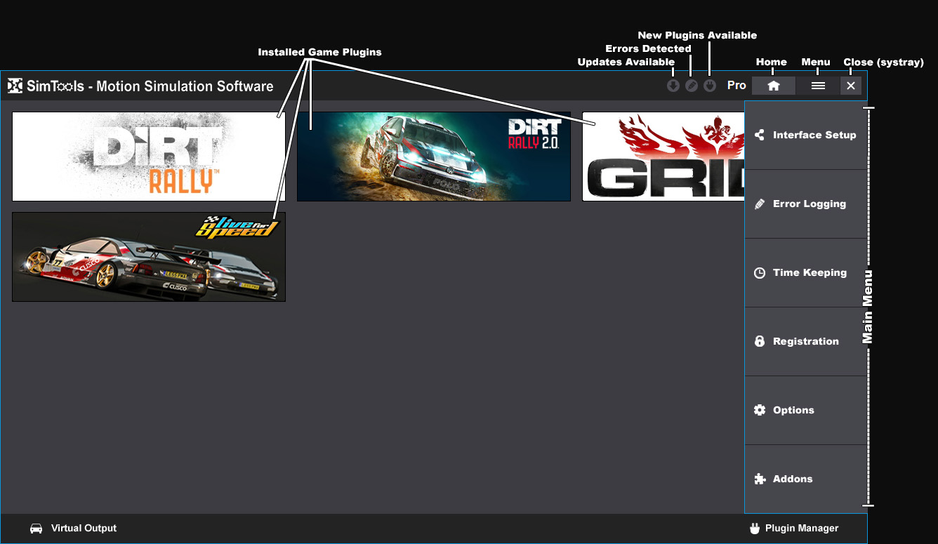

    ~ A little bit about the new Menu System ~
    Interface Setup
    All interfaces for Motion, Dash and Vibe are setup here.
    Error Logging
    If you see the errors detected icon blink and turn on, you can go here to see what has been reported as the error.
    Time Keeping
    Ever wanted to know exactly how much ride time you have had on your simulator (per game) between two dates? Now you can. (Ride Time is only counted when at least one interface is running, and the game is reported active from the plugin.)
    Registration
    This is where you use your license to unlock the SimTools v3.
    Options
    This is where the options are for SimTools v3. All plugin exports are also available from this page.
    Addons
    This is where add-ons will be displayed and accessed in the future when we get some built.

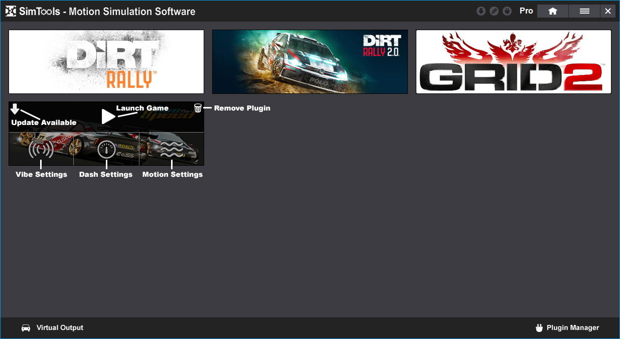

    Any action that is directly related to a specific game can be done under its menu.
    Updates Available
    Click the down arrow for update options for this plugin.
    Launch Game
    If this button is white, the game is ready to be launched. If this button is gray, you need to set a launch path for the game.
    Remove Plugin
    Click this to remove the plugin from SimTools v3.
    Motion / Dash / Vibe Settings
    If these buttons are red, they are temporarily disabled and will not be started when the game is launched. If these buttons are gray, it means there is no interface setup for the given section. If these buttons are white, it means the section has valid settings and the section is ready to run.

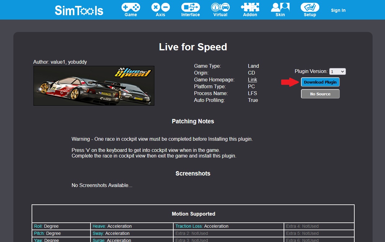

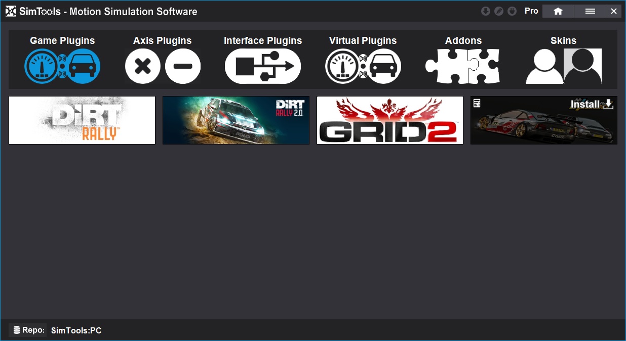

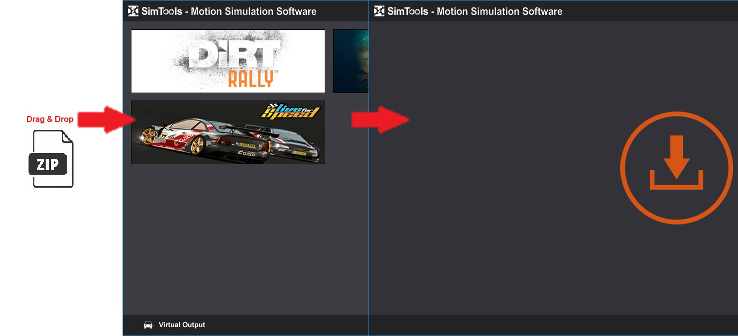

    Installing plugins can be done directly thru SimTools v3 in the plugin manager section of the app. Or by downloading them from the online repo system and then drag and dropping them into the main GUI for offline installation.
    For Offline Installation, grab the file from the online repo:
    Then Drag Drop the plugin into the main gui
    You may find that some game plugins do not set a launch path for a given game plugin, or the path is setup for a different version that what your running. To update a launch path for a game plugin, simply drag and drop the games exe or shortcut on the banner for the given game plugin.

    @yobuddy are there plugins we can try? I can't see any game plugins (LFS would be great) and no interfaces :cheers
  13. yobuddy
    5,433
    51,016Coins
    +5,181 / 19 / -0
    Take a look in the Plugin Manager section.
    Lower right of the main screen.
    (also make sure your registered)
    You will need to install the axis and and the interface plugin that you want to use.
    then install a game plugin and your golden!
    The Alpha ships with nothing installed as I want to test the repo downloads for as many plugins as possible.
    Thanks for the message!

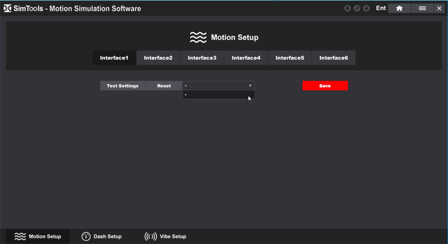

    Thumbs up Yobuddy for this great new version :), it's much more fun to navigate between the different panels. After some tests with Dirt Rally 2, here is a quick report about my experience:
    + Navigating through the repos and downloading the plugins is working perfectly, it's a pleasure to use this new function;
    + Today I've been pushed a new update to the main software, the automatic update worked like a charm;
    - Each time I start Simtools, it gives me an error message about a license issue, but then in the registration dialog everything is fine (intended for alpha? bug?)
    +- It's cool to be able switch between vibes/dash/motion. But once I'm working in a section e.g. motion and I wish to go to vibes, I have to go back to the home menu and click the vibes button on the plugin again. It will be a real pain once I have 20 plugins installed... A direct switch between the three section is necessary.... or did I miss the magic shortcut??o_O
    - Does the red vs white color of the vibes/dash/motion buttons on the plugin image reflect the enabled/disabled state of the section? If yes, this does not work every time, I've had the color changing but not always in sync with the switch inside the section (try clicking three or four times on the switch then go back on the home screen and check the icon).
    + The vibes section is very cool and I have tested it successfully with rpm and speed change! Problem is, now I definitely need a bass shaker :grin
    - There is a small bug in the vibes section, in the Vibration Editor panel the "Test Settings" generates a data type mismatch error (reference to the Selected Vibration dropdown is made via the text instead of the index)
    +- Is it assumed that there is no output interface for the Dashboard yet?
    + It's soo cool to have an export function (intentionally hidden in the options menu?), so now we can easily share our beloved fine tuned setups! I don't know how the import process will work but I guess it should create a profile that would appear in the "Selected Profile" dropdown.
    All in all, I find that a lot of efforts have been put in the accessibility of the different elements and options, it's much more logic than before... and this is particularly useful as we all know there are so many options that you can easily get lost.
