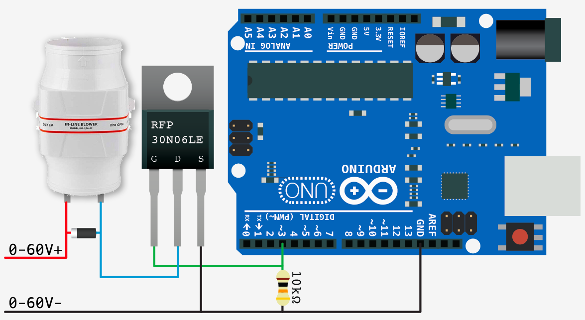

    Below you will find a wiring diagram, a sketch for an Arduino, and instructions to turn a pair of In Line Blower fans into dual speed fan setup for a sway controlled 3D wind setup.
    Here is the fan wiring diagram: (Both fans are connected the same way as shown, with pin 3 in the pic below being the fan’s output pin number)

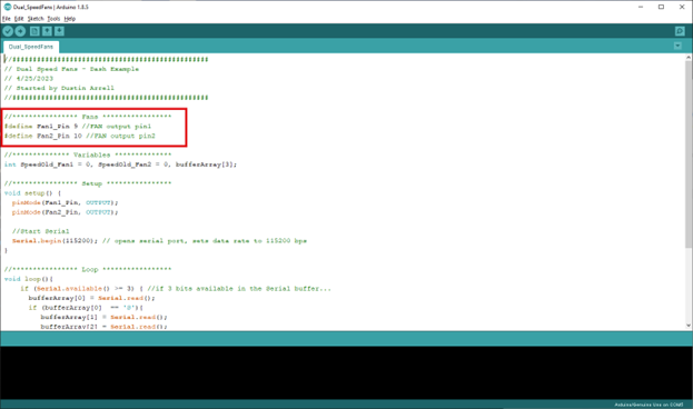

    Dual SpeedFans Arduino Sketch:
    Dual_SpeedFans.zip
    Once the file is opened, if you need to, you can change the fan output pins here.
    Then upload it to the Arduino and you are golden!

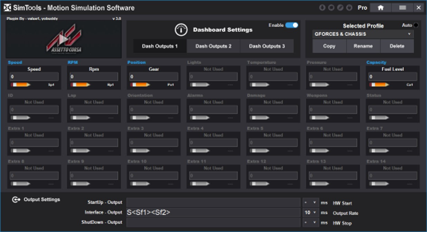

    SimTools v3 setup.

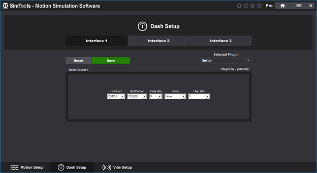

    Go to the interface settings and connect your new dual speed fan setup.

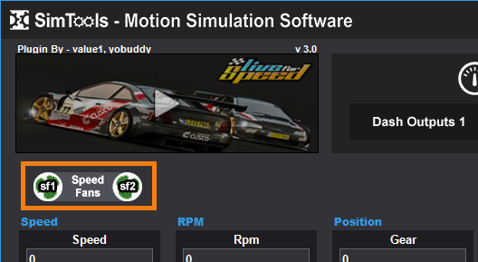

    Click here to get to the 3D wind settings:
    Configure the sway, speed and output configuration settings shown in the orange box below. Then then adjust the fan speeds when panning to your liking
    And lastly, tell SimTools what to send for output

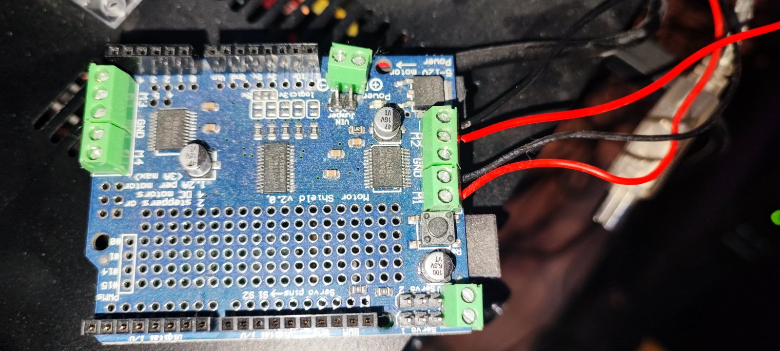

    Hi friends ! I have an arduino one + adafruit motor shield V2 to power two PWMfans. I followed a lot of advice but I'm a bit stuck... I think I need to download a sketch for my arduino to configure it but I don't know don't know how to do that. I put the tables here but it's a bit of a coincidence. Do you have any leads? Maybe I don't have the right equipment? I was on simhub before...I want to be on simtools V3 now. Thank you friends

    I mounted my arduino exactly like this :
    I don't know if that helps? I put the link of the tutorial on which I copied the assembly and the photo of my arduino as it is today.

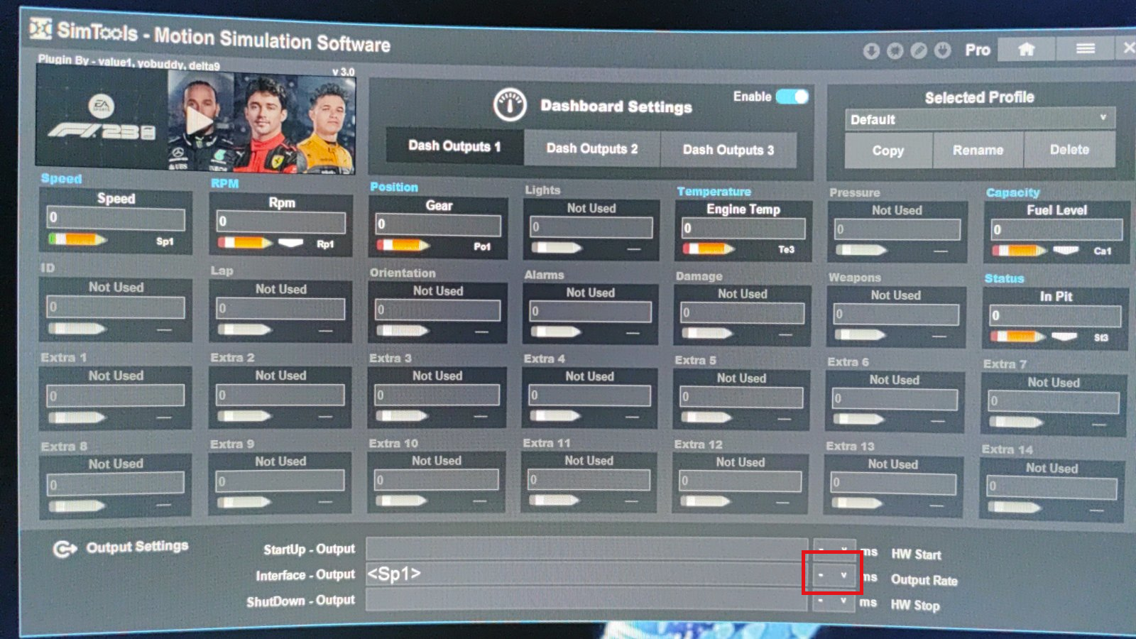

  10. yobuddy
    5,375
    50,302Coins
    +5,149 / 18 / -0

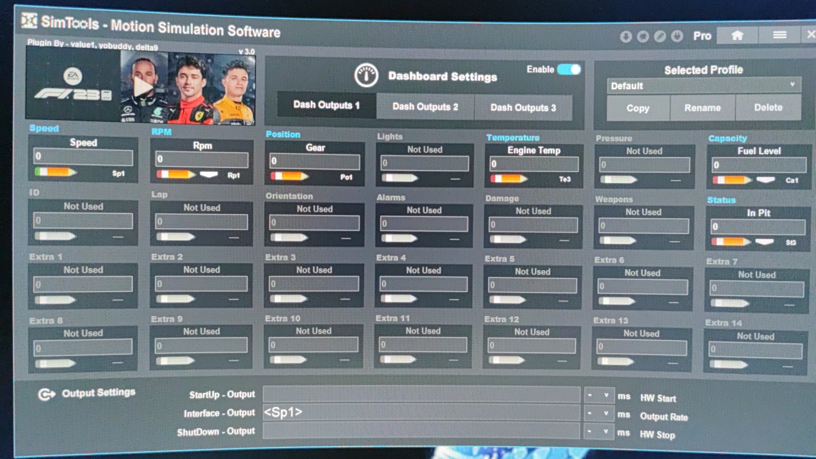

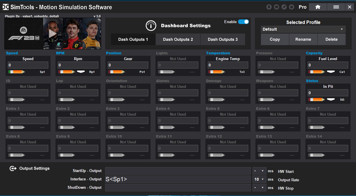

    Please try this buddy.
    Replace the "GetBits 1 5 8 d" command for speed, with these 2 commands.
    Map 0 100 0 255
    Pad 3 0
    Then for the 'Output Settings' - 'Interface Output' replace the '<Sp1>' with"
    S<Sp1>
    And then give it a run and see what happens.

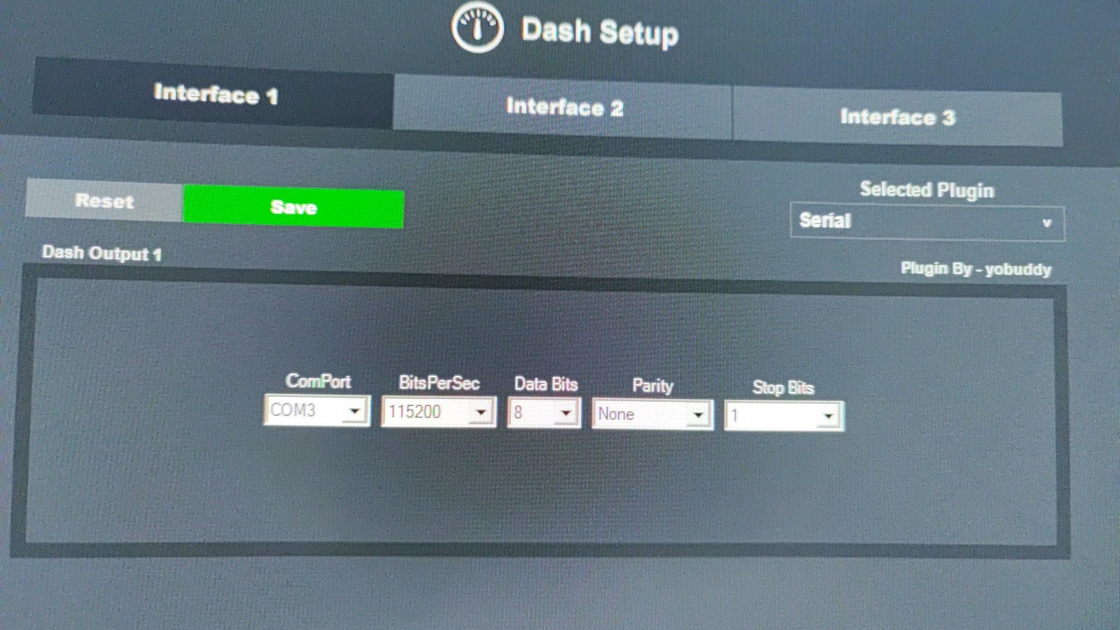

    thank you for your patience...unfortunately nothing is happening..
  12. yobuddy
    5,375
    50,302Coins
    +5,149 / 18 / -0
    The sketch shows that the communication rate is 9600, so please change the 115200 to 9600, and give it another go.

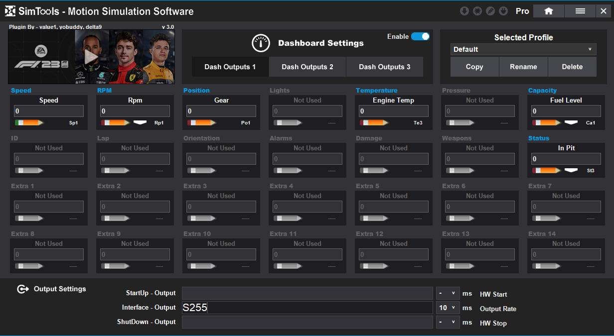

    Looks like it takes a input of 'S' and 3 chars, like S001 thru S255, which is what I was trying to do with our output.
    Just for a test, in output settings, put "S255" instead of "S<Sp1>" and see what happens.

  15. yobuddy
    5,375
    50,302Coins
    +5,149 / 18 / -0
    Please make sure you set this to 10 or nothing will happen buddy.
    I bet it will work, once you set this value to 10.
  16. offman
