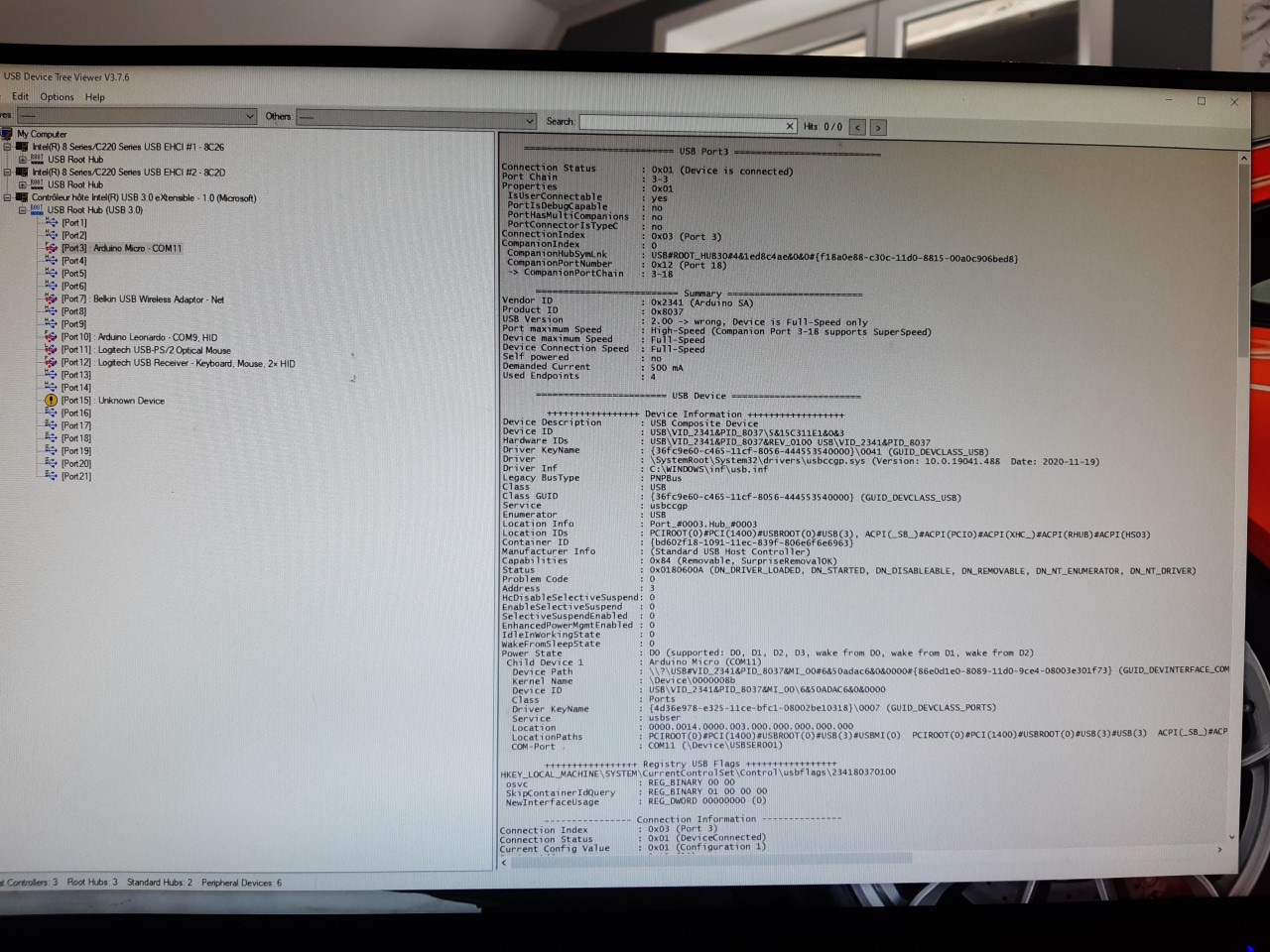

    To eliminate some ideas already, my version of simtools is the latest and the computer is in English
    I installed USBTREE, I am in USB3, but I don't know which software information is useful for my problem(see picture) thumbnail_20211208_134910.jpg thumbnail_20211208_135434.jpg

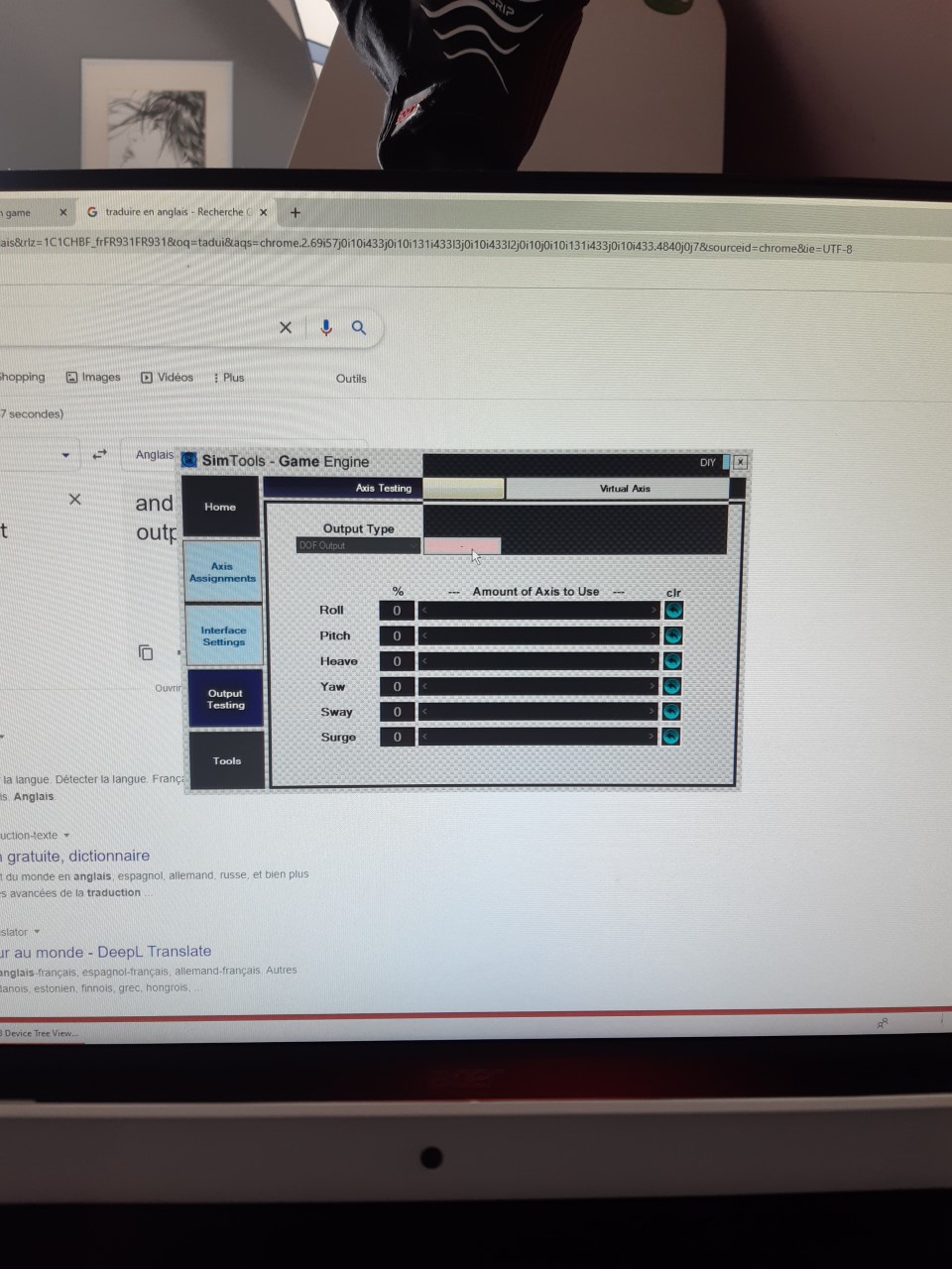

    I will try to explain the problem well
    I'm testing simtolls or games but just trying the axes with game engine
    I go to output testing and set the output testing to OFF
    I slide the sway or surge cursor from left to right quickly and the software picks up in a few seconds
    the arduino's green light goes out
    and when I pass the output testing to ON, a sound is heard
    the software changes color(see picture)and simtools no longer activates any axis, there is no more response
    I then stop GAME ENGINE and restart it and switch to OFF or TURN OUTPUT TESTING nothing happens, no sound and no movement
    20,462

    From your description of the sound, if it is a Windows notification sound, tends to suggest either an error, which should trigger an error message, or a USB disconnect, my guess would be the USB disconnect.

    It looks like you have everything loaded on USB 3, and USB 3 implementation can be a bit flaky, plus is not really needed for a lot of things. USB 2 is actually more solid and is suitable for anything that does not have high data transfer needs.
    So consider spreading stuff to some other USB controllers.
    You can also unplug everything, plug one thing in at a time, test it with SimTools Output Testing, and try and pin down which device, or combination of devices, triggers the disconnect.
