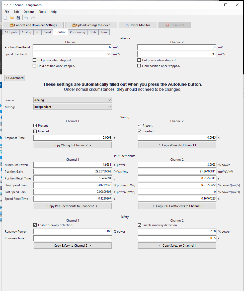

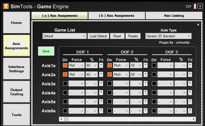

    I would be very grateful if any one could help with a setup problem with Simtools.

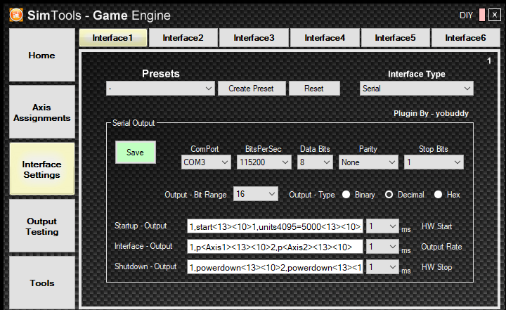

    I have recently upgraded my simulator to use a different type of position sensor to control my motors position, and within DEScribe I managed to complete a limit switch tune after the tune I set the BitsPerSec to 115200 and tried to connect to Simtools so far I have been unable to to get the motors to move in the output testing within game engine.
    I have setup the Interface with all the parameter's, although in the Pre-sets dialogue box it would not show the name of my pre-set and the file seamed to save ok

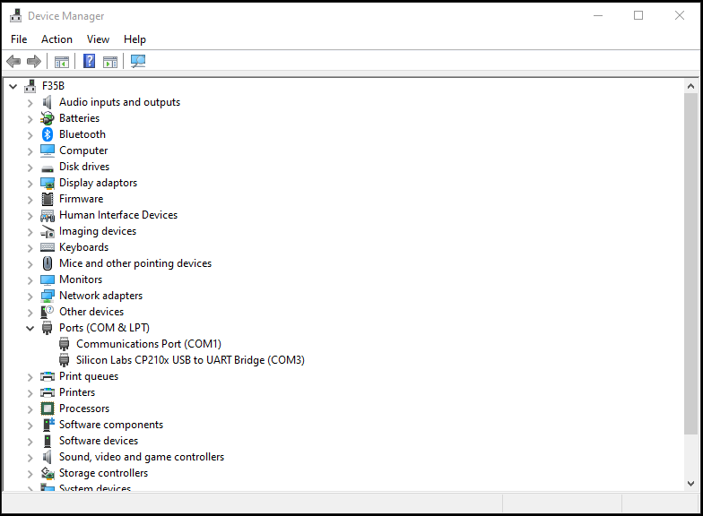

    on reading the documentation i have tried output bit ranges 12 & 16 with no effect, and i was connecting through a Silicon Labs CP210x UART on com 3 this is attached to the Kangaroo.
    at this stage i am at a loss if anyone can help i would be very grateful.
    I have enclosed some pictures of my setup for reference.

    HI noorbeast, thank you for putting me back on track I can see the error in the code Interface - Output, i did not type it in but copied pasted the code, in future i will double check the code.
    Thanks again.
