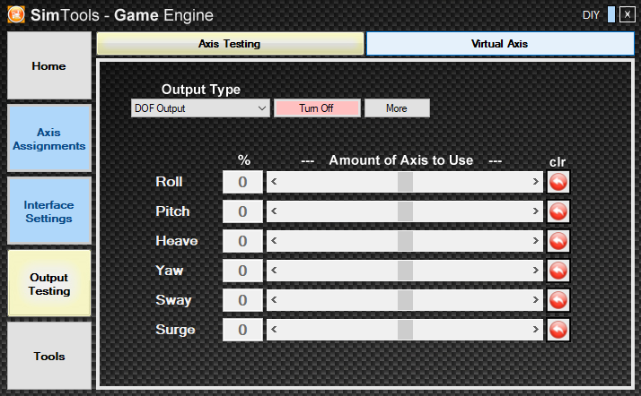

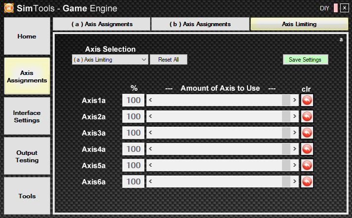

    Hi, how to center motors in SimTools?
    Here is my config:
    Then I turn on output testing my motors rotates from center a bit. Now I'm using only pitch for testing. Changing 127 to 0 in startup do nothing.

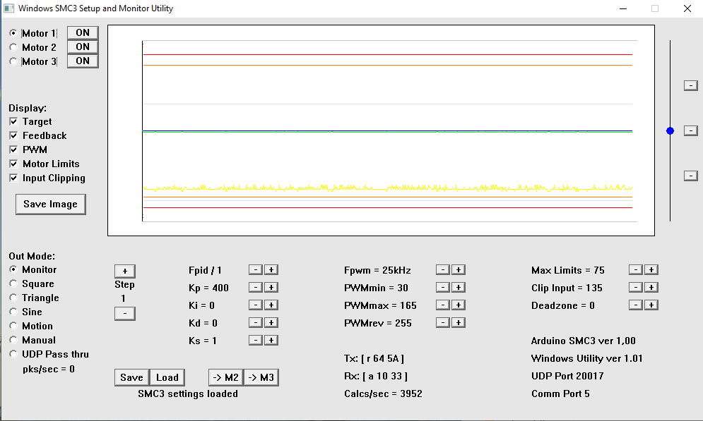

    Here is how feedback in SMC3 looks after this strange movement(I turned off power to take screenshot):
    How to fix this?

    not entirely sure, but the output is 10bit so half is 512. 127 is half of 8 bit.
    21,517
    150,722Coins
    +11,018 / 55 / -2
    Centering the motors should be done in SMC3, not SimTools.
    With power OFF to the motors and with the motors in their centered rest position loosen the pot and rotate it by hand until its feedback line is centered in the SMC3 graph, then re-tighen the pot.

    I did it in SMC3, it looks like in SMC3 it works just fine, but in SimTools every axis rotates about 20 degrees.

    I am not sure what you mean by that?
    If SMC3 is properly centered, there are no Startup Output in SimTools, the motors should start centered. If not can you please explain further what the settings are, with pictures, and the observed output.

    SMC3 every motor feedback:
    And motors look like this:
    SimTools settings:
    In Output Testing Pitch is set to 0%, but every motors moves and look like this:
    And I'm confused, it should look like in SMC3 I think.

    In SMC3 both motors should be centered in their default rest position, this picture seems to indicate that one motor is in its proper centered rest position, the other is not, is that correct:

    Well, both are not in their proper centered rest position. This is after turning on output testing in SimTools.
    In SMC3 rest position is fine and look like this:

    Please let us know how the language change goes, as that is a known bug, which hopefully has been squashed in SimTools v3, which is currently in testing.

    Yeah, that was it. I changed unicode language from polish to english and now it's centered.
