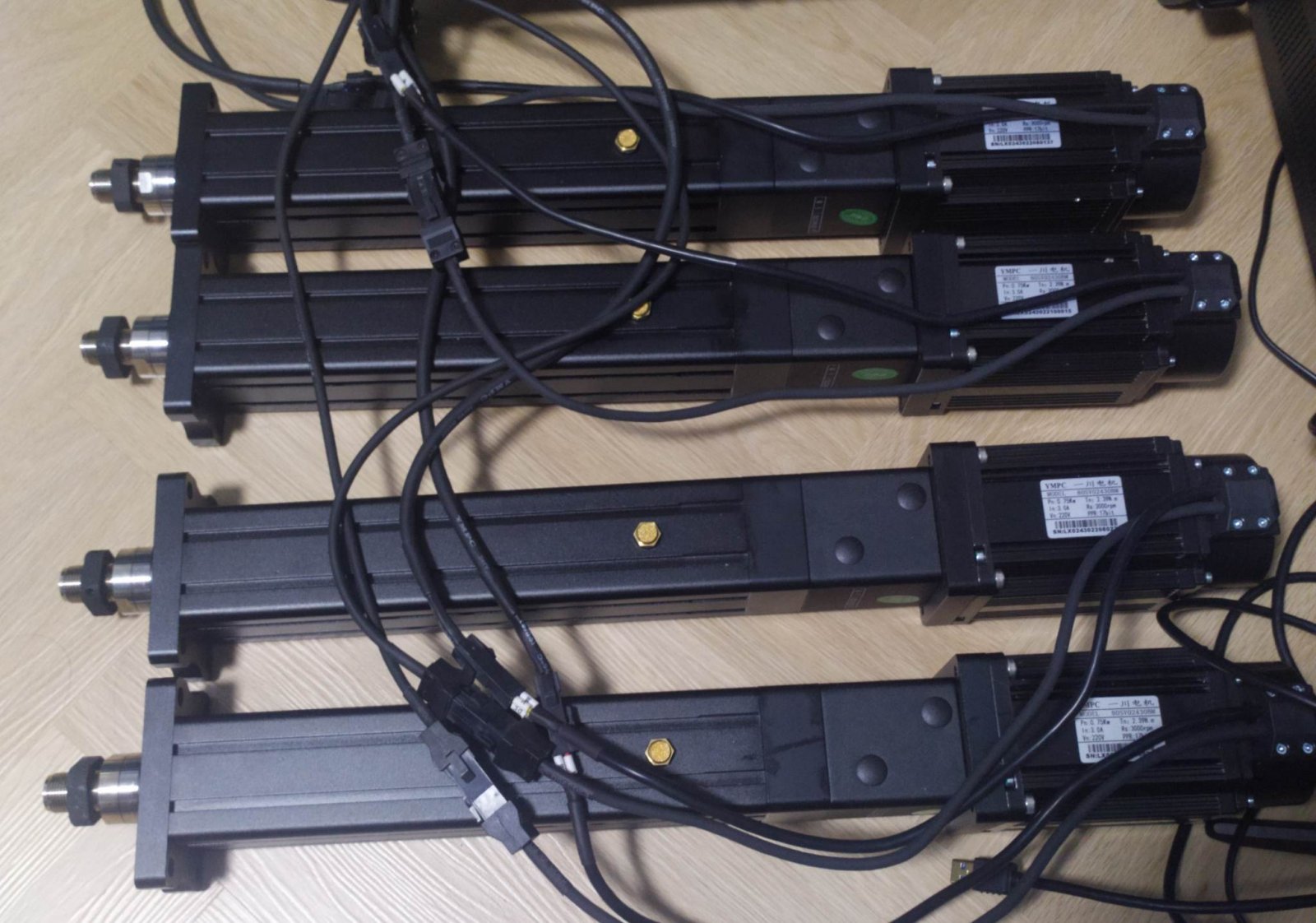

    I install simtools both version 2 and 3 with my notebook, and I can use it and motion worked normally for a year. But last month it just had problem. When i connected the monitor to hdmi port, motion had unusual movement immediately. When i unplug cable from hdmi port, it's back to work normally again. when i connect steering wheel to usb, it also had error.
    I searched in this forum to find out how to solve the problem. I tried to close antivirus and firewall, delete simhub, reinstall software it's still error. And finally i found out that it occurred from fanatec driver of my new steering wheel. When i uninstalled it, motion worked normally again.
    But last week, this problem occurred again. But now I don't know how to solve it and need all of you guy help. I try many ways. try to delete some software, reinstall simtools software, try to change to my other new pc, install both version 2 and 3. It also has same problem. I also try to install with my other notebook with reinstall windows, it also has same problem. I find that the error will occur when i just bring hdmi cable to touch hdmi port.

    - 4 axis of chinese actuators, i don't know how to call. I have 2 sets of them. when i test, they have same problem. Last month, it still work normally.

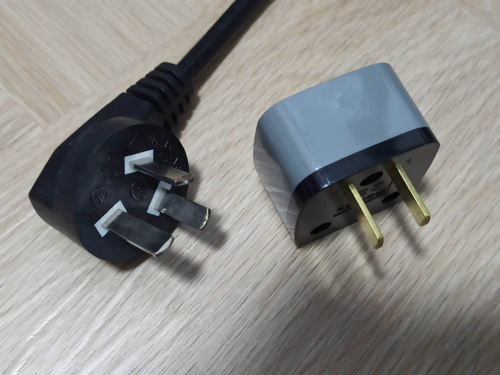

    It sounds like something is not properly grounded, is there any cable damage to anything?

    That you get the same issue with multiple computers and operating systems really does suggest something is not properly grounded, which may be the hardware and/or wiring.

    Many thanks to all of you to confirm me, finally i recheck all again and again. I just know that the problem came from only my universal adapter of my machine that was no grounded. that's my very stupid. Now it can work normally.

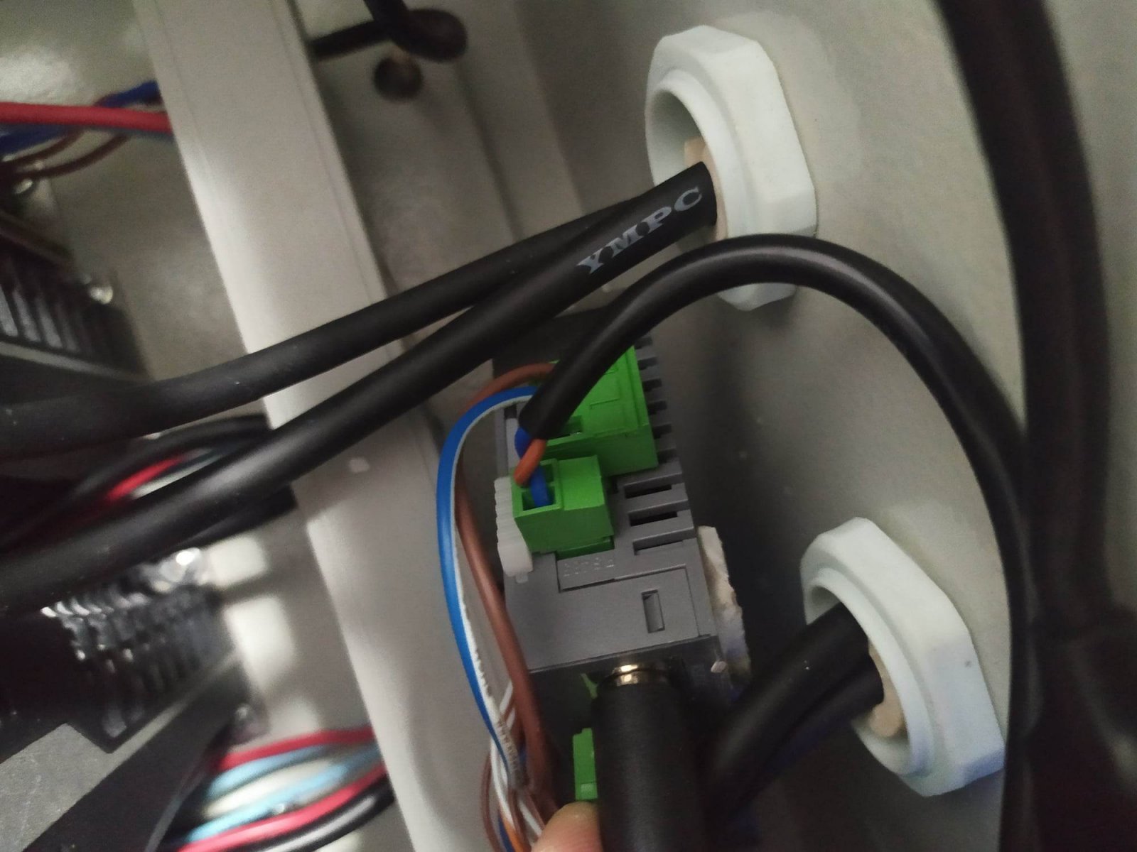

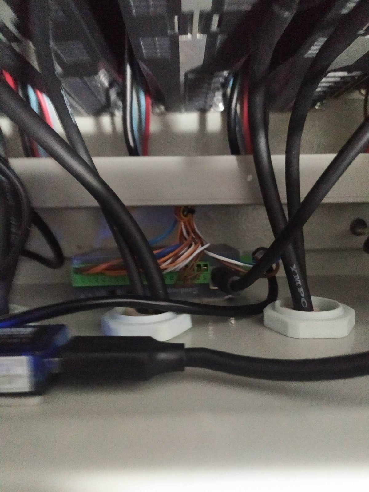

    I just found that one connector inside the machine is loose. (small green one) Now it works well again.
    Thank you all of you.
