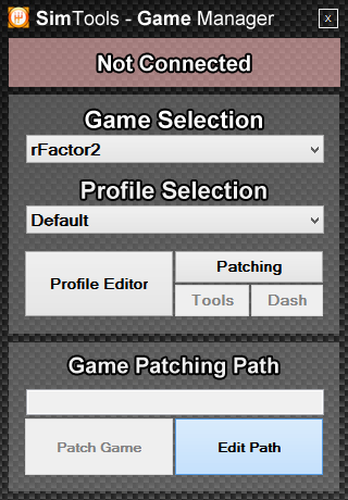

    Is Simtools going to be compatible with rFactor 2 x64 build 798 and the new map structure ?
    Game Manager search for the map where the launcher.exe is in and then place the plugin in the totally wrong map.
    When I replace the plugins to the originally correct map Simtools still isn't working.

    Thanks @Rinus janssens for letting me know! :thumbs
    I have updated the plugin and it now works with the old builds as well as the new.
    You can find the plugin here.

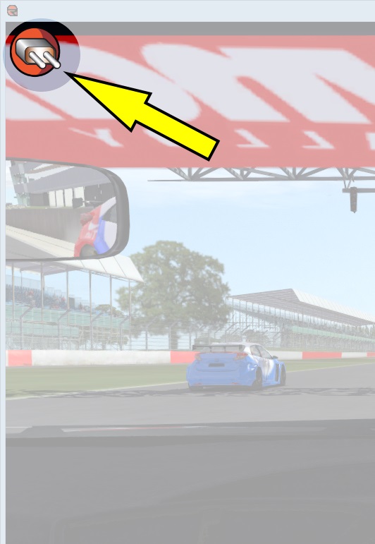

    @Matthias Griese: When you start the race, do you see the plugin icon in the upper left corner?
  6. Matthias Griese
    Matthias Griese New Member Gold Contributor
    Feb 18, 2014
    16
    - 12Coins
    No i dont. In the older build i saw it.

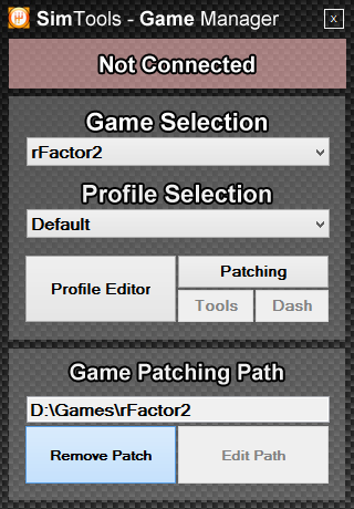

    Try to remove the patch
    and patch again
    Maybe run GameManager in Admin mode when patching.
    Only when you can see the plug in the upper left corner, you will be able to see data in SimTools.

    Thank you. I will try it soon. The patch path is still the rfactor2 main folder right?
