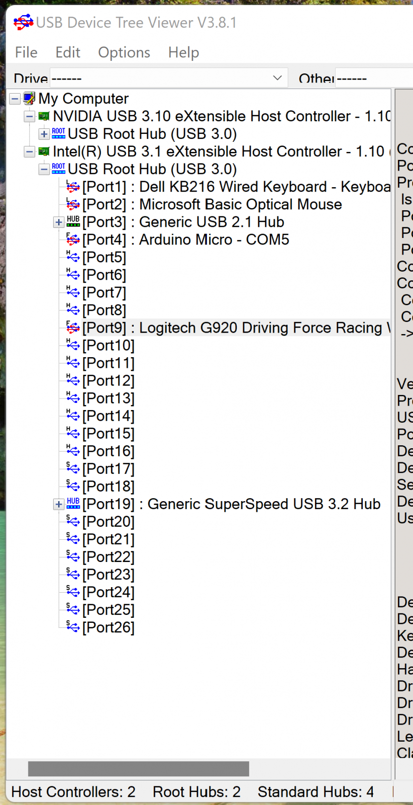

    Hi @noorbeast , I am attaching here a USB tree view of my system. I am not sure which port on my computer is 3.0 and which port is 2.0. Is there any way that one can tell readily?

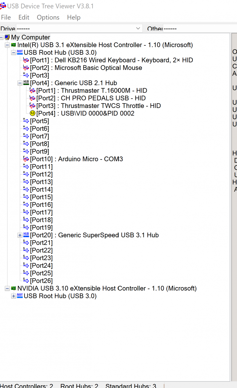

    Some update: I replaced my main USB hub where all the controller inputs were connected to with a new USB hub. Now I don't have the problem of the USB controller not recognized anymore. Here is the USB tree view for it. However, I continue to have problem with Game Engine quitting each timer Dirt2 started. It happened even if I lower the profile input to 20%.

    USB tree view tells you which port is 3.1 and which port is 2.1, all of your controllers are on USB 2 port 4 and the rest are USB 3.
    Try shifting your controllers to a USB 3 port and your Arduino to the USB 2 port.
    Please also post all your SimTools settings for Dirt2.

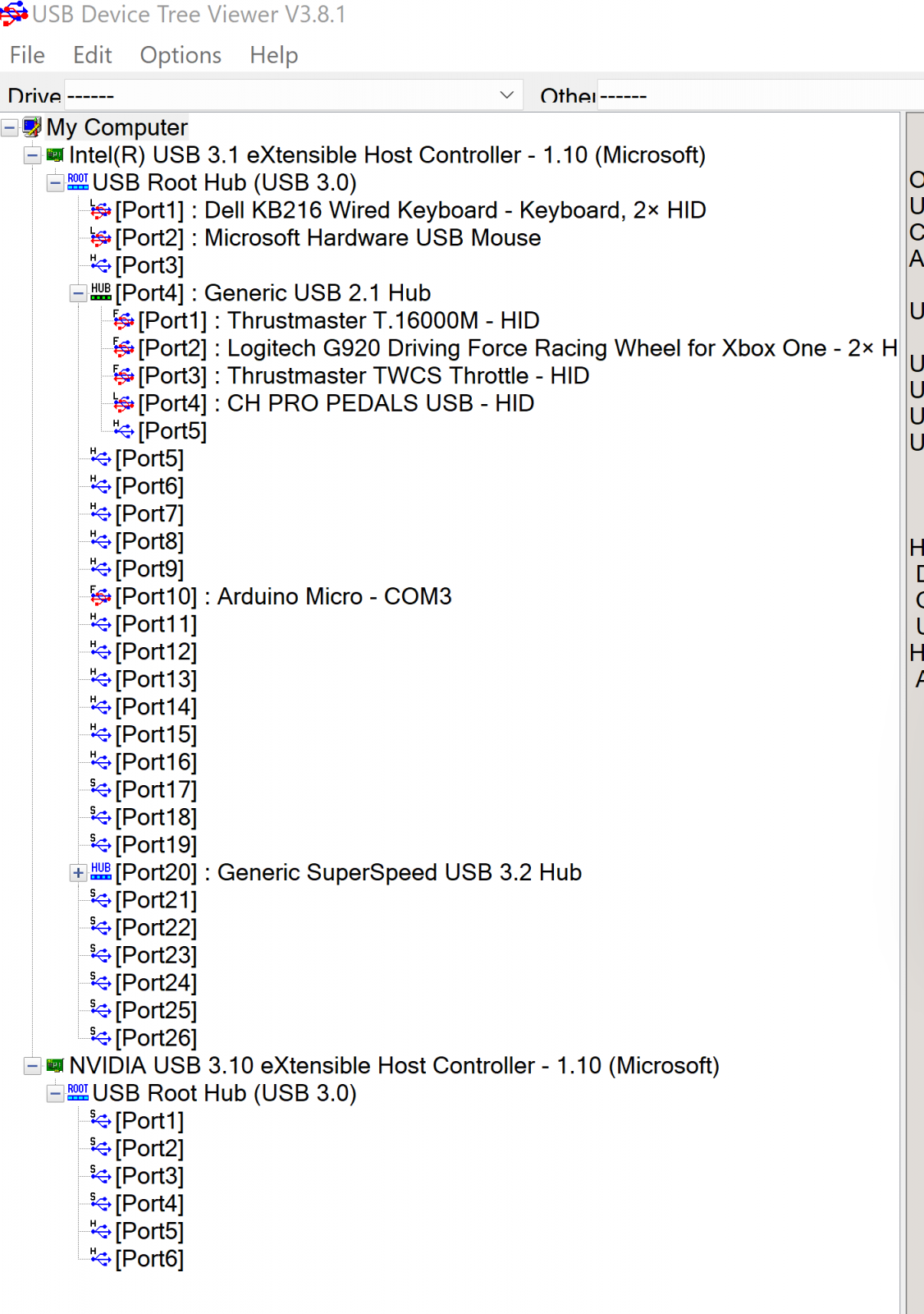

    1. I have replaced my usb hub with another one with more ports on it. I rerouted my simtools interface to another port, USB3.0. Here is a USB tree view of the newer one. I also changed the Simtools interface port to match the new USB port setting.

    You do not need to change the "Simtools interface port to match the new USB port setting", a usb port is very a very different thing to a communication port.

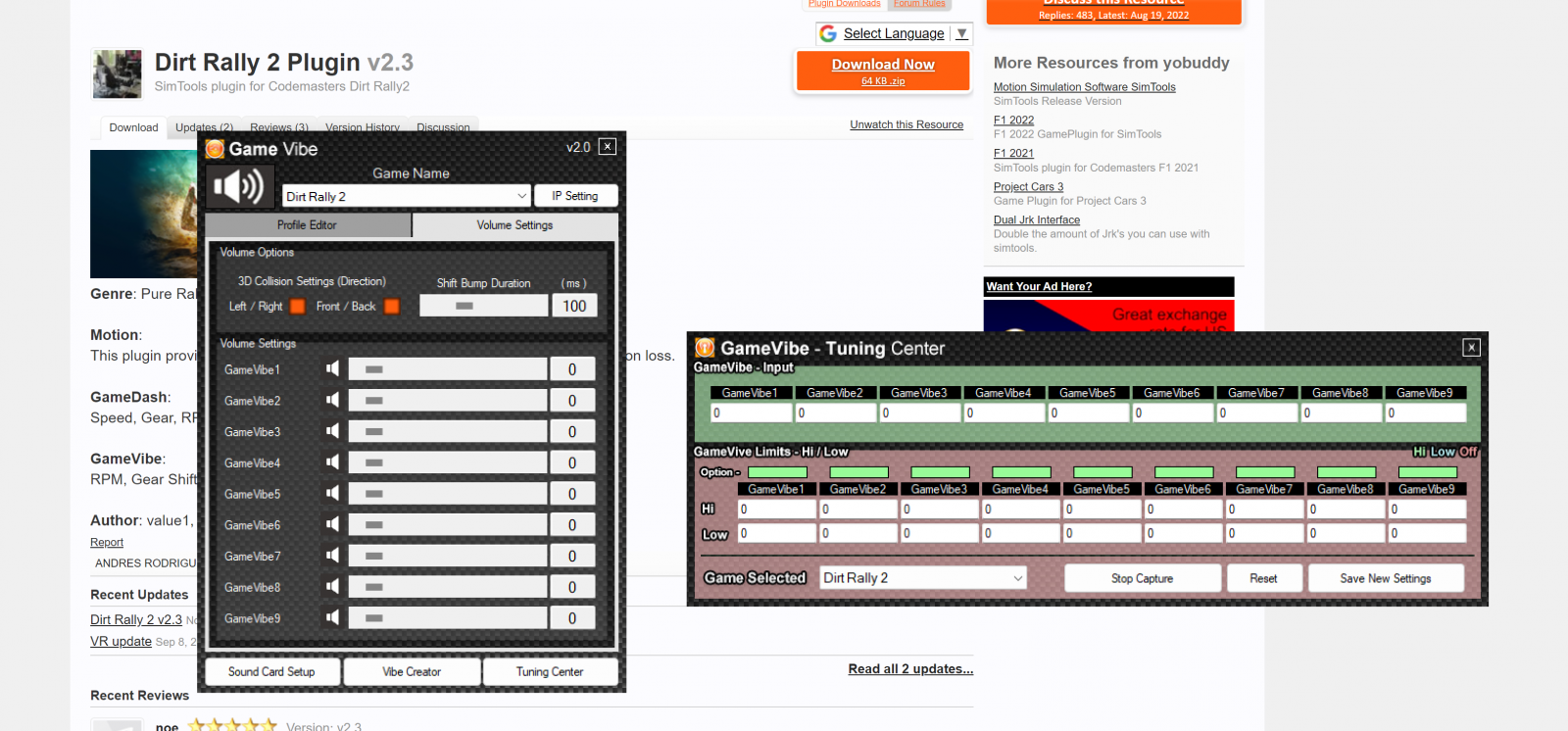

    update: I made some good progress.
    I downloaded the DirtRally2_GamePlug.2.0.3.0 and patch it instead of using the file Dirt2_GamePlugin.2.0.0.1. After that I went into the Game Manager and remove the patch and then patch the motion sim again. The motion then began to work and there is no more crash of the game engine.
    The only thing that is not working for me is the game vibe. I am not getting the vibration of the seat. I tried to tune the game vibe but it is not getting any value from the game as you can see in the screen capture.

    Update: both my motion and game vibe are now working perfectly on Dirt2.
    Last time I was able to get the motion working but not Game Vibe as it didn't produce any output to the seat shaker. Thanks to a tip from @noorbeast on another thread, I was able to get it to work now. Basically, sometime Game Vibe doesn't work and you would have to apply the following procedure to get it to work.
    1. Bring up Game Manager and turn it OFF
    2. Start Dirt2
    3. Turn Game Manager to ON
    4. Bring up Game Vibe and make sure it is tuned to capture Hi-Lo parameters. Then save the captured parameters.
    5. Game Vibe should now be working.
    Hopefully this can help someone out there with the same problem.
