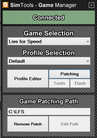

    Hello !
    I'm posting here because I set up simtools on my computer.
    I did all I had to do but I'm receiving no game's data on Tuning Center.
    None value appear, I see only 0 in the table.
    What Could I try ?

    Pictures of your setting's please. Axis % Interface setting's....ect ect.
    21,557
    150,962Coins
    +11,025 / 56 / -2
    And include what game is being tested and the patch path used.

    Actually, I tried to test Simtools without interface output but I did'nt succeed to make work it.
    I tried with Live for speed and Trackmania, none of these work...
    I'm going to become crazy x)
    I don't know what to to

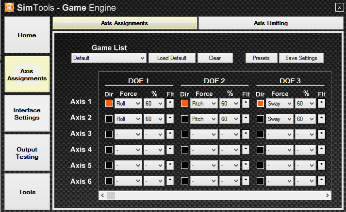

    you have to configure a profile for LFS to have motion while playing LFS.
    create a profile in game engine under-axis assignments-game list-LFS.
    make sure you have launched the game before patching it

    I tried but that doesn't works...
    21,557
    150,962Coins
    +11,025 / 56 / -2
    What is your simulator hardware, what control boards is used and what are your Interface Settings?

    That worked ! Thank you very much for your great help ! hug:

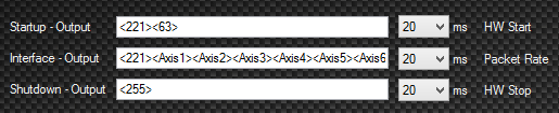

    Now, if it's possible, I would like understand what means the instructions in "Interface Settings" ?
    Because the simulateur is a project for my studies, I must understand what I do.
    I understand what are the axis, but about the differents numbers ?

    The Startup and Shutdown values set the position of the simulator for each of those states: http://www.xsimulator.net/community/faq/startup-and-shutdown-positional-controls.234/
    The Interface - Output defines the axis and the rate is set in ms.
    You can find the SimTools documentation here: http://www.xsimulator.net/community/faq/rtfm-start-with-the-official-simtools-documentation.117/
    There is also a useful section in the FAQs: http://www.xsimulator.net/community/faq/simtools-settings-tips-and-tricks.18/category
