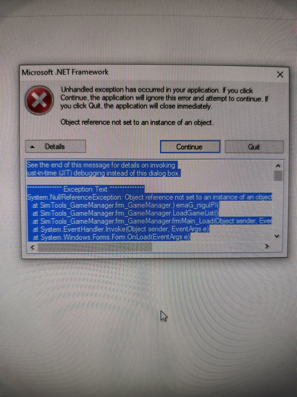

    I keep getting this message when trying to start simtools. long but I will share it anyway. Any ideas?

  4. yobuddy
    51,378Coins
    +5,202 / 19 / -0
    You can not install SimTools v3 plugins into SimTools v2 is all.
    All v2 SimTools plugins need to be downloaded from xsimulator.net
    The v3 plugins can be installed directly in the v3 app, or from SimTools.us.
    You should be able to simply delete this file : "C:/Users/Victor/AppData/Local/SimTools/GamePlugins/155_GamePlugin.dll" And you will be up and running again.
    If you do want to use that plugin, then install SImTools v3 from here:
    https://simtools.us/downloads-links/
    Take care!
  5. Onaflyer
    Onaflyer Member
    Apr 19, 2018
    43
    Boston, USA
    284Coins
    +30 / 0 / -0
    2DOF, SCN6
    Your the best. That worked. Thank you
