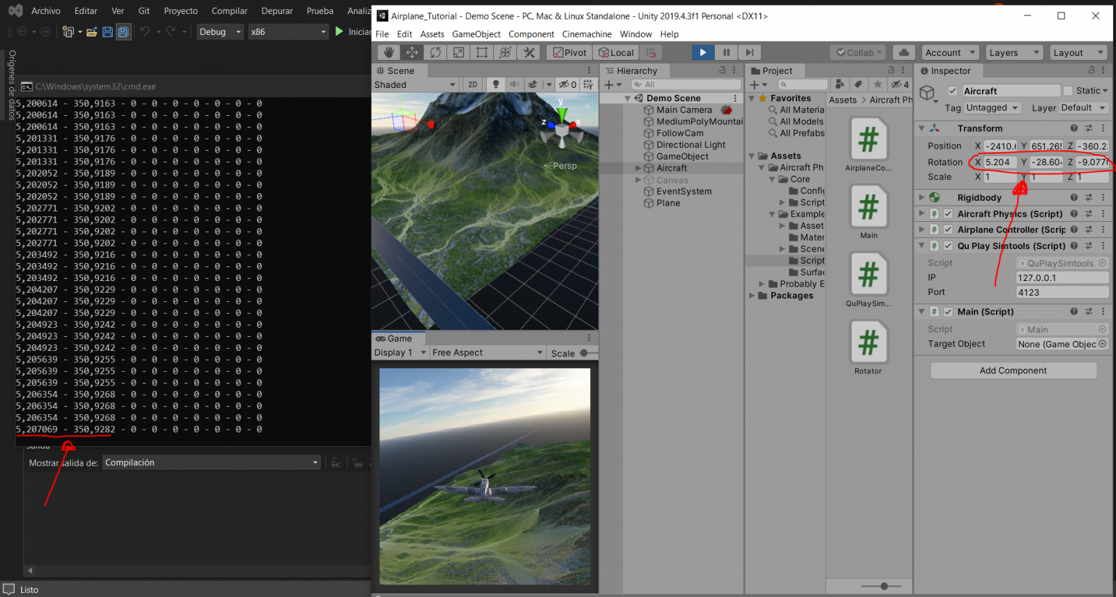

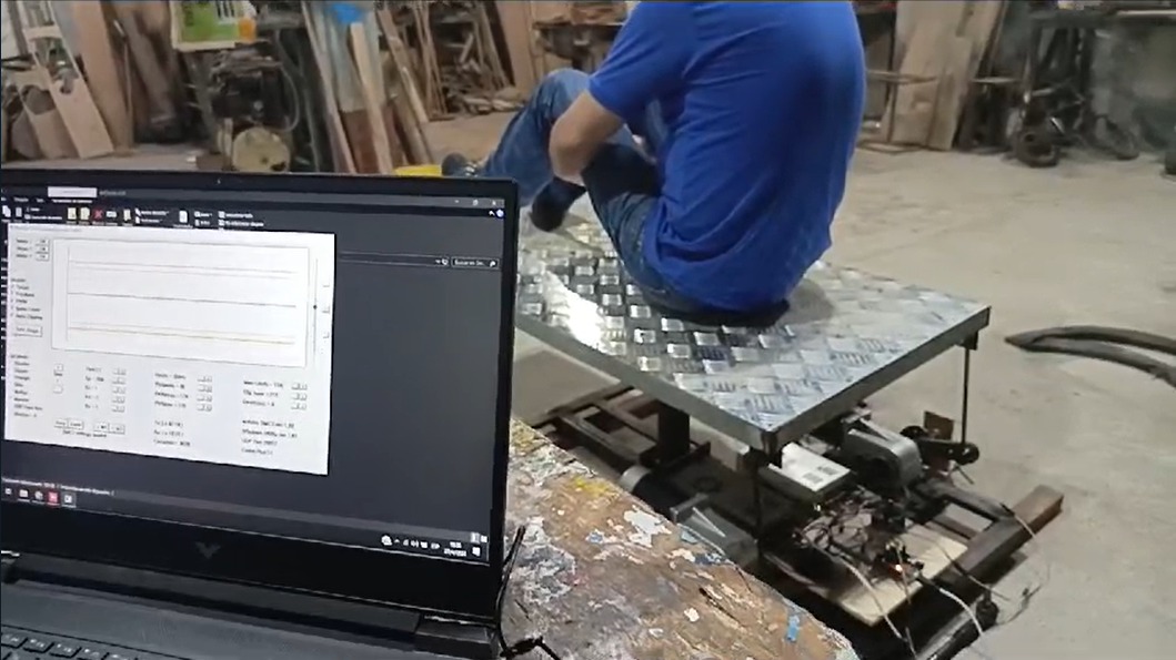

    I'm a beginner in the field of simulators, and for about a month now, I've been building a 2DOF flight simulator. I've set out to design almost everything from scratch. I'll soon be sharing updates on everything I've done. So far, I have progressed (almost completed) the mechanical and electronic parts.

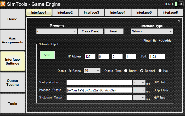

    I'm following YouTube tutorials to design the game in Unity3D. I already have a game designed that's basically a copy and paste of various designs. My question is: How can I connect the Unity3D game with Simtools? So far, I've been sending roll and pitch data over UDP with the help of a forum from @Claudio Silva that I found (by the way, I think he's a genius, excellent work).
    I would appreciate it if you could help me install the plugin in Simtools to connect Unity and Simtools. I believe it's important to mention that I don't have the paid version of Simtools; I'm using the demo.

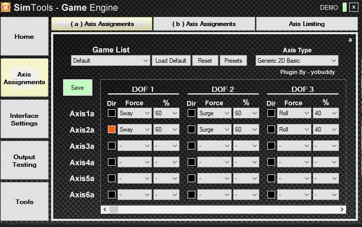

    In SimTools configuration I have the following:

    Thank you very much for your response, I have followed that forum closely and it has been quite useful to me. I understand what the problem is, it is the demo version of SimTools, these days I will buy and I will continue commenting if I manage to create the communication. This community is excellent, it feels like a family!
