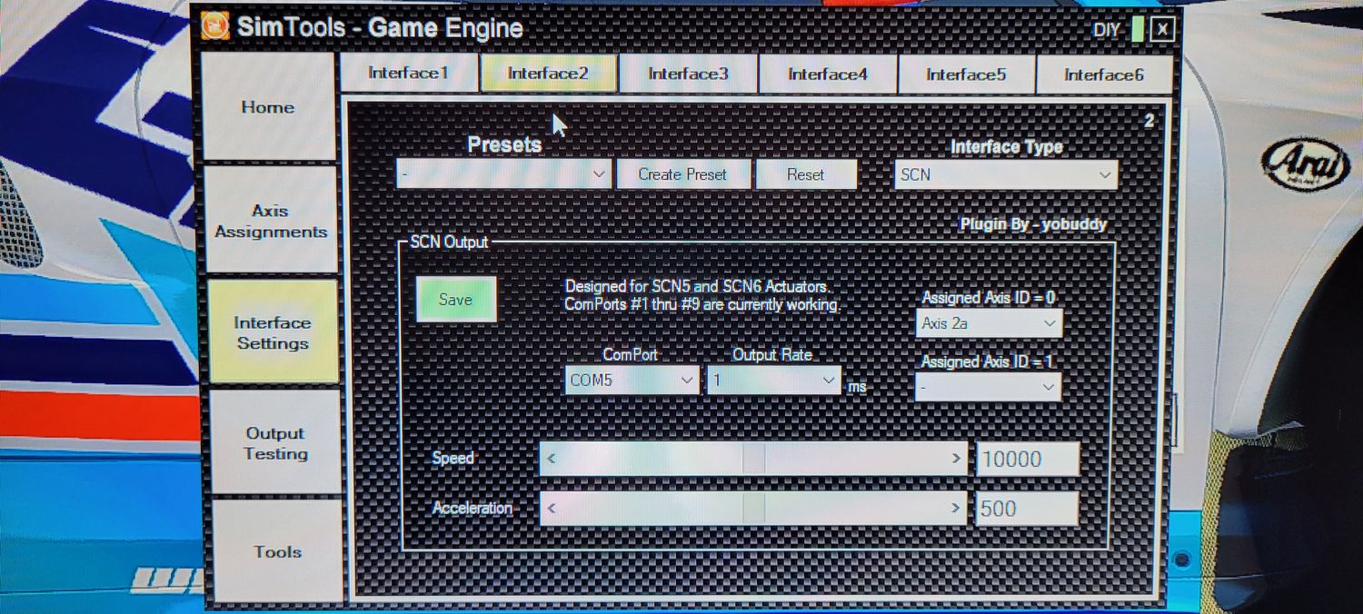

    Hi
    I'm Renaud (France)
    I'm a newbie but I spent hours checking youtube and forum before posting here
    I was hoping to find the solution alone...
    As a newbie I choose to buy a setup from a guy
    The set up was working on his PC (important point )
    Here with my PC, actuators are not moving at all

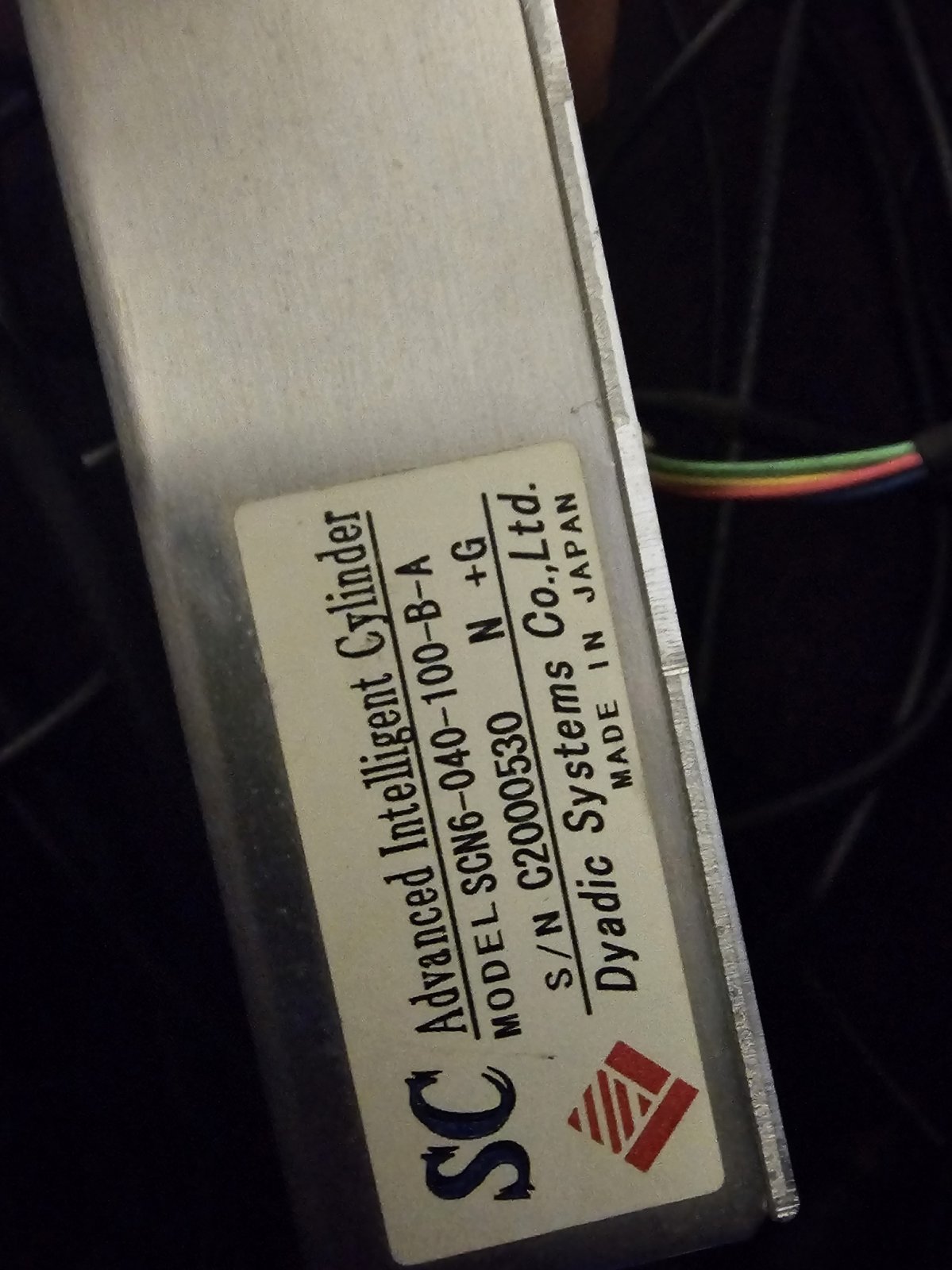

    - prosimu with 2 SCN6 040-100
    - simtools 2.6 (DIY licence)

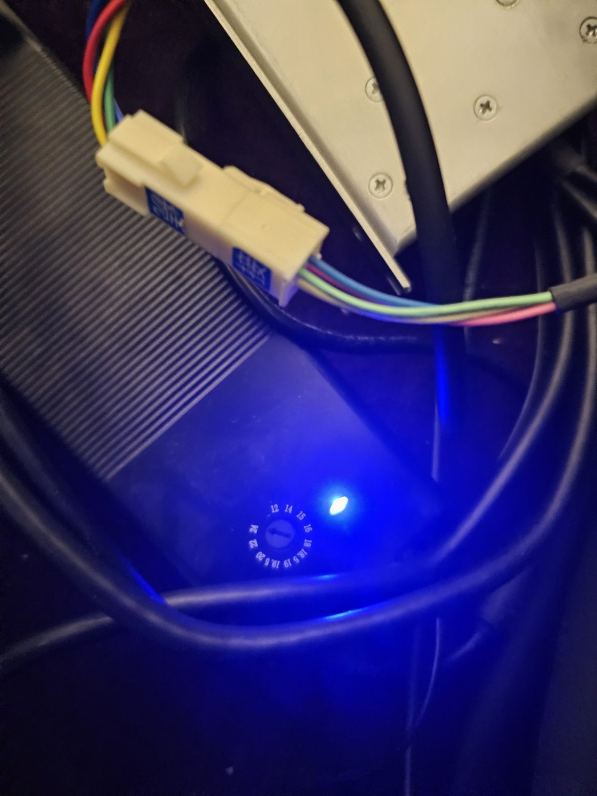

    - actuactors are hooked up in one big 24v ps (working) check picture
    - the 2 scn 6 boxes are working (green and red light inside)
    and to a grey box with two usb cables going to my computer
    my computer can see the 2 USB cables

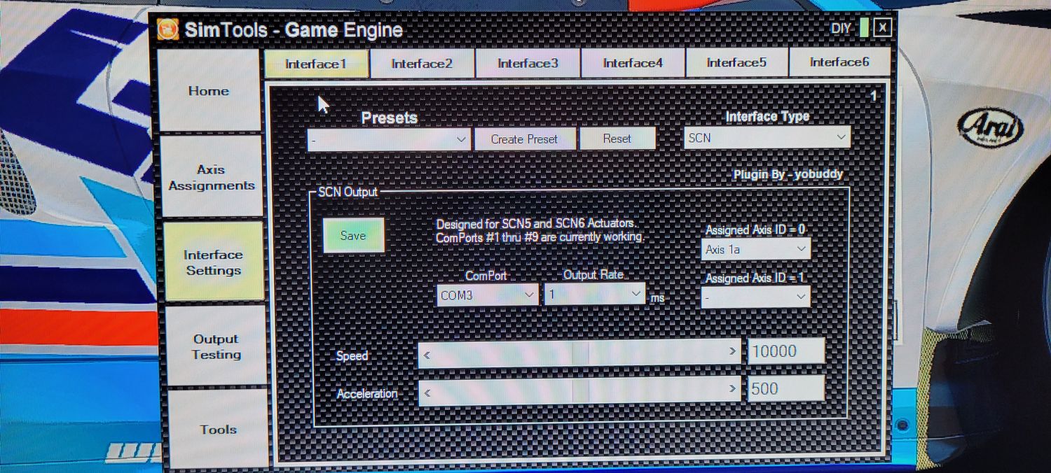

    If if understand correctly, when starting simtools, i need to configure the interface setting (like photos)
    when i do that the actuactor should move (like center position ) right ?
    nothing happen, i try to use only 1 interface (like yobuddy says in the formu ) to test only one = nothing
    i tried to change COM = same, tried to change USB port = same
    And of course if i try to output testing i have the message "one of your interfaces requires gamerengine to be restarted" = means simtools didn't detect my actuactor right ?
    I wanted to try on simtools 3 but when install i have a message "licence already activated need to contact support ( i did but no luck)
    I also download the dydic software to check if the actuactors are detected but i m not sure how to use it ... (sorry)
    So i need help
    What can i do ? (i will try on one other comptuer ...)
    in advance thank you

    QUOTE]And of course if i try to output testing i have the message "one of your interfaces requires gamerengine to be restarted" = means simtools didn't detect my actuactor right ?[/QUOTE]
    This means restart Game Engine, and the actuator should center.
    Basically, you just need to configure both interfaces and then restart game engine and they should center.
    Take care!
