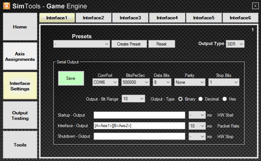

    Hello, recently I got a DIY license, thank you very much, but it does not just go as before, I use it in Corsican assetto and the forces are very strong, I try to soften with the filter but even 100% feels too fast, the sway is a problem in this, my ribs are going badly ..

    Like @noorbeast said, it sounds like the Max/Min values needs to be adjusted for your sim.

    When I increase the value in the tuning center the movement becomes shorter, softer but shorter too

    Adjust the PID a little lower in the code, you will make the motors smoother in the movements.

    The FPID of SMC3? I lower it from 500 to 400, I'll try 300, Simtools 2 seems to make the engines go to the limit

    One question, if I put 150% to the axes, I will do well for Assetto and be able to put higher values in the tuning center, and from that I only want to use half with the boundary filter that I have to put 50% or 75 % in the filter?
