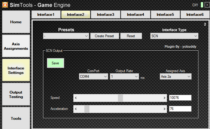

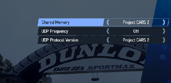

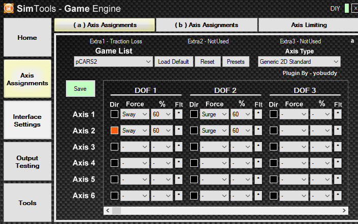

    Just bought the DIY version of Sim tools last night and installed ver. 2.1, I've read through every post I believe and still can not for the life of me figure out why I have no motion. All games are patched and turn blue, all in games settings are set for motion but none have worked.
    I've tried pcars 1 & 2 and also dirt rally. I've spent more than 10 hours and I'm all but defeated at this point. HELP!!!! LOL

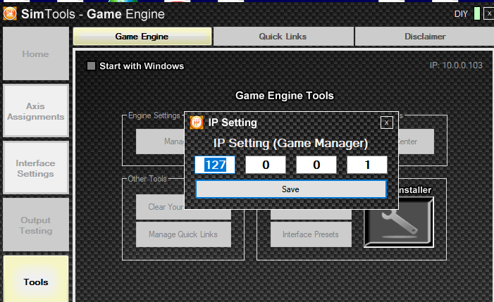

  4. Hobbs77
    Hobbs77 Active Member
    Jun 6, 2008
    207
    Connecticut, USA
    815Coins
    +76 / 1 / -0
    2DOF, SCN5
    What ip setting should I be using?

  5. NjMotion
    Dec 29, 2012
    271
    España
    1,490Coins
    +261 / 5 / -0
    2DOF, 6DOF
    Do you use a single computer or two?
    If you use only one, you do not need to configure ip

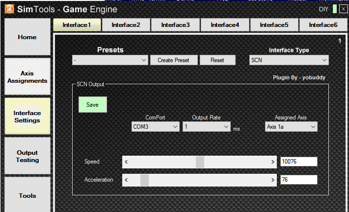

    21,496
    150,596Coins
    +11,017 / 55 / -2
    You have not posted your Interface Settings and you need to check those.
    The difference from SimTools 1.3 to SimTools 2 in setup is that in the Interface Settings instead of axis defined like this <Axis1> it now has designate grouping for a or b in SimTools 2 for each axis assignment, like this <Axis1a>
    In your case each of the Axis should use the a, you will not need b.

    +76 / 1 / -0
    2DOF, SCN5
    I posted the left one but not both earlier. Do I have them set properly?

    21,496
    150,596Coins
    +11,017 / 55 / -2
    Yes you do have them set correctly.

  12. yobuddy
    5,374
    50,295Coins
    +5,149 / 18 / -0
    Turn the acceleration up half way on you interfaces (scn) for the tests.
    You settings have it very very low.
    I think it will help,
