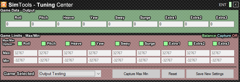

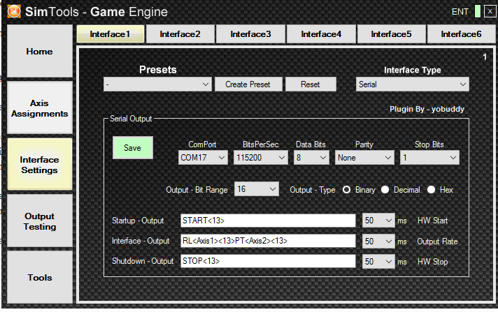

    2.Game Plugin where the error is happening: Within Output Testing - Game Engine. after setting up assignments and interface, just like I did before in ST 1.3, I get no movement on the Output testing stage. The same when trying Elite. The rig tested fine with ST 1.3 Game Engine just today.
    3.Settings (Relevant settings) Same as v1.3, where everything worked fine, except axis assignment using Generic 2S Standard. Tried running the exe as both administrator and not. Operating system is Windows 10.
    One interesting observation: when Turning on Output Testing or launching a game the rig pitches down to the left for a couple seconds and then returns back to neutral. Thereon - no response.
    See the screenshots attached.

    hello
    you need write interface -output
    RL<Axis1a><13PT<Axis2a><13>
    i think :)
  3. Ilya
    Ilya New Member Gold Contributor
    Mar 15, 2016
    8
    - 451Coins
    LOL just copied the old one not thinking about the new naming convention. It moves now. thx man!
