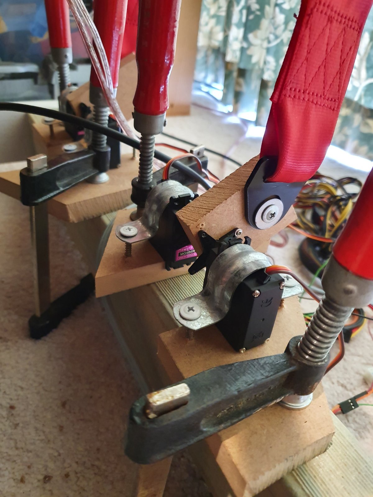

    Hi All,
    Here's my first motion simulator project. I've been playing around with using RC servo's as a cheap way to add more tactile feedback to my simulator.
    I was able to get my hands on some MG996R servo's which have around 10kg of torque. I figured that I might be able to double up the servo's so 2 are used on each seatbelt for around 20kg of total torque on each belt.
    I'm using an old PC PSU to power the servo's with 5V and an Arduino Nano to send the control signals from SimTools.
    Here's my inital prototype mount for test fitting. (Janky but it works)
    And here's a video of the first prototype in action.
    https://drive.google.com/open?id=1eEhfkRde5Tnr1WSGAI2UOf_S9FXXtur3
    So far the feeling of the belts is great however they're pretty weak. I'll attempt a dual servo setup after I make this post however I think I may have some issues getting them lined up and synced perfectly.
    My favorite thing about this setup is that when the belts are tight, the servo's actually vibrate and move the chair slightly.

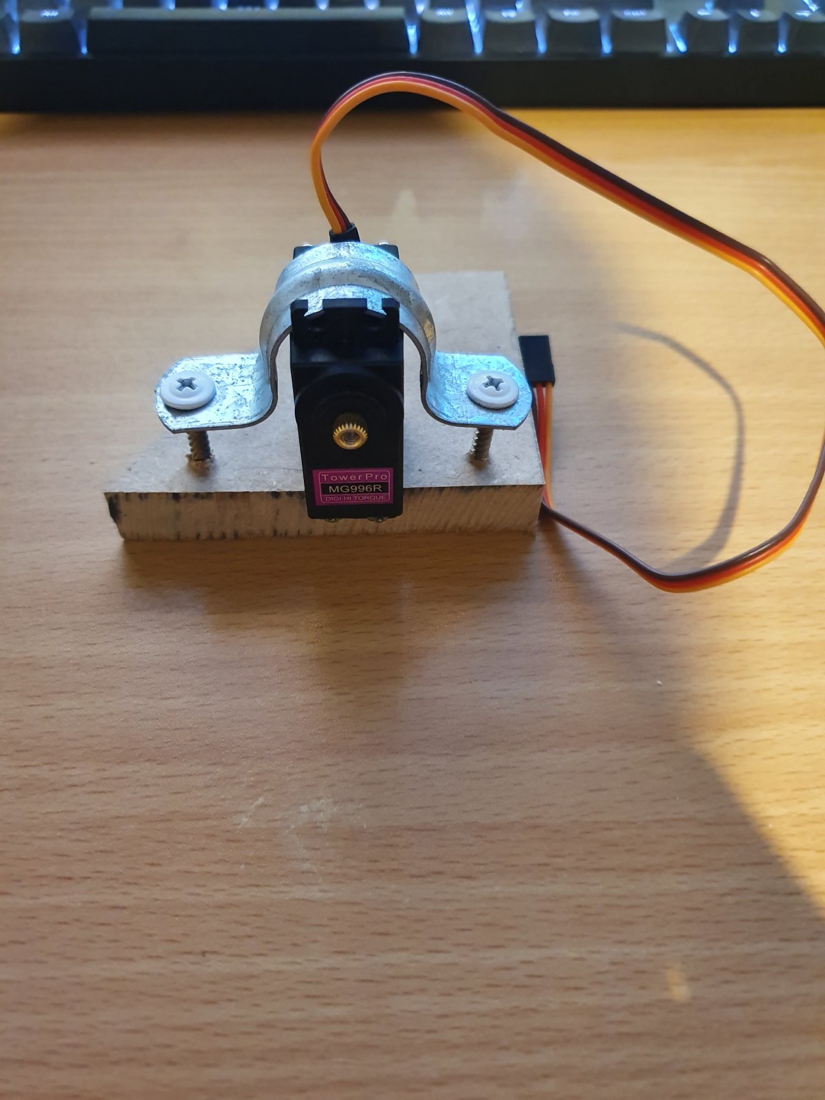

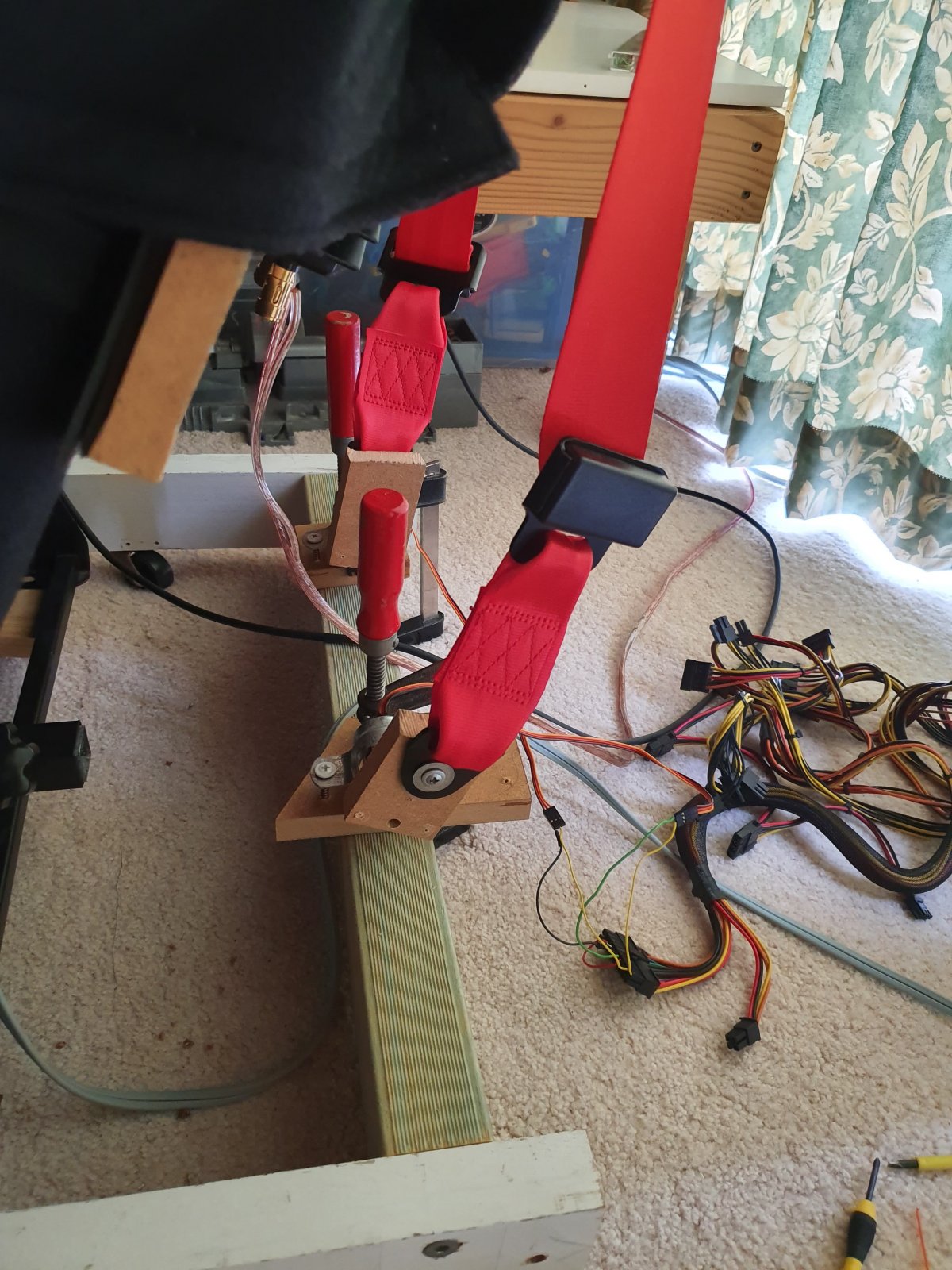

    Managed to get the servo's aligned on both sides of the belt. Feels even better now!
    My next step is to develop a 6v regulator circuit. Currently I'm running these off the 5V rails on my PSU but I can get about an extra 1.5kg/cm of torque by using 6V. Any suggestions on the best way to go about this?
    I'm also planning to 3D print some proper mounting/alignment brackets for the servos so I can screw them in directly to the wooden beam they're currently clamped to.
    Obviously the servo's stall during heavy braking, should I worry about constantly putting the servo's into stall? Or does it not matter because it's only for short periods of time?

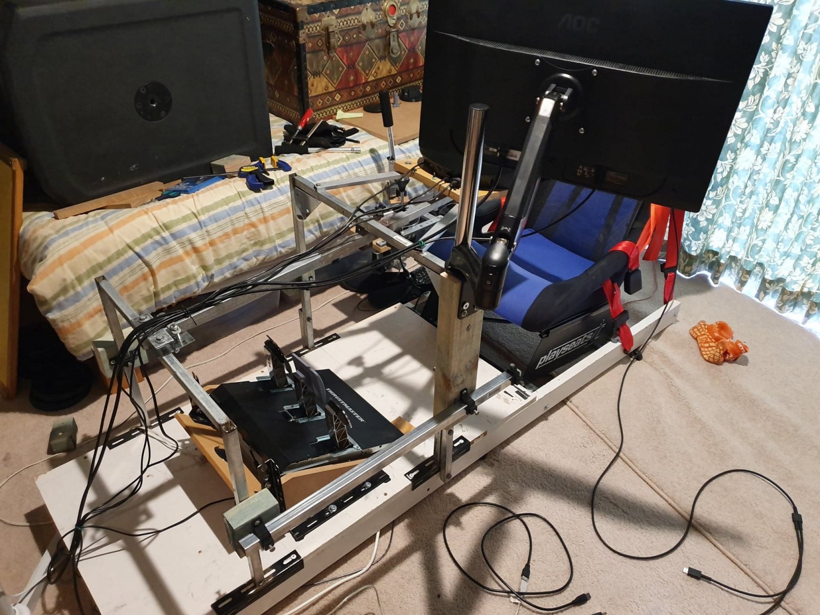

    Do you have pictures of the entire rig?
    Cool idea, hope it works out for you.

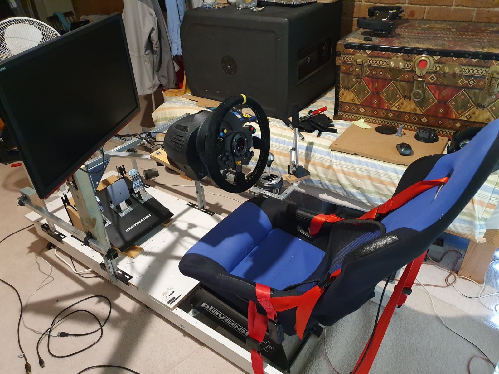

    Here's some pics of the full DIY rig. It's literally just been developed by bolting on parts as I got more and more into sim racing. I designed it so I could adjust everything independently. (wheel height, angle, seat position, pedal position, etc)

    I'm actually quite surprised by the amount of tension these little things are able to provide. It's nothing amazing and won't punch the air out of your lungs but you can feel bumps in the road and braking forces through them. I drove around in LFS for about an hour yesterday and the servos never shut down or backed off from over heating.
    I fully agree that the wiper motors are probably the best way to go, however I got 5 of those servo's for $30 and had everything else to get this setup in a few hours.
    I've been playing with the idea of some stronger 50kg/cm servos.
    (http://www.kingmaxhobby.com/pd.jsp?id=22&nSL=[1,2,4,12,8,9,10,5,6,7]#skeyword=DCS16942&_pp=0_35)
    I think at this point it's probably better to go down the wiper motor route as they'll be faster, quieter, and more powerful.
    I'm planning to build a 2DoF seat mover anyway so I need to learn the wiper motor setup at some point.
    I set them to a 'zero' position in SimTools and attatched them to the servo's at a slightly above horizontal angle. That way deceleration forces result in the belt loosening. I'm using the the heave and sway degrees of freedom to actuate them. The servo's are honestly only moving a couple of degree's once the belts are tight on me (because they're stalling...) but it's enough to give an effect.
    Yup! I've also been thinking about this. As long as I find a spring that's the right stiffness I can limit the total force that the servo's need to exert.
    Another idea is to just soft mount the servo's and let the body/chair/belt/softmount system act as a sort of spring once I have stronger motors/servos.
