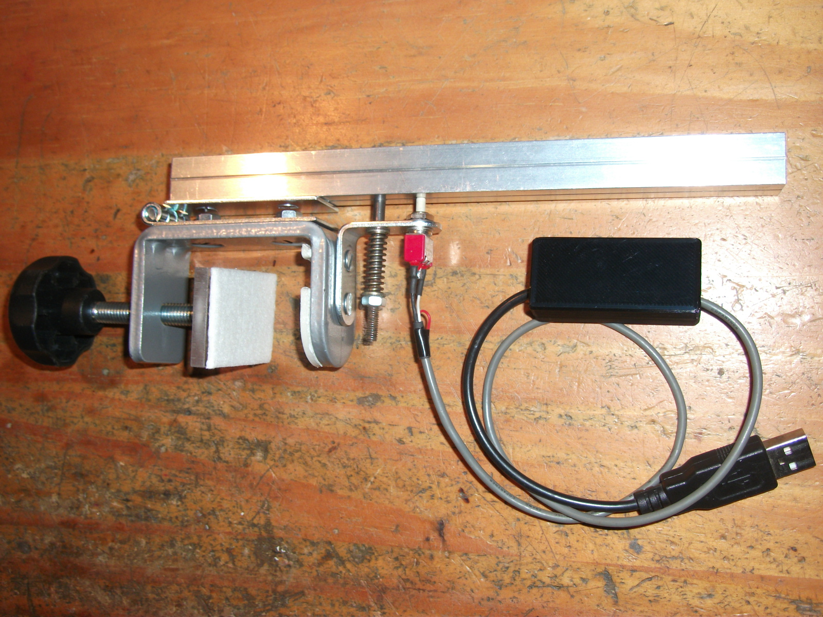

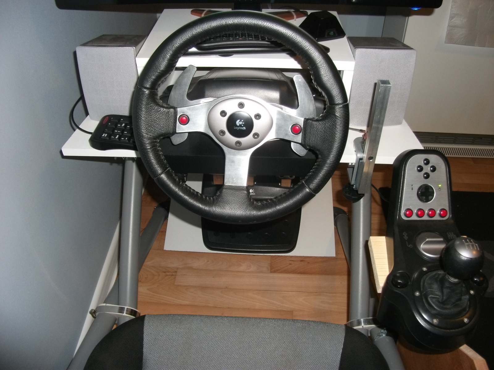

    I needed an E-brake for my simulator, and I don't have much space, so I made this :

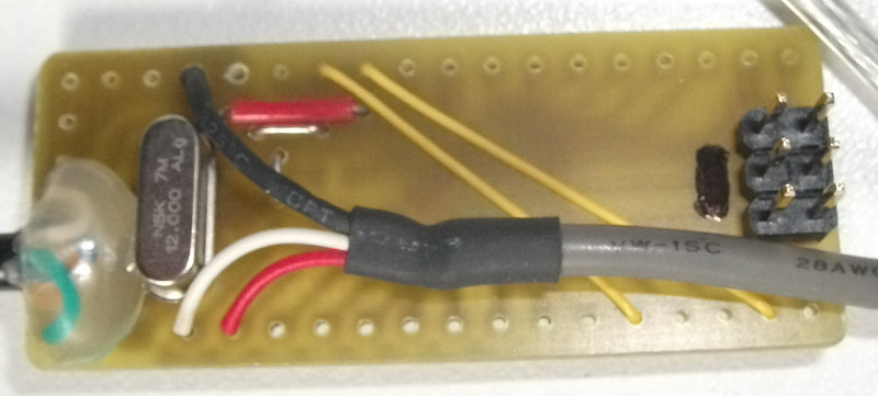

    The normally closed contact of the switch is connected to a custom circuit (the black 3D-printed box) that simulate a USB keyboard.

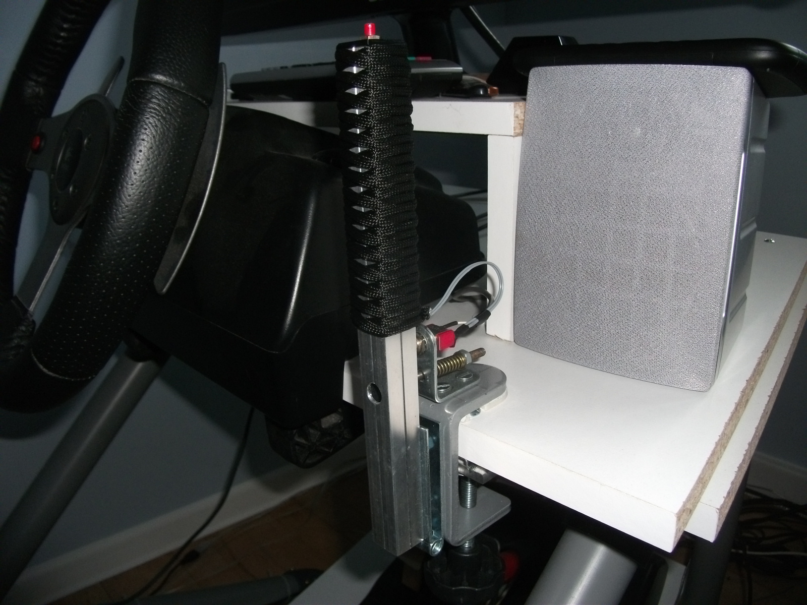

    I made some comfort and aesthetic improvement by wrapping the handle with paracord :
    I also added a button on the top.

    Super, that looks really cheap to make. Can we have a picture of the circuit? How did you get an analog input via keyboard firmware?
  4. Zed
    Apr 4, 2017
    1,040
    USA
    5,842Coins
    +1,043 / 4 / -0
    Don't know how the OP did it in his application, but it's really easy: https://www.sparkfun.com/tutorials/337
