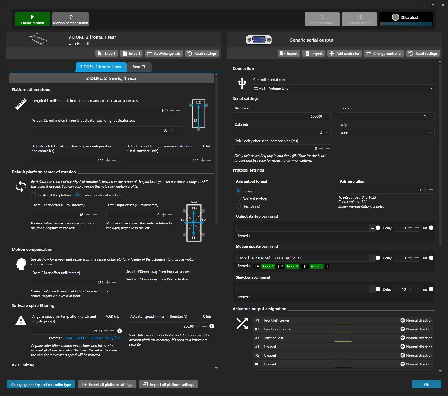

    Wotever has done the unthinkable and released SMC3 support in a very short period of time.
    This is (mostly) working on my DOFreality H3, and it feels incredible.
    Be sure to set axis resolution to 10 bit

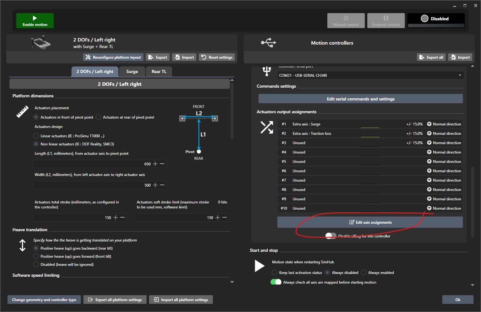

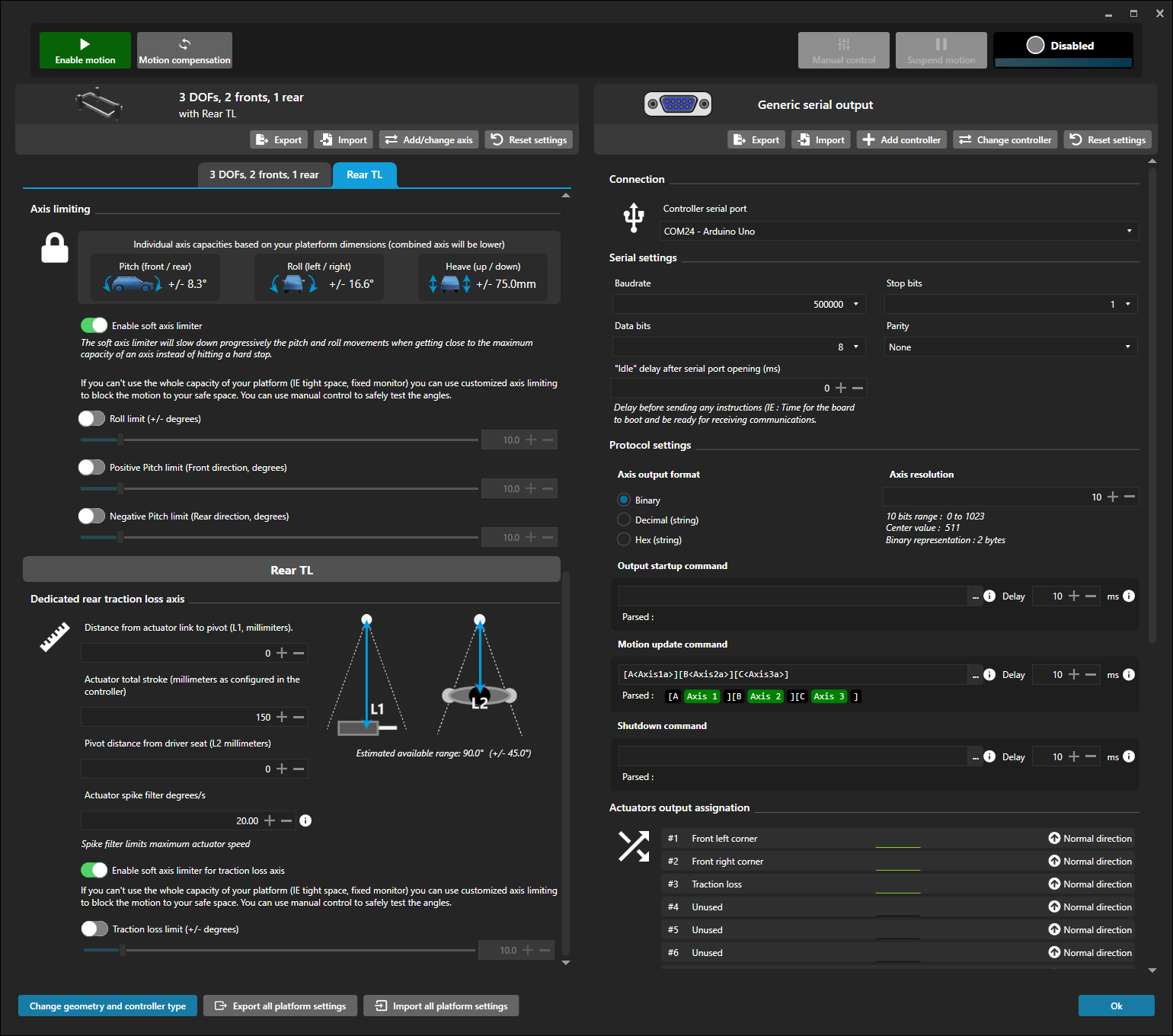

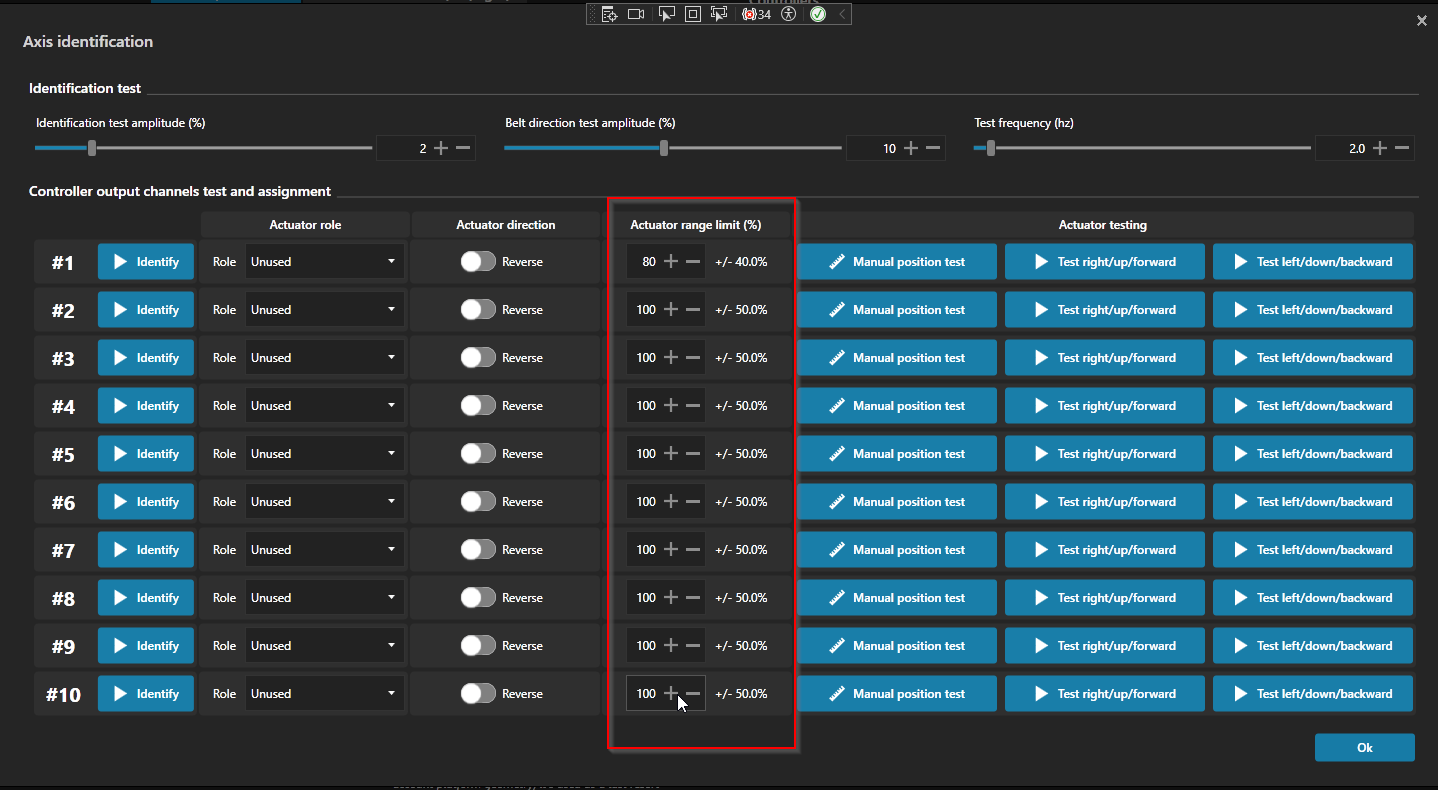

  4. itsumairu
    itsumairu Active Member
    Dec 13, 2021
    203
    Psychologist
    Indonesia
    438Coins
    +90 / 2 / -0
    2DOF, 3DOF, DC motor, Arduino
    This is a great news! thanks for sharing.
    I've been test it, but I confuse how to limit my axis angle movement?
    I got my DIY motion system always off without limit the angle

  5. Silyn
    Silyn Member
    Sep 14, 2023
    40
    60Coins
    +18 / 0 / -0
    3DOF, DC motor, AC motor, Arduino, 4DOF
    I'd recommend joining the discord and posting your config, Wotever has been extremely responsive

  7. itsumairu
    Dec 13, 2021
    203
    Psychologist
    Indonesia
    438Coins
    +90 / 2 / -0
    #update I've contact Wotever and he said that he will add the axis limit in next release. can't wait for it.

  9. itsumairu
    Dec 13, 2021
    203
    Psychologist
    Indonesia
    438Coins
    +90 / 2 / -0
    Yeah, I did every limit setting there, but no axis limit as in simtools that works on my diy build.
    Wotever give me this picture. He will add it to the next releases.

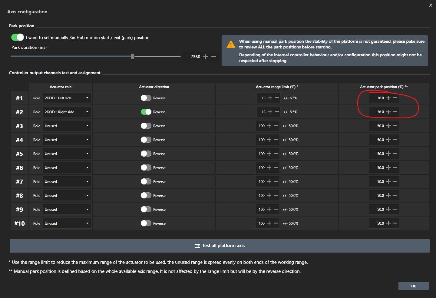

  10. ProjectF1
    ProjectF1 Member
    Jun 12, 2023
    52
    Electrician
    299Coins
    +16 / 1 / -0
    hello, I can't find the settings for the position of the platform at start-up, can you give me the adjustment parameter because I would like, to facilitate access, for it to be in the low position and not in the middle
    thank you, have a good day

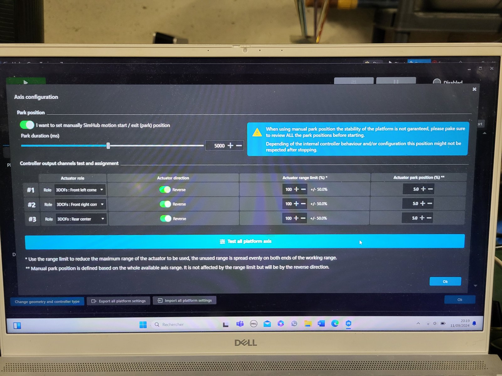

  15. itsumairu
    Dec 13, 2021
    203
    Psychologist
    Indonesia
    438Coins
    +90 / 2 / -0
    yes, you can do it with simhub. there's a section that control the "parking position". just like mine, I can get in and out easily now.
  16. itsumairu
    Dec 13, 2021
    203
    Psychologist
    Indonesia
    438Coins
    +90 / 2 / -0
    This is my rig setup, it move to idle/ready position from "parking" position when the game is start or when the motion is enabled. and if we close the game, it move to parking position again.
  17. ProjectF1
    ProjectF1 Member
    Jun 12, 2023
    52
    Electrician
    299Coins
    +16 / 1 / -0
    thank you very much, I will look at these settings this evening!
  18. ProjectF1
    ProjectF1 Member
    Jun 12, 2023
    52
    Electrician
    299Coins
    +16 / 1 / -0
    I found the parameter for the parking position, thank you for your help
