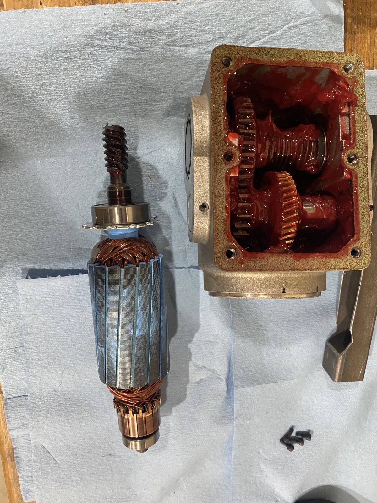

    Well I got the worm gear out of the motor, not sure how I can reduce the backlash. The bearing next to the worm drive has the tiniest bit of play and allows the worm gear to move slightly, if I can push the worm gear closer to the worm wheel that would help, but I can’t think of any way to do that.
    What exactly do you mean by rotating the gear in the wormdrive? I’ve read that some wormdrives have a variable pitch worm gear that can be moved to adjust backlash, I was hoping that was my case but unfortunately it is not. Do you mean turn one of the gears slightly so that the teeth fill up more of the gap in the other gear? That seems like it would work, but I don’t think there’s any way to rotate either gear along that axis, but if anyone has any ideas that would be great. 9B80312F-1AC1-4054-A212-A08D3750F650.jpeg

    What I mean is the worm gear interfaces with a helical cut gear wheel.
    Given the limited range of our rigs one portion of that interfacing gear wheel is always being worn and possible spread, if brass, by the worm gear.
    So a possibility is rotating that interfacing gear so a different potion of it is in contact with the worm gear.

    Your gearbox has a worm drive and then another set of straight cut gears, it is probably the second set of gears that has the backlash
    Can you move them back and forth and see the play ?
    Also the worm drive is only supported on one end by the motor - does it move up and down a bit ?

    There is a small amount of backlash in the straight cut gears and then a slightly larger amount of backlash in the worm drive.
    Yes there is movement of the worm gear while the casing is off, but I think I can adjust the angle slightly by forcing the angle of the casing when tightening.
