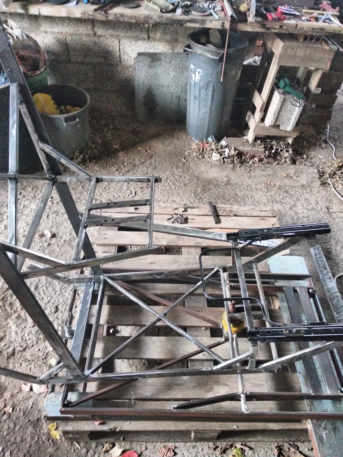

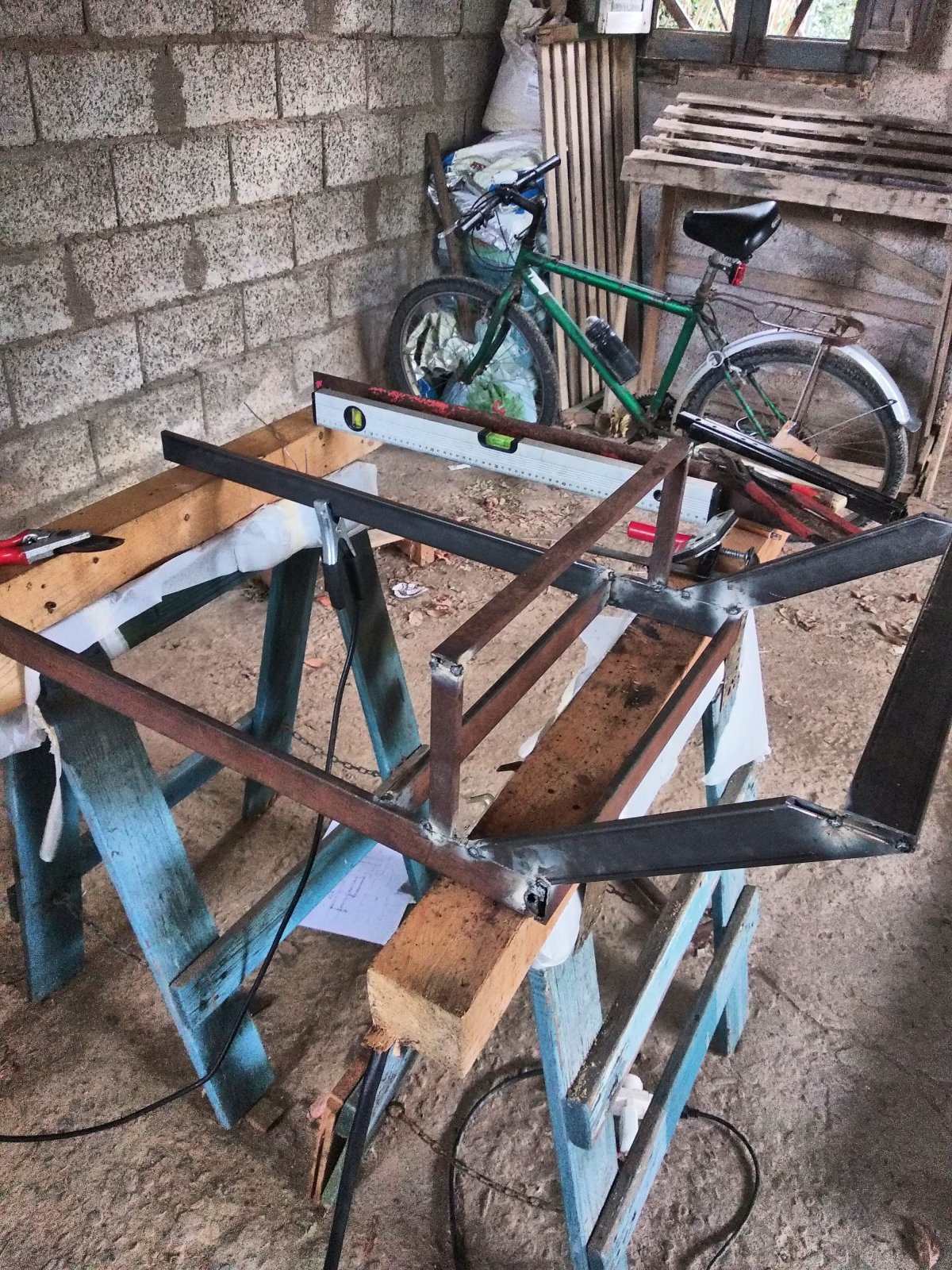

    One goal is to have an adjustable seat, it is ease of access. Knowing how to weld metal, the structure will be made of steel. I chose rectangular tubes 40 by 10 and 20 by 10.

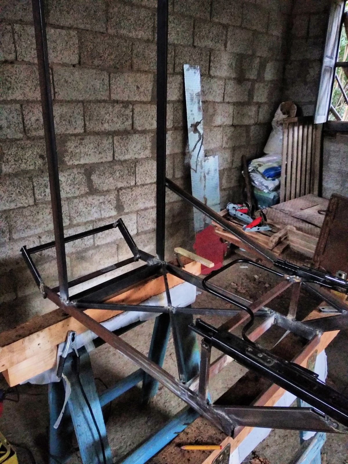

    Another requirement would be to create a frame where the steering wheel pedal and the screen move together. I tried projects with fixed runner and I didn't like them.

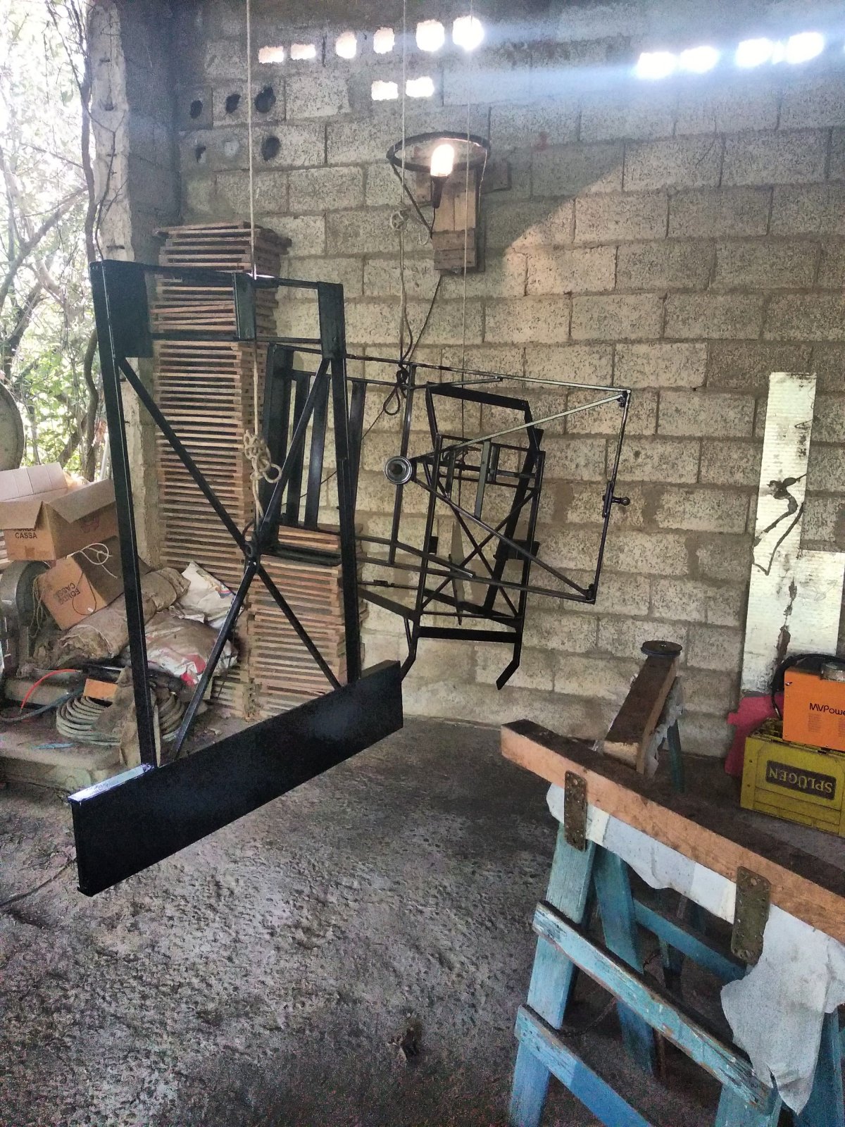

    Here are the photos of monitor, steering wheel, pedals, seat structure :

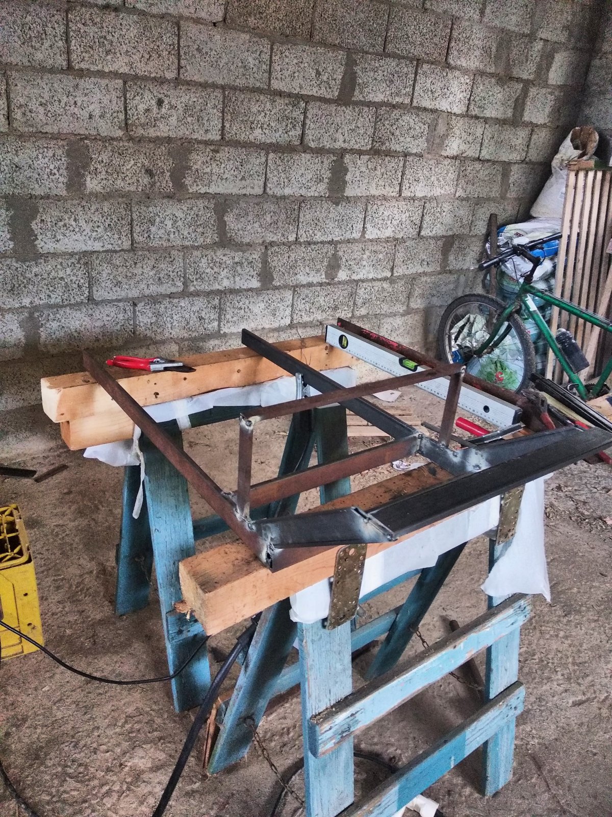

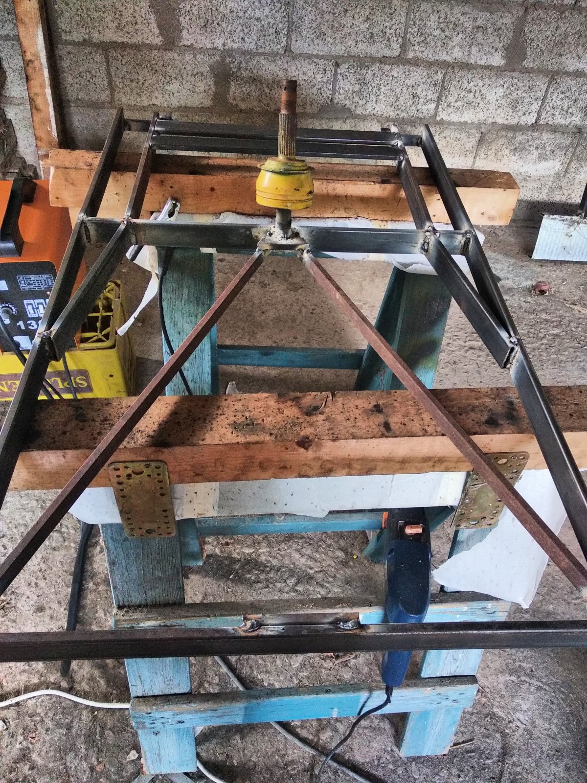

    This is the frame for the third movement. The three engines and electronics will be fixed. The third motor is fixed between the v-bars.

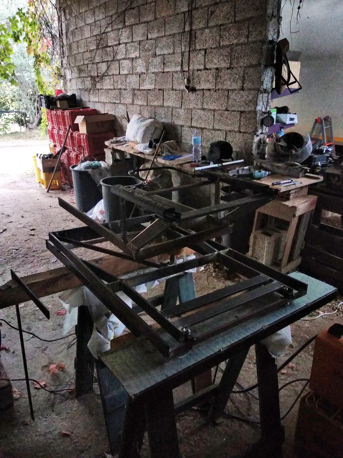

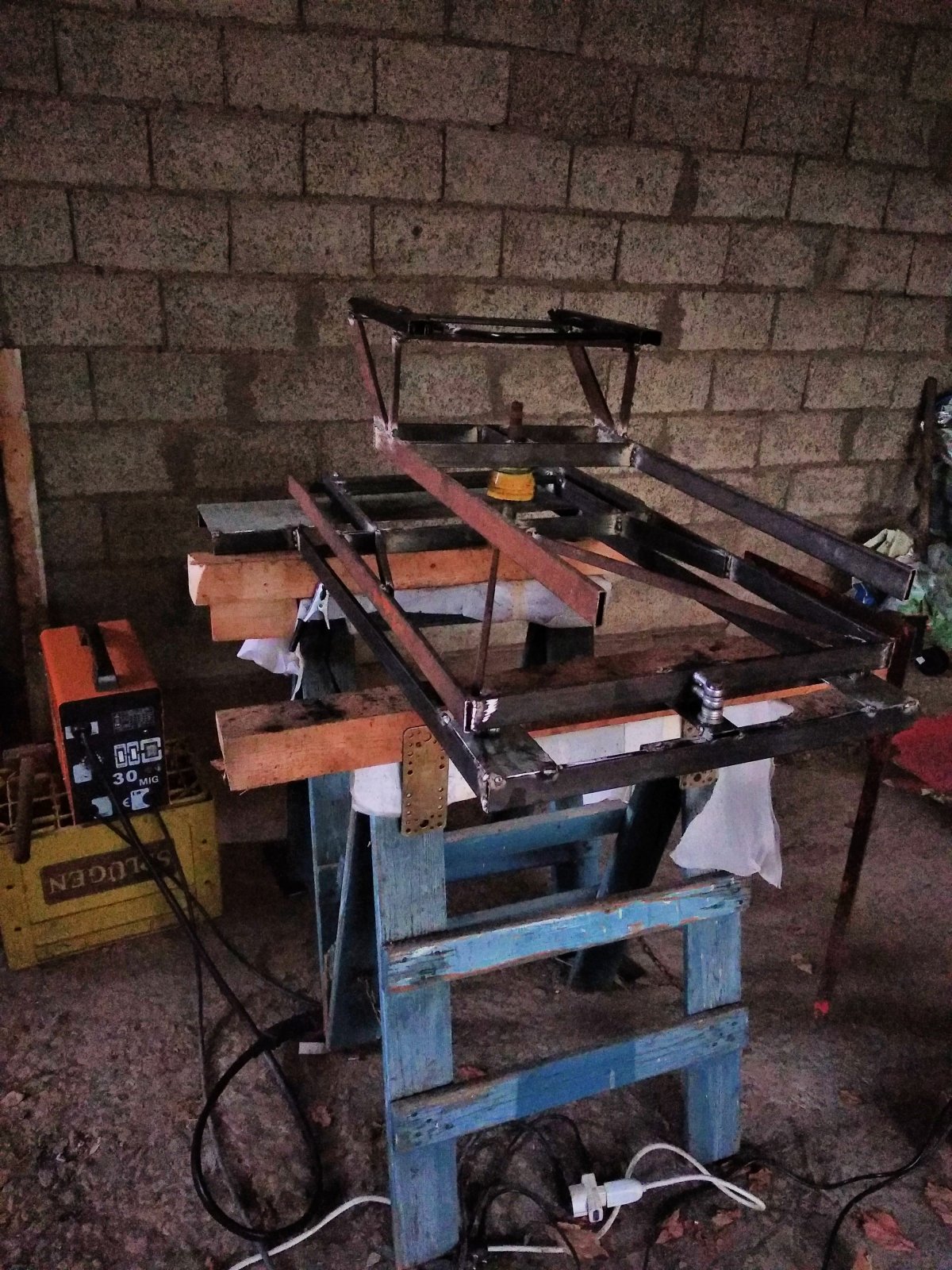

    in these images you can see the platform on which the simulator runs (yaw, extra movement).

    In these images they show the steering wheel holder that can be adjusted in height. The frames are finished.

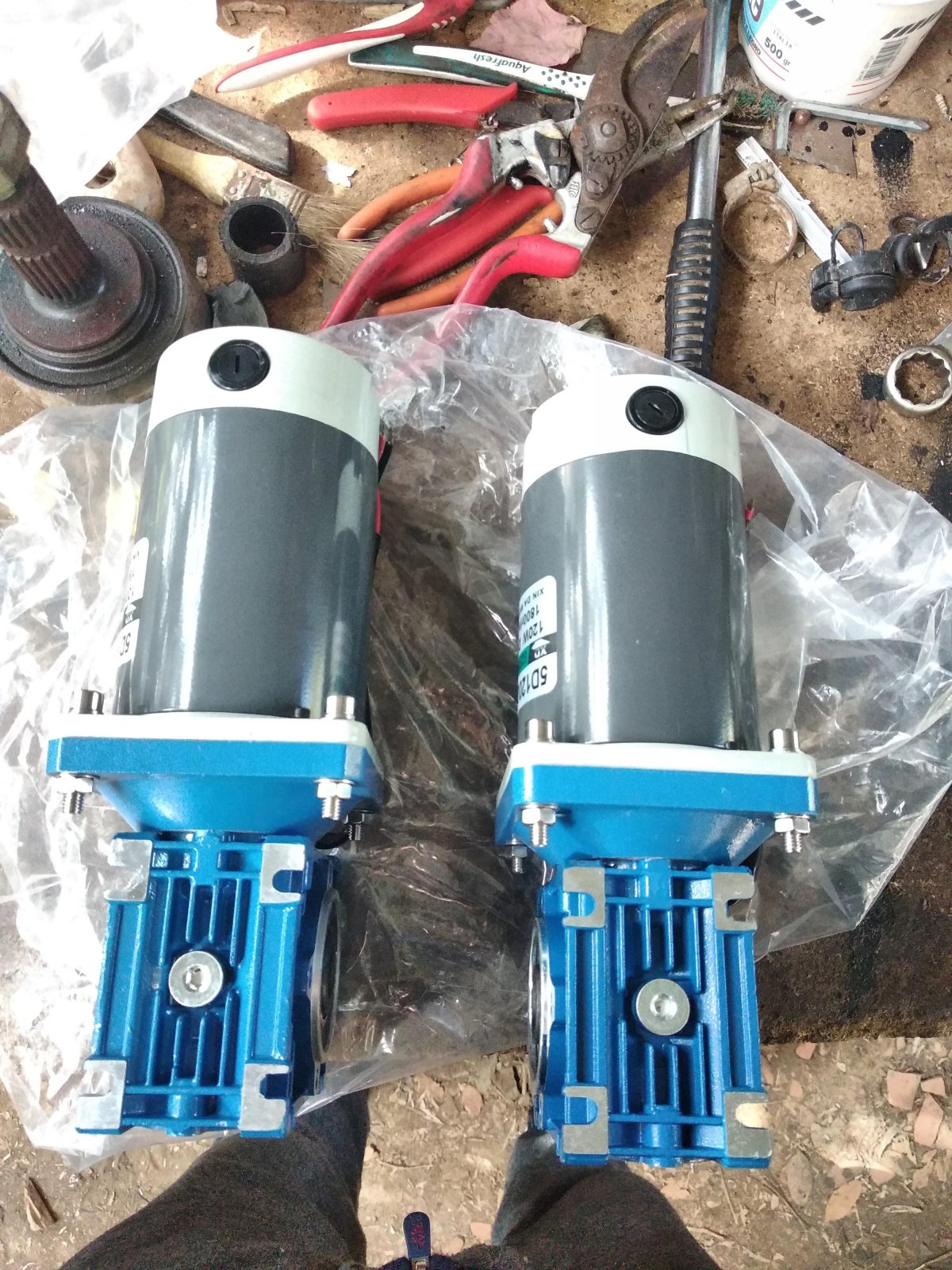

    Engines are the first to arrive !!!!
  13. Overclockersmania.it
    Overclockersmania.it Member
    Oct 24, 2014
    99
    Cagliari, Sardinia
    20Coins
    +25 / 0 / -0
  14. Overclockersmania.it
    Oct 24, 2014
    99
    Cagliari, Sardinia
    20Coins
    +25 / 0 / -0
    Next weekend I will try to assemble them and create the arms. They will be 6 cm long from hole to hole.

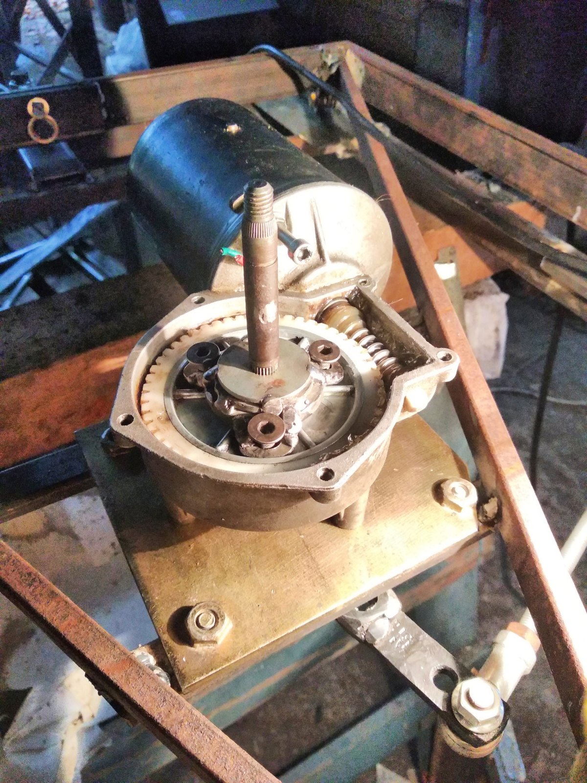

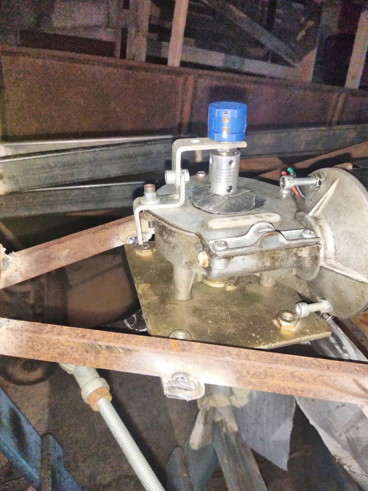

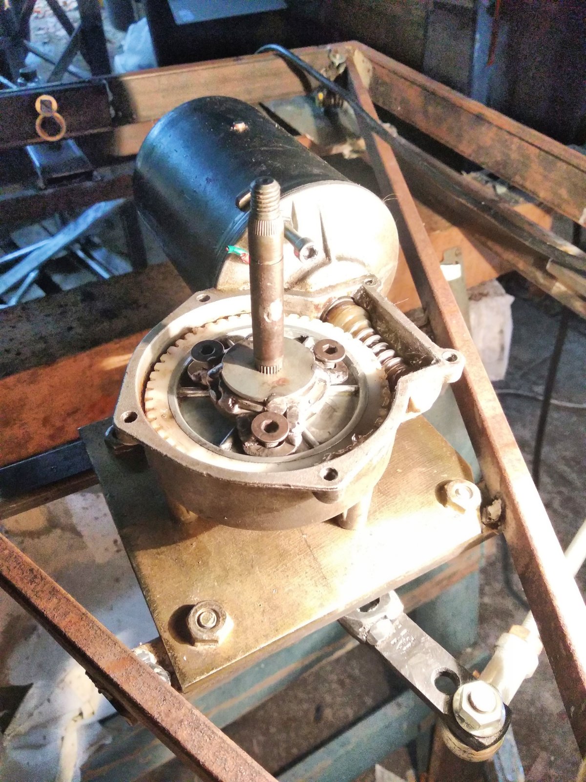

    the third engine is one of a truck wiper found at the car wrecker, in the photo the modification to have the output shaft for the potentiometer
  16. Overclockersmania.it
    Oct 24, 2014
    99
    Cagliari, Sardinia
    20Coins
    +25 / 0 / -0
    Realizing the parts so that everything is in axis took time, and a lot of filing !! Even if I use an articulated joint, these potentiometers are delicate.
