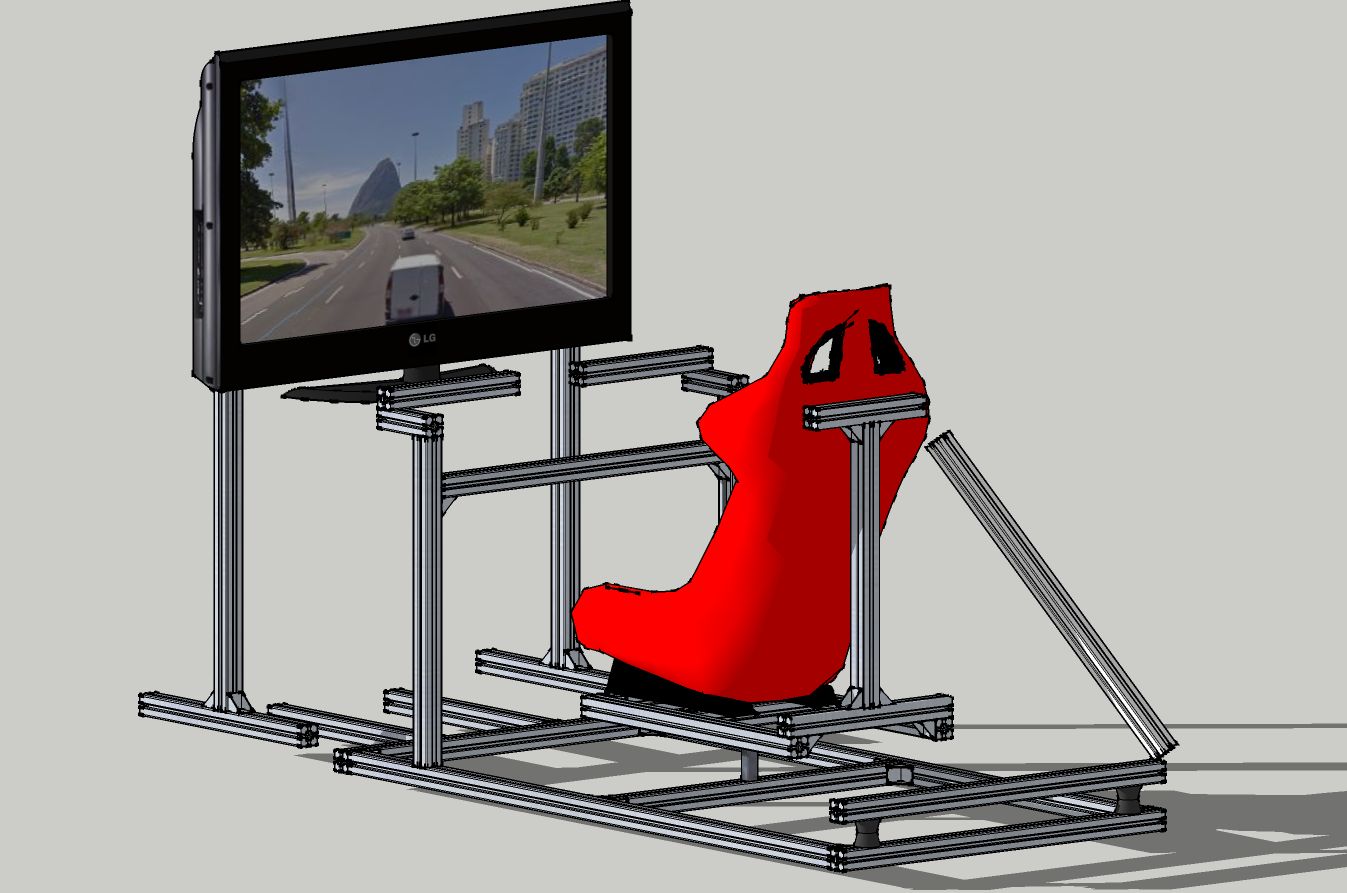

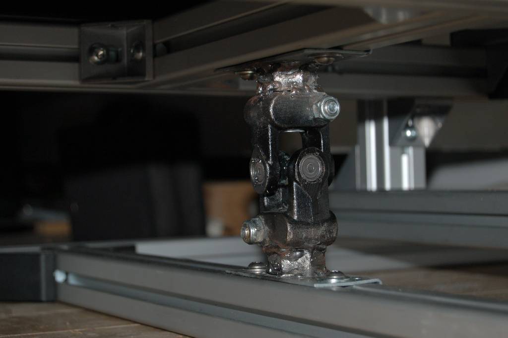

    For the moment, this is the status of my project in Sketchup (I'll post my model when it's finished)
    - 2DOF motion racing sim with SCN5 and a U-joint: waiting for the last parts (a few pieces of profile, the SCN5s, Silent Blocks) to add motion to the cockpit, expected in the next few days. (yay at last !!!)
    - TV Support with Alu Profiles : done. (that was easy, one has to love those Alu Profiles !!!)

    Only one suggestion ... Assuming that you will reproduce your drawing, you should try to lower your screen height for more immersion. With this monitor size you could set it to match at least the center of your wheel or even the bottom...

    i agree with bleco with the screen.you can use the fanatic wheel with x-sim profil.make many better
    ffb vor dirt.

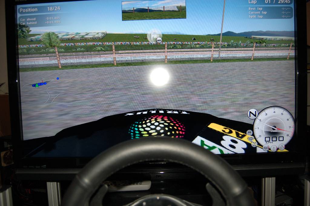

    The TV in the Sketchup drawing is a bit off (didn't see that, tx btw), here's it looks in reality (from a lower and closer angle + realistic perspective): TVvue.jpg
    I can assure you the immersion factor is there :p

    Is that a 42 inch ?
    Would you mind posting a pic from behind the wheel/seat so we have a better idea of your point of vue ?
    Thx!
    Bleco

    Hello Bleco,
    Yes that's my 42 (107 cm).
    I can't take pictures right now because the rest of my profiles arrived today and I'm rebuilding the structure. As my seating position is 8cm lower in the new config, I'll have to readjust the monitor too (which isn't a problem due to the modularity of the alu profiles, damn I love them :))
    What I can tell you is that my eyes were approx. 8 inches from the top of the screen. Lower than that and the wheel is viewed higher than the hood (in the hood view that I prefer).

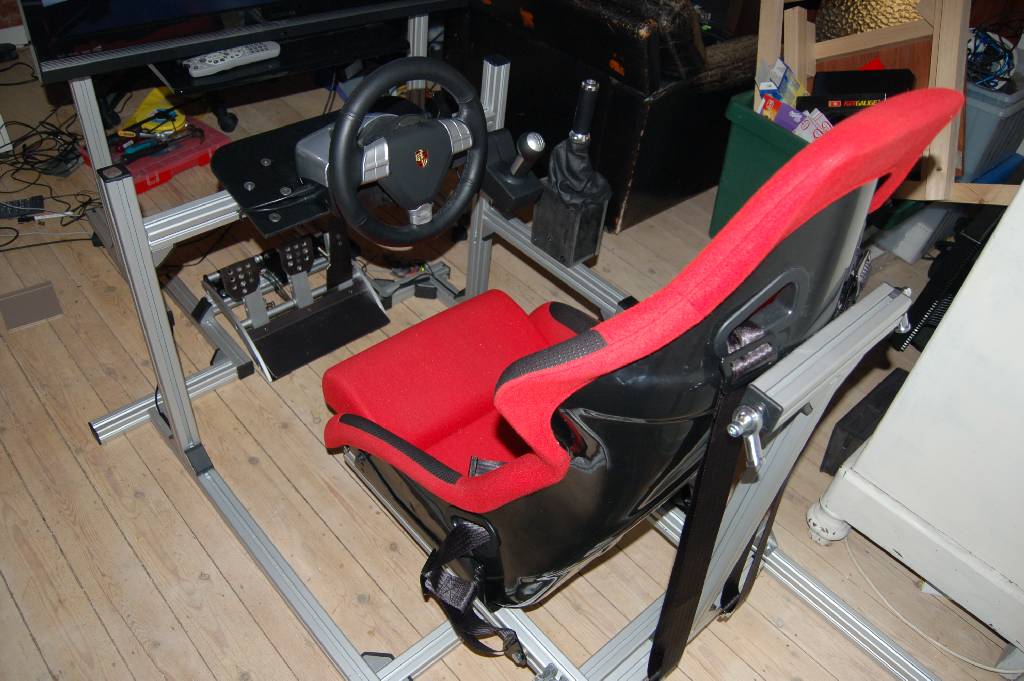

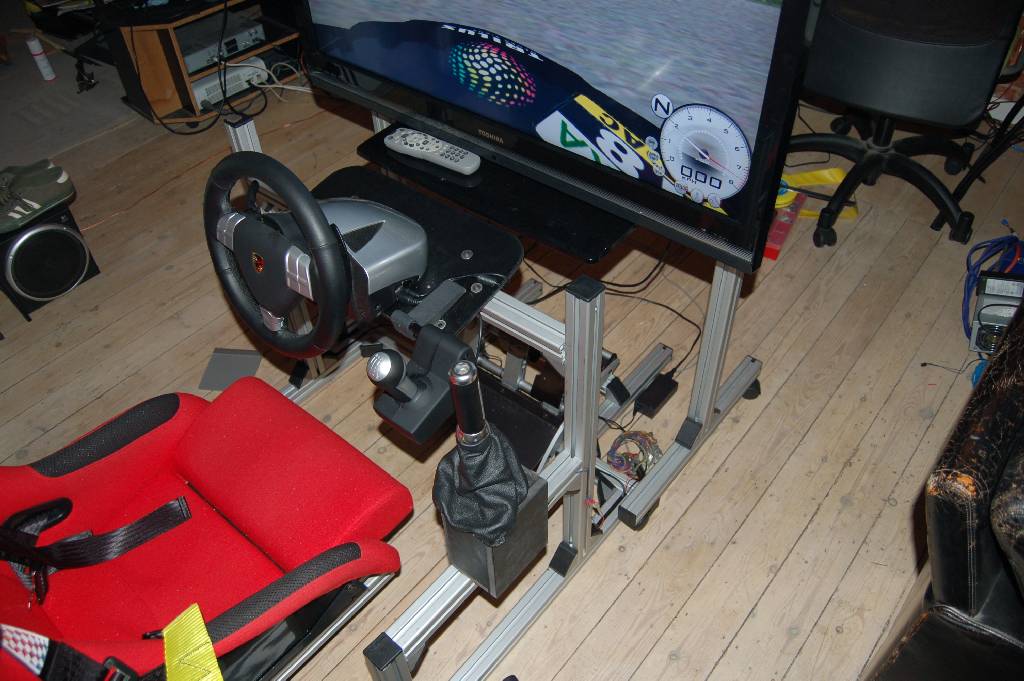

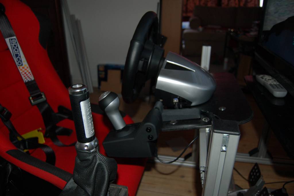

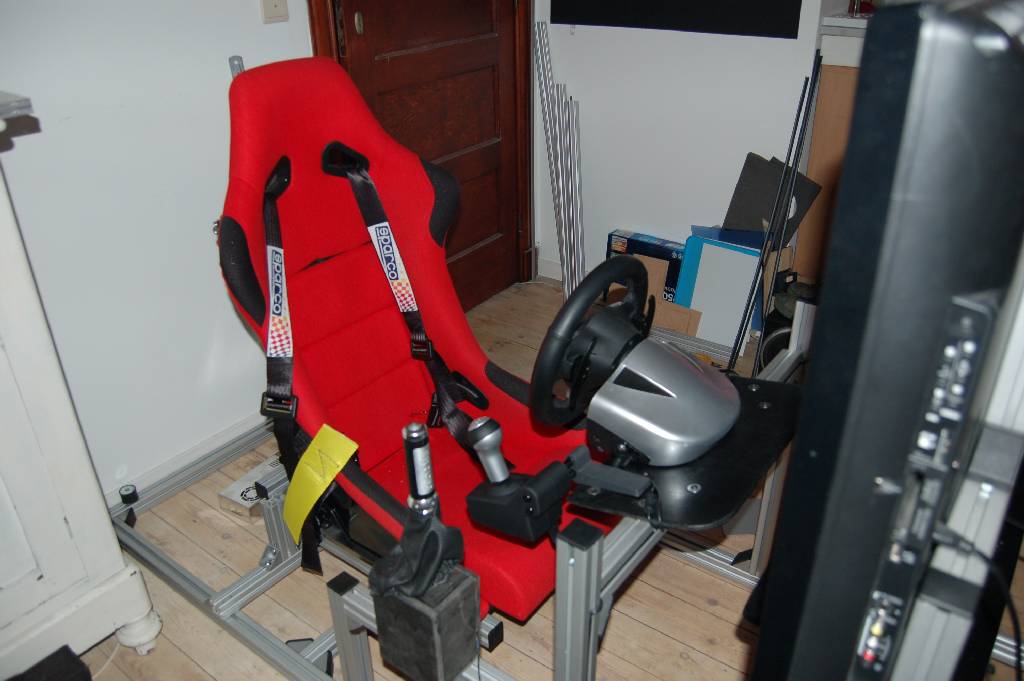

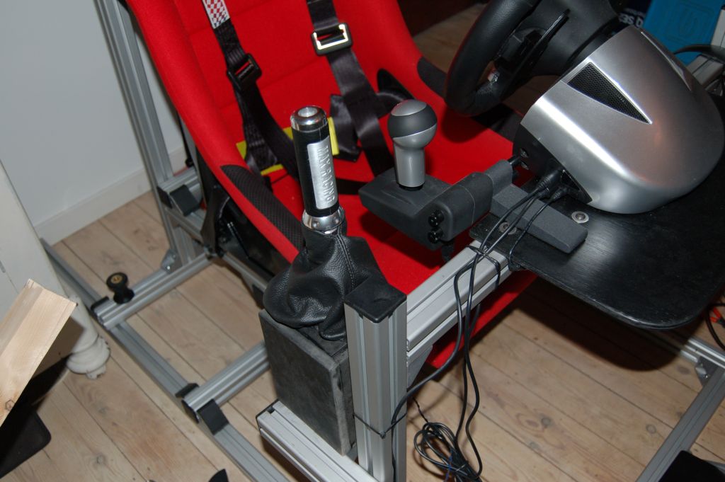

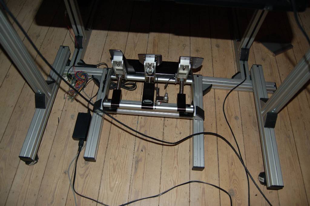

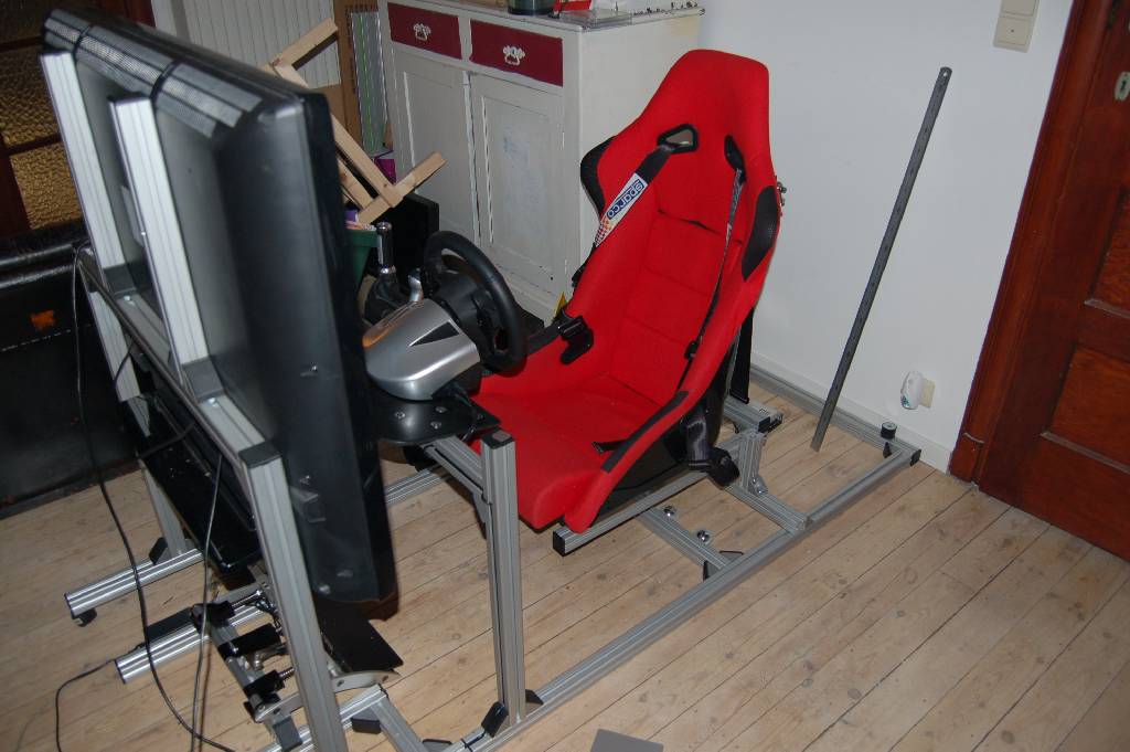

    Ok, big pictures update...
    First, the driver's view. I guess I'll lower the TV a little bit more (5 to 10cm).
    Then the whole sim...

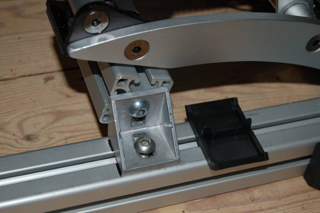

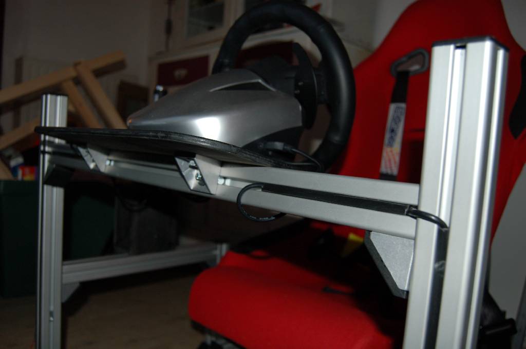

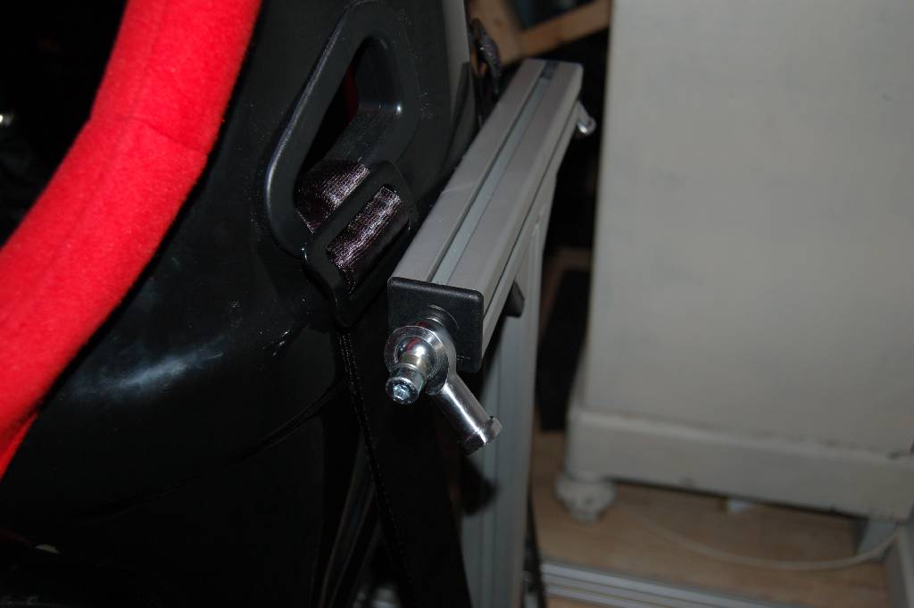

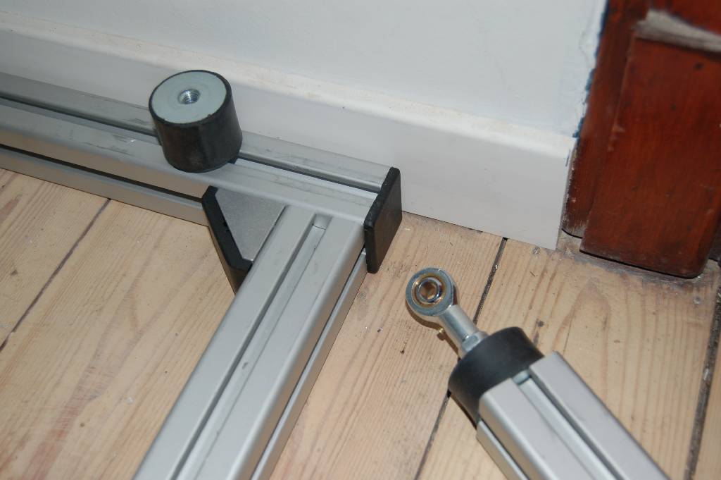

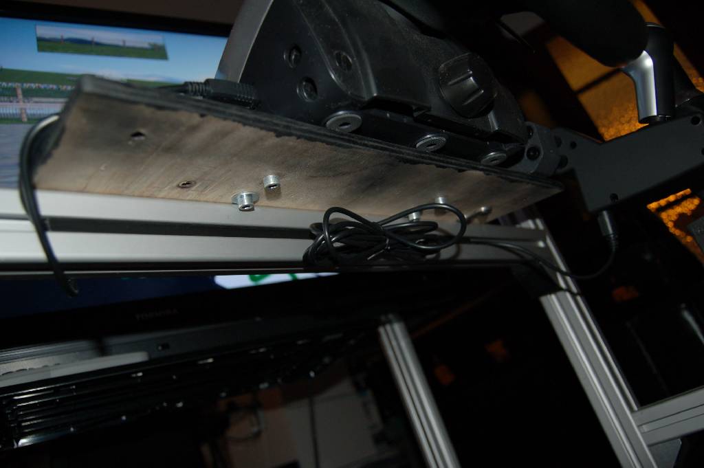

    And a few details...
    This is still largely under construction, pictures are not indicative of the final product ;)
    Feel free to comment...
    Cheers,
    Silly(c)One.

    Hey!
    looking very good! and thx for the screen pic ;-)

    I lowered the TV by 10cm and I think it's as low as it can get without missing half the screen behind the wheel :p
