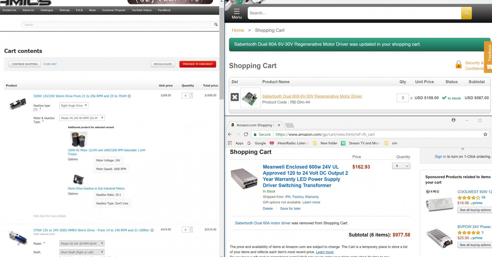

    Parts Shopping 1.JPG shopping around, not sure which motor would be the best bet though...

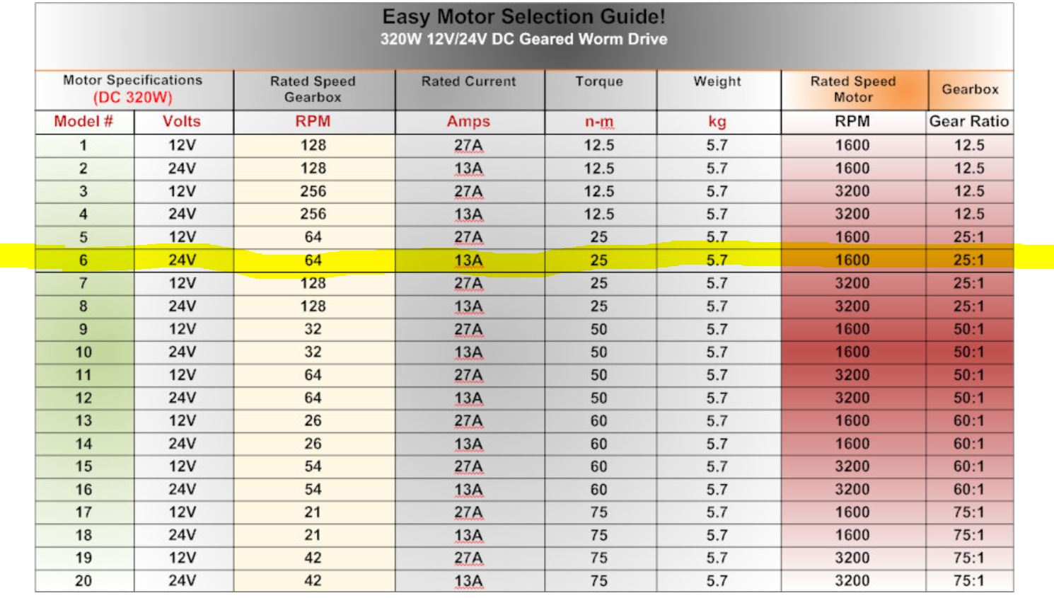

    320w 24v 64rpm@25nM, or 375w 24v 28rpm@65nM

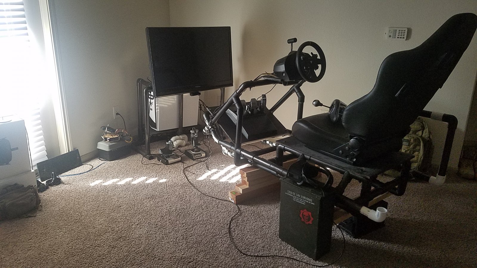

    So I'm looking at turning my pvc pod..

    using these motors driven by Sabertooth Dual 60A 6V-30V and powered by Switching Power Supplies 600W 24V 25A (thanks again Zed!)

    Why choose the lower speed motor in that list? Line 8 has the same specs but doubles the rpm, so would result in much faster sim speeds.

    NOORBEAST! hells yeah bro, I've gotta be blind as a bat! Yeah faster speeds for sure, I was envisioning 400mm/s for better realism. 40mm ctc lever arms, 100mm arms. Now, I had thought on going linear based off of @wannabeaflyer2 diy design, but figured the base platform may exceed space constraints. Definitely appreciate the thoughts and wisdom of those who have been there n done that!
