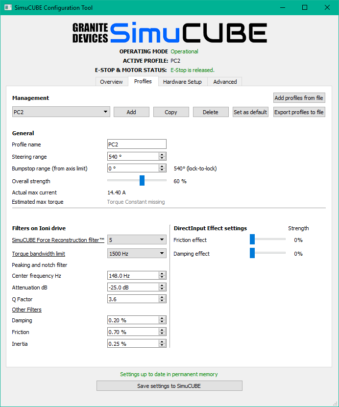

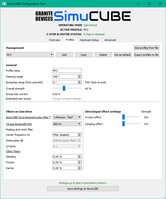

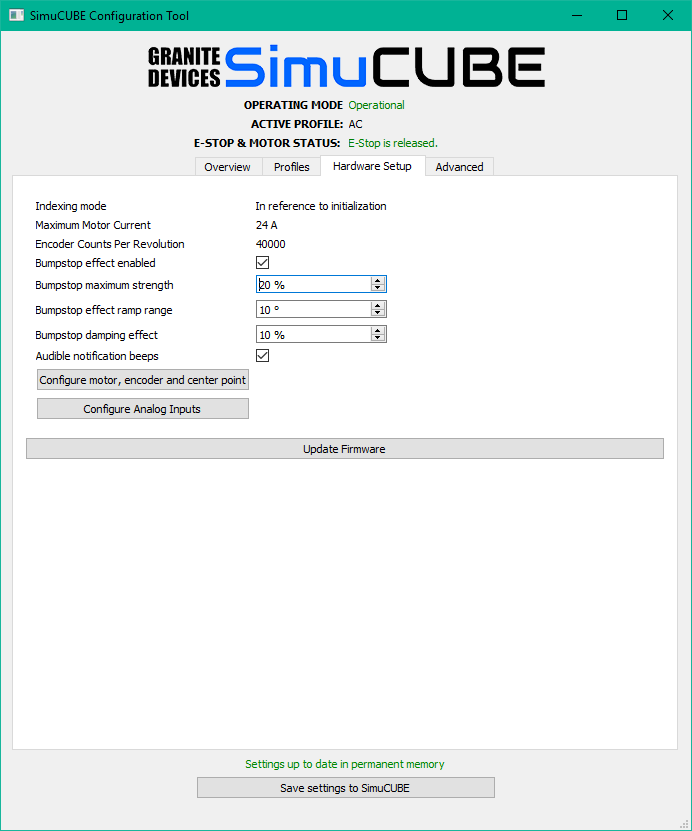

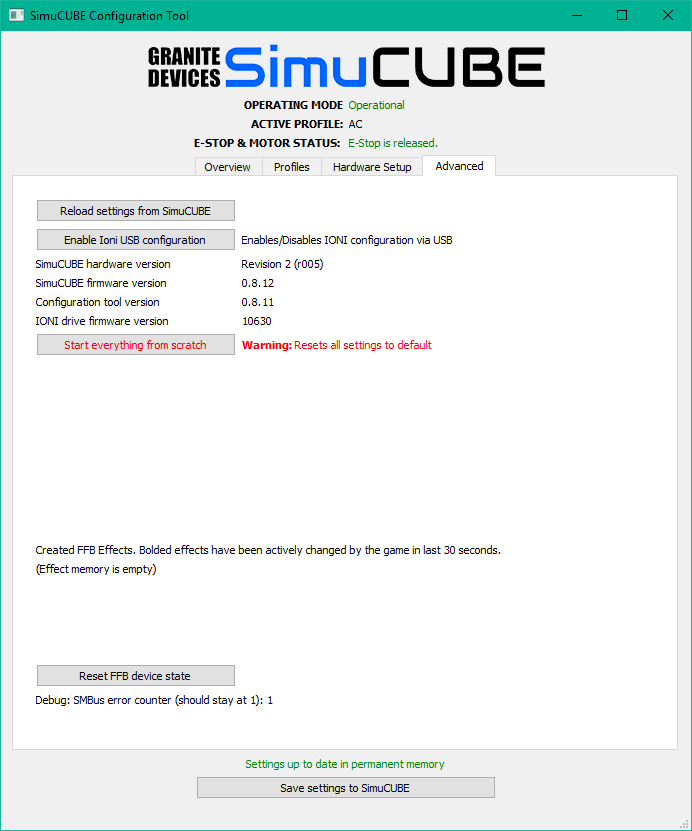

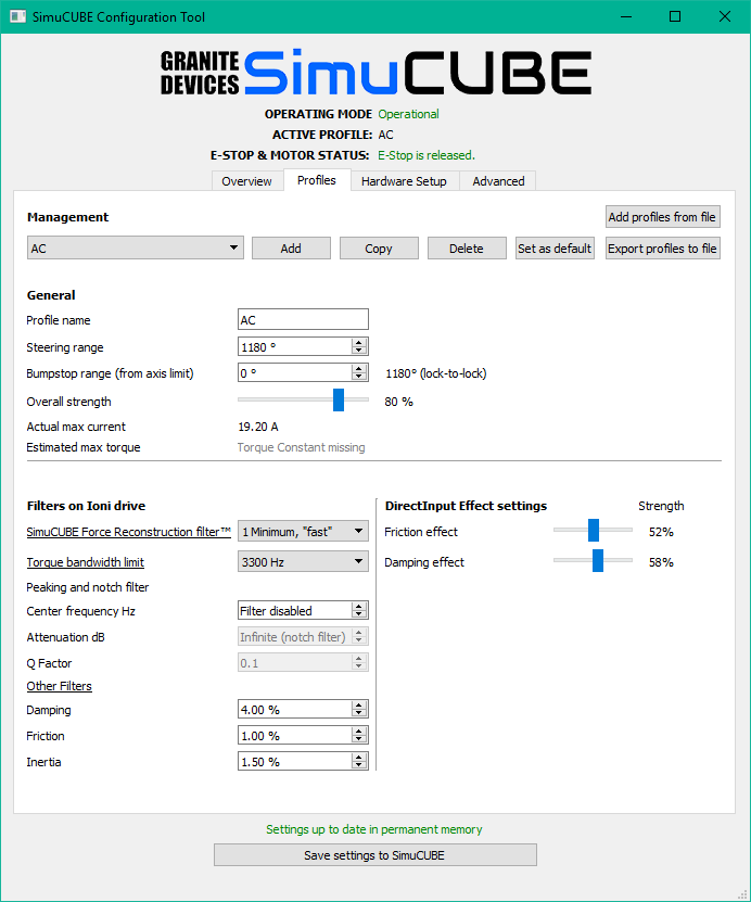

    In this thread we are going to share any SimuCUBE profil settings. Of course it makes a big difference which wheel we are using, be it the Mige, Lenze etc - but for a first approach you can try out these settings, if they will satisfy you. If you may find out better settings for your hardware, please upload your profiles including a short description of your wheel components.
    My wheel: OSW Big Mige, IOINI HC, SimuCUBE
