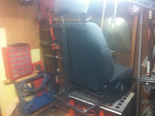

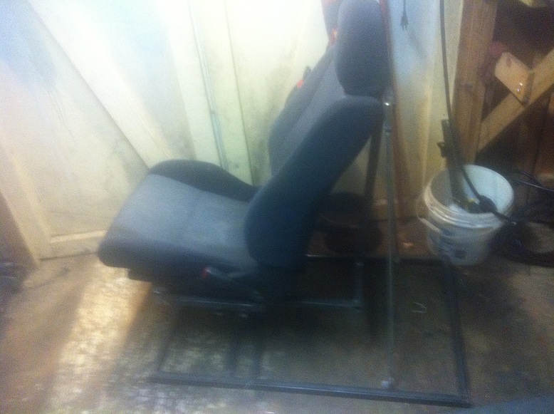

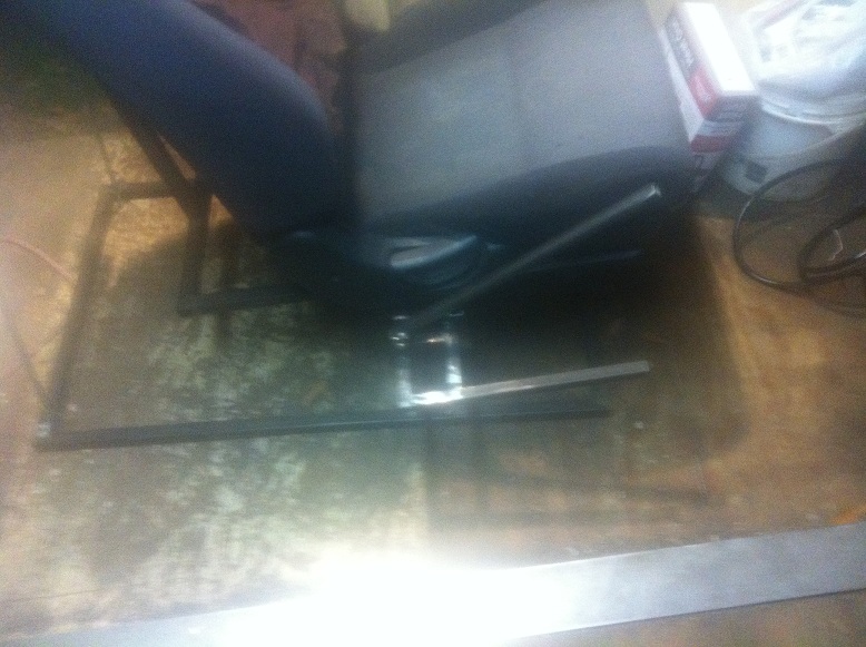

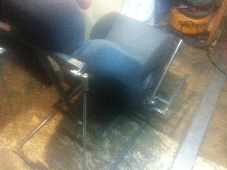

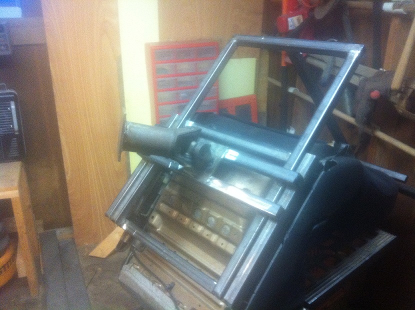

    So I have started the frame!
    Gonna use the Pololu Jrk 12v12 for my first go round with Wipers.....decided i need a chop saw to cut metal, the cut off blades just arent doing straight enough cuts for me...atleast i have the frame size's now so i can make a template.....
    To find the balance point I was going to place a piece of steel tubing under the middle and look for balance forward and back....any other suggestions to this?

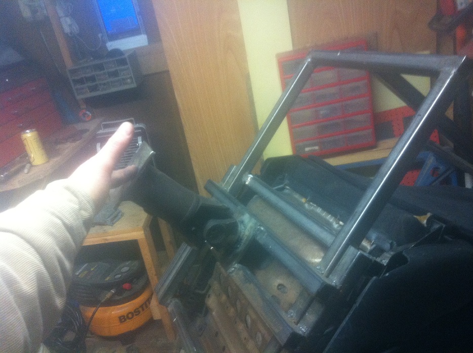

    I have the drive shaft cut and welded, but is there a theory around height of the drive shaft or joint?
    Update
    Today I added the pivot and built the base stand, still need to create the corss members that connect the base to the pivot

  6. gbeef
    gbeef New Member
    Feb 23, 2011
    0Coins
    Looking good what did u end up using for the povit joint.
  7. shannonb1
    shannonb1 Well-Known Member
    Mar 12, 2008
    1,107
    Sales Intelligence
    Virginia
    8,909Coins
    +598 / 5 / -0
    universal joint from an old jeep i had, cut it to about 10 inches, i dont want to be on the floor, this way i dont need the arms to keep me from twisting like a bushing.

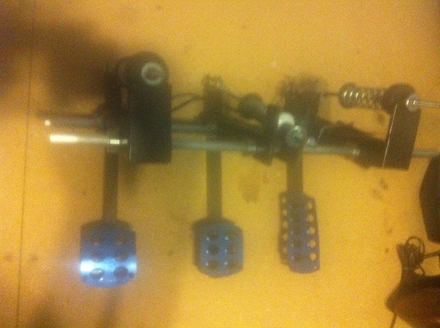

    Have all the parts ordered for my CST DIY pedals using my own style.
    Welded up the base, have the rods, need to weld the pieces that will go on the back of the T for the joints to attach, weld the motor platets on, what for my JRK, leobodnar in the mail, 60kg load cell in the mail, springs in the mail.
    Then the process to build the wheel stand, pedal stand and foot rest as well as the shifter and shiter support.
    Im going to use a couple designs that are out there and combine their best features, i have it in my head so well see how it turns out.

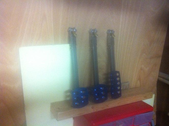

    as for today i took 3/16 flat stock, 4 and cut it to size for my pedals. Almost got all 3 done but didnt get to the gas pedal.
    As for my goodies in the mail today my leo bodnar LC came! and my Springs and POT arms came as well.
    All I am waiting for now is the load cell which should be here in a week or less. I imagine if shipped soon after I orderd, it may be here tomorrow.

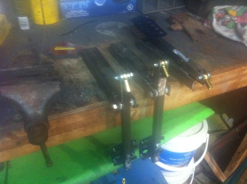

    Ok almost done with the CST DIY Pedals, did my own mods, the load cell is from china and taking over 20 days to get here, i will mount this to the wheel stand as it will not move like the wheels. Also added the rod ends as well as a piece on the side that is removable for shiter/hand break or for flight stick and yoke to be easily changed out. Going to use the leo board and a pot for the hand break as well as a shifter i plan to make, this too will use 6 or 7 of the leo boards available buttons, has 12 total. thinking about installing a turnable key for the ignition switch.
    Im wondering if the pololu delays which are based on that vhns30 of whatever, that is the part they dont have, willl be delayed by the issues in Japan. I have reached out to the simexperience as I think I may change my plans and try to get scn5 actuators.
    pics or nothing has happened...

    Pedals are done and have been for about 2 weeks, they are pretty awesome if I say so, much better then my stock pedals. I have my power supply, today I went and got my wiper motors, its funny to go to the auto parts store and say, ok this is going to sound odd but I need 2 wiper motors, the same, and I need them to be reasonably priced. You get funny looks. Well the second store I went to the lady thought I was a genious and it was helarious, told her what I was doing, we found that a 2000 ford escalade has pretty good sized motors and they were only 49.99 at autozone, had to pay a 10 dollar core charge, but I wanted new motors. Well when I was leaving she was like come in the back with me real quick,hmmm, she had this box full of bolts, threaded rods, washers, all kinds of shit and said do you want this stuff for your projects? so of course I took all the goodies, she said to come back every 3 weeks or so and she would have more stuff that was either mixed up or returns and I could have it! Jack pot.

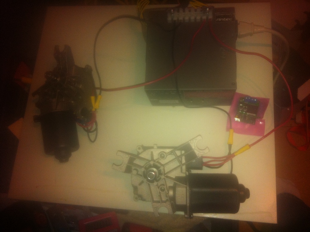

    ok so didnt have too much time but I have the motors, i wired up the temporary power supply, meaning lets see if and how long it works. In the picture its powering both motors showing 12.8 volts at the posts. I have the Jrk's shown in the picture and need to mount them. I plan to Mount a plate to the power supply and the jrk's to the plate. I wired a 5volt to my binding post so that I can wire a fan to cool the Jrk's. I have one POT but the other is in the mail. I will need to figure out the wire length needed for them and then wire them up. I was able to get the part number of my motors, and then go to the website and see the pin out. I made jumpers to all of the correct pins to get the high speed going.very pleased. I hope to be finished by next weekend as the seat is completed, just need to wire the hand break and weld on the motor mounts.
