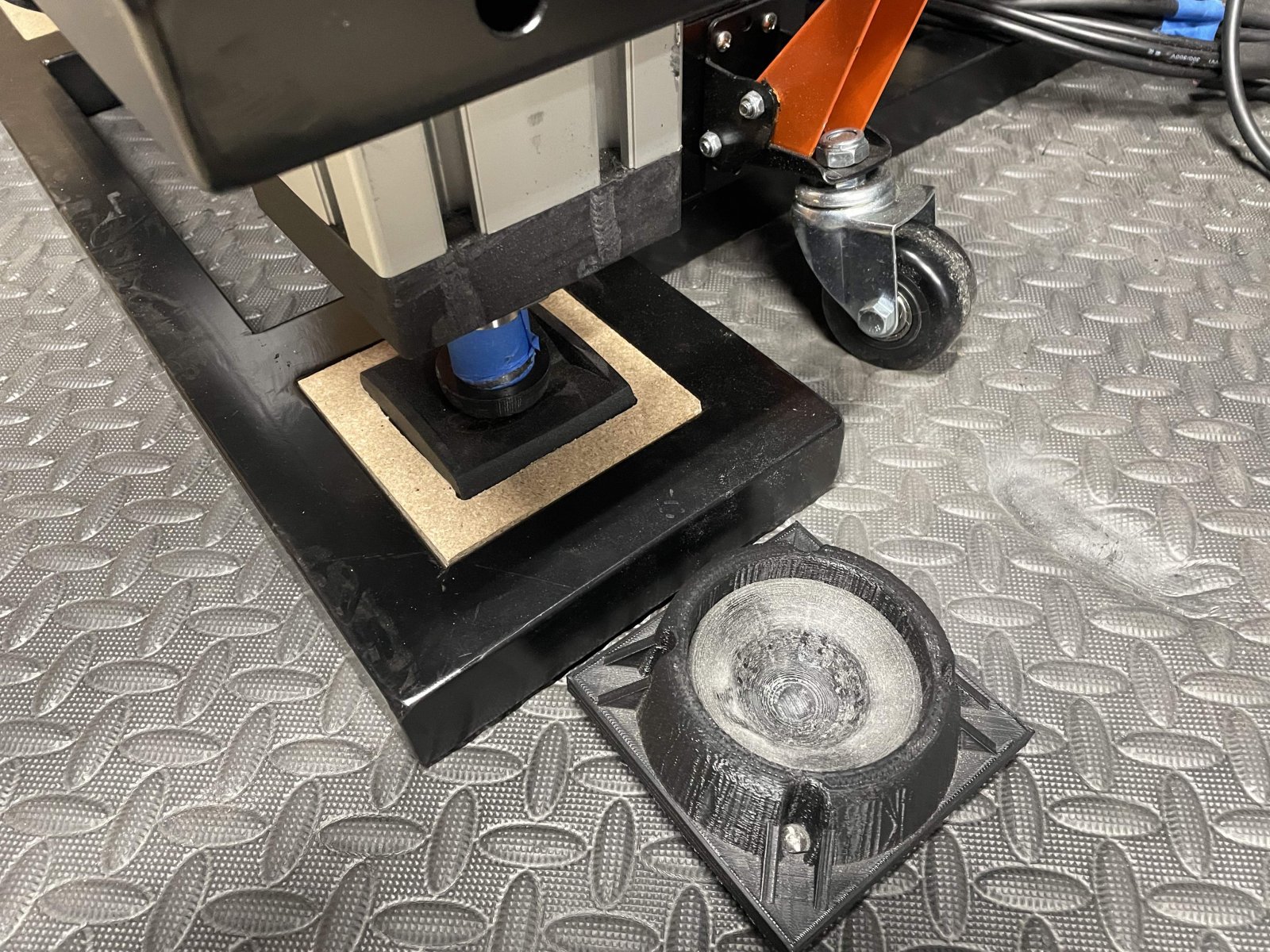

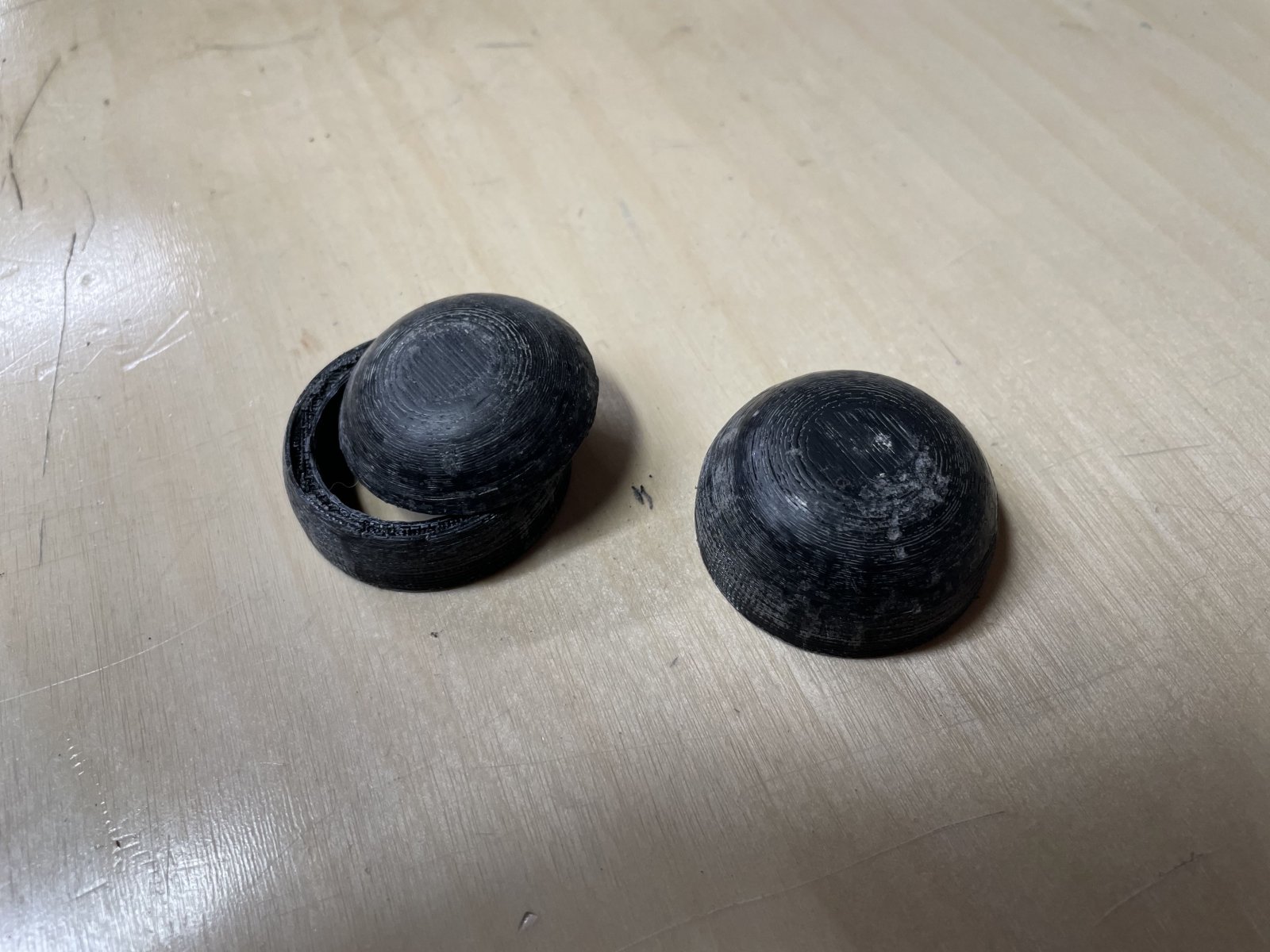

    After getting tired of my rig jumping around I built a base (with retractable casters to roll it around) and printed this "foot" kit: https://www.thingiverse.com/thing:3446630
    After breaking the cups, I added some reinforcements and those have been fine, but now I'm breaking the feet.
    I also don't like how "creaky" it sounds with the 3d printed layers rubbing against each other (no matter how much I've sanded both sides to make them smooth).
    Does anybody have a sturdier solution? I'm getting close to having something machined out of nylon, but that's going to be pricey, so I'm looking for an "off the shelf" solution.

  4. FourOff
    FourOff New Member
    Oct 16, 2018
    29
    37Coins
    +28 / 0 / -0
    Tried them out on the floor and soooo much better.
    Just made some temp holders out of MDF to fit them on my base frame, recessing a space for them so they are less likely to move. Hopefully will have some time to try it out tonight and see if it will stay put. My only worry is the shorter walls compared to my old cups (on the right) might let it walk off the frame.
