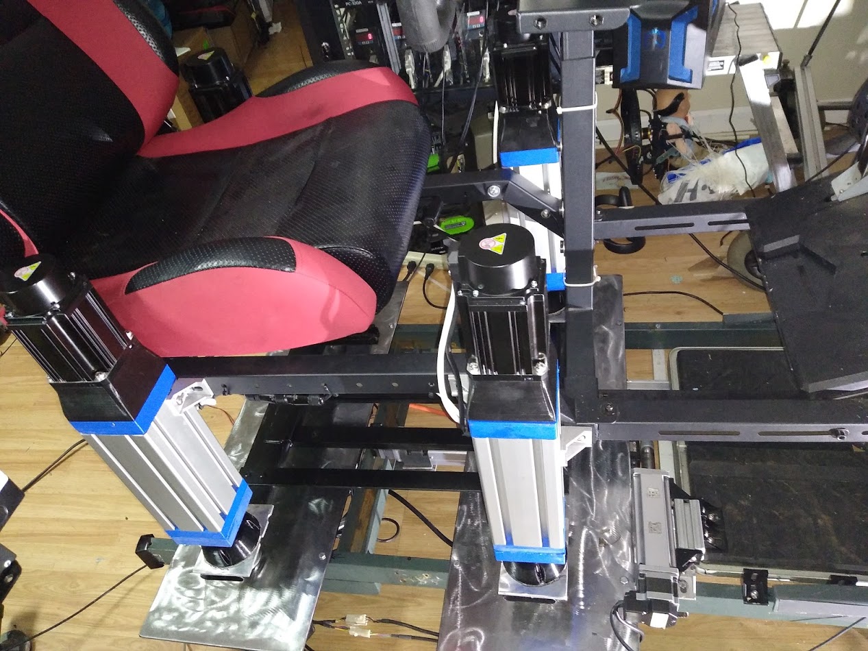

    @Pojo I just built a set of SFX 100 actuators. I am in Ohio so you could order the profiles from the same distributor as myself. I got the profiles from them in under a week and the total cost was under $200 .
    The SFX100's are very popular and I felt with so many posts covering their construction I did not bother creating another build thread.
    However I did find much of the information I needed scattered about the internet as the design has progressed in the last few years.
    If you need any info/help just let me know. I built mine less than a month ago so things are still pretty fresh in my mind....
