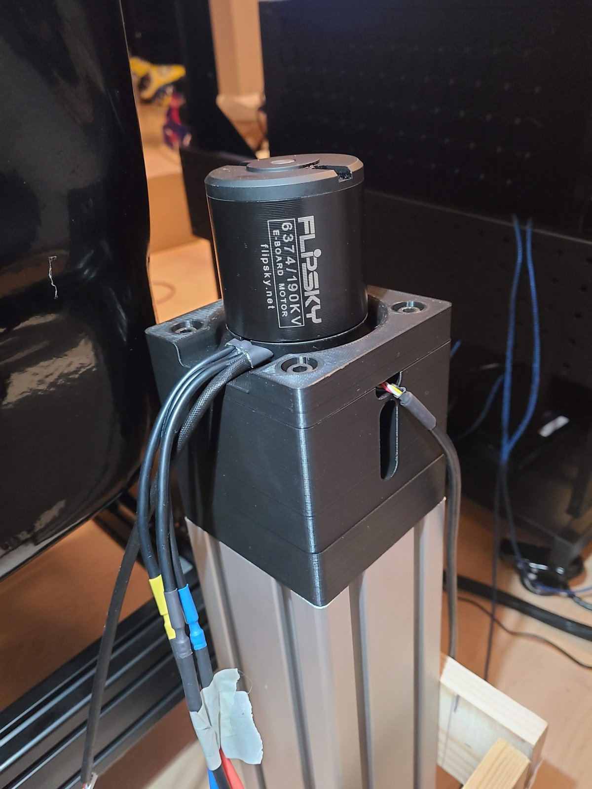

    For the motion system I decided on using an SFX-100 concept but have been adapting it to use brushless motors and Odrive as the controller. I did this partially as a learning experience not necessarily because it's the cheapest or most ready-made option out there. It has been quite a learning experience for me and so far I the design is looking like it's going to work out quite well. I ran into EMI issues as expected but so far have beaten them back. I'm hoping to go farther by adding a CAN communication layer in the future but I'm not there yet.

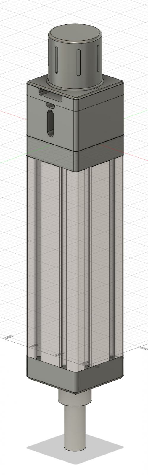

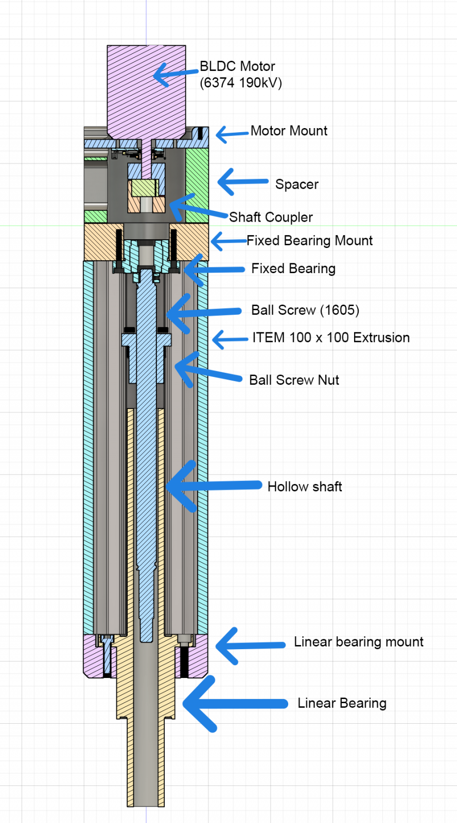

    The actuators are pretty standard SFX-100 design with a few modifications to make them 150 mm travel.
    • 300 mm long ITEM 100x100 extrusion for the main housing since that was easier to source for me in the USA. (I also tapped the extrusion directly and used larger bolts as advised in the SFX-100 guide).
    • Extended the hollow shaft to 320 mm to accommodate the extra travel.
    • Extended ball screw to 300 mm to accommodate the extra travel.

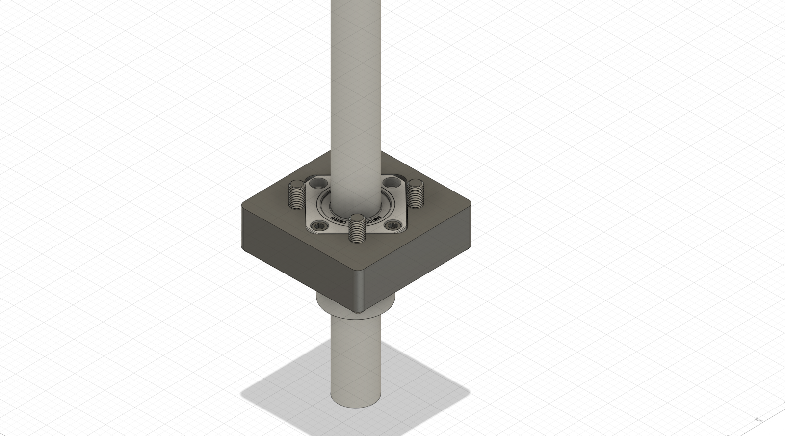

    • I modeled a new linear bearing mount to invert the linear bearing so that it fits inside for a more clean appearance and sits flush against the extrusion. I saw this mod somewhere else, I didn't come up with the idea.
    • Driven by Odrive 3.6 56 Volt version - more details on this below.
    • I (re)modeled ALL of the 3D printed components so that I have control over them as I wanted in Fusion 360 and I could manage tolerances and dimensions more directly than scaling someone else's finished models.

    In a future post I'll include a more detailed BOM and costs. For now, here are a few drawings and some of the key components (this is definitely not a full list).

    Actuator_overall_crop.png Actuator_section_view_annotate.png Linear_bearing_mount.png

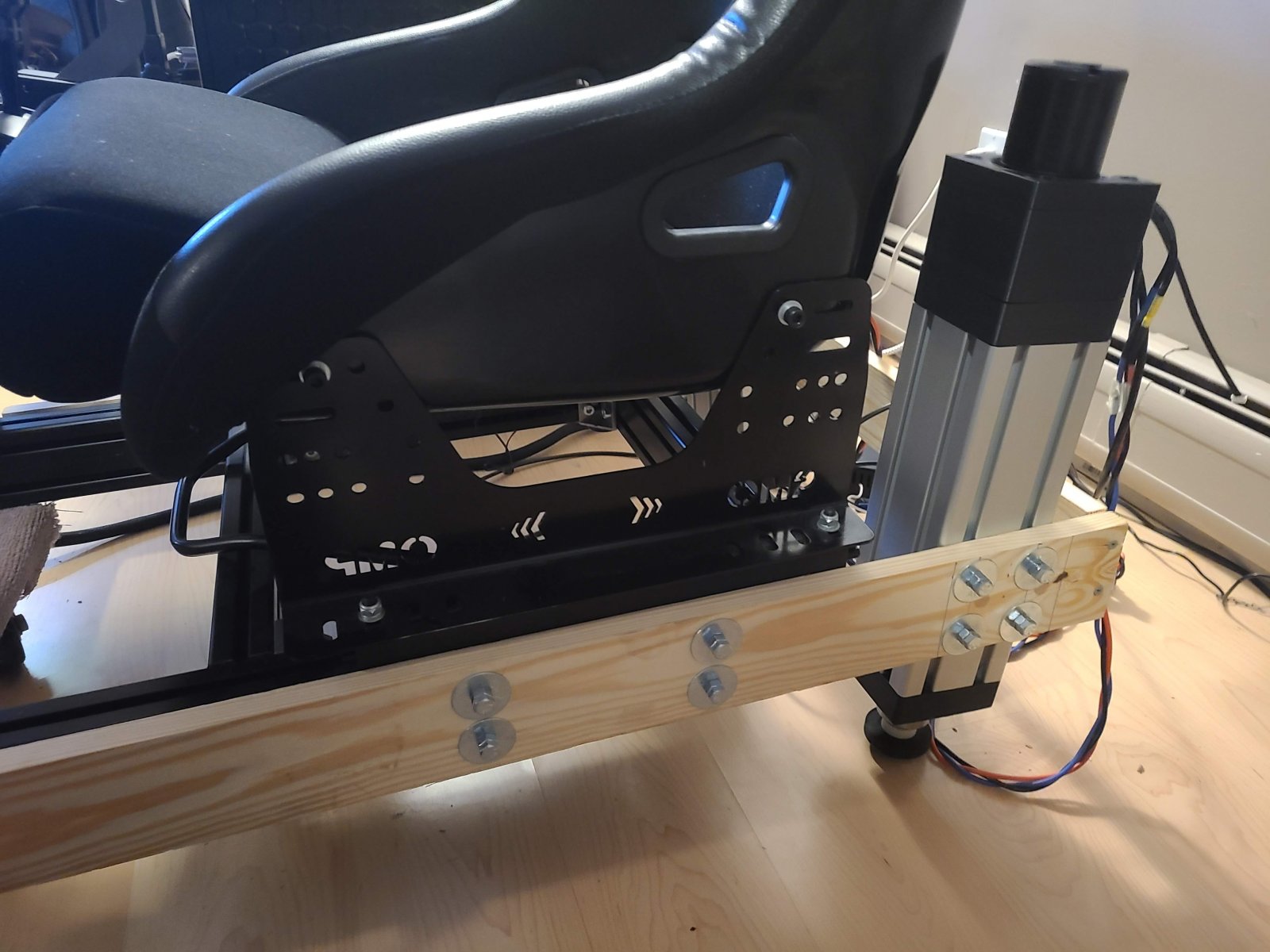

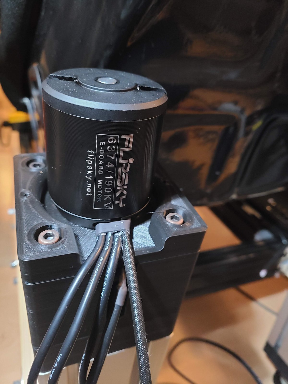

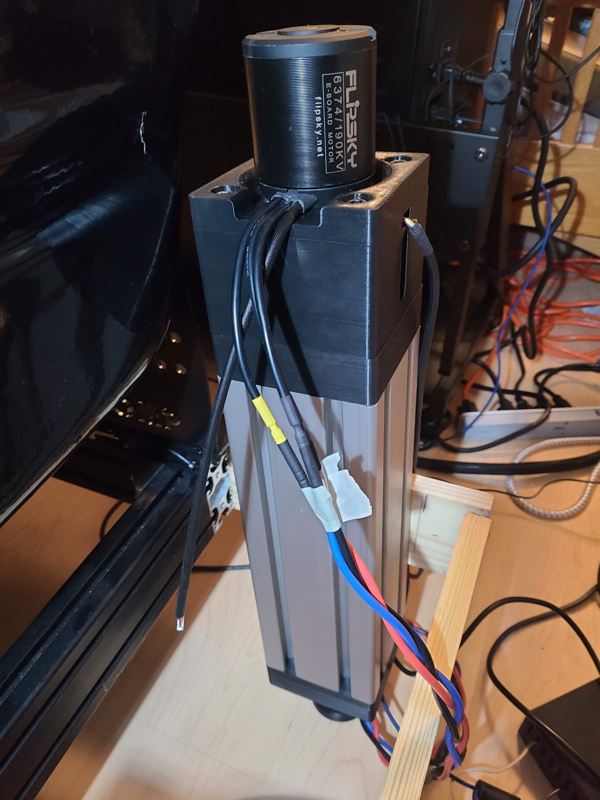

    I have a basic test setup on my rig right now with only two actuators at the back and the front propped up. It's not very realistic but in this scenario even while supporting my full weight (195 lbs) and ~50% of the rigs weight I only pulled a max of ~30 W driving two actuators during test runs that were very poorly tuned and moving pretty aggressively. Much of the time my draw was only about 15 W according to my Kasa plug so I'm looking foward to seeing how the full system performs.
    Yes, that's just common pine board attached to extrusion with a very much DIY approach to prove the concept but it made me convince myself that the approach should work so now I'm starting to build the other two actuators. I'll do a more detailed build log of those as I didn't really document the steps for the first two.

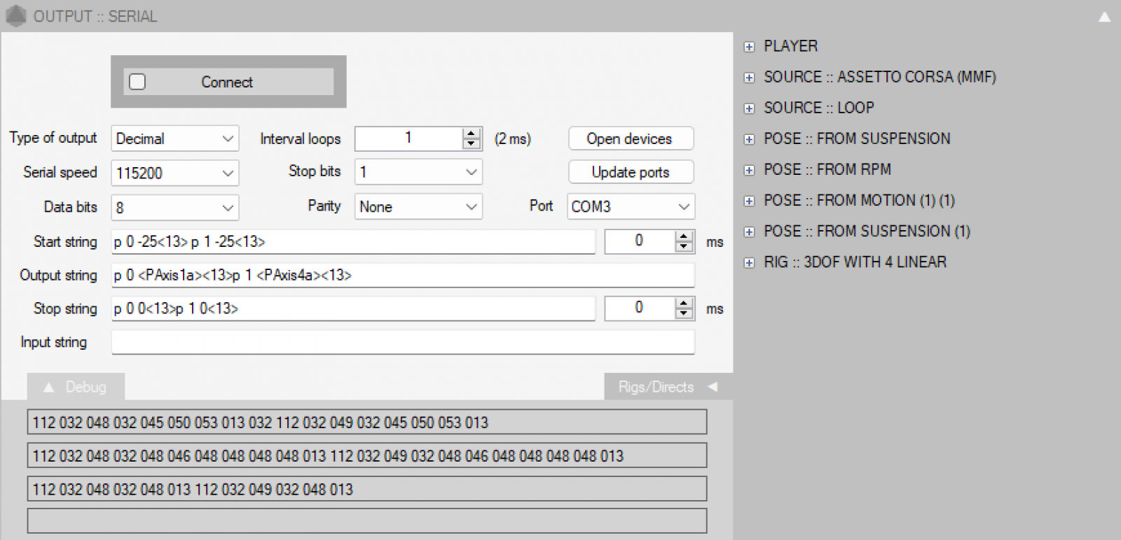

    Now, for your question about calculations.
    In FlyPT mover I use the Rig actuator filtering to map the actuator position in mm to a number of turns which can be fed directly to ASCII output in the Serial output <P Axis 3a> for example.
    I have a ball screw with 5mm pitch, so every turn is 5 mm of position or 1mm = 0.2 turns.
    In actuator filtering I then apply REMAP(MUL(VALUE;0.2);-11;11;0;-22).
    My zero position is with the actuator fully retracted so the mid-point is 55 mm extended which is 11 turns (55 x 0.2 = 11). Since my Odrive is set up with the encoder at zero when it's fully retracted and to account for the direction of motor turn, I then remap the -11 to 11 turns that Mover wants to output to zero to -22. That just offsets the coordinate system from having zero in the middle to zero at the top of the actuator and makes sure my direction of motion is correct. I could have flipped the direction in Odrive settings and probalby applied an encoder offset as an alternative but for now I'm just letting Mover do the remapping.
    In testing I have the Odrive running trapezoidal control with 95 turns/sec/sec acceleration and deceleration with a max velocity of 110 mm/sec. That's pretty quick motion so I started playing with filtering in Mover but since I only have two actuators running right now, I didn't spend much time on tuning.

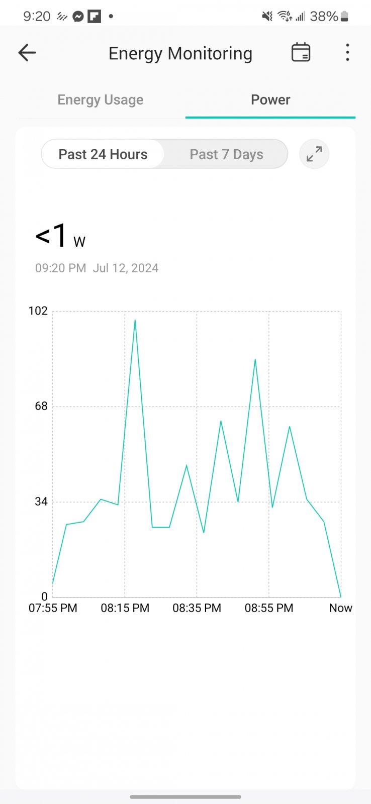

    @theoptimisticcynic Thanks for this explanation. It looks a simple and efficient solution to use odrive directly. I have some experience in odrive use, that's why, i'm very interesting to follow your evolution. Indeed, not all chinese odrive is good . i already had some bad experience with ODESC ( same board than odrive) ... The best will be to stay with original odrive board but price is not cheap :).
    Your power supply looks small for your use. Only : 10,4 A ... it can explain the low speed that you have : 110 mm/s ? ( Theoricaly , you can add : (190 x 48) = 9120 tr/min 9120x(5mm/60) = 760 mm/s :o:) and other problems...

    The power supply is relatively small and my original intent was to use one per Odrive board but for the moment it's working with just the single power supply. In my very limited testing so far the only thing that is really stressing the power supply is a crash. As I do more testing I'll provide some detail on the power draw.
    I need to make a correction to my previous post though. I was moving too quickly and stated inaccurately that the trapezoidal control max velocity was 110 mm/sec. That parameter is actually 110 turns/second which translates into 550 mm/sec with my 1605 ball screw.

  16. DaveH
    DaveH New Member
    Jun 3, 2024
    30Coins
    +7 / 0 / -0
    3DOF, DC motor
    Forum won't let me edit, but the Mover output string is as below, with as many axis as you like.
    Code:
    1<PAxis1a><10>2<PAxis2a><10>3<PAxis3a><10>

    Ok, I finally got a chance to add to my documentation for those interested in the Odrive side of things. Here's the path that I followed. If someone wants my full Odrive config file I can upload it as a reference for all settings.
    I followed the Odrive instructions found HERE.
    I settled on the last version of the V3.6 board firmware which is version 0.5.6.
    I'll just show one axis below, but all were configured the same. To get things started I used the below settings during testing but later increased currents and speed in the final system (as noted below). The initial calibration is done without attaching a load to the motors while tuning is ideally done with load.
    odrv0.axis0.motor.config.calibration_current = 40 //I increase current from default.
    odrv0.axis0.motor.config.resistance_calib_max_voltage = 4 //Recommendation from FlipSky Website
    odrv0.axis0.motor.config.torque_constant = 8.27/190
    odrv0.axis0.motor.config.pole_pairs = 7
    odrv0.axis0.controller.config.vel_limit = 20 //used for testing
    odrv0.axis0.motor.config.current_lim = 20 // Needed to get motion when I started (later increased)
    odrv0.axis0.encoder.config.use_index = True //Because of encoder choice
    odrv0.axis0.config.startup_encoder_index_search = True
    odrv0.config.enable_brake_resistor = True
    From there I performed motor calibrations without load.
    odrv0.axis0.requested_state = AXIS_STATE_MOTOR_CALIBRATION
    odrv0.axis0.requested_state = AXIS_STATE_ENCODER_INDEX_SEARCH
    odrv0.axis0.requested_state = AXIS_STATE_FULL_CALIBRATION_SEQUENCE
    odrv0.axis0.motor.config.pre_calibrated = True
    odrv0.axis0.encoder.config.pre_calibrated = True
    odrv0.save_configuration()​
    This got me a system that I could put into closed loop control and test.
    I don't know if it was necessary, but I ended up performing the anticogging calibration according to THIS video. It's probably not necessary for our application.
    After finishing tuning according to the Odrive documentation I updated the configuration to use Trapezoidal control mode and to also start up directly into closed loop control when powered on. Trapezoidal control is to add ramp when changing directions. The Odrive docs point to the original publication if you want to really geek out on the method implemented in their code. It's a jerk limited trajectory planner.
    odrv0.axis0.controller.config.input_mode = INPUT_MODE_TRAP_TRAJ
    odrv0.axis0.trap_traj.config.vel_limit = 110
    odrv0.axis0.trap_traj.config.accel_limit = 95
    odrv0.axis0.trap_traj.config.decel_limit = 95​
    For the 1605 ball screws used the 110 turns/sec max velocity is about 550 mm/sec. I didn't add much of an acceleration ramp but tapered it off just a bit and I didn't have any issues. Most of the ramp comes from my PT Mover filtering.
    To make the Odrives start up ready to be used I also made the following changes for the final configuration.
    odrv0.axis0.motor.config.current_lim = 60 //Fits in motor specs for higher performance
    odrv0.axis0.config.calibration_lockin.accel = -20 //Made negative to reverse the rotation direction during calibration.
    odrv0.axis0.config.calibration_lockin.current= 30 //increased to make sure calibration completes when lifting the rig on startup (see below)
    odrv0.axis0.config.startup_encoder_offset_calibration = True // So we find index each time
    odrv0.axis0.config.startup_closed_loop_control = True //Puts us ready to be commanded by Mover​
    When assembled I needed to reverse the encoder search direction so it turned correctly and didn't just push against the immobile side of the actuator. That's done using the calibration lockin acceleration variable noted above which isn't that intuitive but makes sense once you understand what it's doing. I did have an issue where sometimes I wasn't finding the encoder index pulse and the rig would just start vibrating as a motor kept trying to lift the rig and then dropped back down without finding the index. Ultimately it would start oscillating very fast and eventually just run away if I didn't shut it down. This was caused by having too low of a calibration lockin current. Once I increased that it has no problem lifting the rig to do the encoder calibration and find the index pulse.
    Ultimately these settings just make it so that when I turn the system on all of the boards immediately move a short distance (less than 1 turn) to find the encoder index pulse and then they go into closed loop control ready to be commanded to move. I don't have to open up python or give any other commands to get started. Connecting to FlyPT mover then moves them to the right position and does a soft start ramp up.
    During testing I kept having my power supply shut down and tracked it down to my brake resistors. The difference between the nominal 2 ohm value printed on them and the actual value I measured was enough that the board wasn't sending enough current to the brake resistor. There was enough back current to trip the power supply safety and shut it down. I ultimately ended up setting my brake resistor value to 3 ohms which made sure that I'm not sending any current to the power supply. This seems to have solved that issue and I have been running stable with only the one power supply driving both Odrive boards (4 actuators).
    I have the power supply on a Kasa smart plug so I can turn the system off and on with my phone app which works well. It also lets me monitor power. Attached is a screenshot of the power draw for an hour or so of playing around in Assetto Corsa Competizione if memory serves me. Most of the time I'm pulling between 35 and 65 watts with occasional short peaks just above 100. I don't feel I'm stressing the system at all and the brake resistors don't really get hot either. Overall I'm really happy with the setup.
