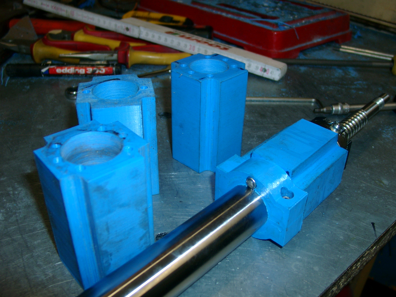

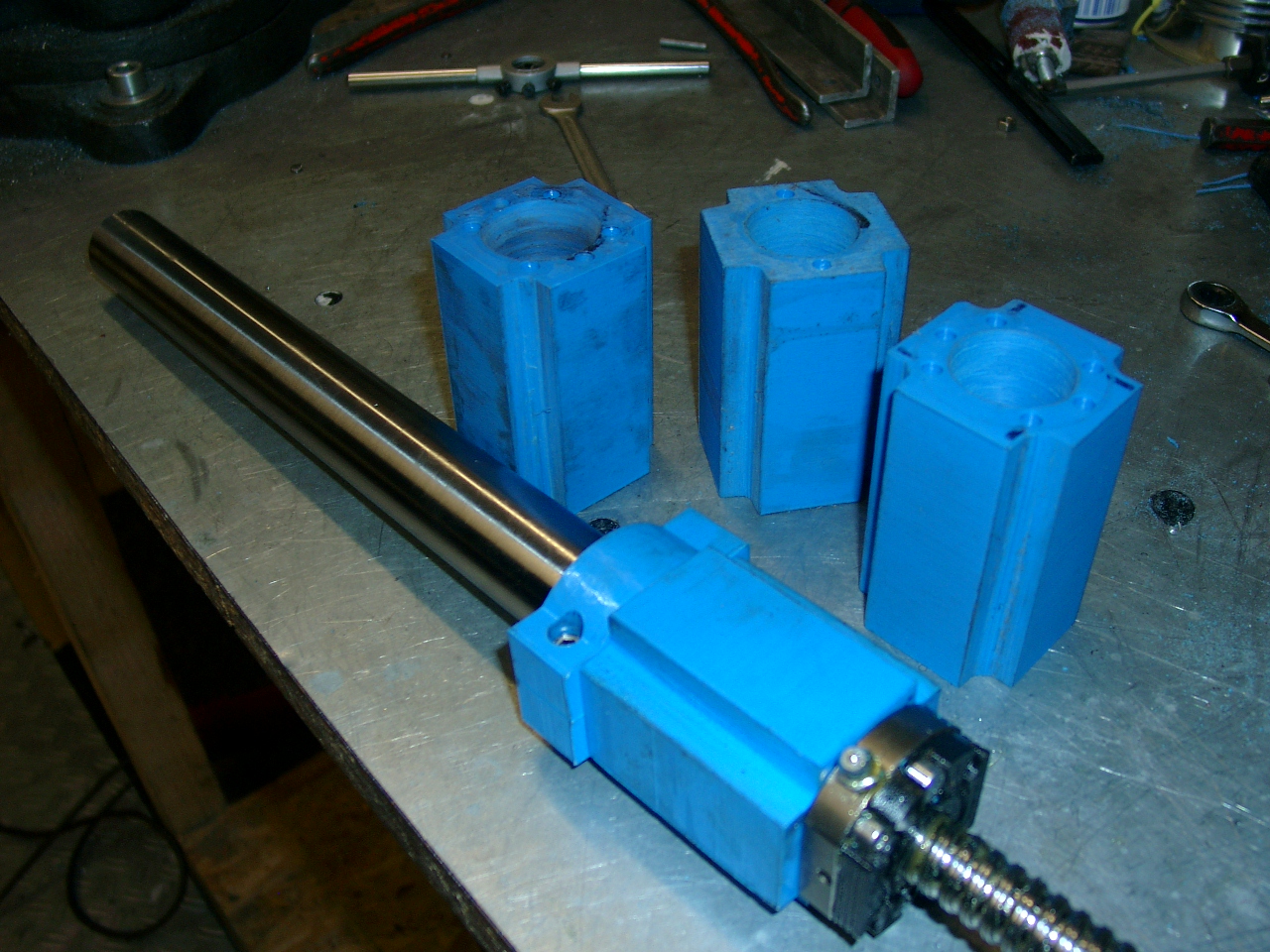

SFX 100 push pull mod with 3D printed parts

    the aim was to find a solution with little effort, easy for everyboy without a lathe, welding and metal machining,
    very surprised how tight it fits.

    4DOF
    it has through boring for attachment a clamping attachment

    - 147Coins
    How much stretch can it withstand? The original sfx100 has only thrust but no tension, and cannot be used on the fifth axis of the horizontal axis. If your design pull is large enough, it can be used on the horizontal pull shaft, which is great!

    4DOF
    choose the version with the metal collar (28/48mm) enlarged to 30mm that only works durable.
