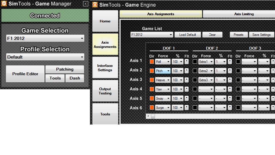

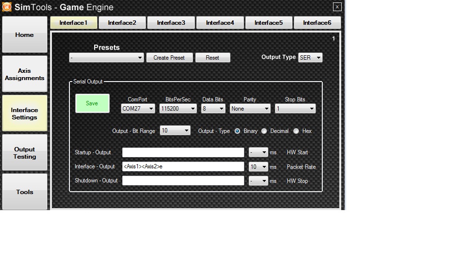

    I havent found success yet. I attach my settings i have.
    (definitely writing this after reading the help :) )

  4. eaorobbie
    20,465Coins
    +1,686 / 23 / -2
    Lets take one step back.
    When the game starts, look at the Game Manager, does it say Game Running, in a blue box. If yes then check the Tuning Centre to see if data is present.
    If not then the game is not patch correctly in the Game Manager.
    Please check.
    Another one would be the game exe filename matchs what is displayed in the Game Manager - Profile Editor - More. Process name displayed must be the file that starts the game or the plugin will not connect.
    Please step through this and then we can check serial out.
    Thanks for your patience.
  5. jismake
    jismake New Member
    Nov 24, 2013
    6
    289Coins
    I could fix finally
    1. Serial line was connected tx-tx instead of tx-rx
