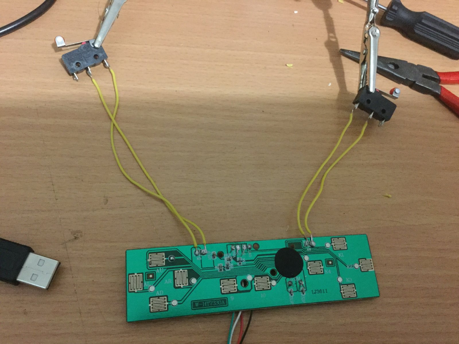

    I have started my DIY sequential shifter. I created a new thread as I couldn't edit the title. Admin, please delete my other thread.
    I'm using a cheap Chinese clone game pad off eBay, they cost around $3
    I unscrewed the 5 small screws on the game pad and pulled the PCB out. It was relatively simple to follow the tracks to find a good solder point.
    I soldered on some micro limit switches to "L" and "R" buttons as they had the largest, easiest to solder to pads.
    The board could even be cut down another couple of cms either side of the two L and R buttons. Although I won't do this yet just in case I decided to use other buttons on the game pad to make a small button box or similar.
    I have plugged the modified game pad PCB to the PC and iRacing is accepting the limit switches as change gear up and change gear down

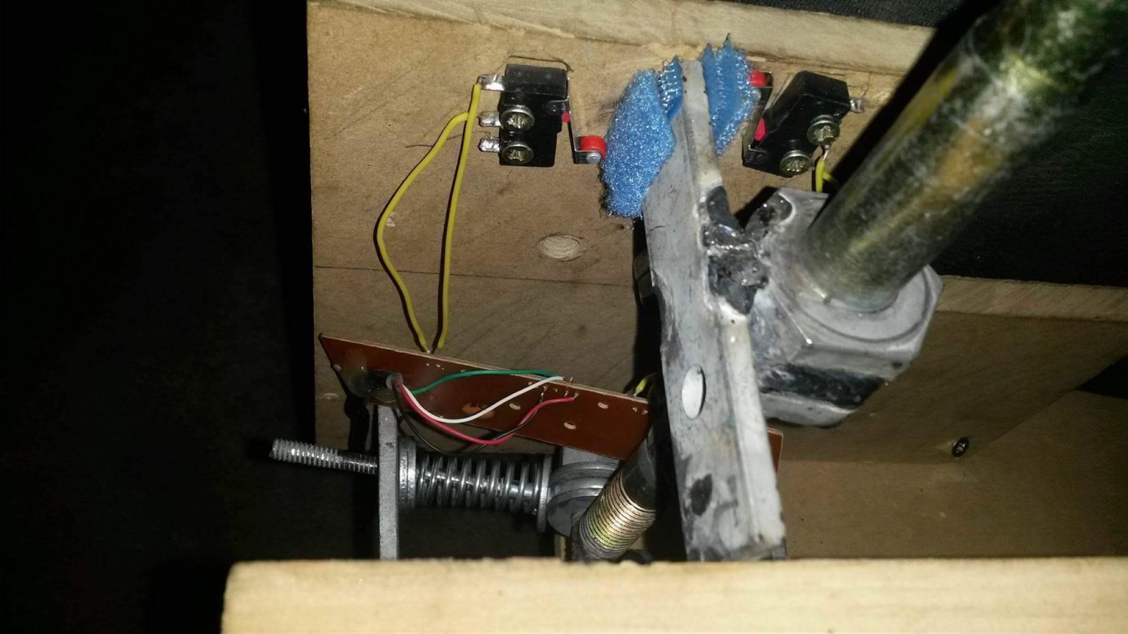

    Now I need to incorporate this into the mechanical shifting mechanism

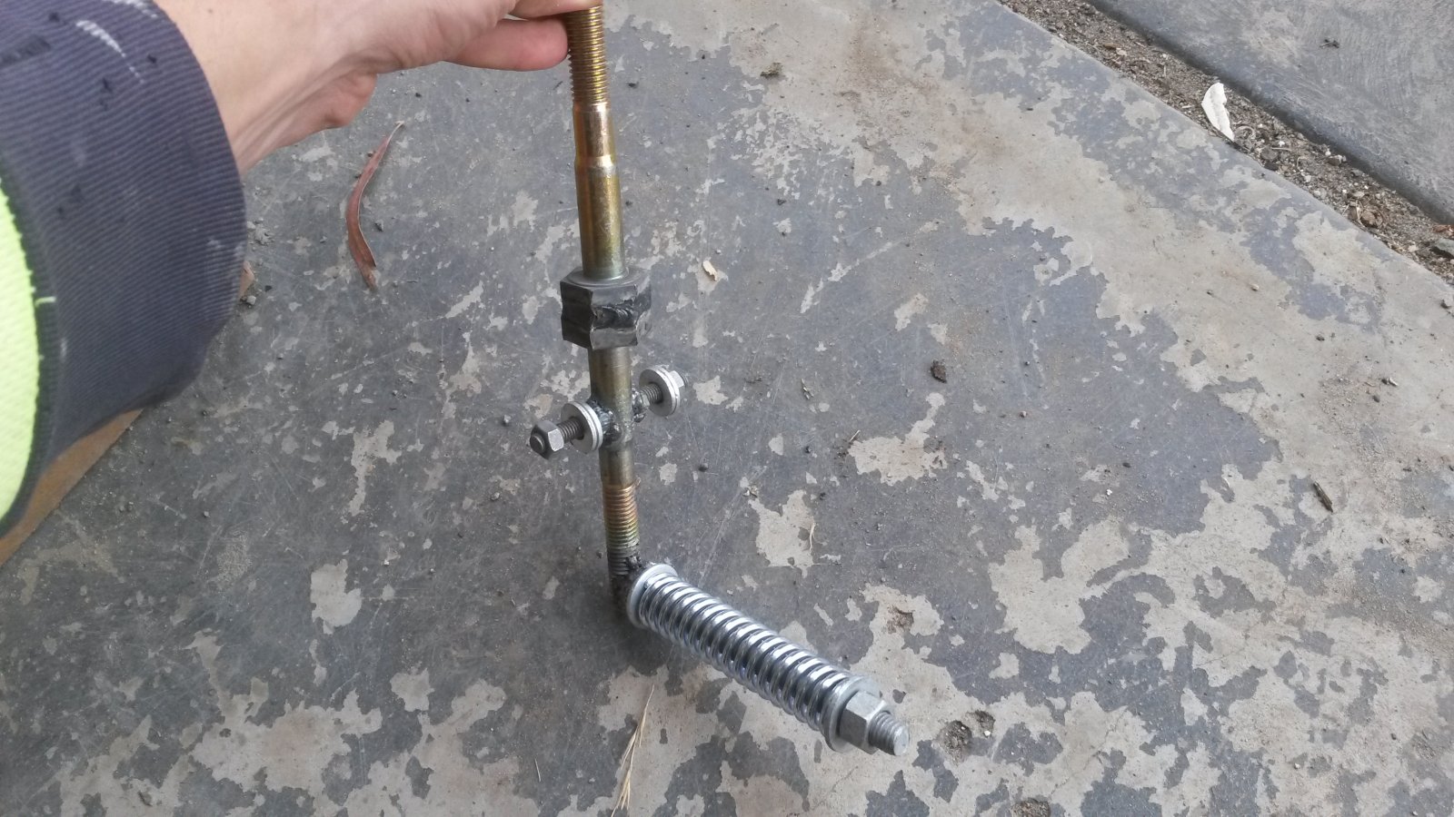

    I welded up the shifter. Although I realized the shaft with the spring needs to pivot. I'll need to cut it off and try again. Doh. Another day

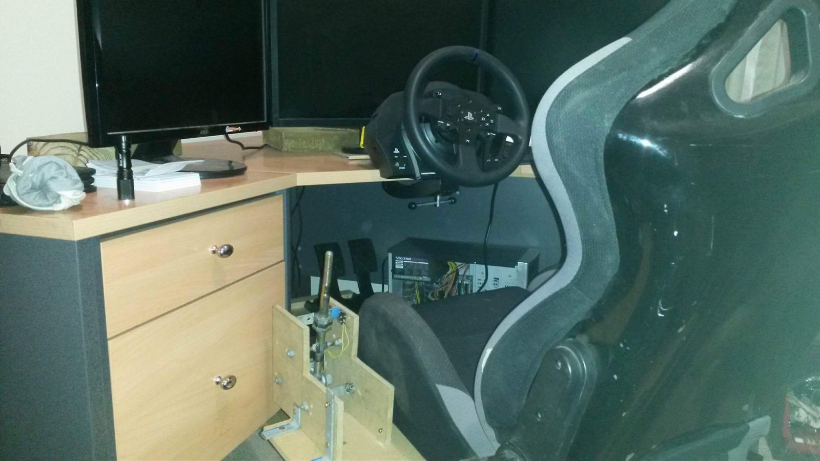

    Finished the shifter. All up cost was around $20. It looks average and doesn't feel like a shifter engaging but works a treat. Just finished playing Dirt for a few hrs and worked perfect. Dirt is pretty demanding on hardware so I'm happy the shifter didn't fail.
