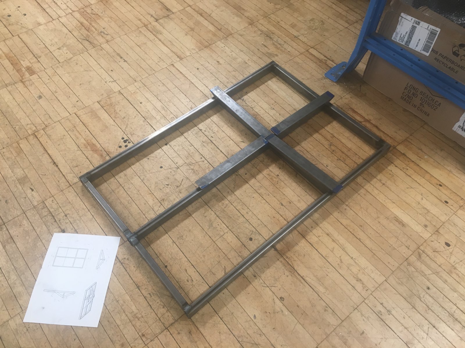

    A little bit about my sim idea: I’m pretty set on designing a simple seat shaker with a welded rectangular steel frame (I want to learn how to weld and will be taking lessons from the instructor in our machine shop). My only concern about steel is weight/modularity (in case I need to lug my sim across campus), but I think I can design around this and enjoy the ease of welding steel (as compared to aluminum).

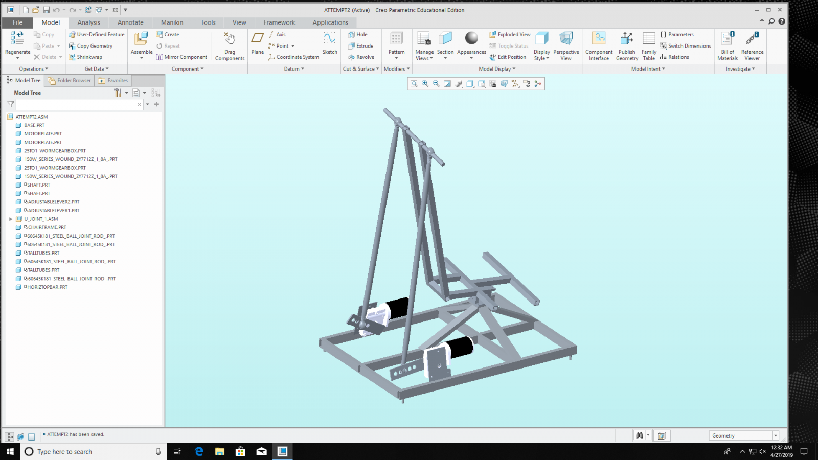

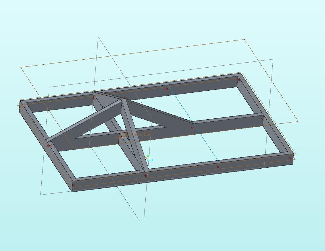

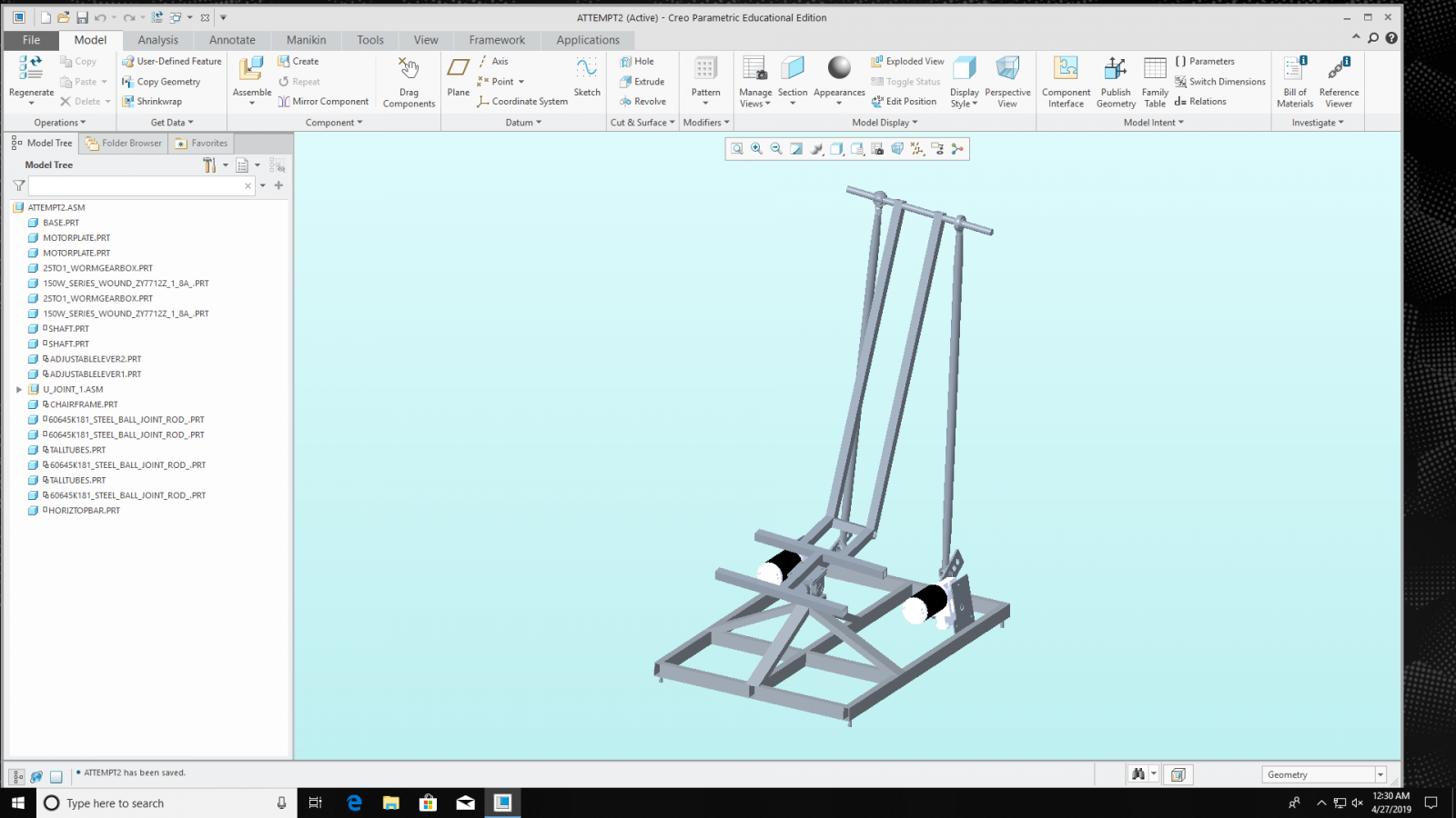

    + I have been working on the base (it's my first design using rectangular tubing, so modeling it in Creo was a bit of a challenge, so don't judge too harshly :p). Below is a picture of it, and a link to my Creo .prt and the exported .obj file of the design. All units are inches and are set as parameters in Creo, so it should be easy to modify any dimension with a few clicks. Any feedback you have regarding the base's design would be incredibly helpful!

    Personally I consider a traditional uni joint is best for a 2DOF rig, as there is no lateral twist and the flat flange makes it easy to mount to a seat.
    The dimensional design leverage matters more at this stage than the shape of the frame, use SimCalc to get an idea of the physics and movement of your design: https://www.xsimulator.net/communit...e-linear-speed-and-forces-of-your-design.270/

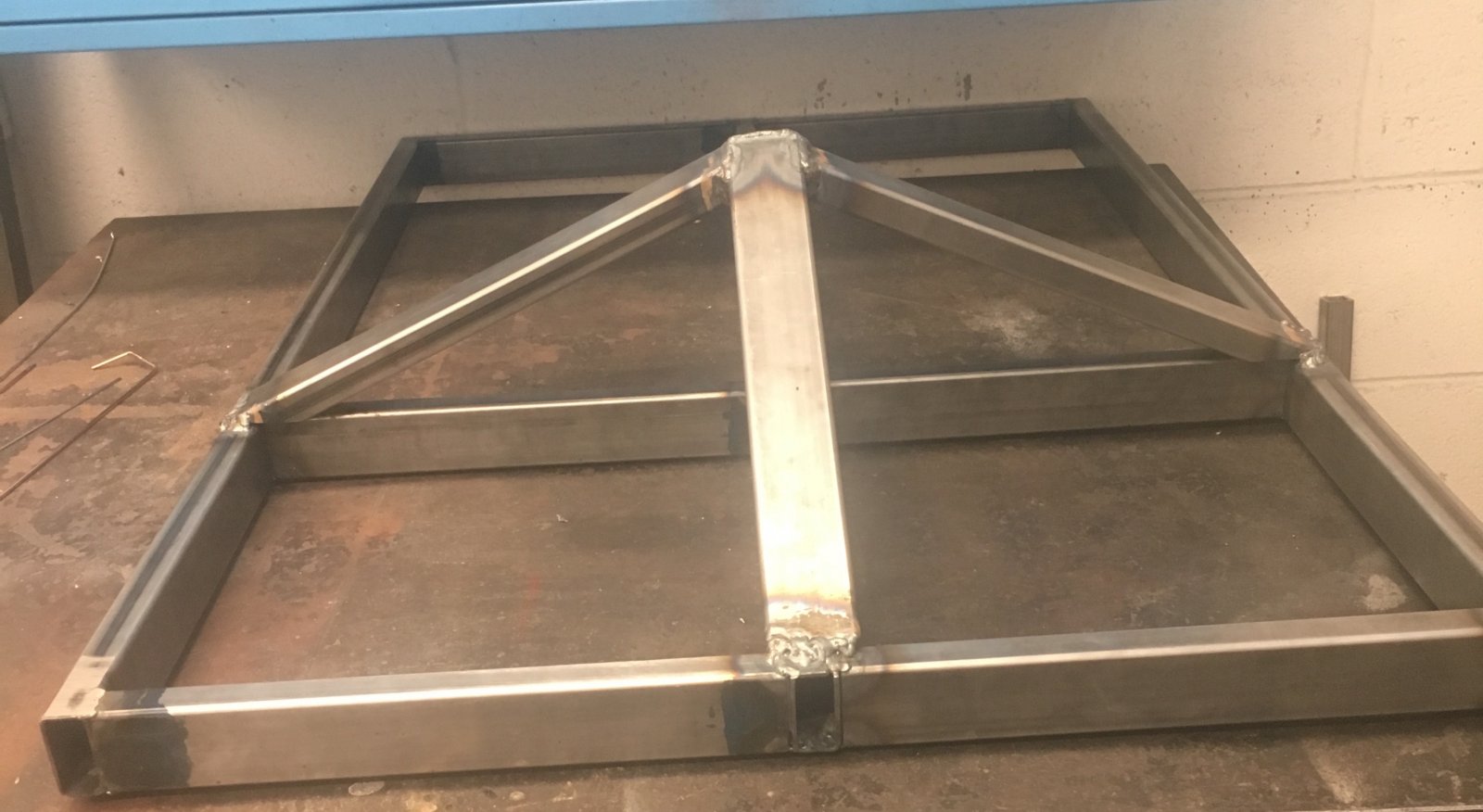

    - The frame is cut and I just need to solder the last few pieces onto it

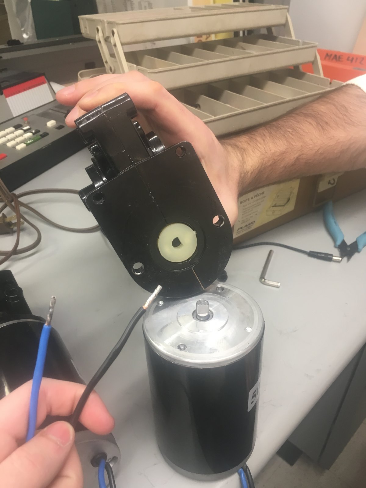

    - The motors have been tested using the JRK 18v27 and work using a simple potentiometer.

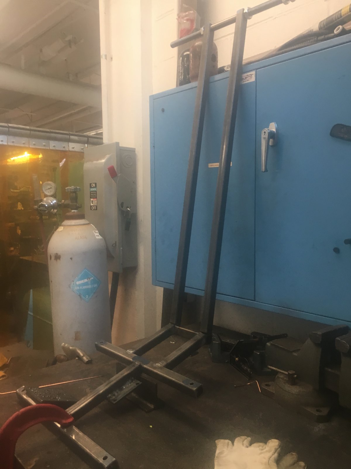

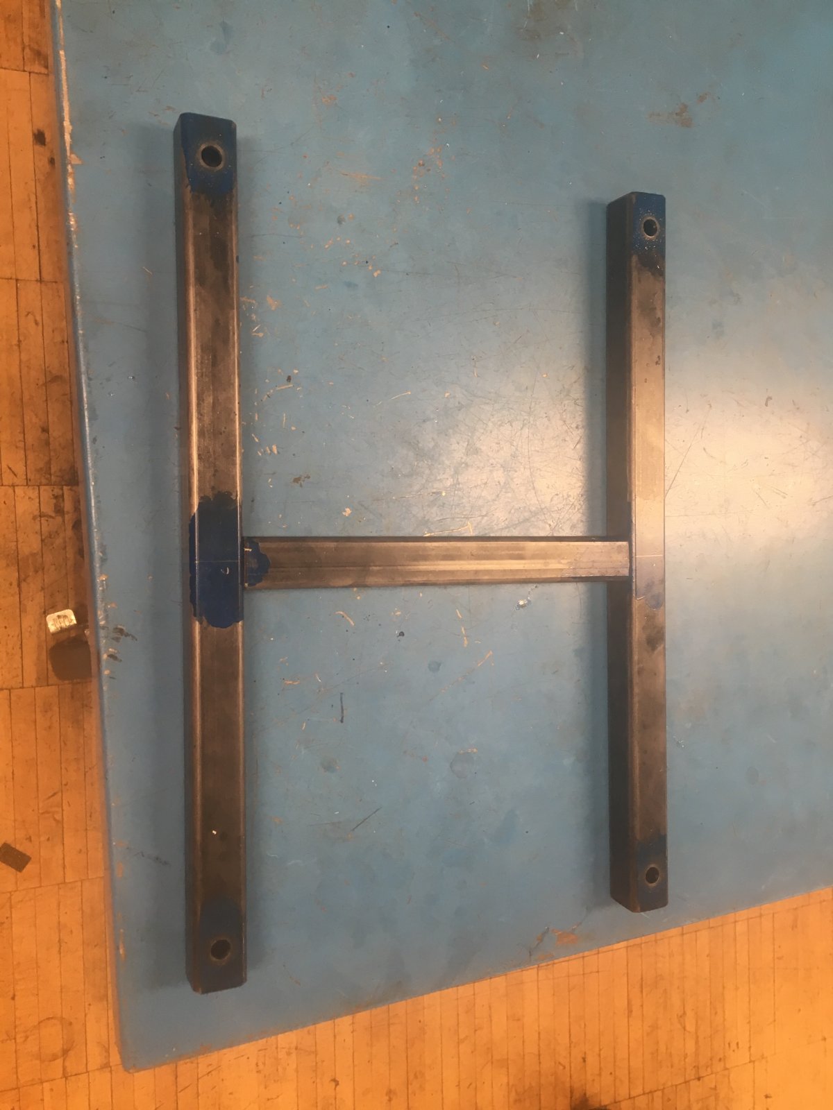

    Yes, I did screw up cutting the diagonal pieces, and my welding will need some touch-up, but overall, it's getting there…

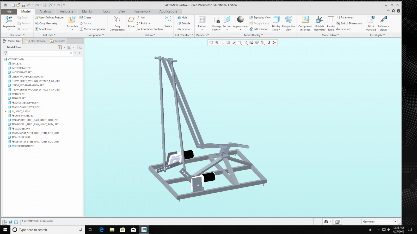

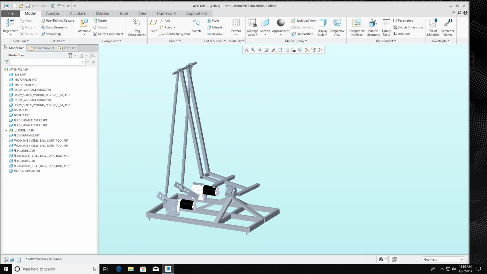

    Another update as the deadline looms nearer...

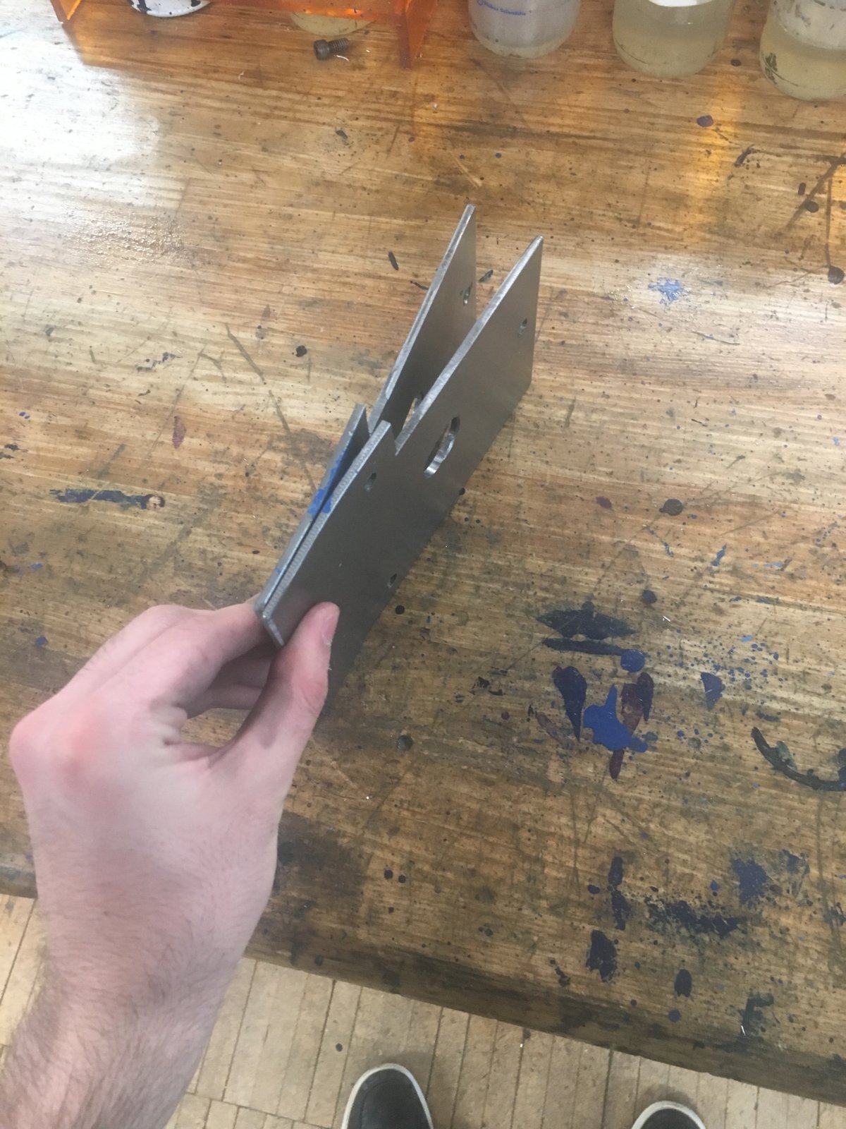

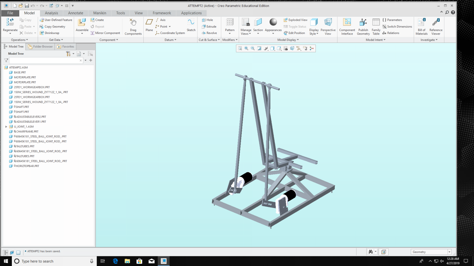

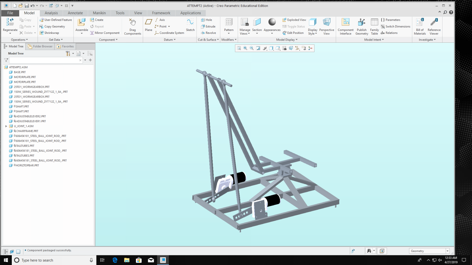

    I now have modeled the full assembly in Creo and you can see how the chair will respond as the motors move in the attached photos.
    I also have finished machining ALL components for the project at long last, and now it's just a matter of screwing and bolting it all together :) Some pictures are attached.
    My goal today and tomorrow is to get it assembled and play around with SimTools (I still need to download that program plus a game or two...). Also, my computer for the project currently is not the best for gaming so if anyone has recommendations for low-quality free racing games just to test out SimTools and my build before I eventually get a new computer, it would be greatly appreciated! :)

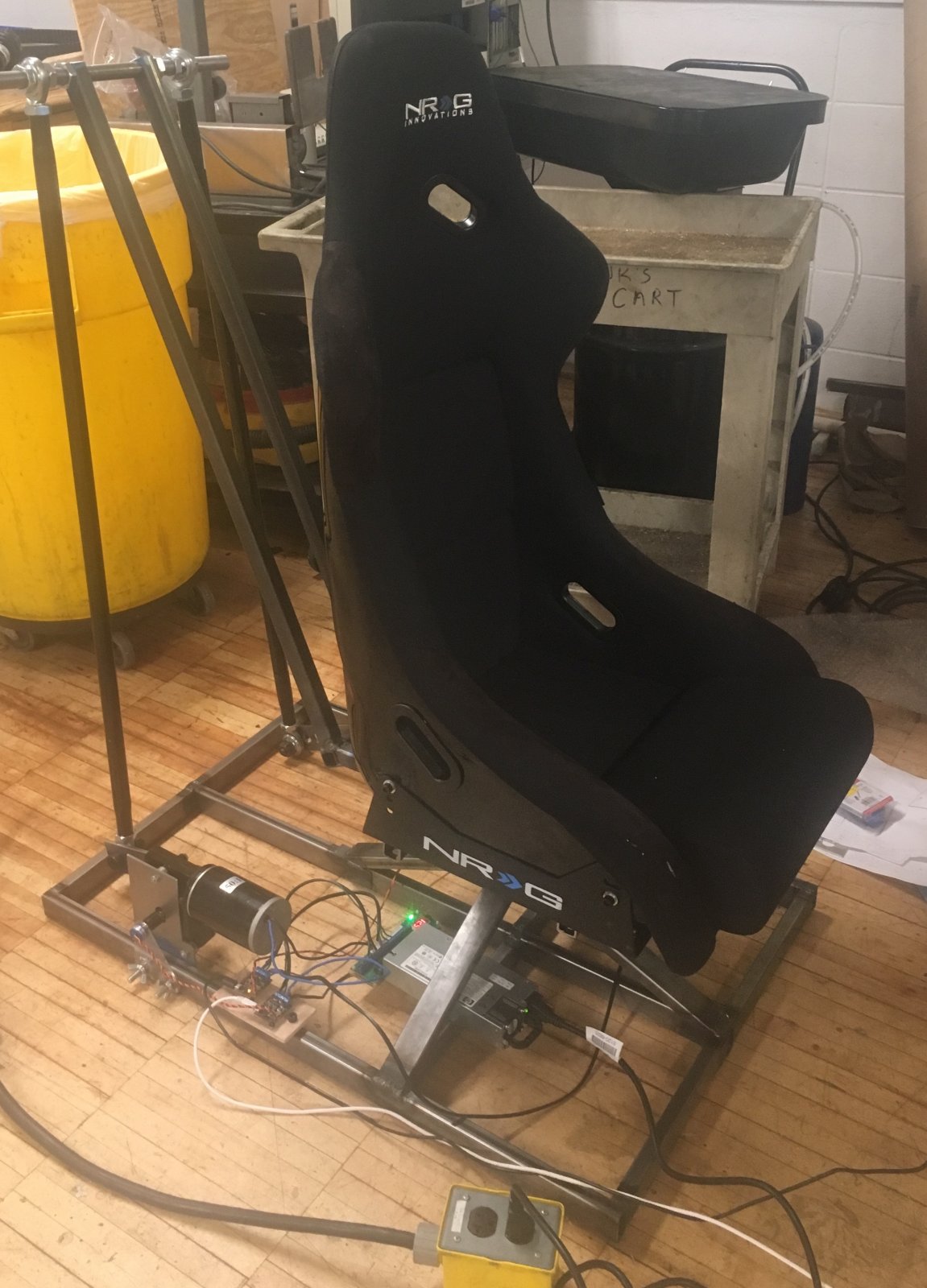

    Ok. My build is finished and has been tested. I'll send some photos and drawings soon. It's not the best, and if I could do it again, I'd definitely make some changes but it works well enough and after some tuning and a bit of welding to strengthen a few connections, it will be perfect! :) So excited!!

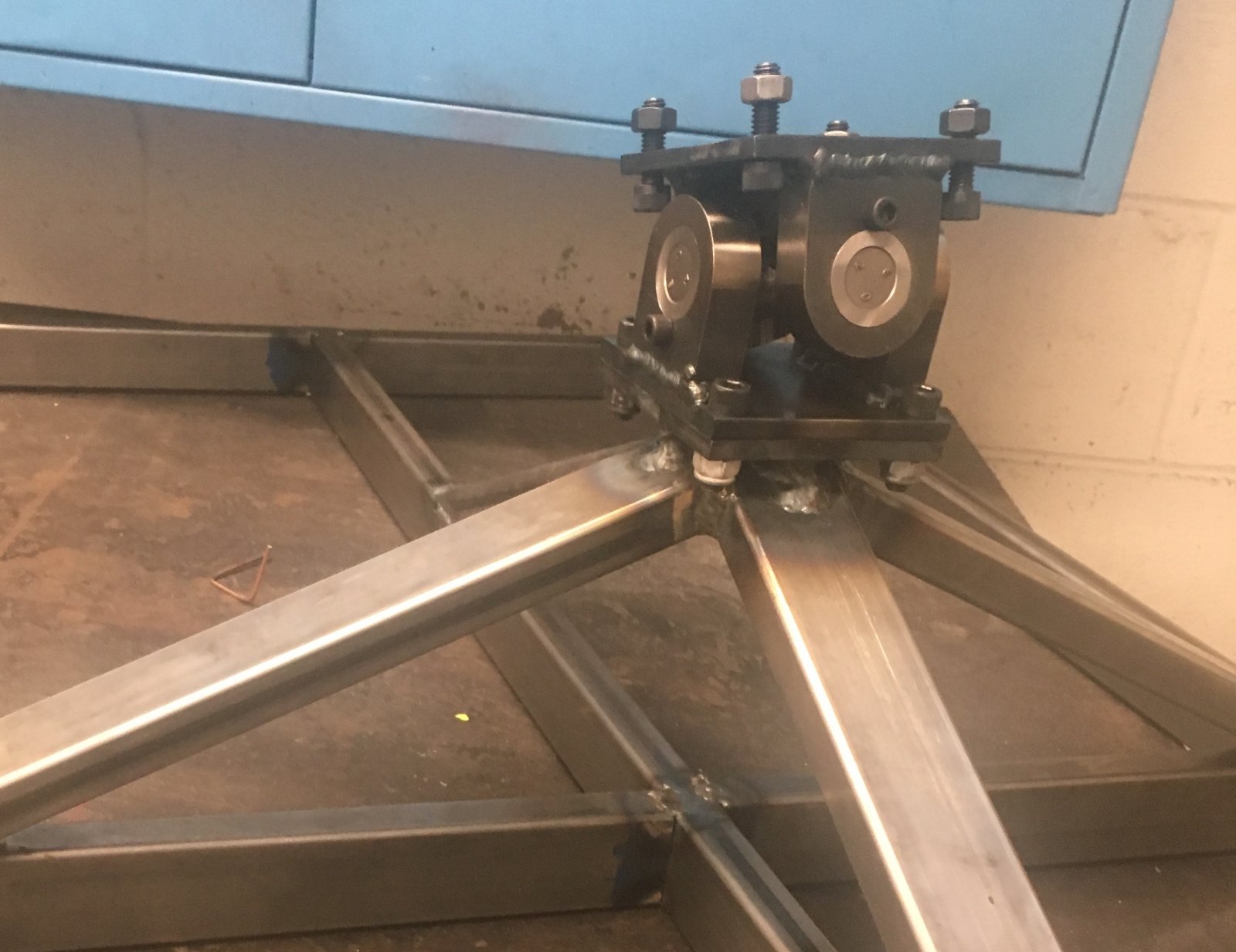

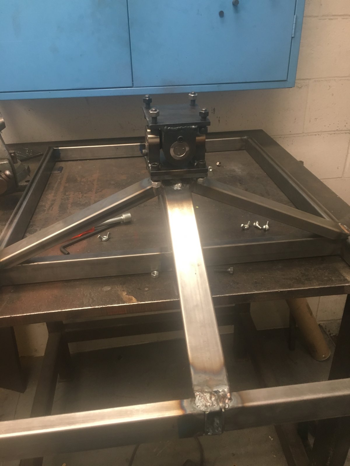

    Here are some photos of different parts of the build + an overview of the simulator. I'll be taking it apart soon to paint it black and then reassembling it stronger and wiser ;)
    I've also included the drawings for machining the motor/gearbox mounting plates, base frame, seat frame, and lever arms, as well as a MATLAB script that can send commands to the JRK to test and plot things like sinusoidal tracking of different frequencies, step functions, etc. It's another tool to use to test PID coefficients.
