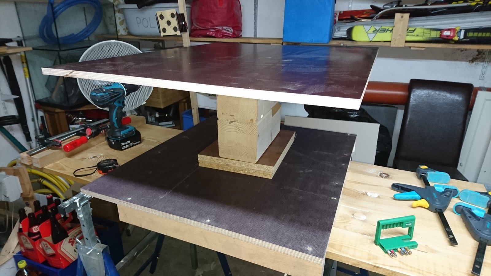

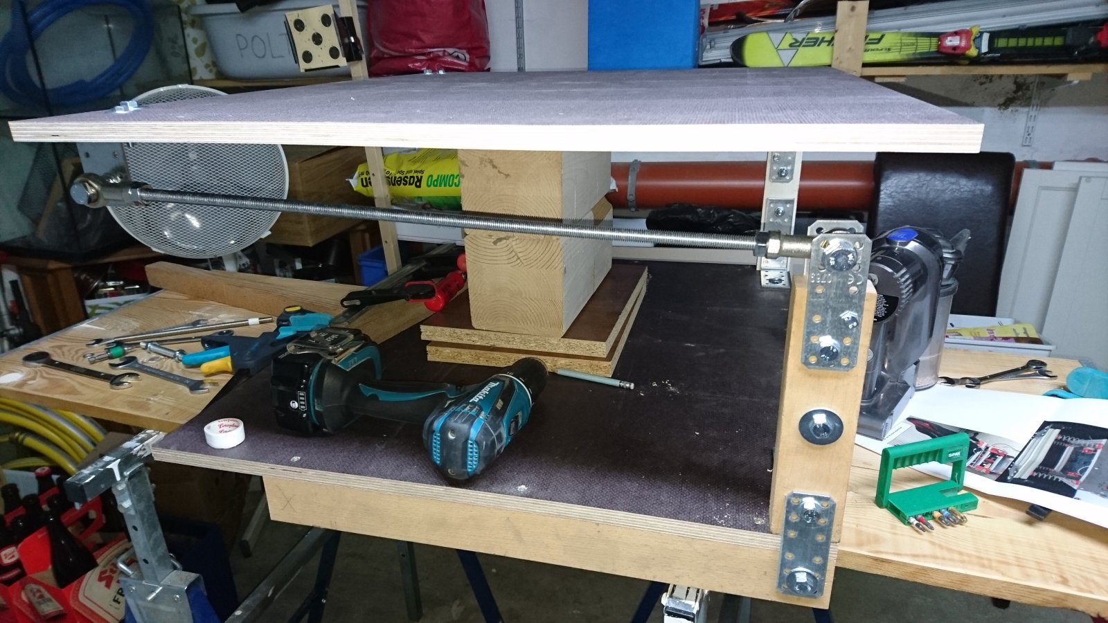

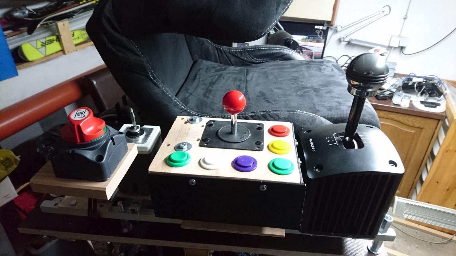

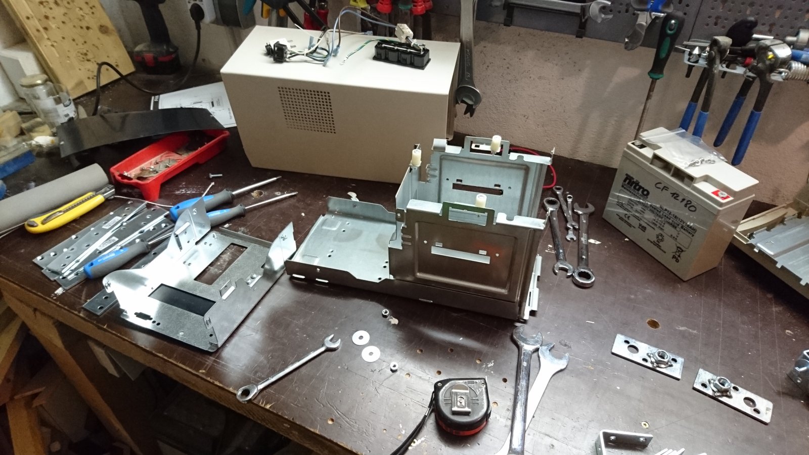

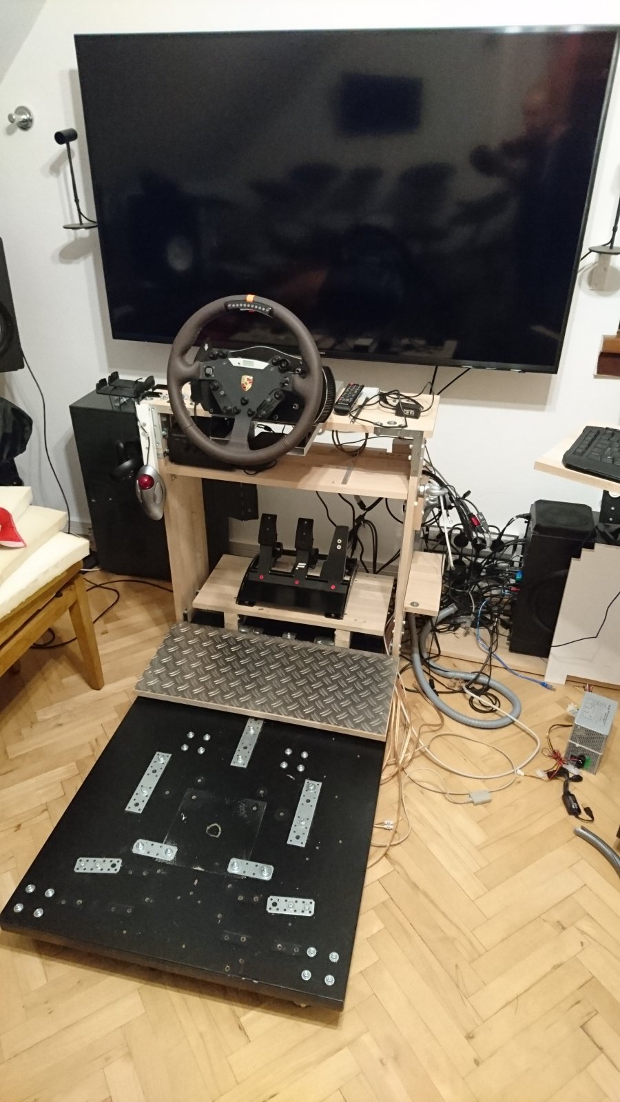

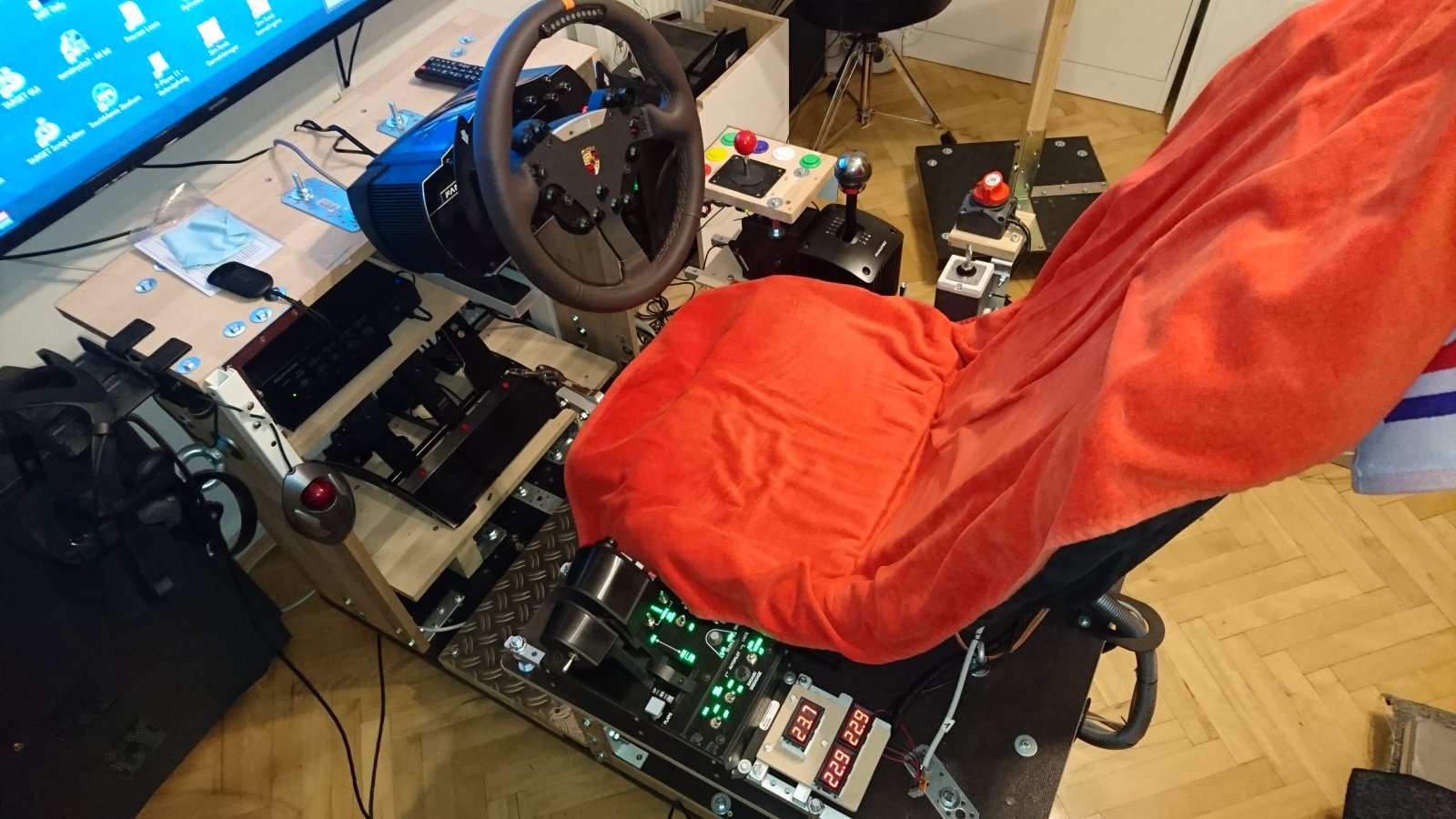

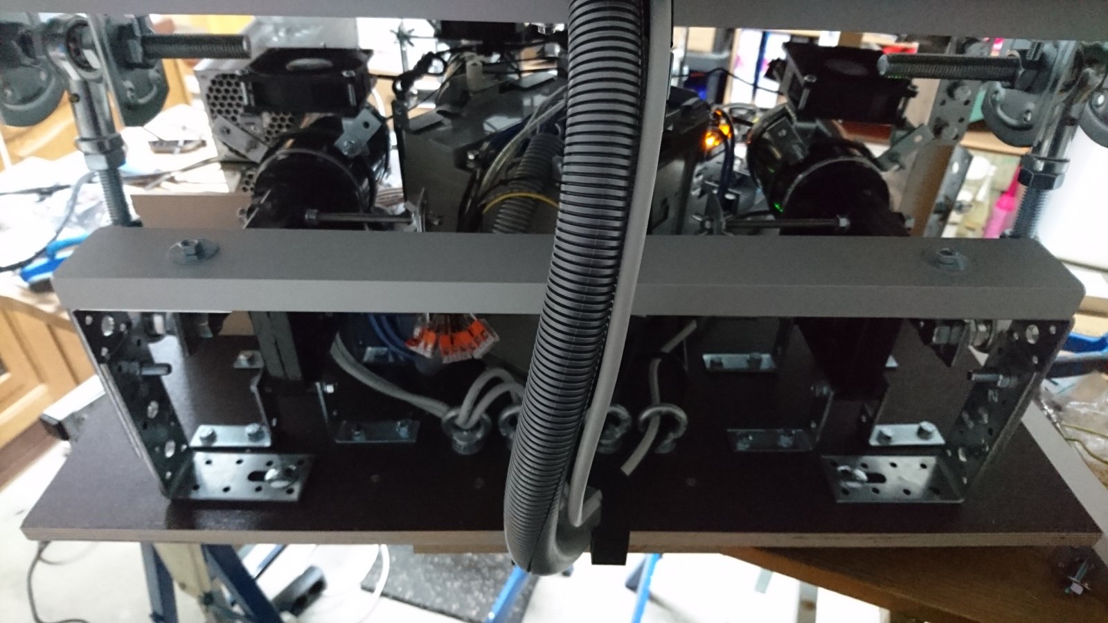

    My first 2 Dof Sim
  3. Papapetrus
    Papapetrus Member Gold Contributor
    Feb 20, 2018
    84
    Austria
    61Coins
    +47 / 0 / -0
    2DOF, 3DOF, Arduino

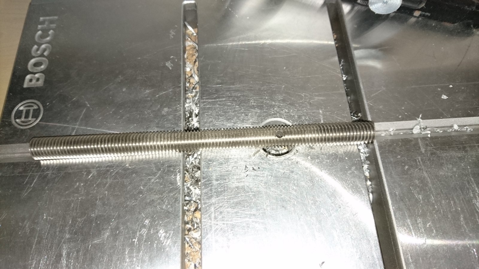

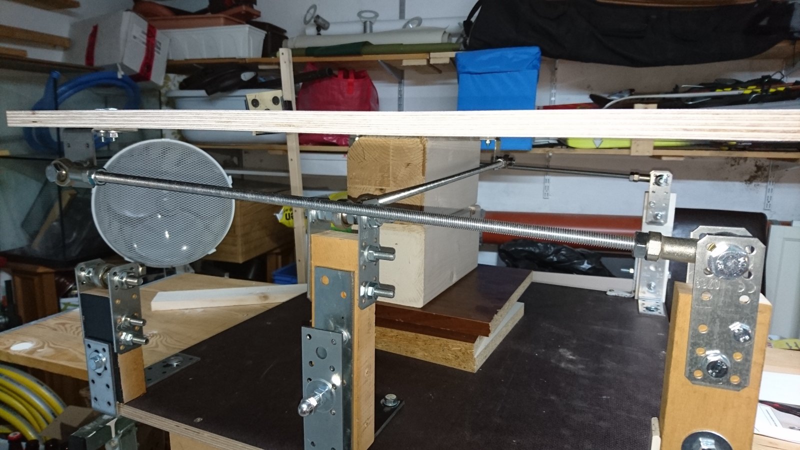

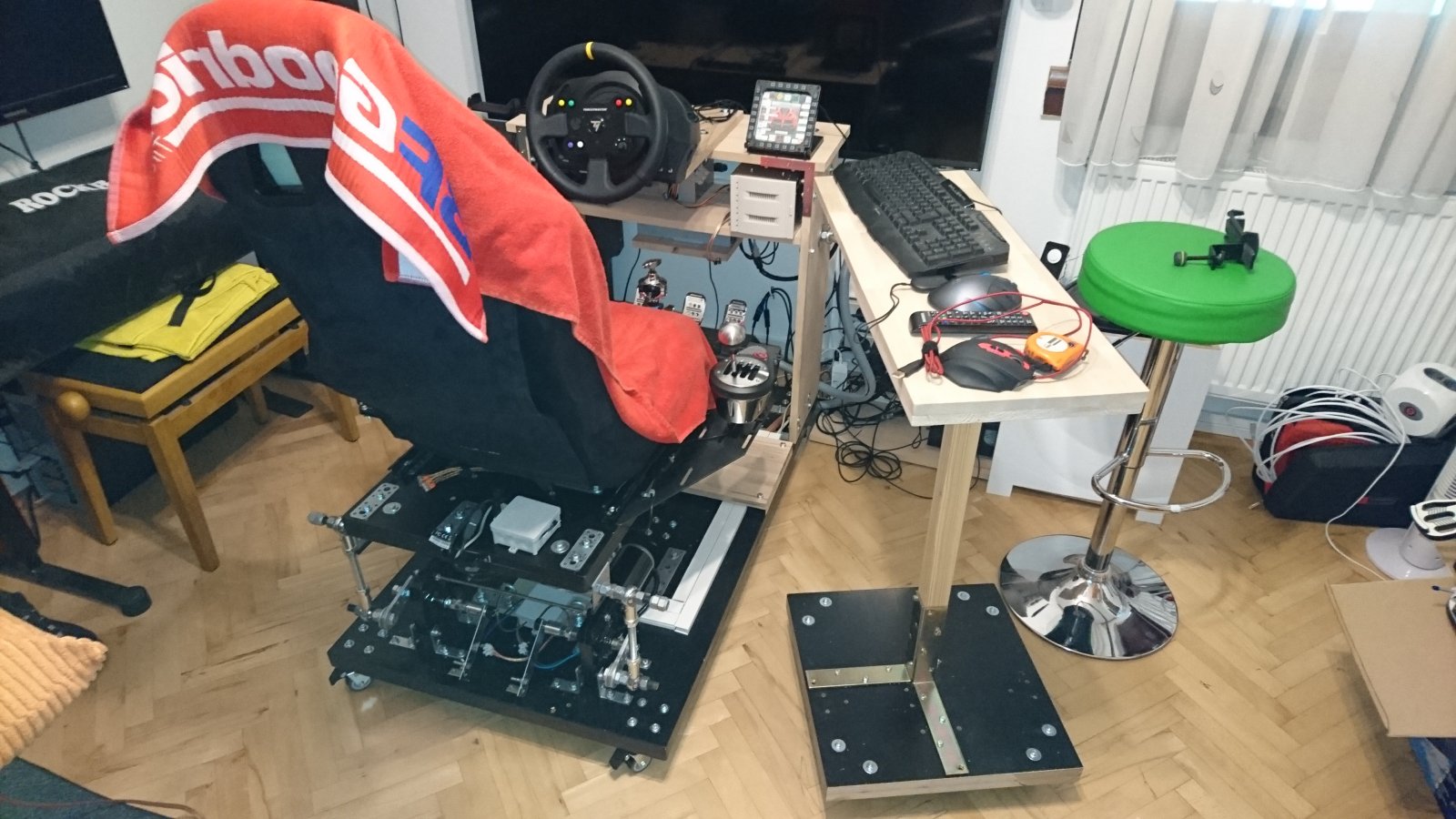

    I wanted to have a lifting axis.
    So I cut everything down again ...

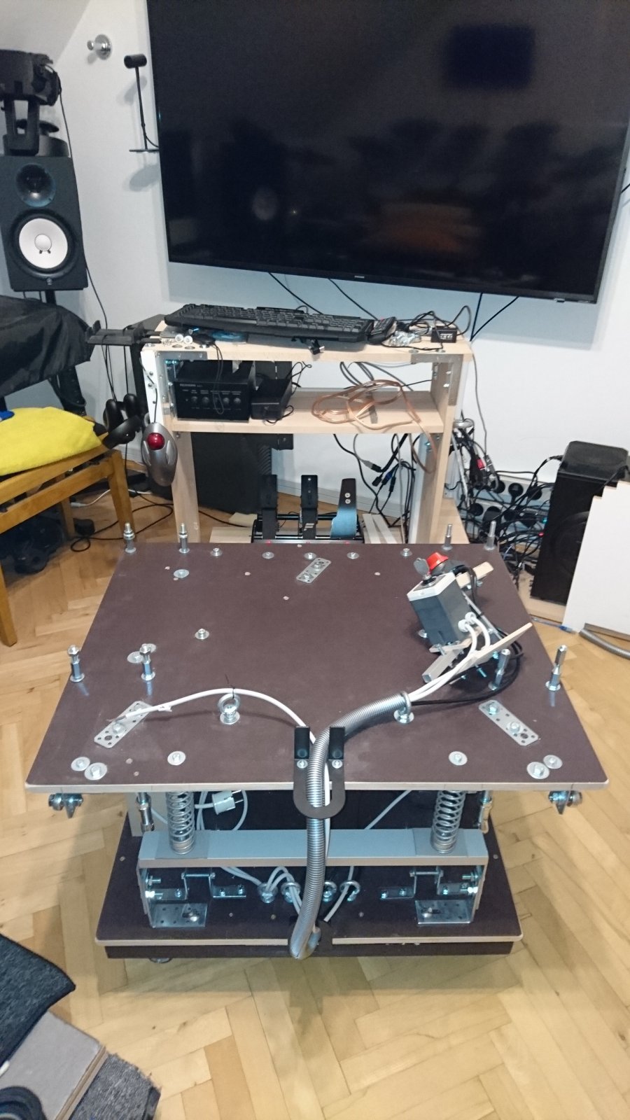

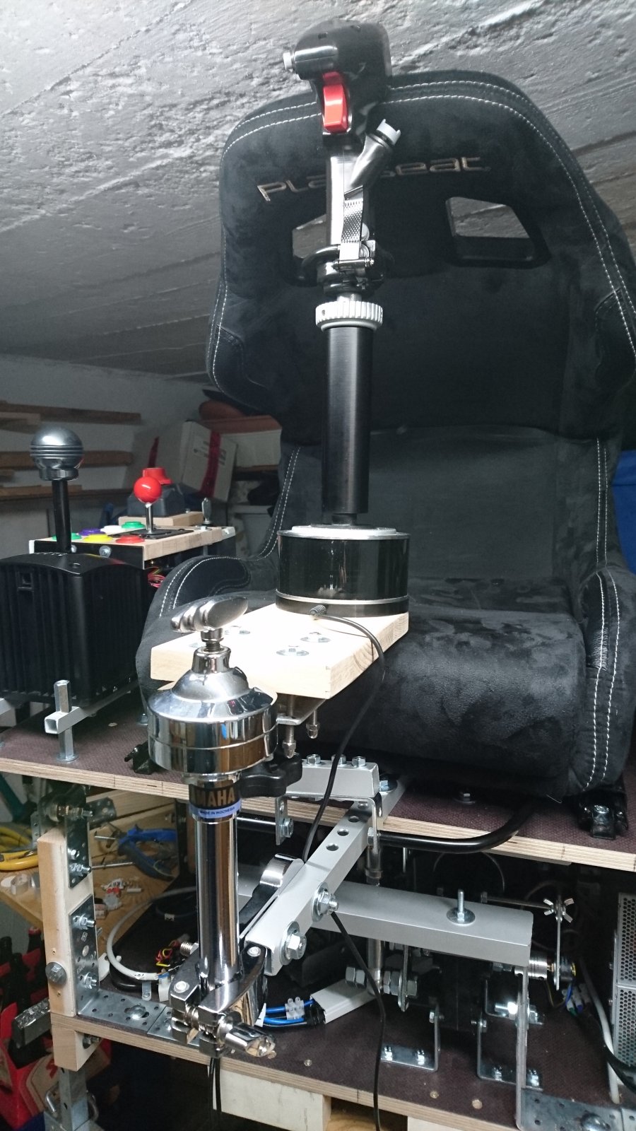

  4. Papapetrus
    Feb 20, 2018
    84
    Austria
    61Coins
    +47 / 0 / -0
    2DOF, 3DOF, Arduino

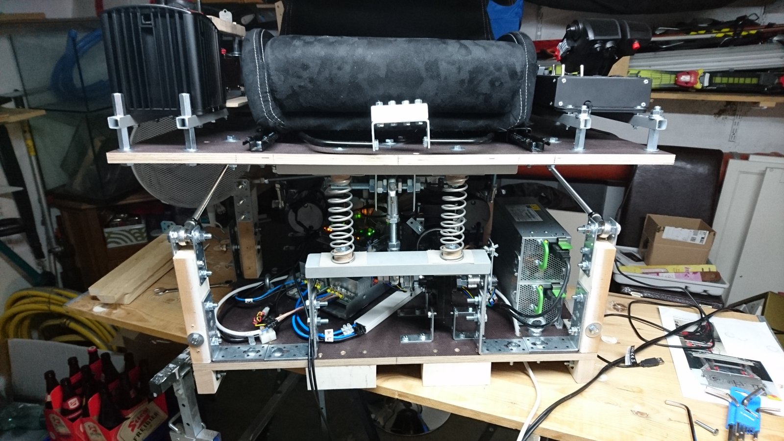

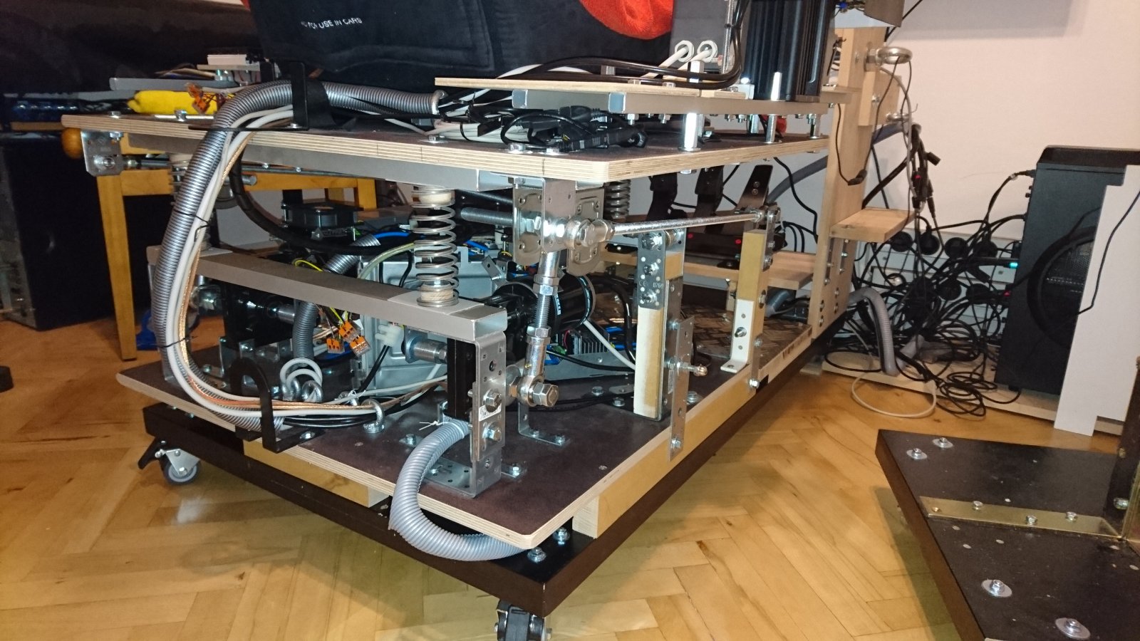

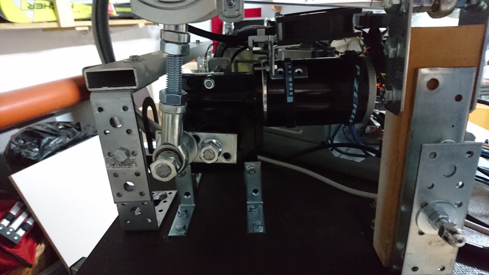

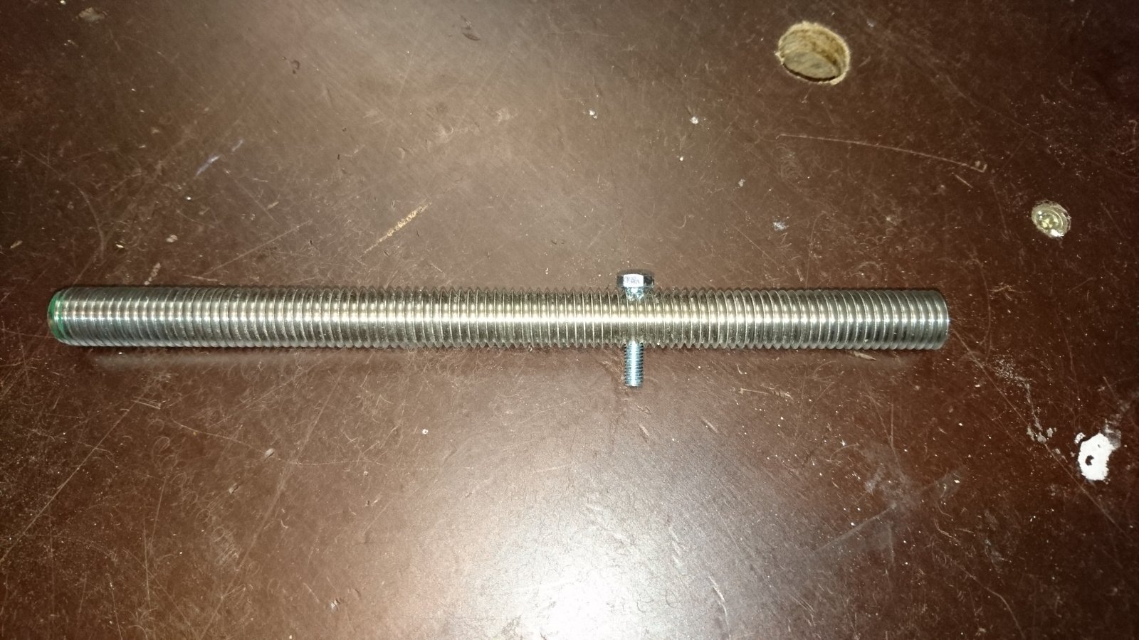

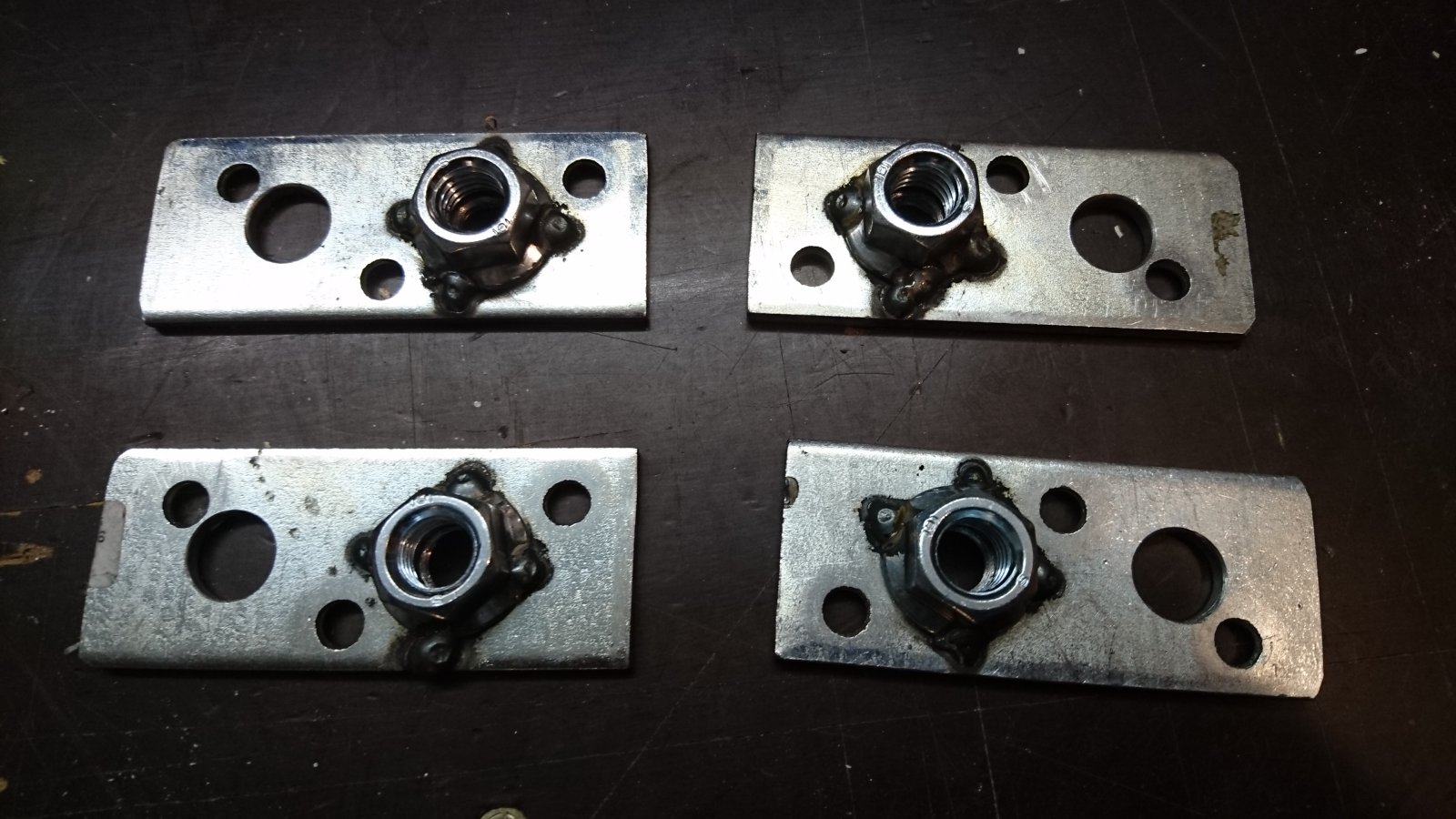

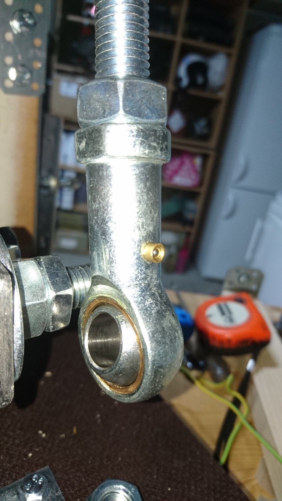

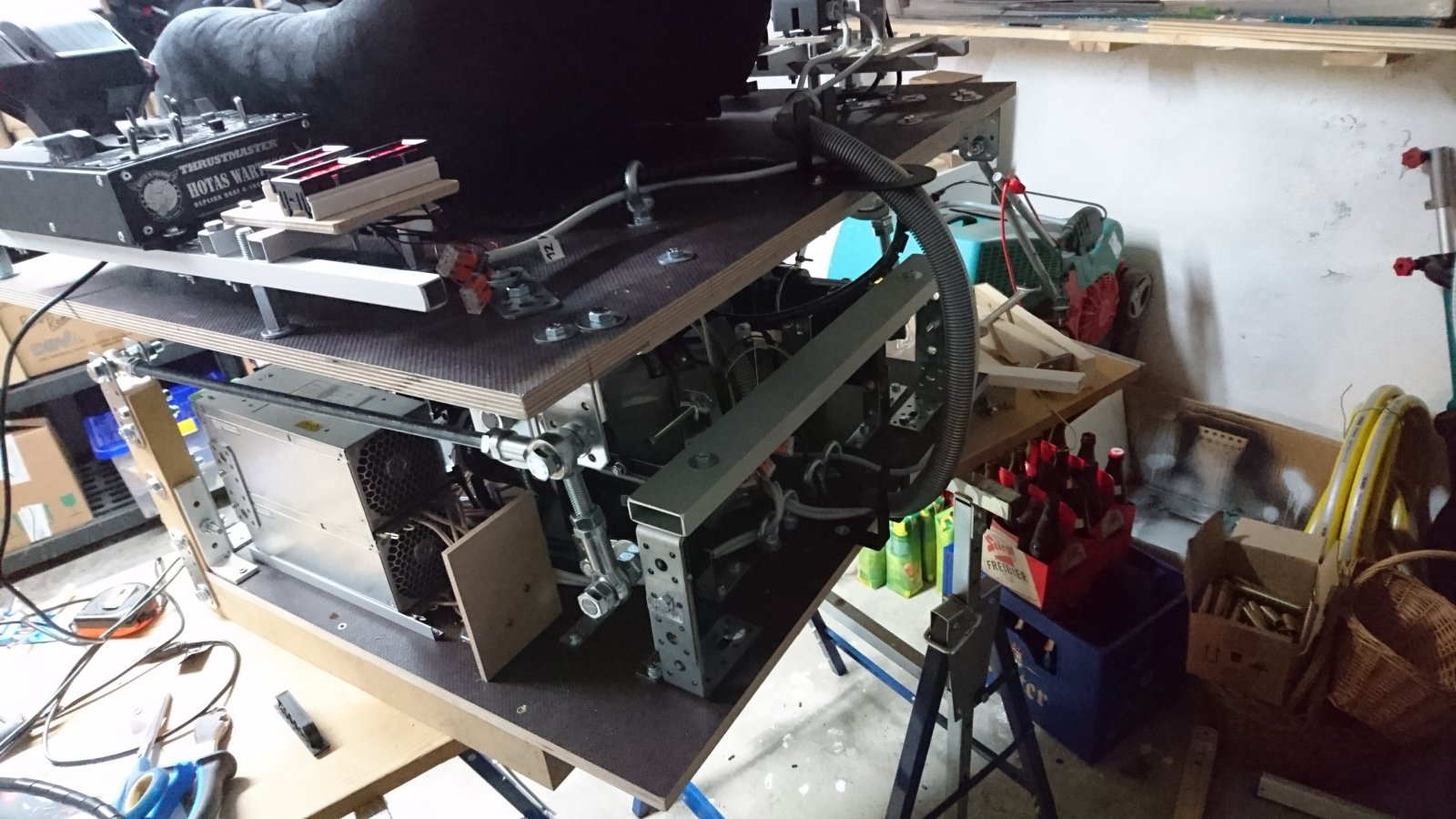

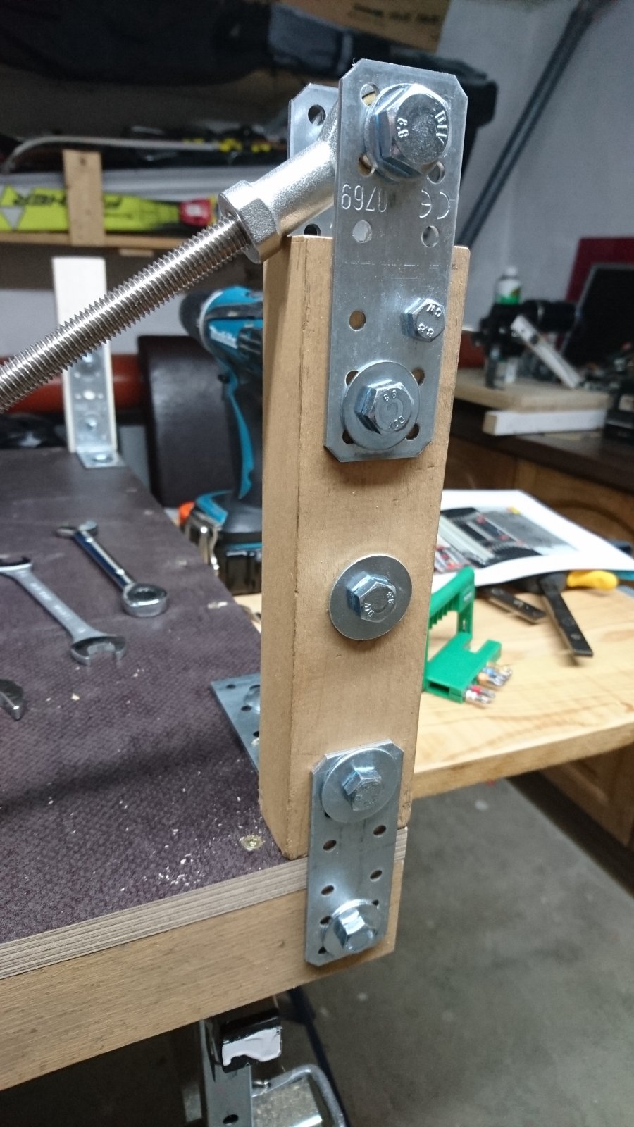

    I took over the principle of Simukit for the platform. Only with 3 motors. So all 3 motors can rotate freely, without damaging anything, should that happen once.
  5. Papapetrus
    Feb 20, 2018
    84
    Austria
    61Coins
    +47 / 0 / -0
    2DOF, 3DOF, Arduino

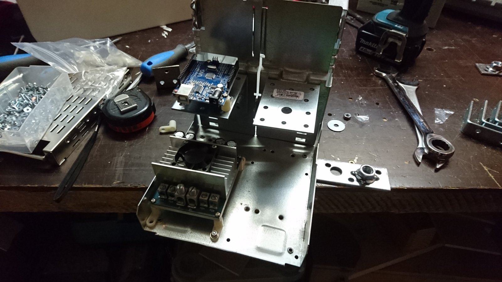

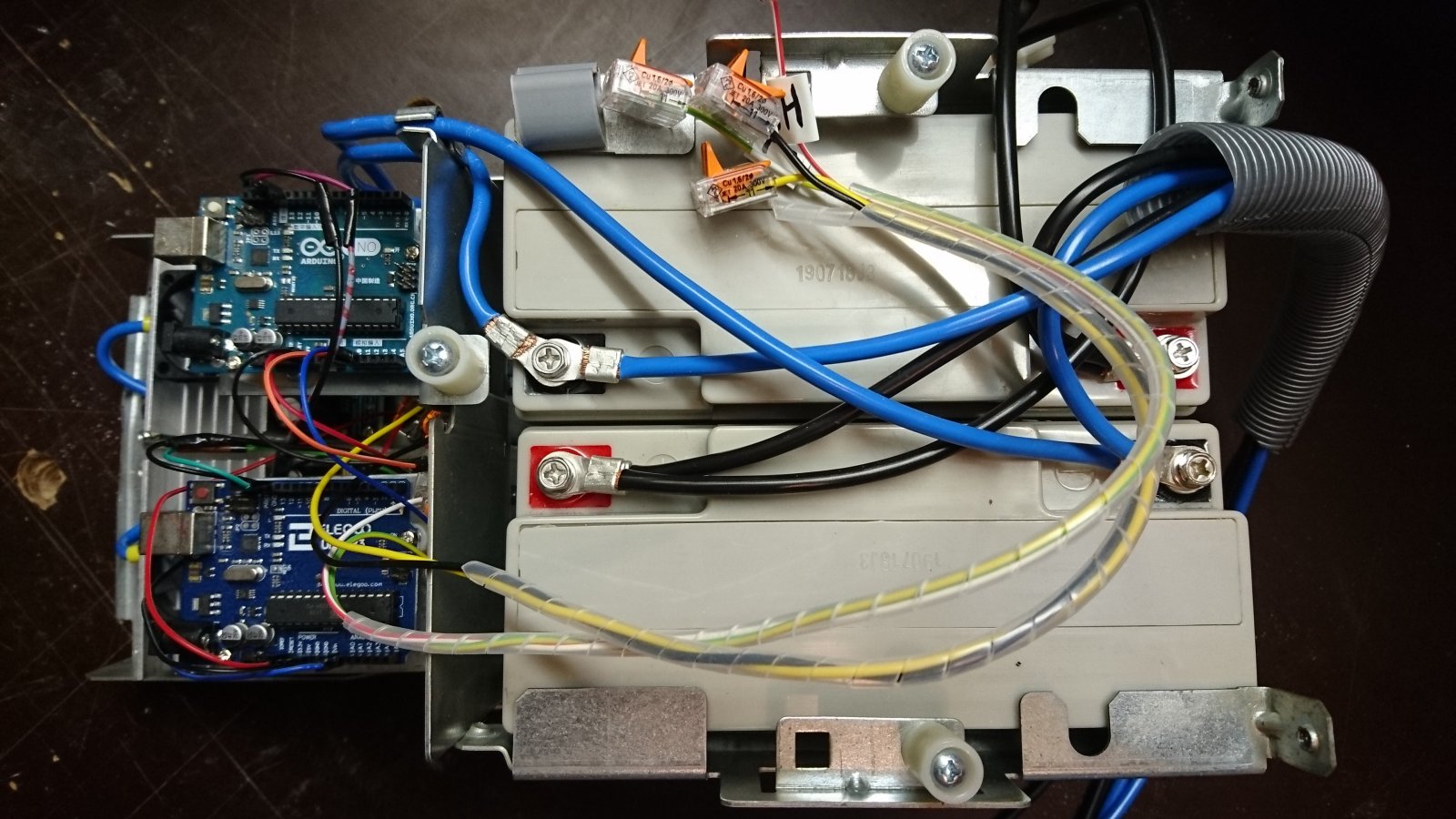

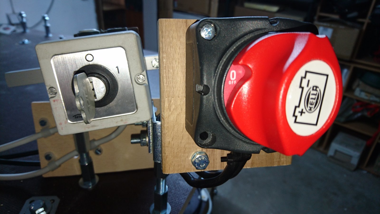

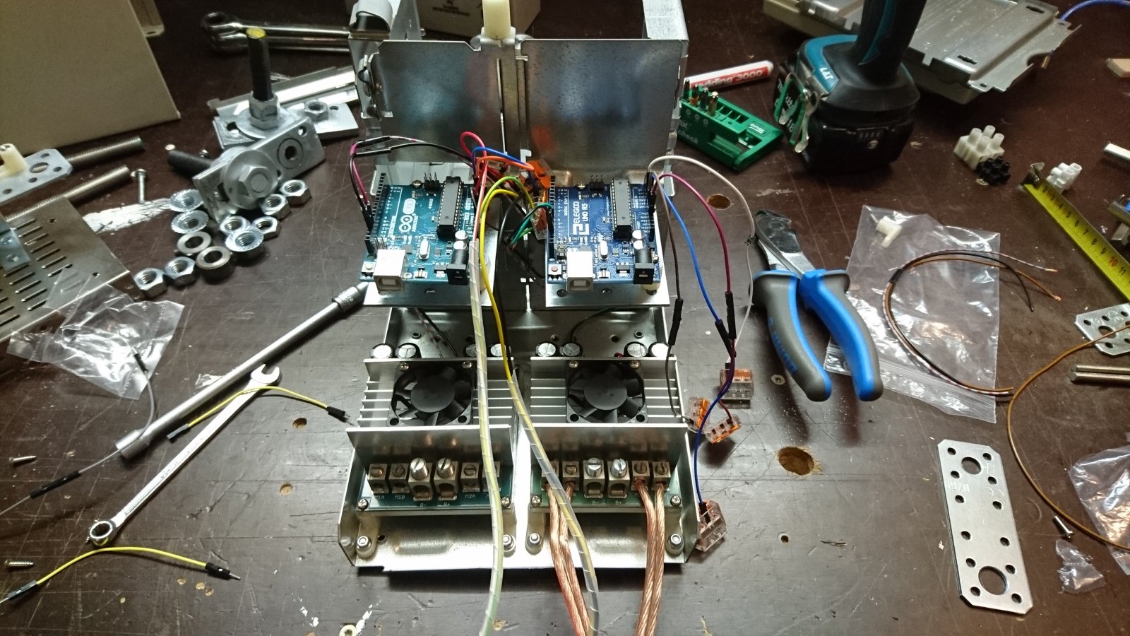

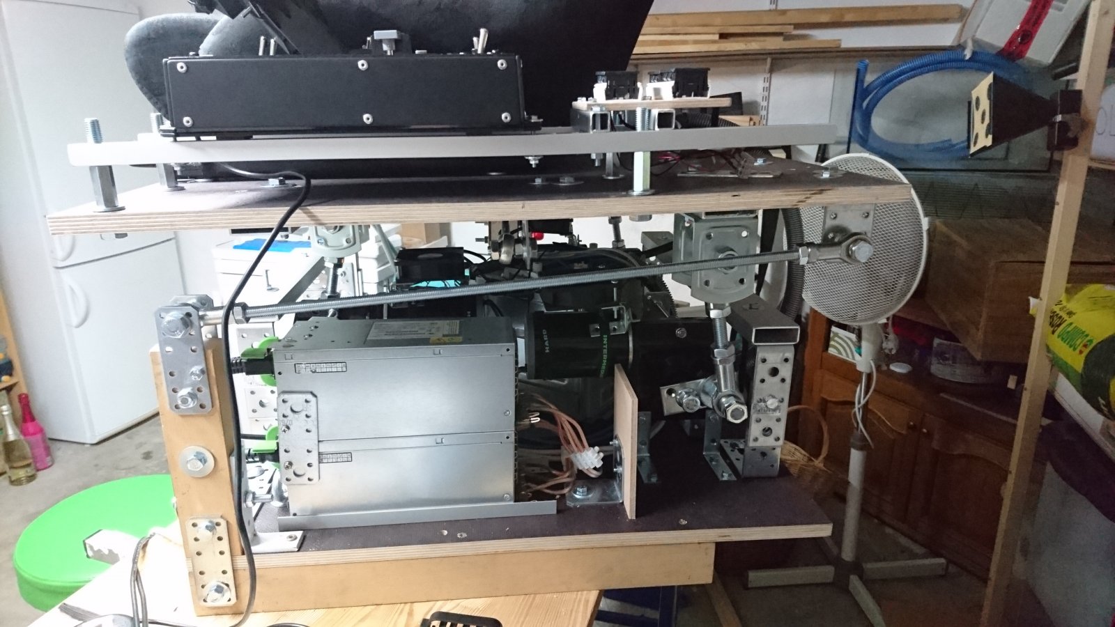

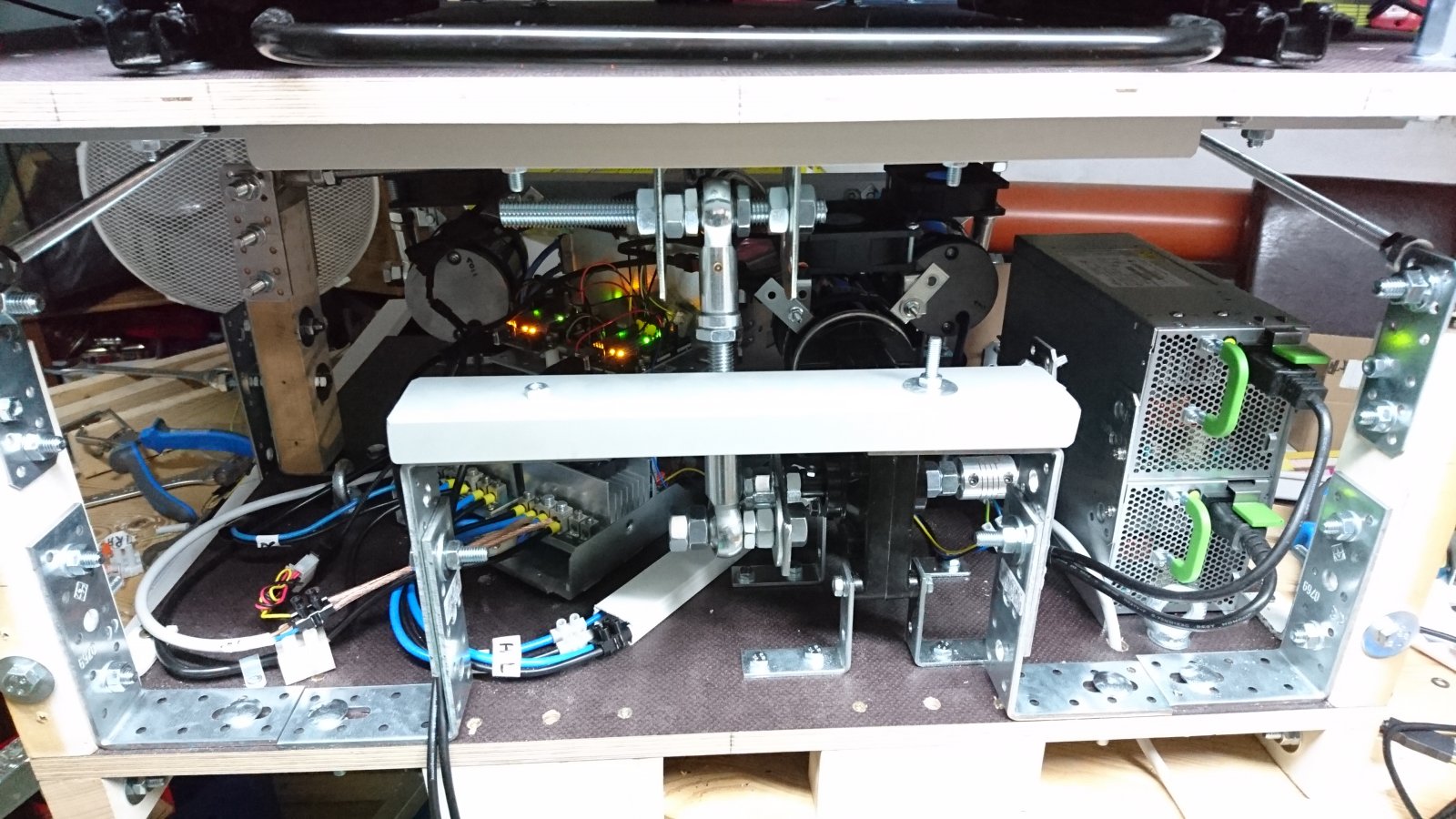

    The electronics I have now installed under the seat. In an old UPS case.
  6. Papapetrus
    Feb 20, 2018
    84
    Austria
    61Coins
    +47 / 0 / -0
    2DOF, 3DOF, Arduino

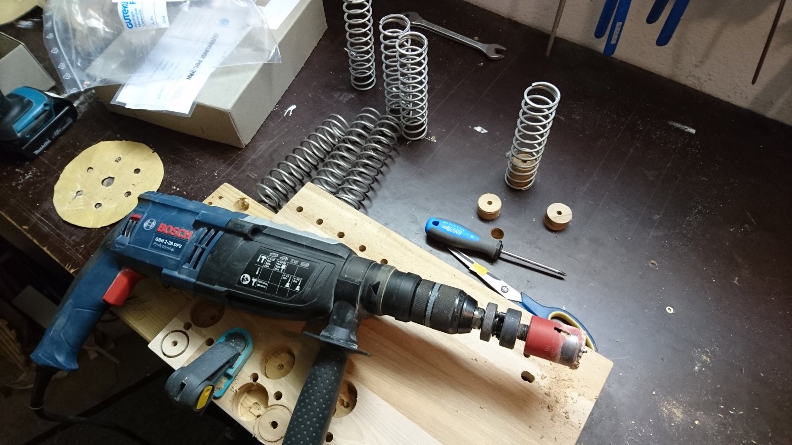

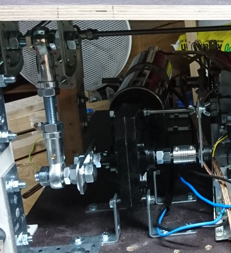

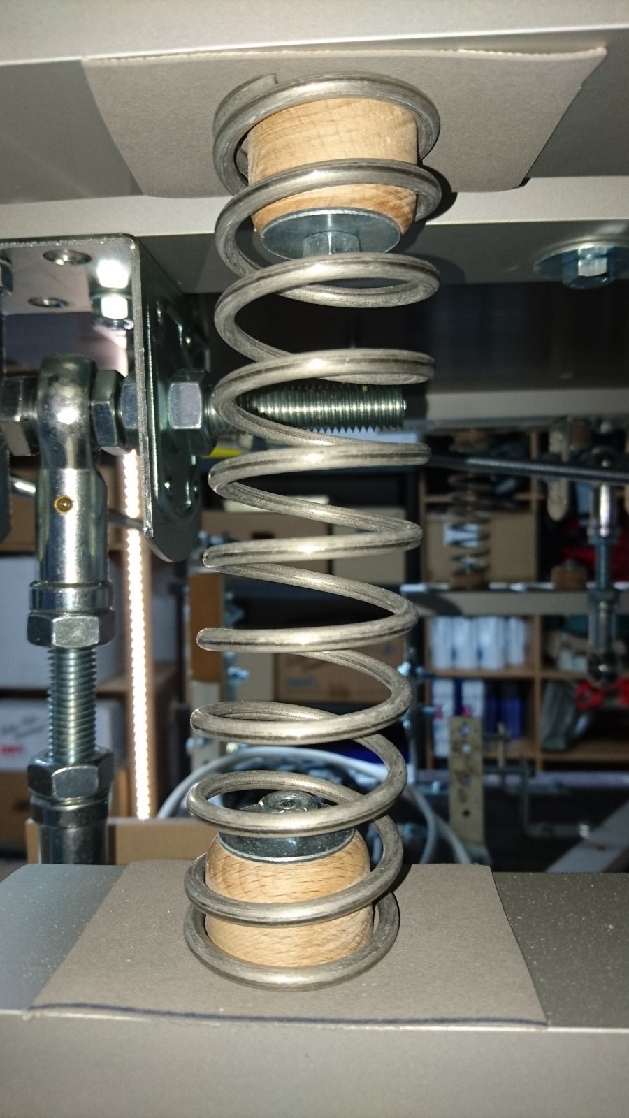

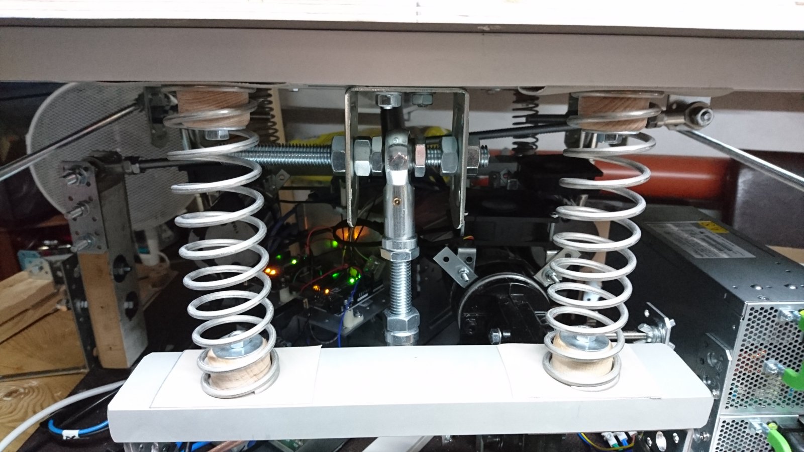

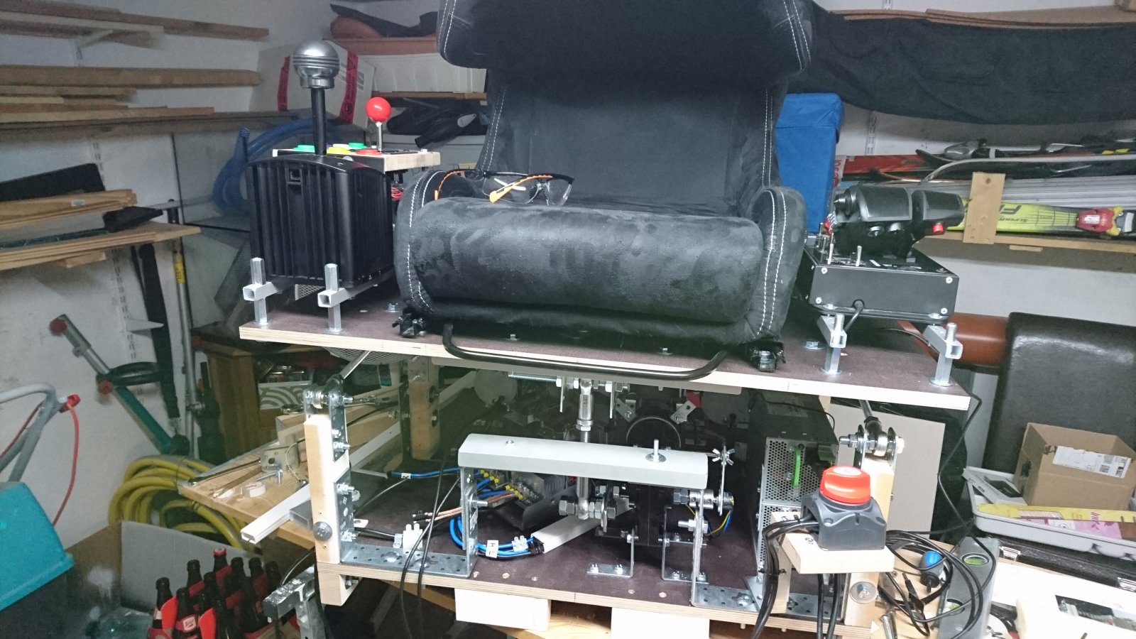

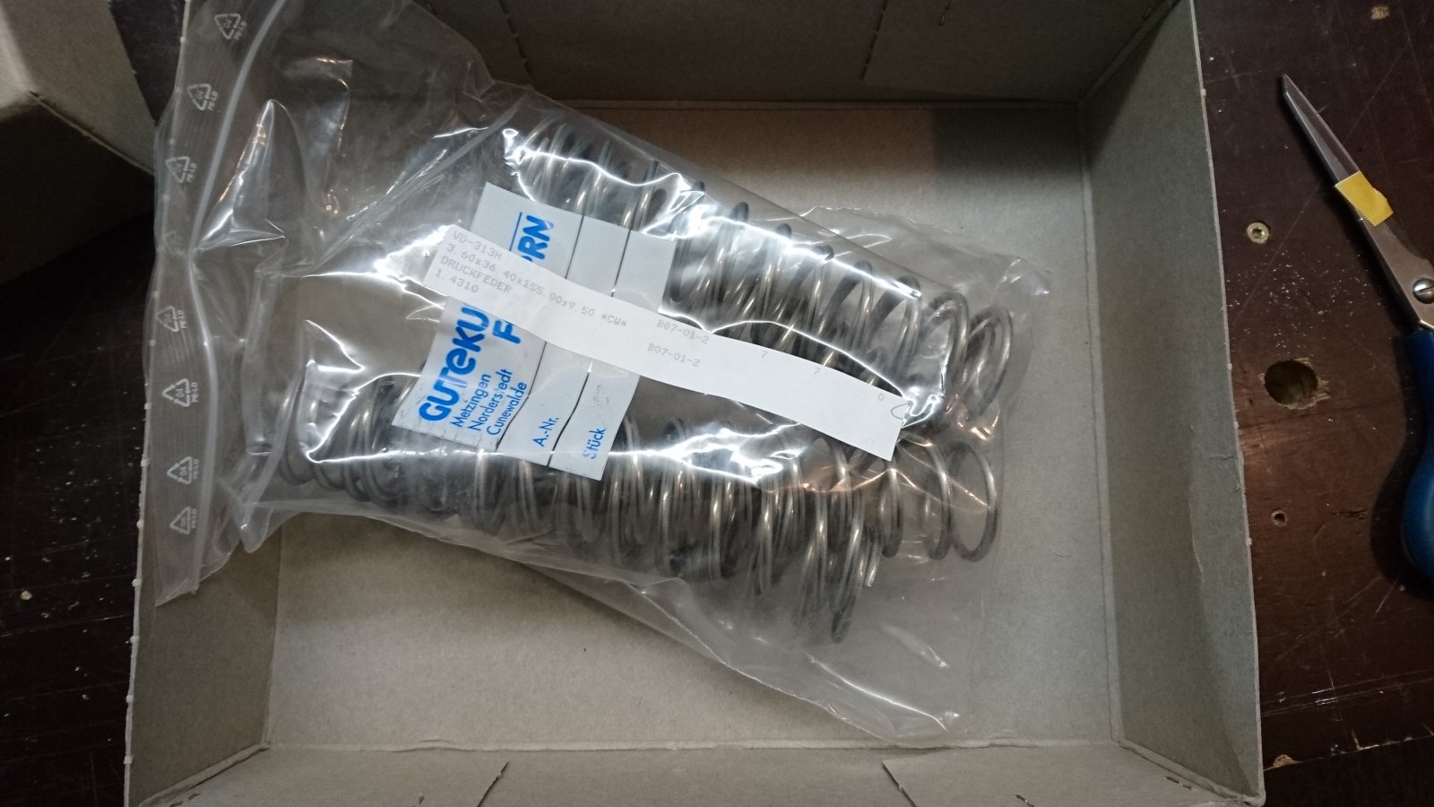

    I support the engines with 4 springs. 2 front for the engine in the middle and one for each engine behind
  7. Papapetrus
    Feb 20, 2018
    84
    Austria
    61Coins
    +47 / 0 / -0

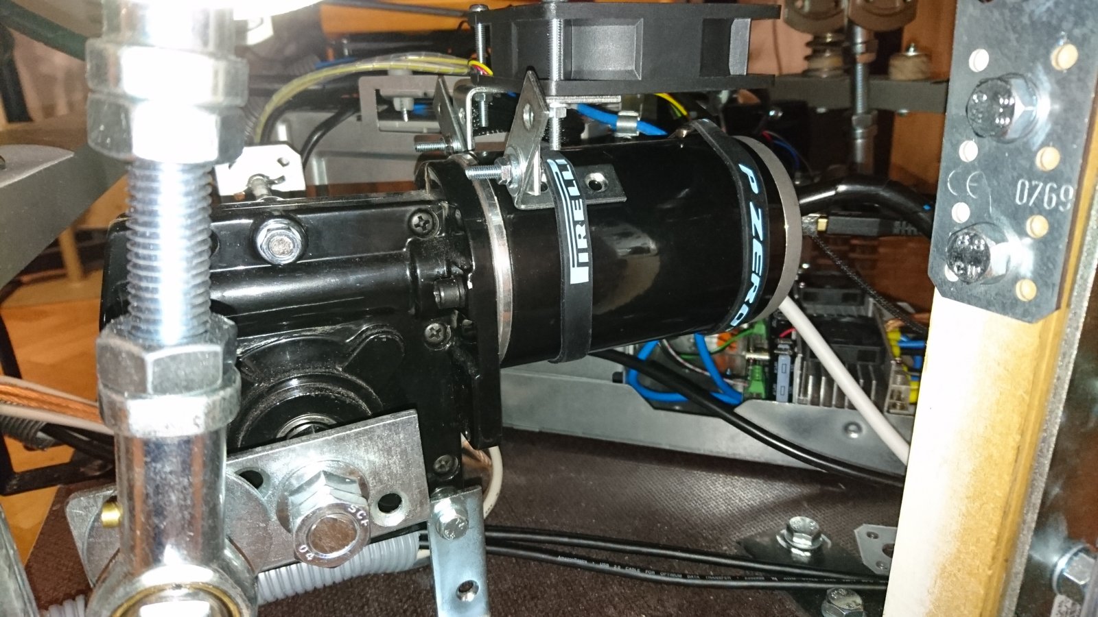

    2DOF, 3DOF, Arduino

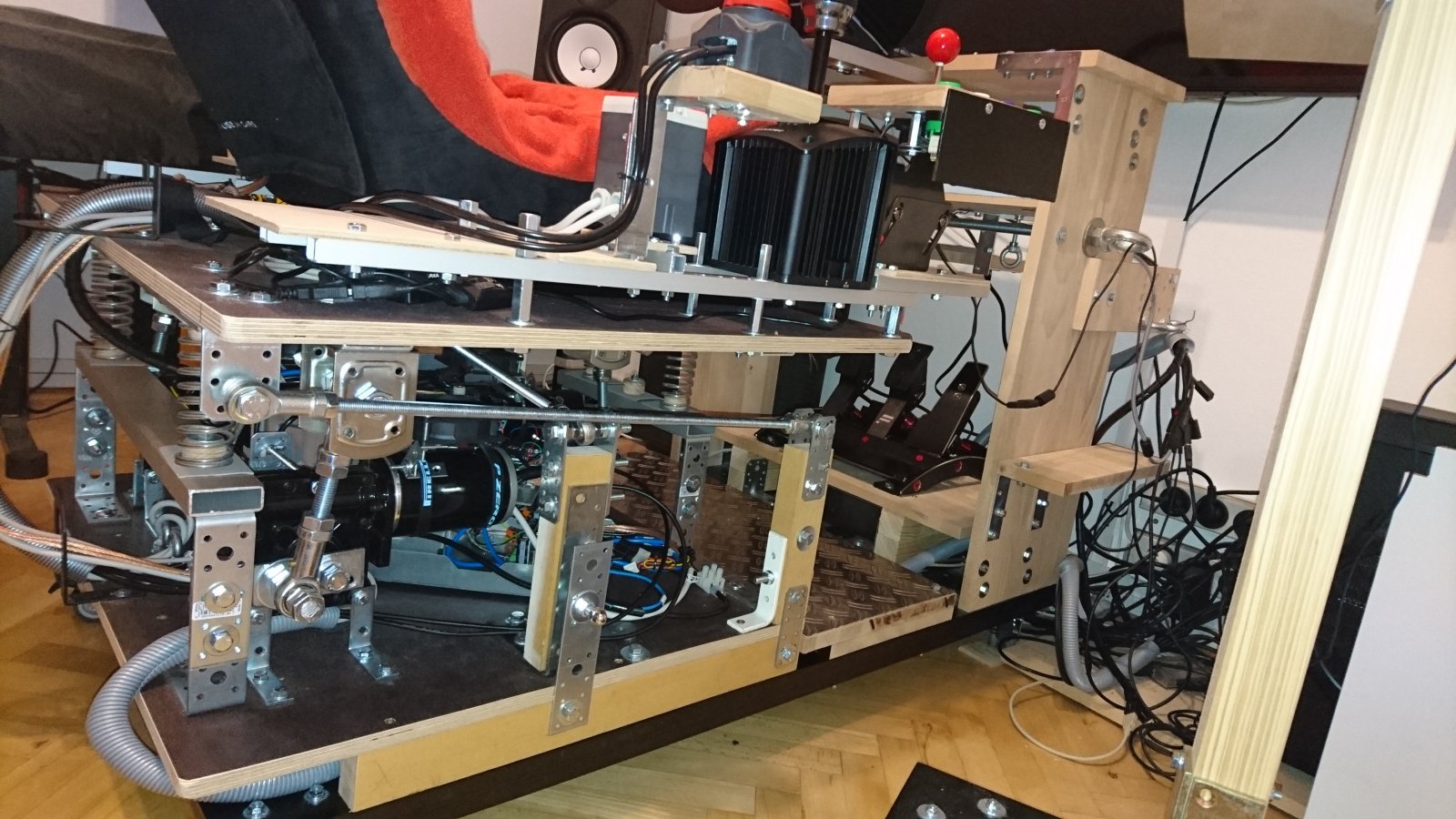

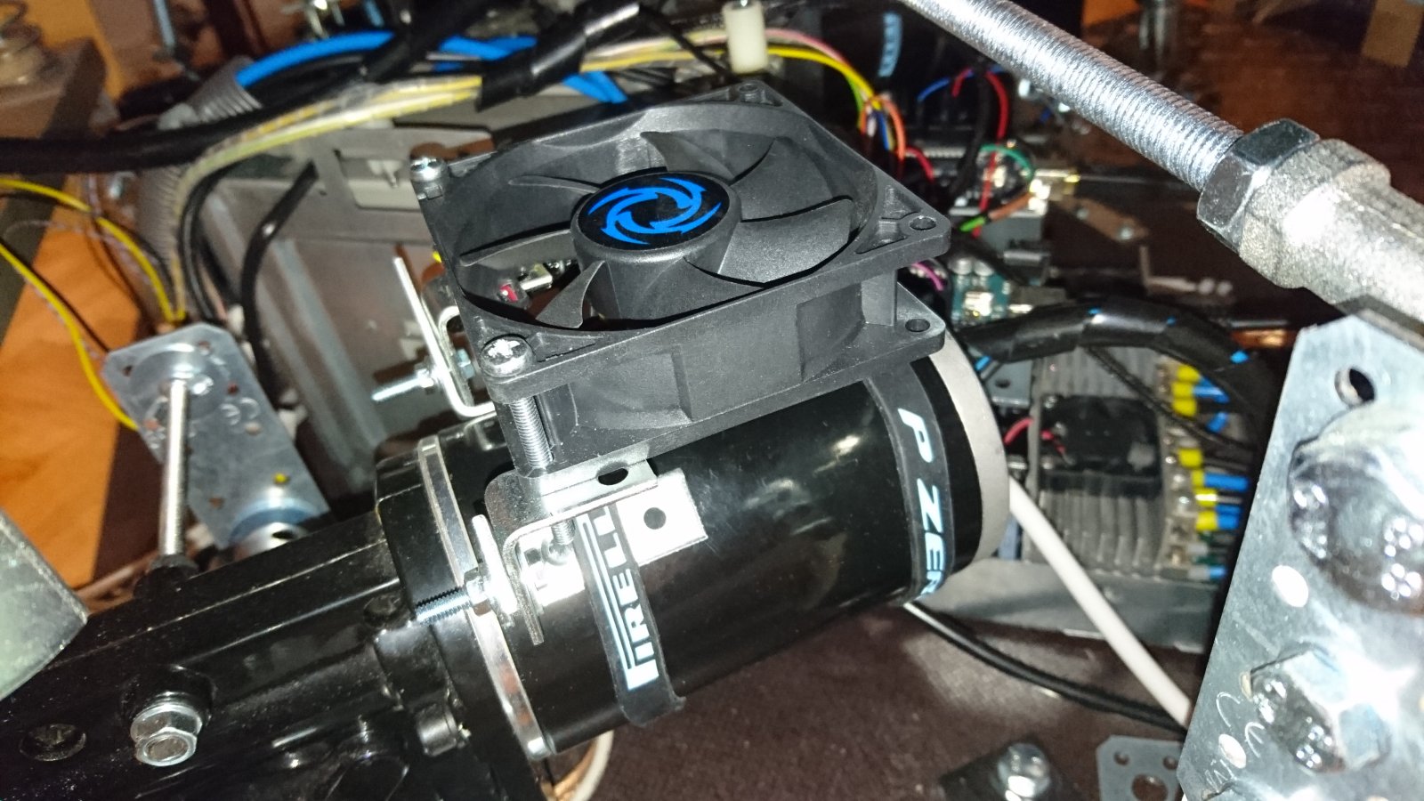

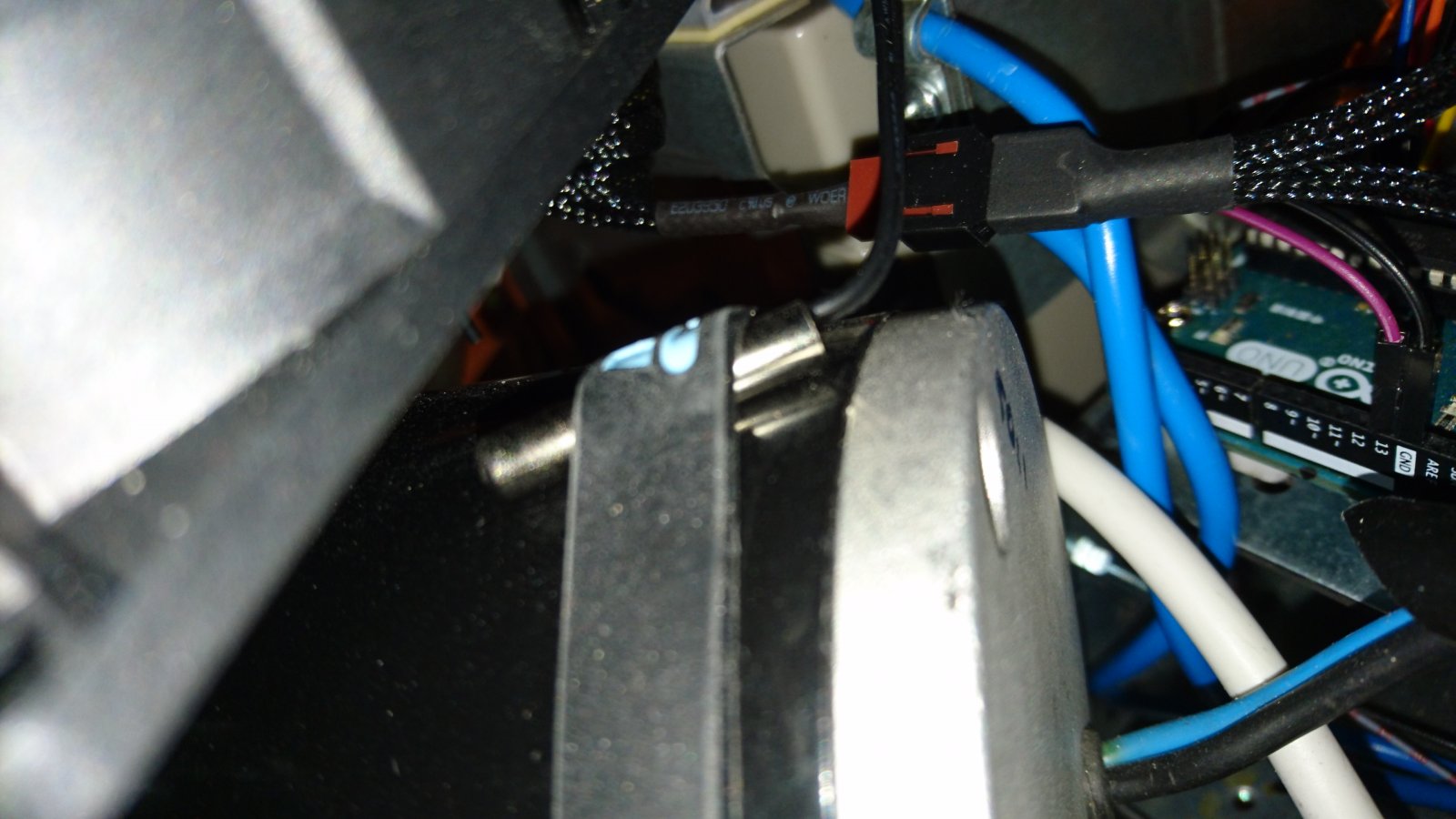

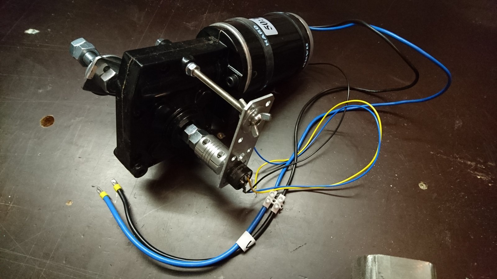

    3 motors of PGSAW 50: 1 with potentiometer 6127V1A180L.5FS
  8. Papapetrus
    Feb 20, 2018
    84
    Austria
    61Coins
    +47 / 0 / -0
    2DOF, 3DOF, Arduino

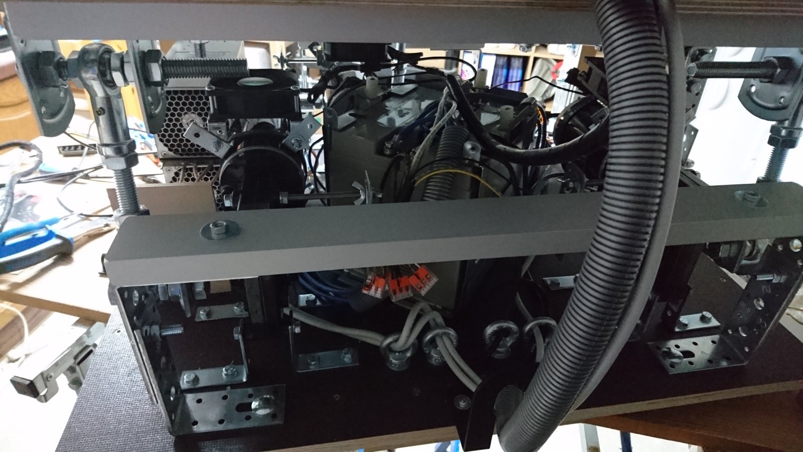

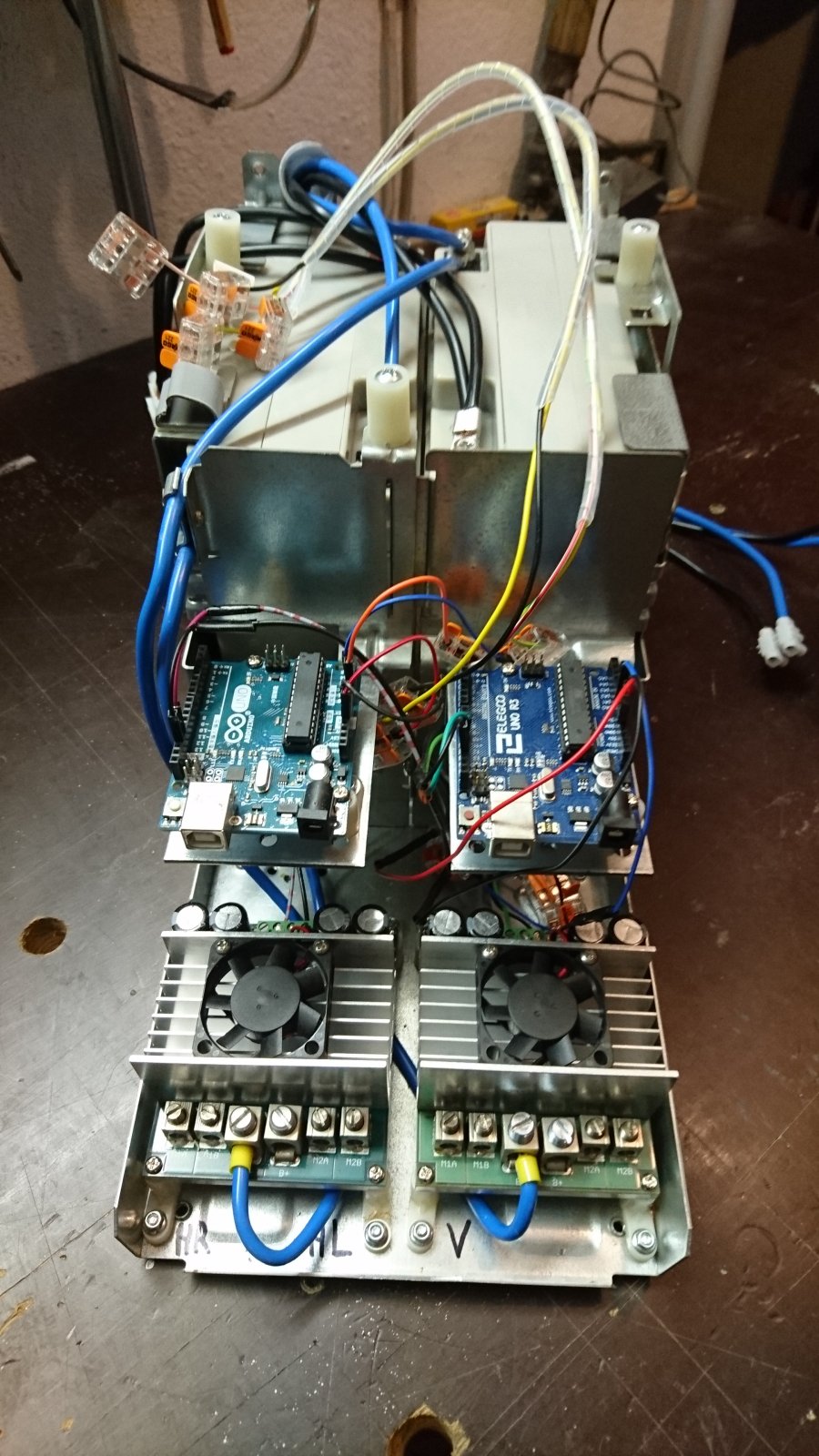

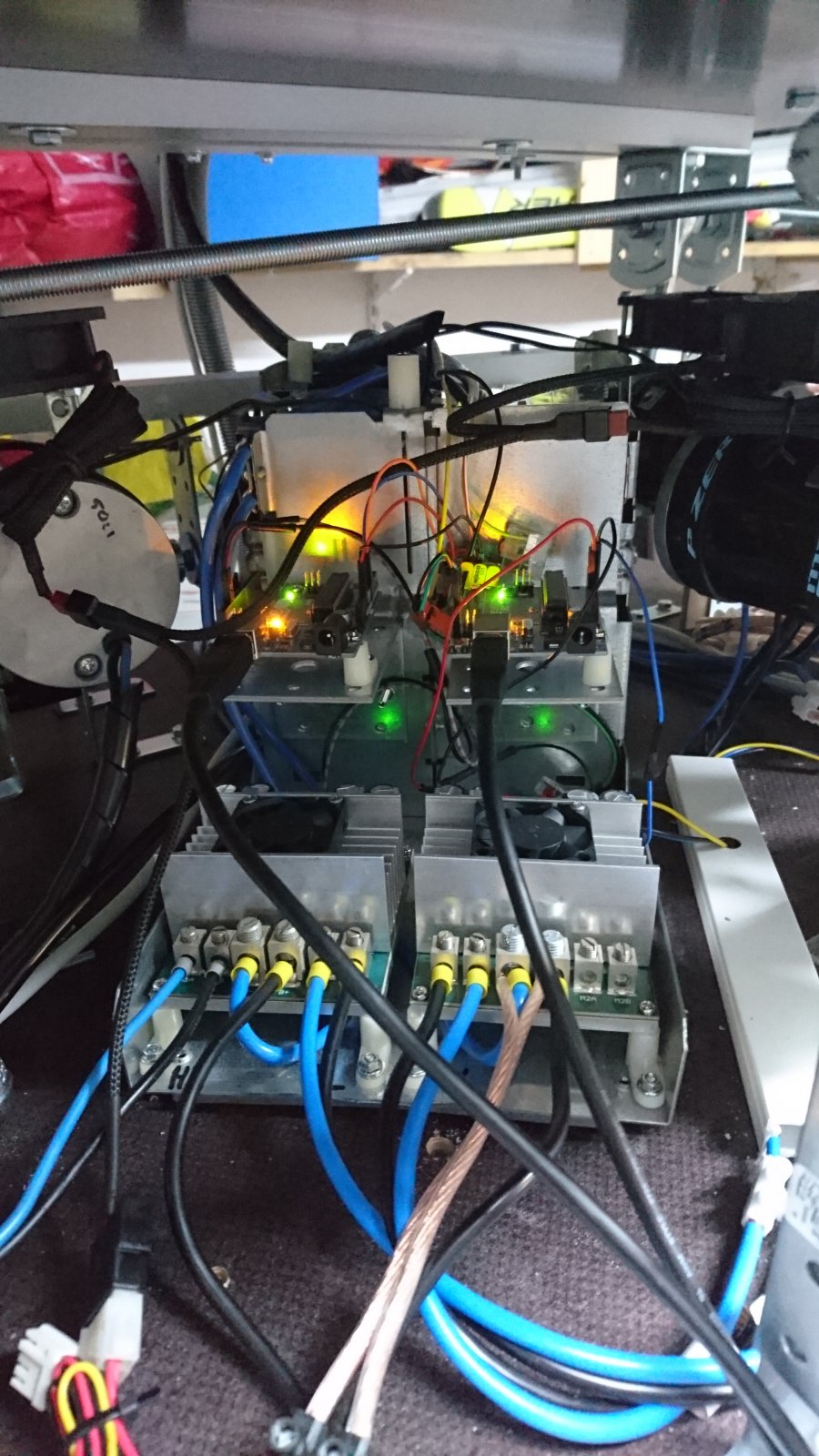

    The whole electronics

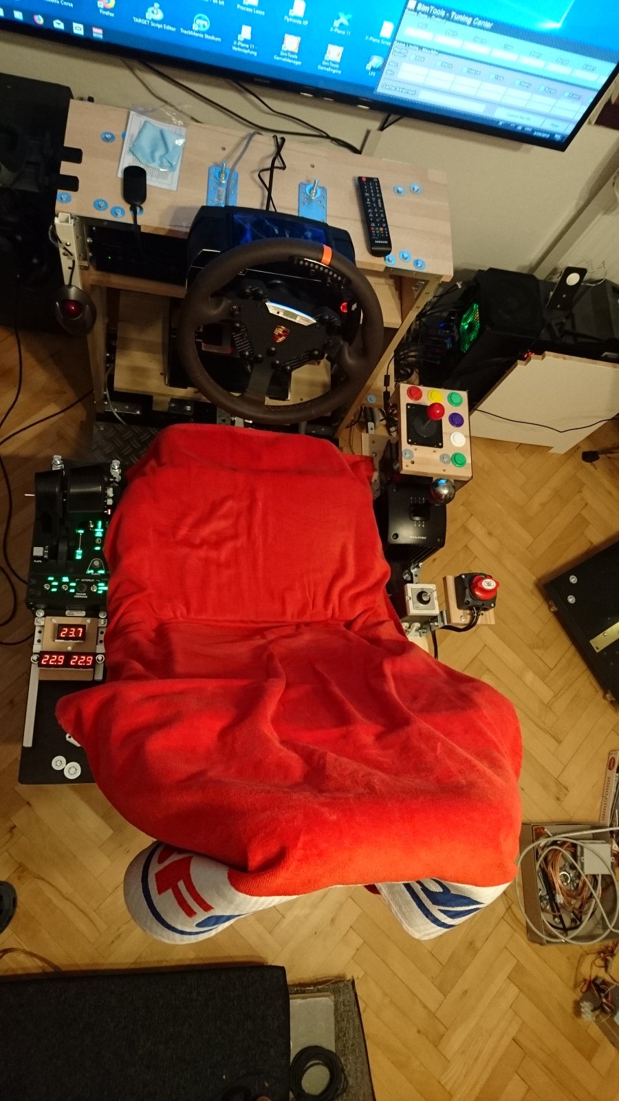

  9. Papapetrus
    Feb 20, 2018
    84
    Austria
    61Coins
    +47 / 0 / -0
    2DOF, 3DOF, Arduino

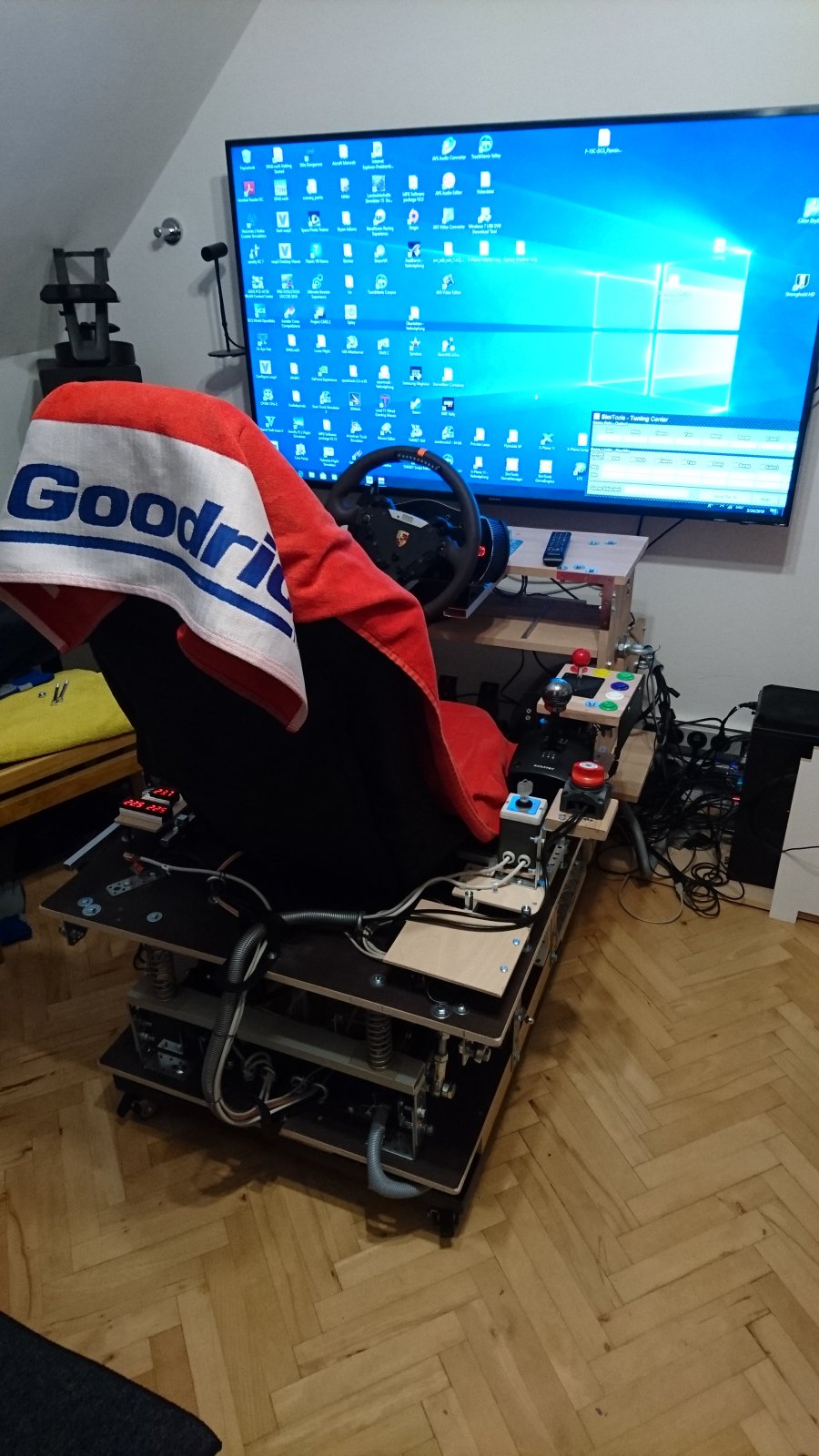

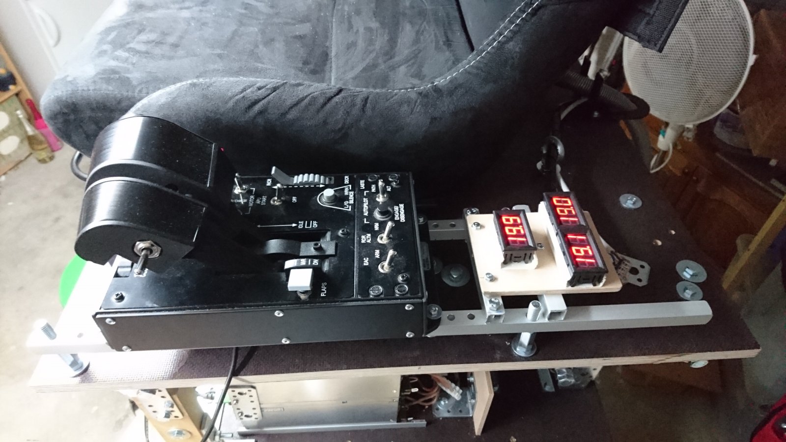

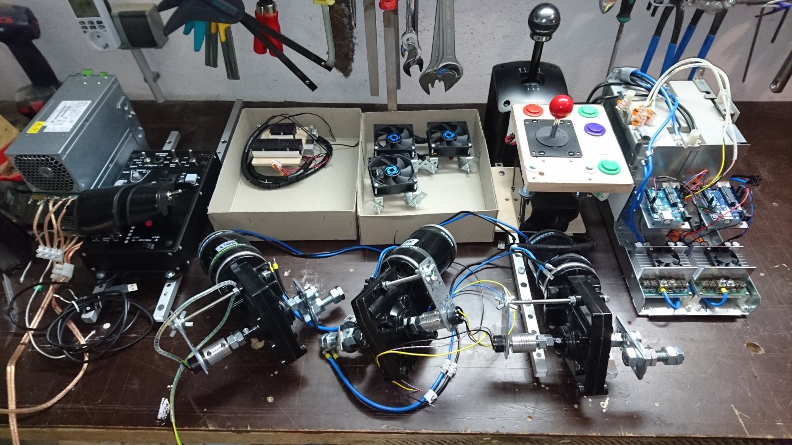

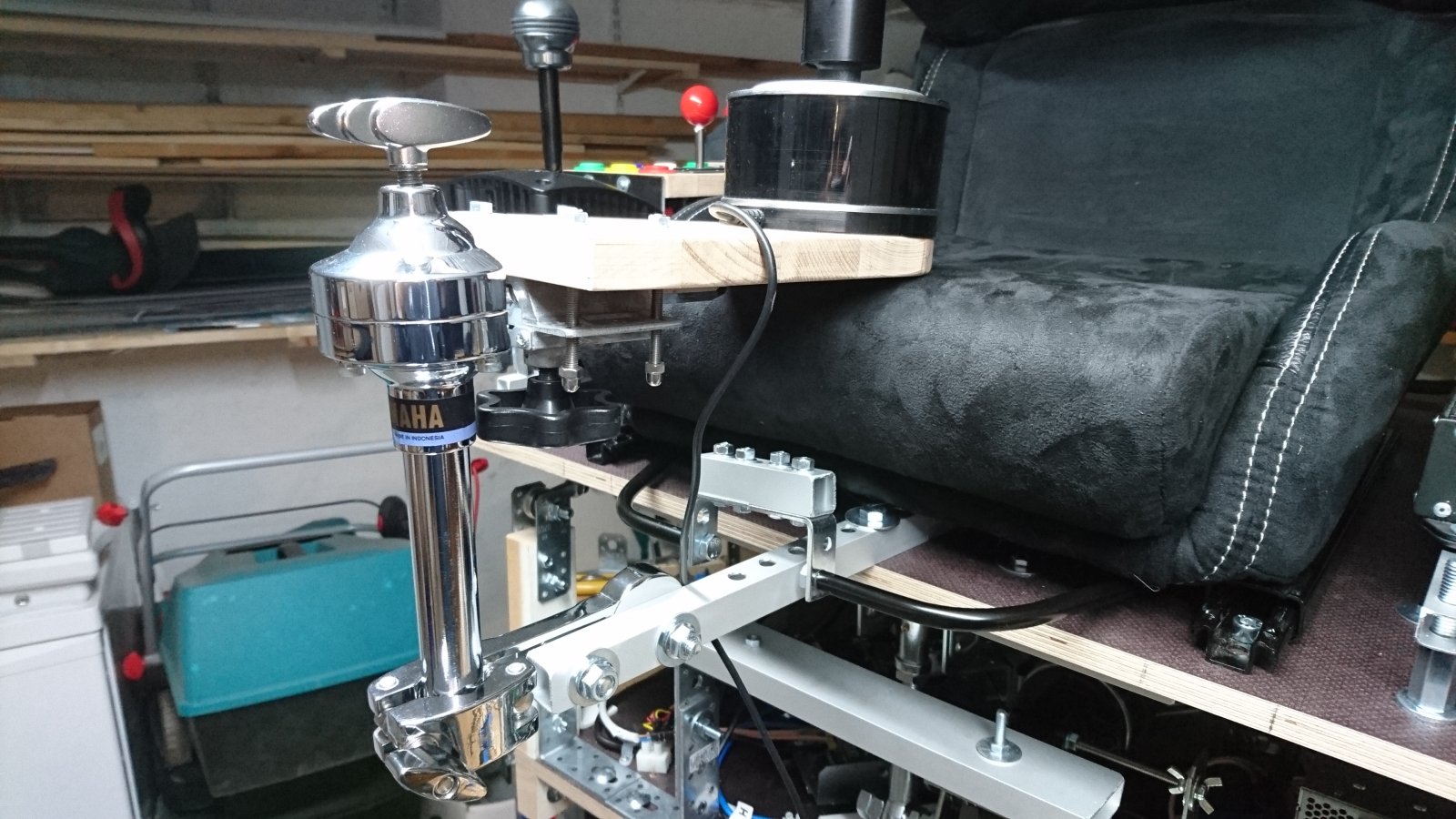

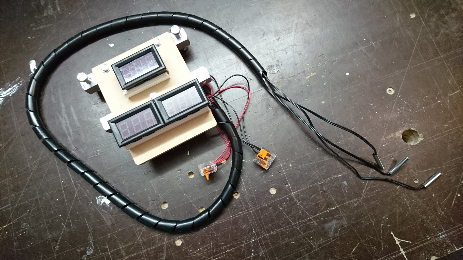

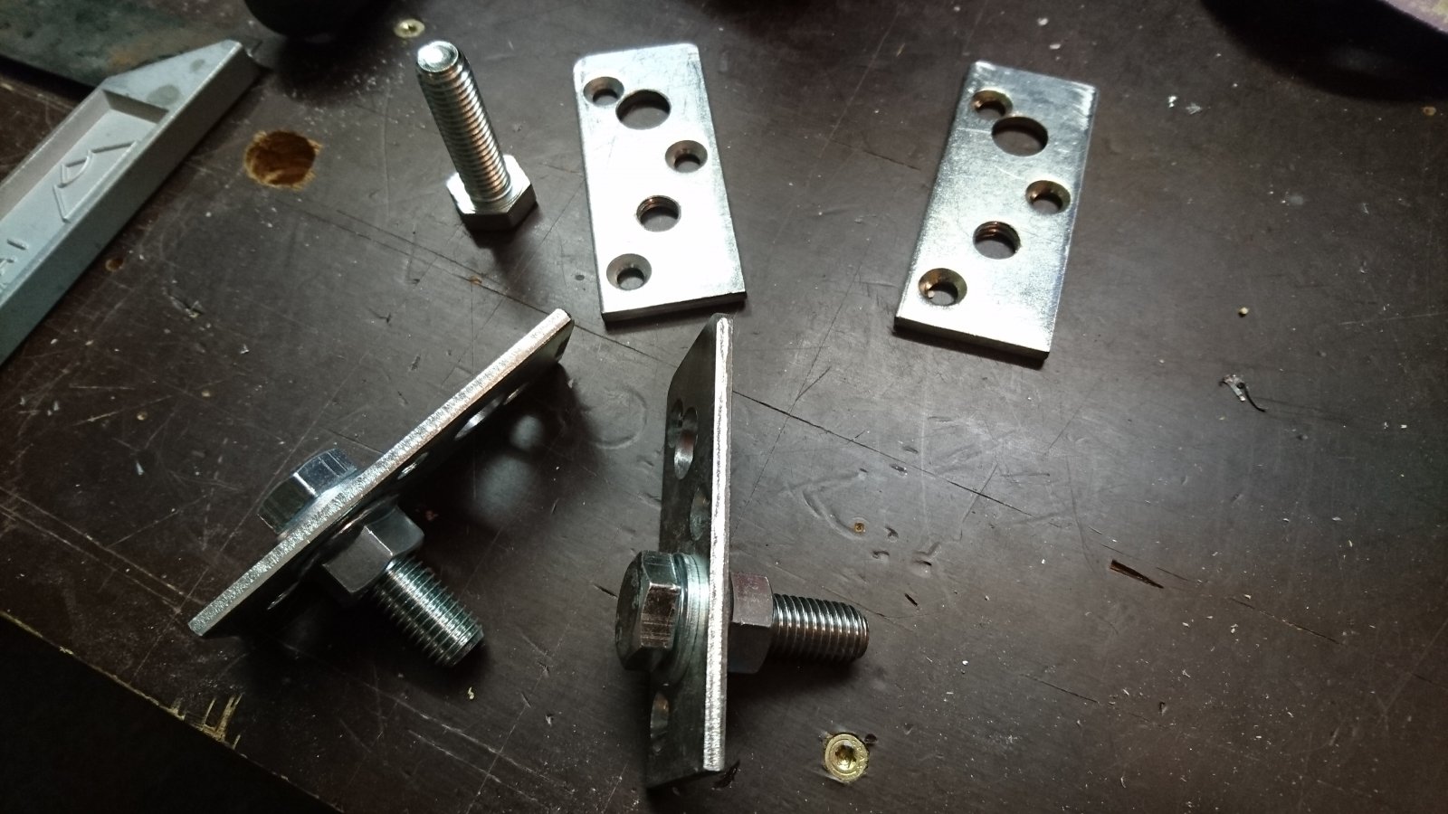

    and the rest of the pictures
  10. Papapetrus
    Feb 20, 2018
    84
    Austria
    61Coins
    +47 / 0 / -0
    2DOF, 3DOF, Arduino

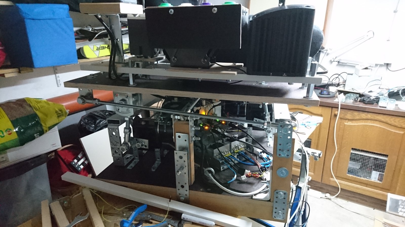

    more,...

    sweet conversion. i have a 2 dof myself and needing to get started with my conversion. what is the spring weight for each one?

    But I have to thank myself, because without the many contributions and help from the forum I would probably still play with steering wheel and Joystik at the desk.
    About 90% of the ideas come from the forum !!
    Thanks all :)
  18. Josh_Possa
    Josh_Possa Active Member
    Jan 25, 2021
    126
    Catalunya
    541Coins
    +35 / 0 / -0
    2DOF, 3DOF, DC motor, Motion platform
