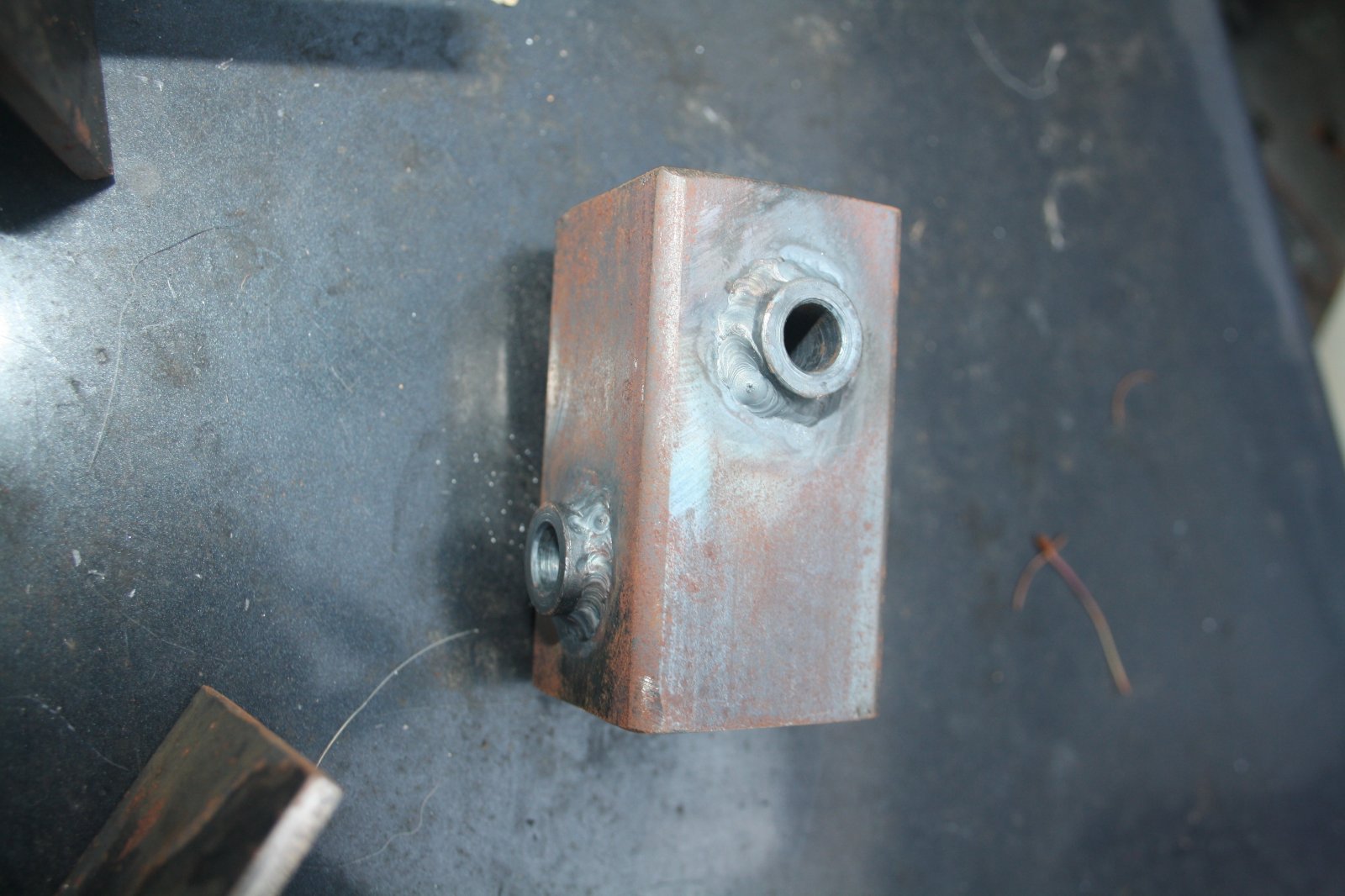

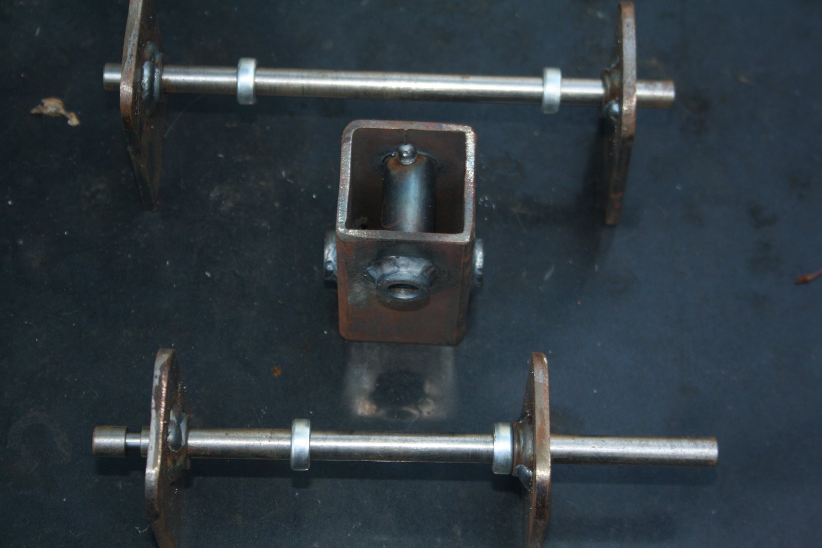

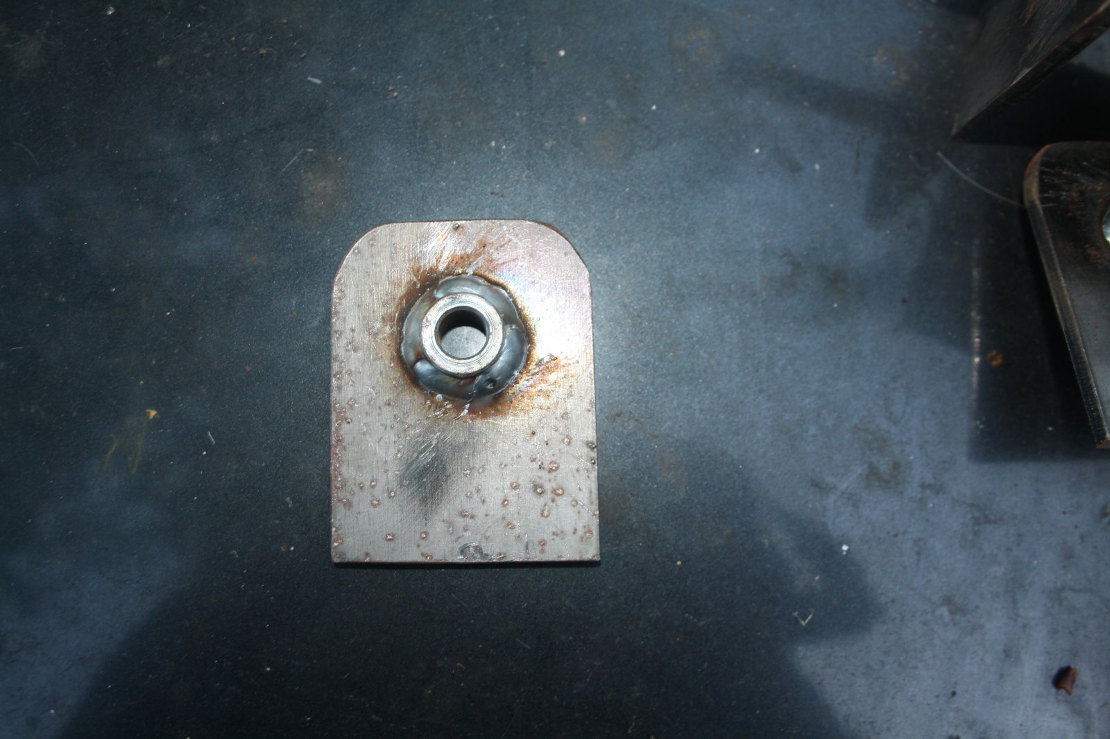

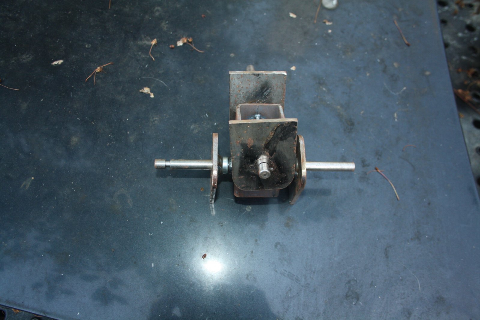

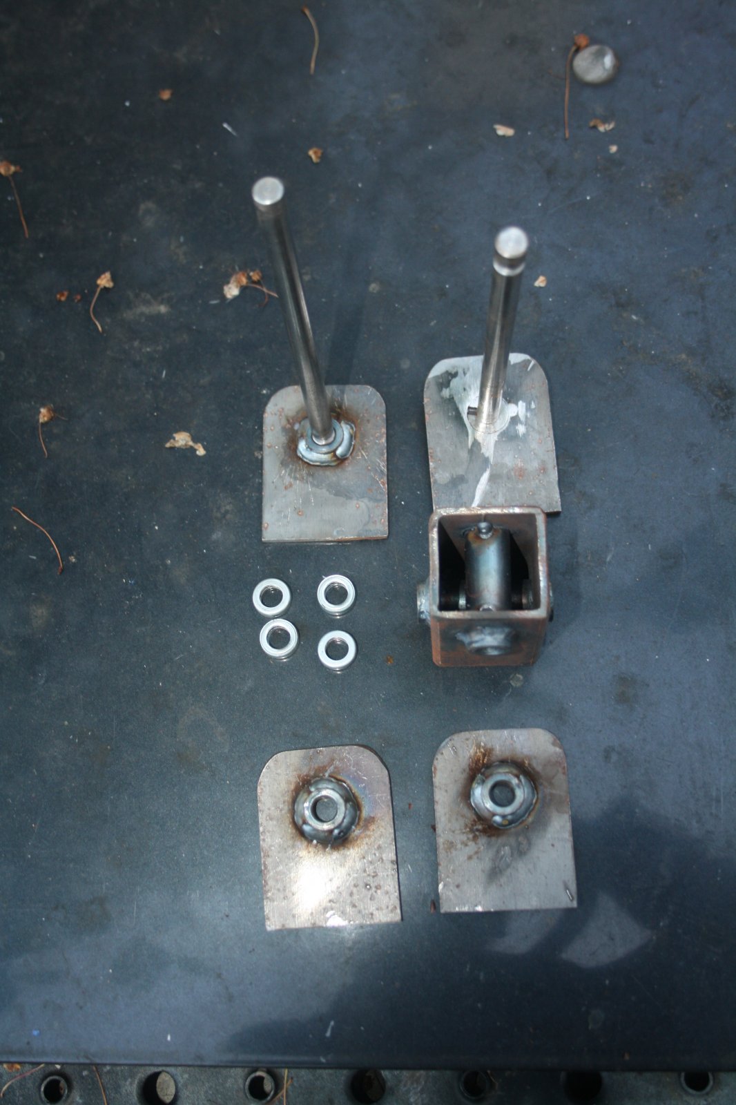

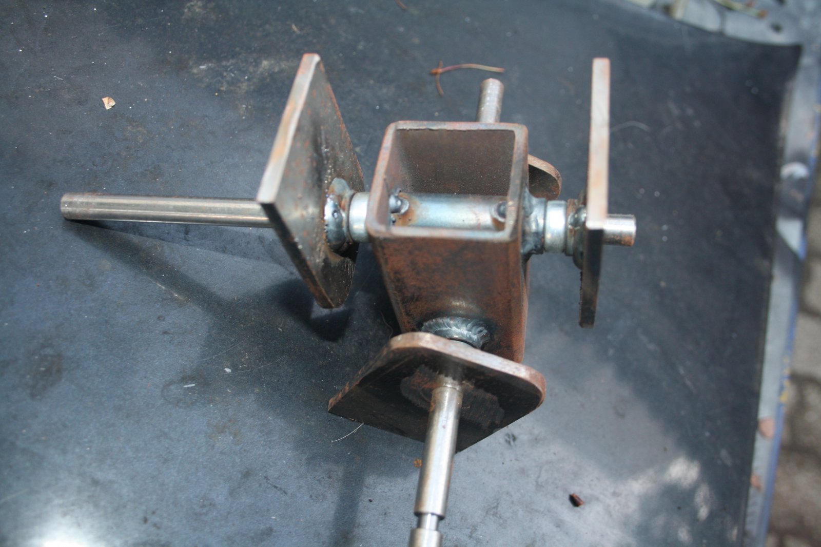

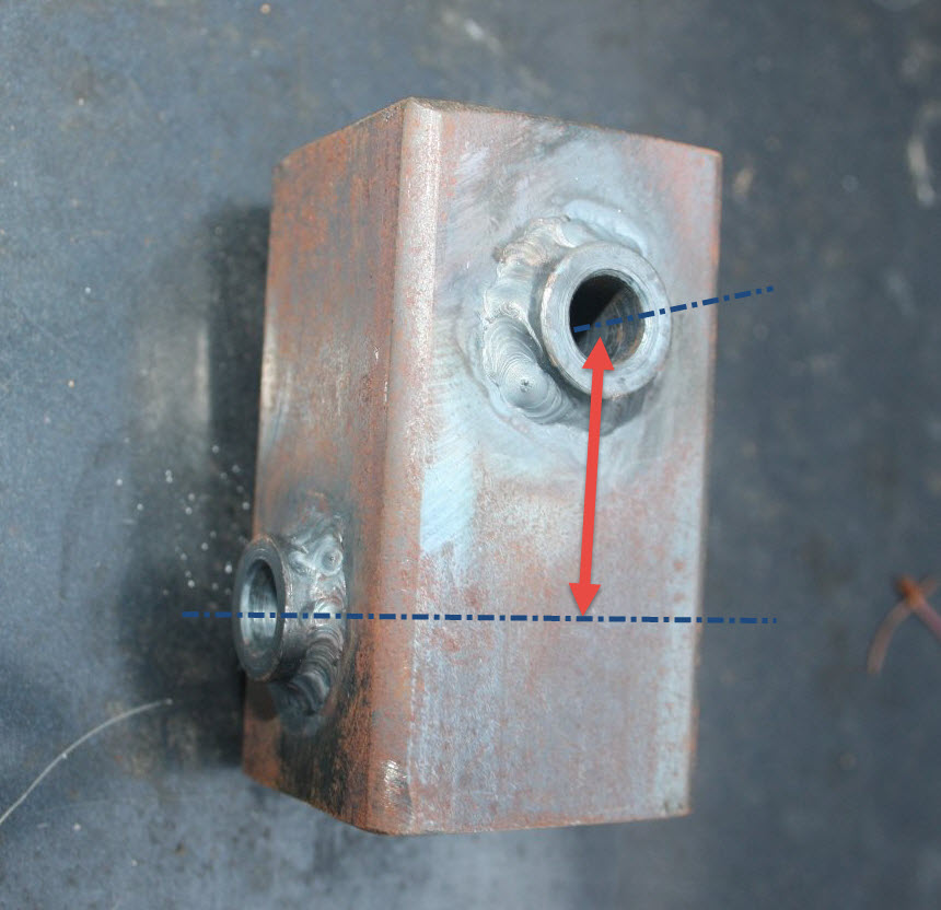

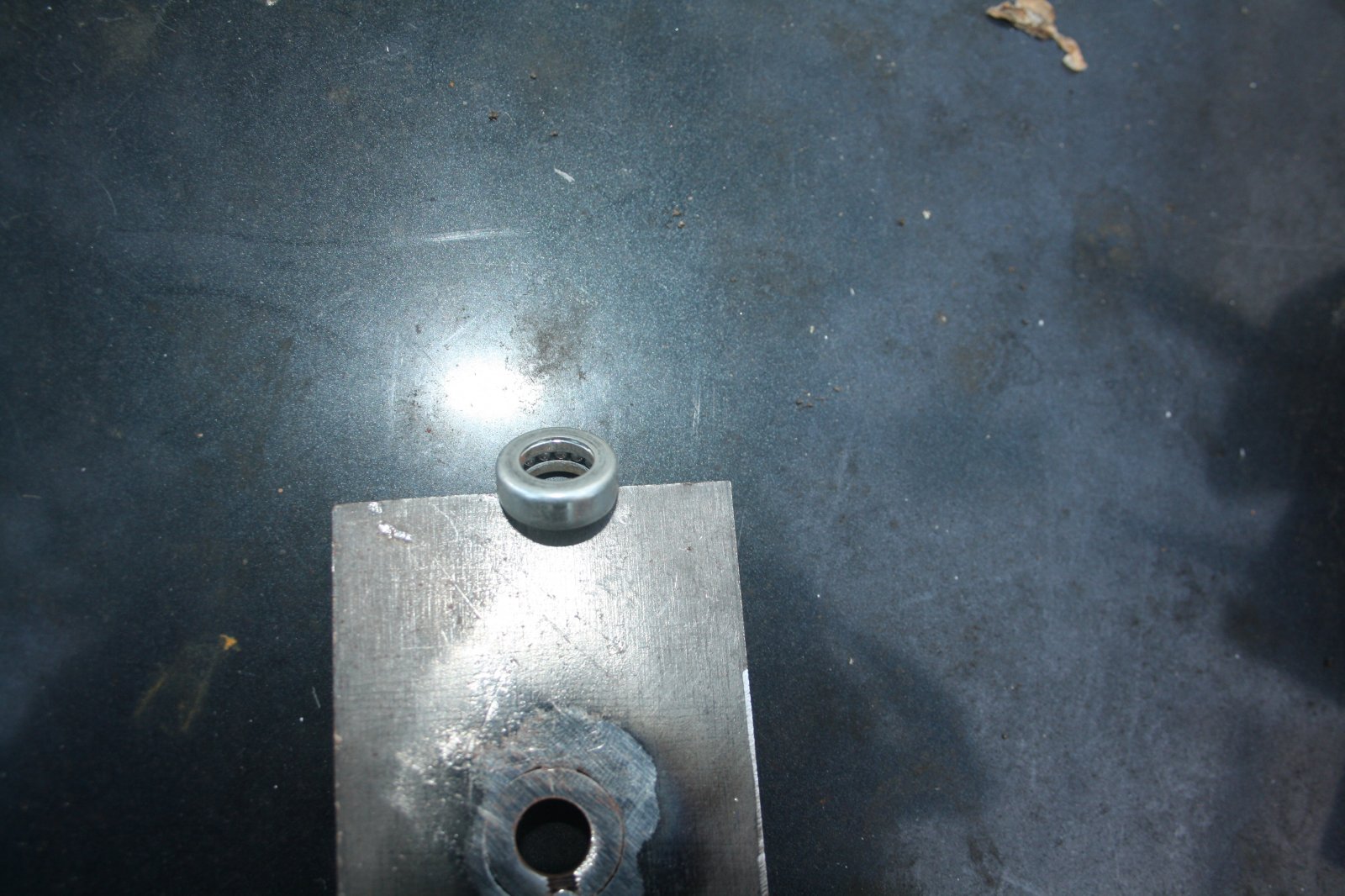

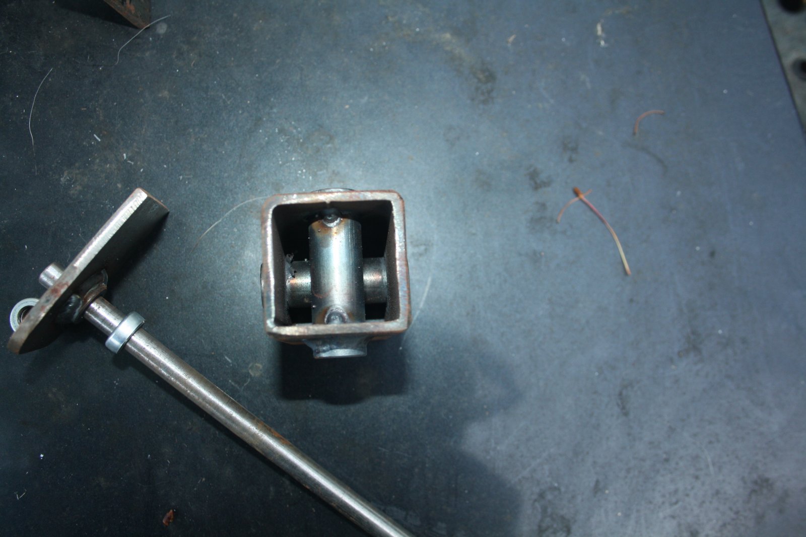

    Home made articulation for race sim seat,parts are made for direct weld!

    great idea to make a joint like that, respect!:nerd

    your welding skill is excellent!
    the gap between the two axes should be reduced as much as possible. The gap induces some inopportune parasitic movements.

    Thanks for the tip @RacingMat ,i check that i can aproach 1cm ,this is for upgrade my seat and i will do other (cardan pipe) pics soon!:thumbs
