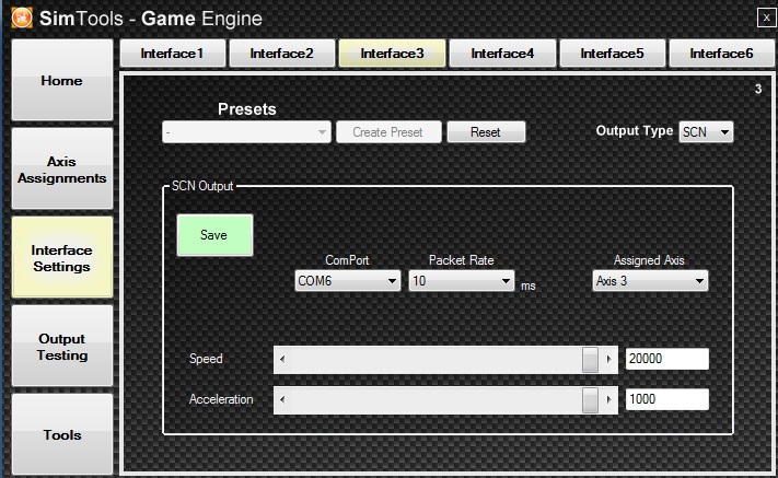

    Hi
    I have it in a position to give it the maximum travel...but the fact is that not always this problem happen in such a pronounced way...it used to travel the plates, but neve outside them and getting stuck...maybe my default config is the cause??...i'm always changing things...
    I agree with you prodigy, it would be nice to have that option.
    here goes my interface settings (if i understood correctly)
    THANKS

    Your settings look fine btw, I used to run my scn5 sim rig like this all the time!
    I even used a packet rate of 1.

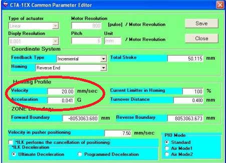

    I stumbled upon this thread looking for the start-up or limit options as well. A couple reasons why I was looking for this. My rig has no problem going full travel to calibrate on simtool startup but is there a way to slow it down? Despite having relatively slow acceleration in my config, the initial calibration rolls the axis quite fast which seems a little violent (too strong a word perhaps.. maybe 'harsh').
    I have all my roll and yaw axis travel limits turned down because you don't need much yaw travel, too much will make you sick and isn't realistic, and sometimes when I roll all the way I get 'stuck'. I don't feel comfortable using the full travel roll anyway as it feels like all my weight is on one side.. too much so.
    Lastly, I have a hook to hang my Oculus DK2 on when I'm finished with it and so I can get in/out of the sim without having to worry about bumping it, etc. However when it's hanging and I start up simtools, the initial calibration throws the Oculus around hanging from it's straps banging it against the monitors. If it did it slower I could keep my Oculus there and it wouldn't swing hard enough to hit anything.

    I found a solution to my particular issue. Using the TBVST.exe utility for the SCN6 config I was able to lower the homing speed for each actuator resulting in a slow, smooth calibration. The homing speed for the SCn6's (and maybe 5's?) are stored in a firmware on each actuator and not controlled, in this case, by Simtools.

    I'm not to sure this is correct, because when I wrote the homing routine, I had to select a setting for both the Speed and Acceleration.
    I chose to use 1/2 for each. If it was built in, how was I able to select any speed and acceleration for my homing routine?
    Are you sure you did not change the speed of the overall actuator?

    Yobuddy.. yup as far as I can tell the performance is the same. The setting only seems to slow them down when it's initializing. Once it extends all actuators it does 'snap back' to the 'center' position the same old speed. I'll post a screenie of the setting and a video of it.

    Here is the screen from the TBVST.exe utility. I have highlighted the setting that I changed. My actuators all had different values for some reason so I changed them to be all the same. I reduced the speed from 20.00 mm to 5.00. Two of my actuators had the same acceleration value as shown here but one was 20g's or something crazy like that so I changed it to match what's shown here. All my actuators are now at 5.00 mm/sec and 0.041 G
    Even after setting this, the default profiles (without capturing min/max with Tuning Center) results in crazy fast motion.. unusable really. I haven't played around with 'Velocity in pusher positioning" as I have to be very cautious what I change here. A wrong value can disable your actuator! I'm unsure if that value would slow down the 'snap back to center' speed or not as that is the same speed it was prior to me changing anything. I'd be glad to post a video of how it looks now compared to this video that had the old values.
