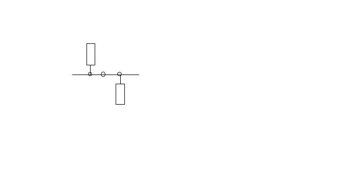

    Has anyone tried butting two SCN5 100mm together?
    something like this i mean: -------||||||-||||||-------
    I'm assuming that two units could be connected in parallel with no problems.
    It should increase the travel but dunno if it would be safe for actuators.

  5. bvillersjr
    bvillersjr Active Member
    Oct 11, 2008
    1,174
    Ohio, USA
    438Coins
    +23 / 1 / -0
    I have not tried this yet. It would increase your travel, but please keep in mind that the load handling capacity may not be what you expect. The push force capacity is different from the pull force capacity on these actuators. This would lead me to believe that at times, one actuator would be pulling the other along.
    I haven't thought it through fully, but at first glance, I'm not sure that I would recommend this. It really depends on how you intend to mount it and what the load would be.

  6. sn4il
    sn4il New Member
    Oct 26, 2009
    55
    2Coins
    This is very important info that makes things different.
    I still think it could be good solution to reduce stress on actuators with heavier drivers. Since travel is greater it could be mounted farther from u-joint where forces needed to move the seat could be weaker?
    I guess I have to think it over and maybe do some math on this one.
    I was thinking to mount them like these:
    Again..., Do You think this factor should be considered during seat balancing?
    If scn5 would withstand the forces it should not matter in this configuration sicne all we care is overall lenght of the setup?
    sn4il
  7. bvillersjr
    Oct 11, 2008
    1,174
    Ohio, USA
    438Coins
    +23 / 1 / -0
    I think once you do the math, you will see that this is not the case. The further that you move the occupants body weight away from the balance point (via your more travel), the harder the actuators have to work to return the driver to center.
    This is an easy theory to prove to yourself even without doing the math. Simply place a seat on a pivot point with no actuators attached. Have someone else sit in it and get balanced. Then you can stand behind the seat and move them 2 inches away from the pivot point in any direction noting the amount of effort required to move them. Now try moving them 4 or even 6 inches away from the balancing point. The force required to lift them back up will be significantly increased. You are talking about moving them even more than 6 inches.
    I'm sorry to be be a naysayer, but I would hate to see you ruin an actuator. Additionally, IMHO, more than 150mm of movement is too much if you aren't planning to move the wheel and pedals too. For example, under acceleration, you would practically pull your steering wheel off with 300mm of travel.
  8. sn4il
    sn4il New Member
    Oct 26, 2009
    55
    2Coins
    I'm building standard motion seat based on two 150mm SCN5.
    I would love to move the wheel and pedals also, that's why I'm looking for different solutions.
    I got Your point with required pull force in this setup (thnx).
    Do You think two SCN5 could be doubled this way?
    I dont know how big of an error between two actuators could be expected (while receiving same data). Three pivots are there only to minimize the risk of failure of an actuator if movment is not exactly same.
    I don't have any experience with SCN5 yet, and would appreciate Your point of view on this setup.
    Thnx
    sn4il

  11. bvillersjr
    Oct 11, 2008
    1,174
    Ohio, USA
    438Coins
    +23 / 1 / -0
    I believe that this can be done given the correct pivot mechanism. You can trick X-Sim into sending identical Commands to two actuators at the same time by manipulating your wiring and actuator ID #'s in the SCN5PLugin.
  12. sn4il
    sn4il New Member
    Oct 26, 2009
    55
    2Coins
    After taking better look at this setup I think it might be dangerous for actuators. If they extend apart from each other, radial force will be created by connector rod between them.
    sn4il
