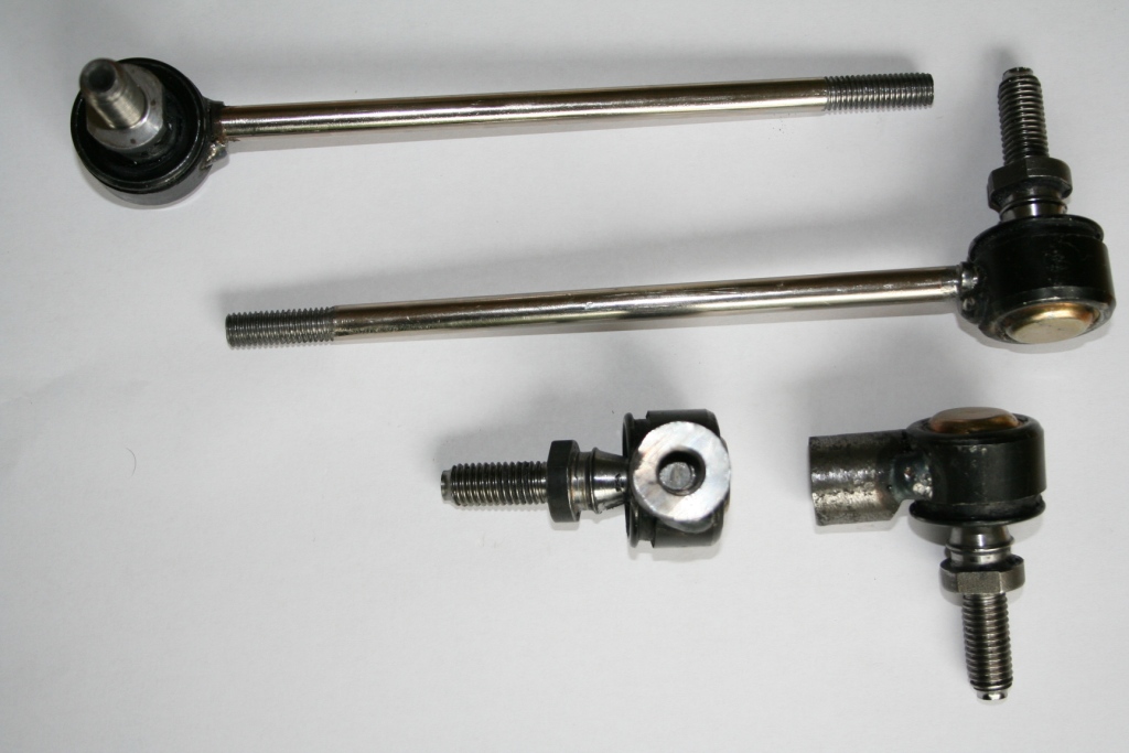

    Hi
    i had the same problem.
    The only manufacturer I could find is this one
    JJ Bearing in China!
    So I found a DIY solution for the Rod ends .
    Made out of a pair of coupling bars from an VW for 12€ both
    and a screw tap for 10€. Never had any need for m10x1,25 bevor, so i bought them on Ebay.
    There are some Pics in my Gallery!
    Works great, no backlash, smooth and enough angle alignment.
    But be careful when welding, immediate cooling is recommendet!
    regards
    kai
