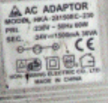

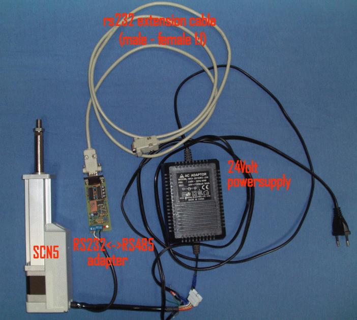

    Dear sirs,
    Please see photo attached.
    I downloaded this from the DIY section of the implentation of the scn motion unit.
    I zoomed in very close to this picture and noticed that this power supply used was 24v 1.5A.
    I have noticed it is hard to get (from uk) 24v 2A power supply.
    Everyone suggests after reading some of X-sim threads that 24v 2A is required to power the scn5 actuators.
    If one was to use the 24V 1.5A, would you get the whining noise I heard when seeing your very first youtube clip where you guys for the scn5 working.
    Kind Regards.

    I am really curious how you have been able to see a 1,5A on the label :lol:
  4. Fahim
    Fahim Member
    Dec 11, 2008
    436
    307Coins
    Dear sirs,
    I zoomed in very close. Then I inverted colour.
    It says 24v 1500ma which I think is 1.5A.
    I will try look for 2A as it says in the DIY section. But if I get a higher one like you guys say, maybe that is for the best.
    Kind Regards.
