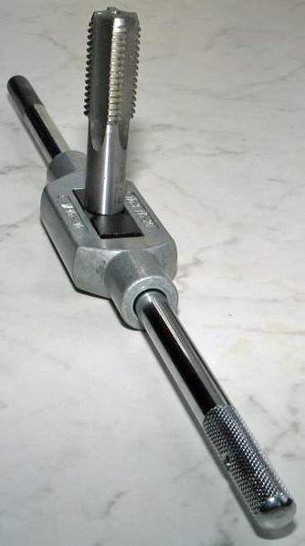

    Can someone please tell me what size of this type of rod end is needed.
    Is it M8 or M10? I take it M8 = 8mm, IF so then that's what needed i guess.

    M10x1,25 (finepitch)
    I took a M10X1,5 and cutted a finepitch tread into it...
    You can buy them with finpitch as well, but they are way more expensive than the standard threaded ones.

    There were two problems from this adaptor from Ebay:
    They show a silver colour rod end on the picture, nice and clean, but it comes all rusty and bronze colour.
    Also the thread size does not fit which Egoexpress stated in a previous post.

    Buy the standard 1.5 threaded rod ends, and cut a 1.25 thread into them. That is how I made it.
    But you may need a fixed bench wise, as you may need to apply much force on the thread cutter, depending the ridgidity of the rod end material.
