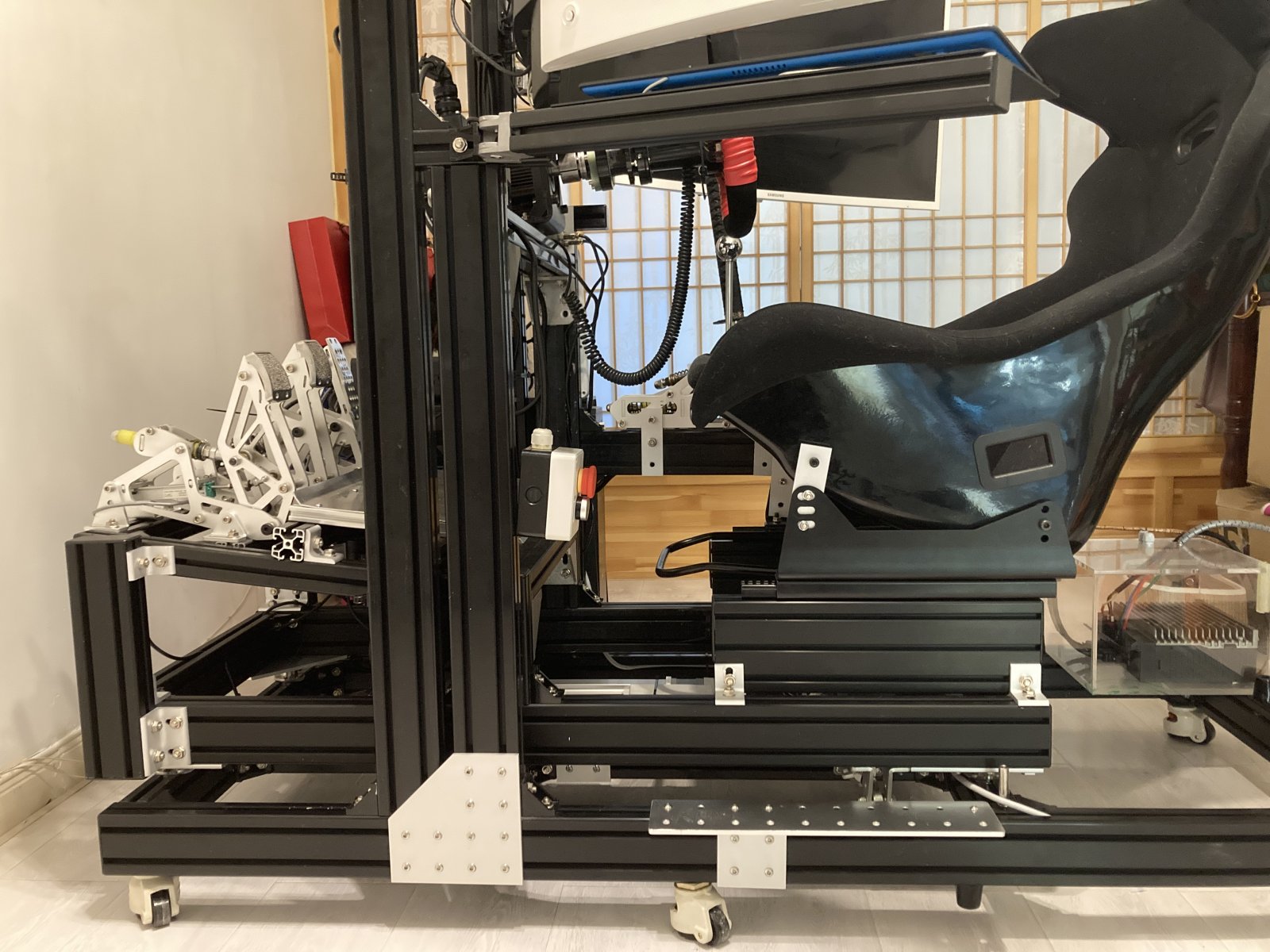

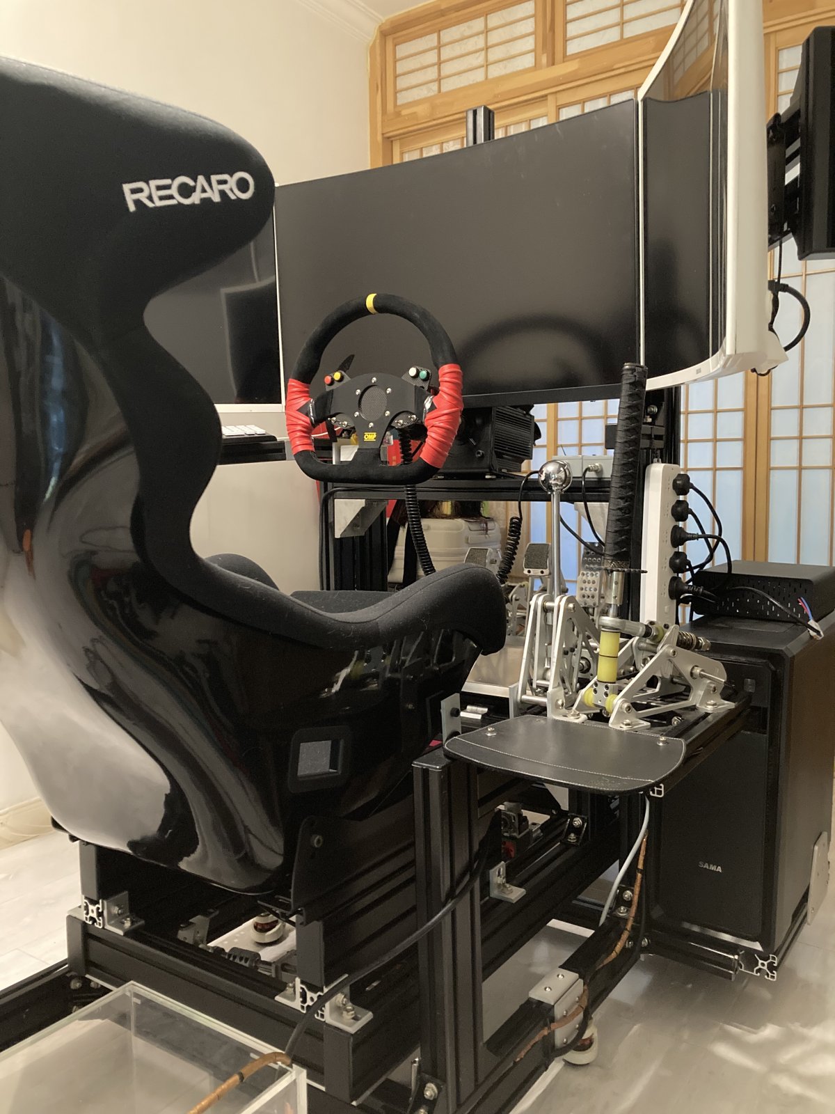

    This is my 2DOF of traction_loss& surf cockpit

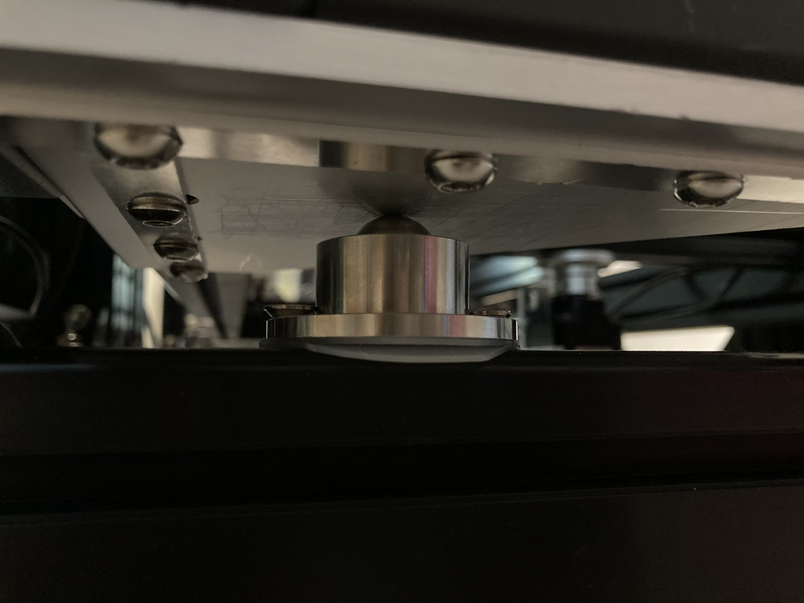

    As you can see, I built another small cockpit on my original cockpit, the outside cockpit supports Servo direct drive motor (15kg) and 3*32' monitors and other things like the sequential shifter and handbrake and computer. The small moveable cockpit support the seat and pedales. I used 4 Universal ball to connect the big cockpit and small cockpit. The wheel, the pedals, the sequential shifter and handbrake are all designed by myself based on a bit of mechanical topology optimization method, if you are interested, maybe I could post another thread talk about them. This is a close picture of one corner about how to use Universal ball connect the small cockpit and the big one.

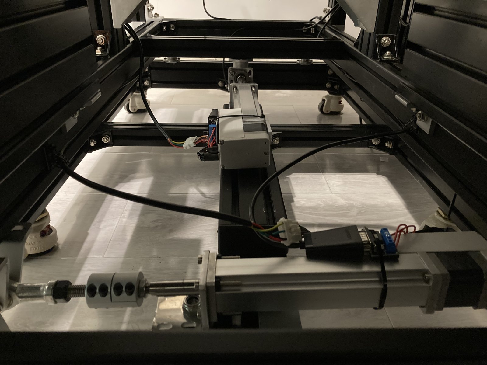

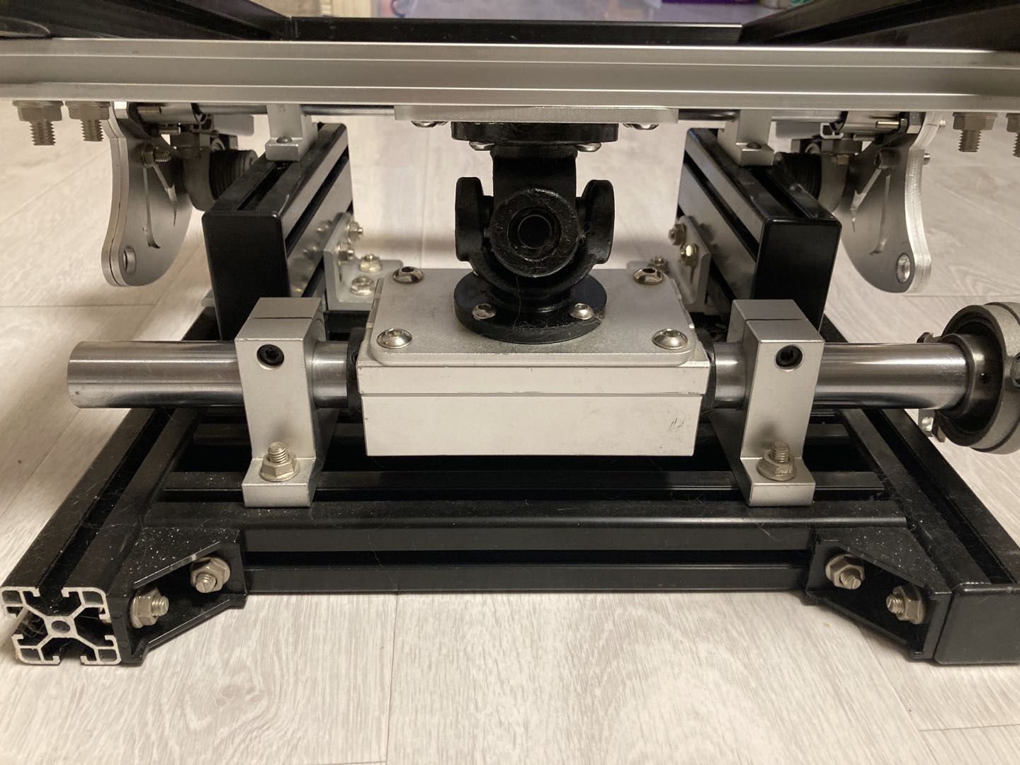

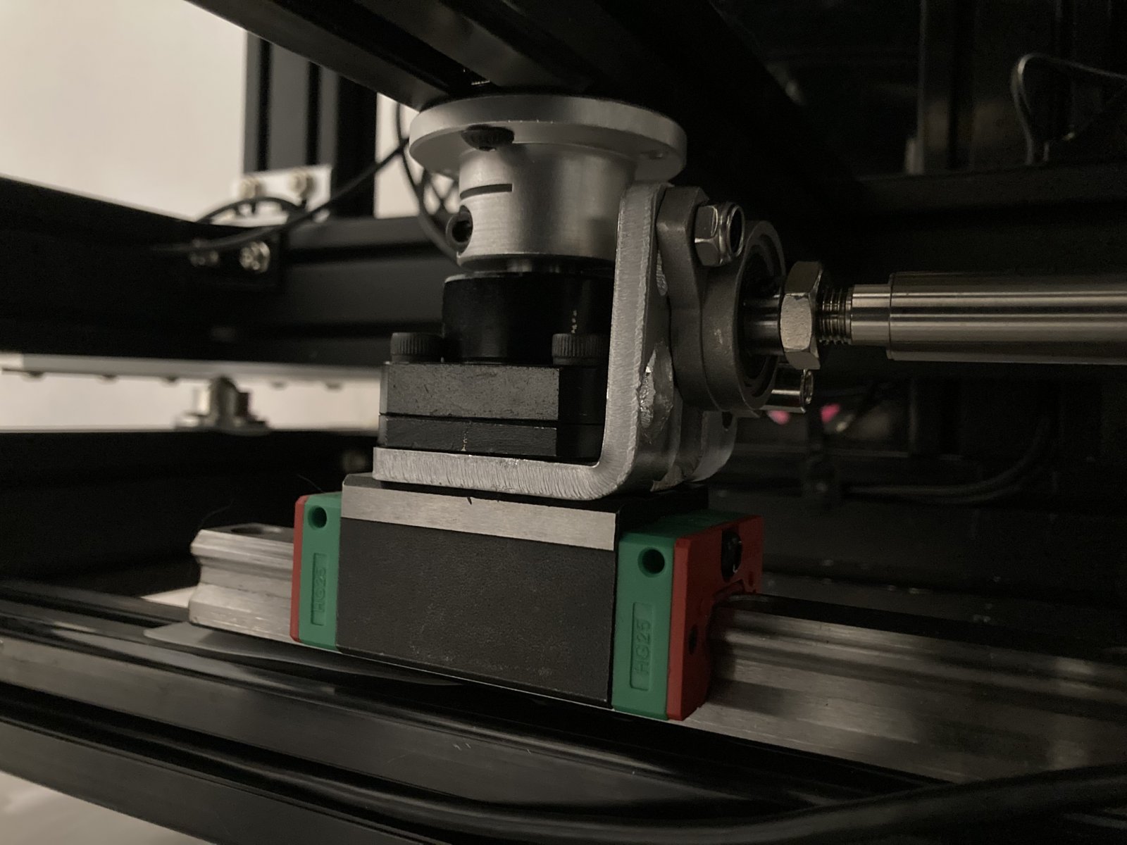

    Then I connect two cockpit with a one-direction-moveable axis, it consists of a linear guide, bearing seat(the black one in the middle), support seat(on the top) and a custom part to connect scn5 and this axis.
    According to this whole view of the structure below, you can see the two DOFs are decoupling. there are just two DOFs, one is surf( back and forth), the orther is rotation along the connection axis.

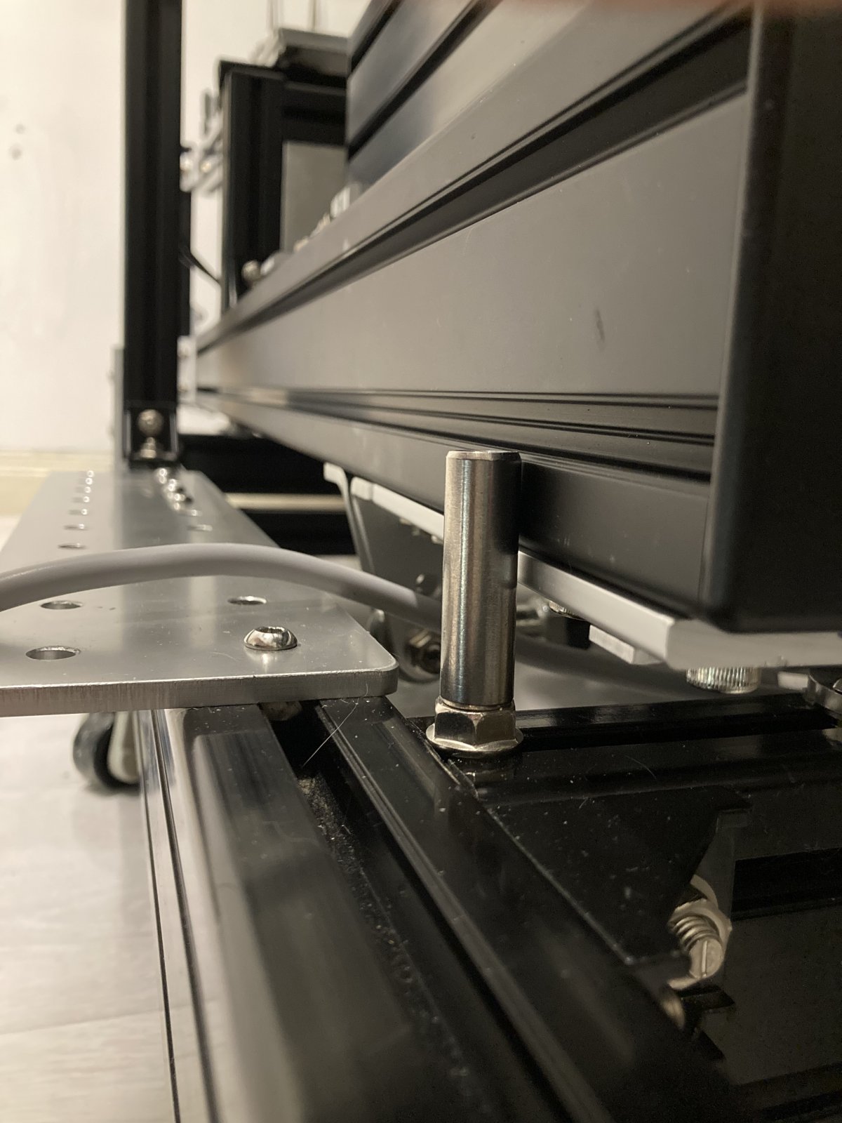

    Limiters are important, when the Simtools start, it will move your scn5s and automatically record the stroke of scn5. so I use 4 8mm bolts fixed on the big cockpit to restrict the small cockpit travel.
    That's it, not very detailed, I hope it shows the idea.:)

    Thats a nice rig and clever design. I always wonder how much inertia those little SCN5 can cope with. How much does the top frame weight? Thanks

    I guess the top frame is 30-35kg, including the seat and pedals.

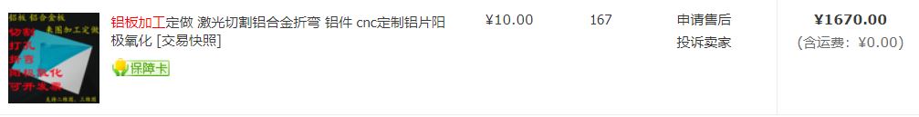

    Since I am in China, it is very convenient to buy all kinds of things from Taobao. I think it is interesting to show you the price of the various parts of my cockpit. You might be surprised that the total price of all the parts of this cockpit is about RMB12000, excluding the computer and three 32‘ monitors. That is about $1800?
    I started to design and build it from 4or5 years ago in my spare time, and it was revised many times in the middle. I had to say the building process is more interesting than driving, that I still can't beat the AI of Assetto corsa.:)

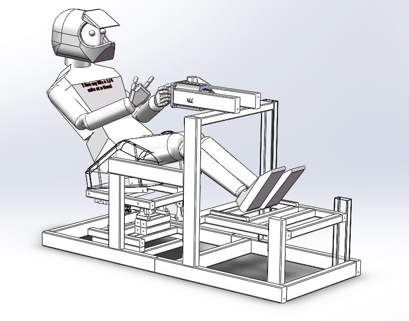

    I designed the frame using Solidworks and a model man named Todd :)

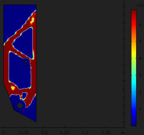

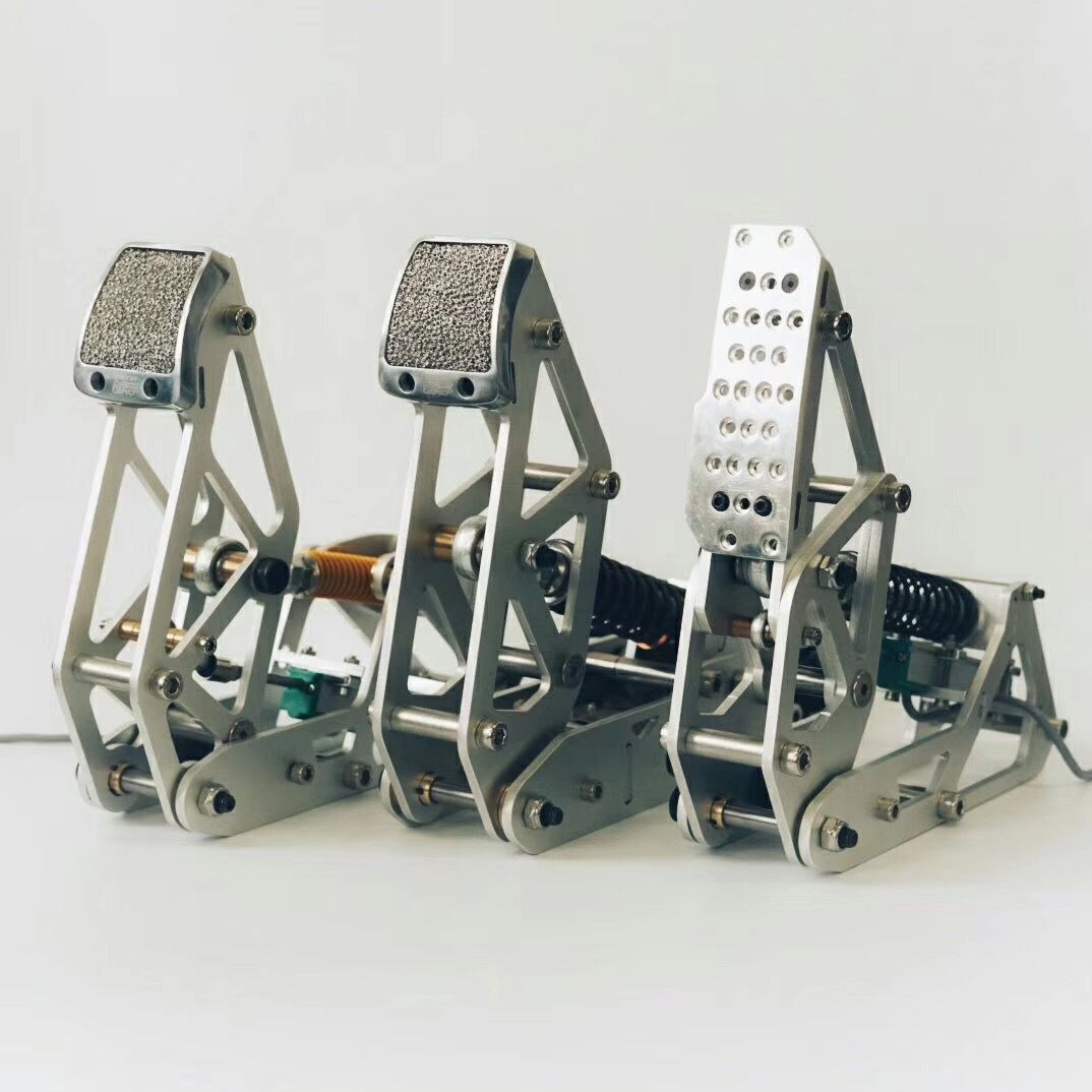

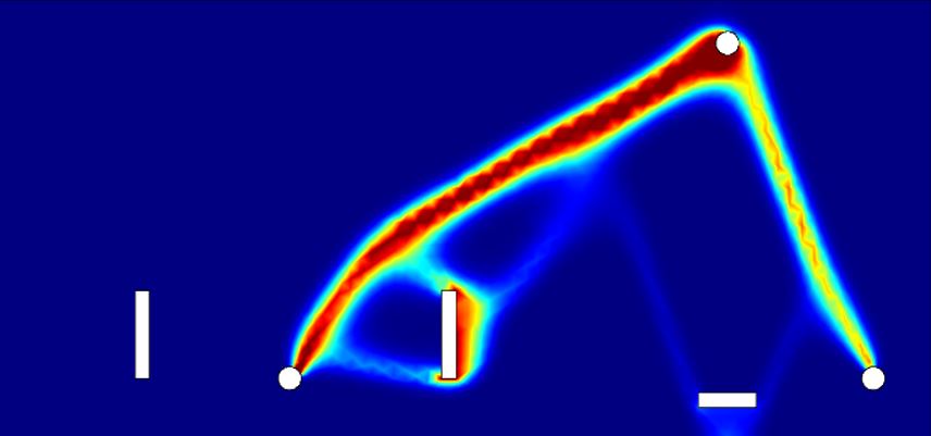

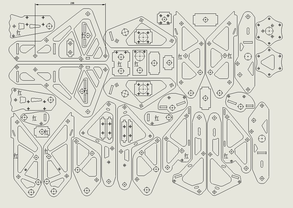

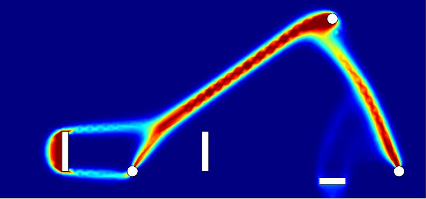

    The pedals the shifter and handbrake are designed using some mechanical topology optimization method, by Comsol
    The brake pedal stress when pressing
    The sequential shifter pull&push stress
    When finished designing, draw the cutting dxf, and send it to someone who can do laser cutting on Taobao
    and done!

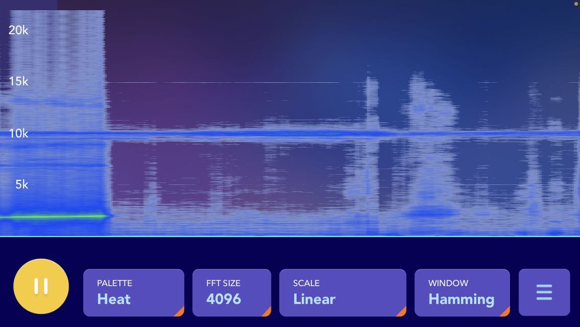

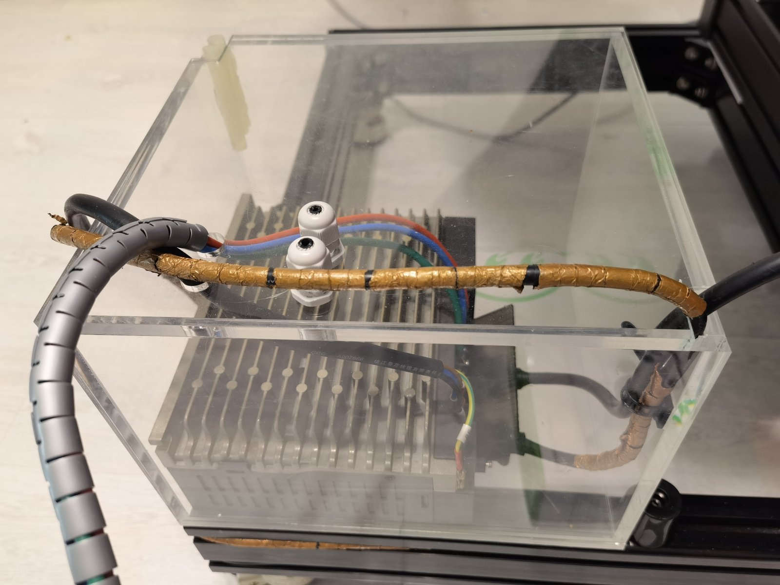

    The driver I used for MiGe 130ST10015LFB(10N*m) is Dealour DO-1000C30L, this is the original driver of MiGe Motor. But it has annoying high-frequency noise, maybe because it is some industry stuff not considering the noise...
    Here is how to elimanate the noise.
    First I test the noise frequency with the help of an app in IOS "Spectrum", it says the frequency of the noise is concentrated in 10k Hz. It is a good thing, because it is usually easy to elimanate sound in a very narrow frequency bandwith
    According to some acoustic theory, When the thickness of the intermediate layer is an odd multiple of 1/4 of the wavelength of the sound wave, the transmission coefficient shall be the minimum value, and the material of the intermediate layer doesn't matter much, comparing to the air.
    After some calculation, I made a box with 8mm thick plexiglass, and put the driver into it, then it became silent.

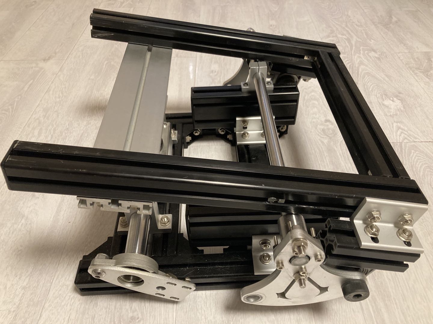

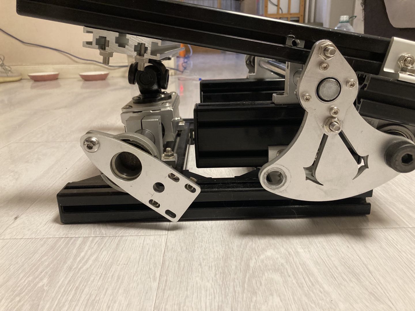

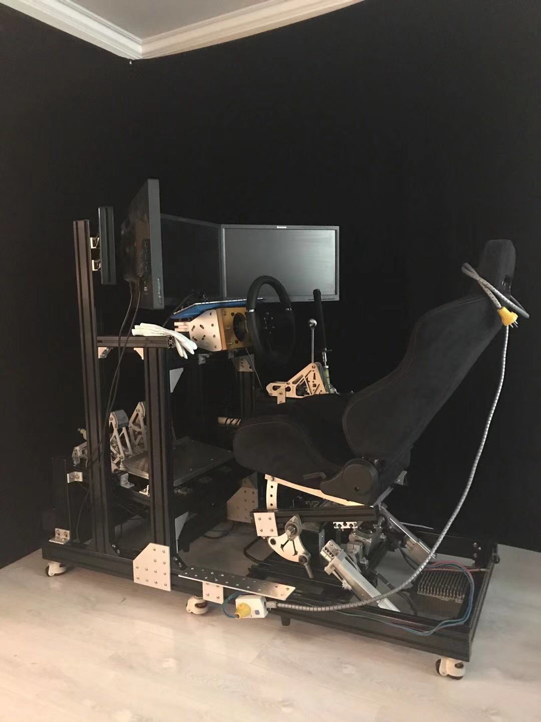

    This is the first 2DOF version, roll& pitch, the cylinders were not connected onto the frame, but you can tell how it works.
    I use two Triangular plate with Assassin's Creed sign on it:grin, to change the force direction of the cylinders from horizontal to vertical, and to push the front of the seat frame.
    That is because, I want the seat to push me forward while pitching backward, to simulate the instantaneous forward acceleration and equivalent acceleration by gravity, when accelerating. vice versa.
    But the result was not so good as expected, because the size and angle of the Triangular plate was not enough. and I could only feel the pitch and roll, almost no back and forward.
    So I changed it to the other 2DOF tractionloss&surf.

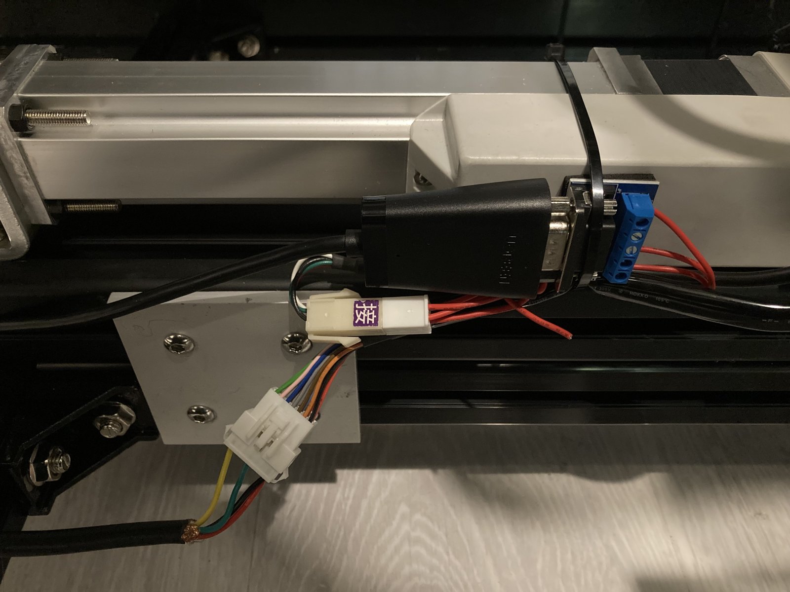

    Some more detailed photos.
