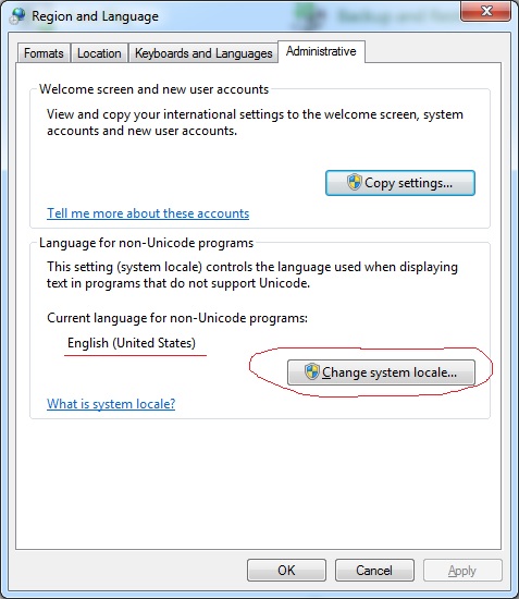

    try this,
    Let me know how it goes,

    Huh... that fixed it somehow. Who would've thought...
    Thanks!
