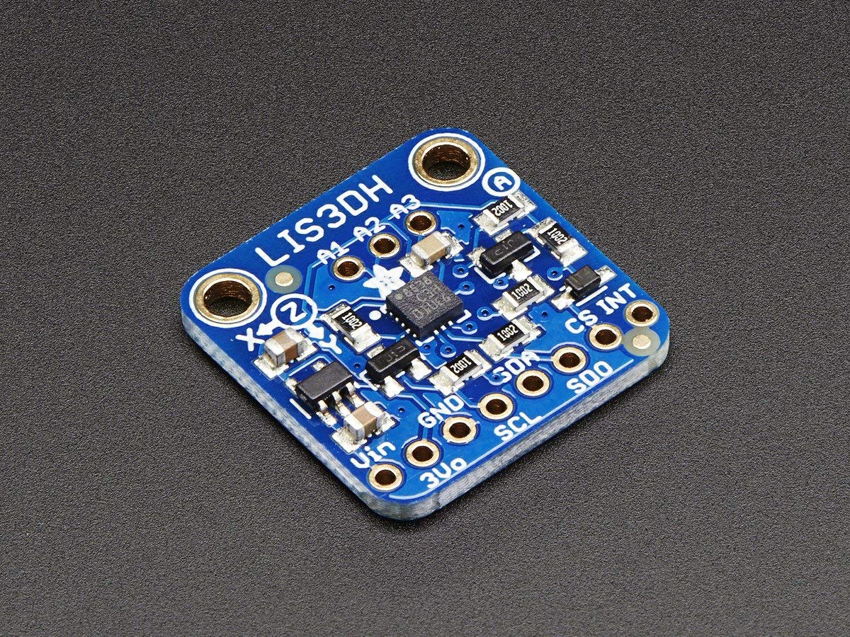

    I hope everyone has wired an emergency stop switch into their rig.
    I would like to expand the safety features to include an automatic shut down sensor.
    With the new AC servo stepper motors I am using it is possible to achieve accelerations that could injure the rider.
    I am not really sure where to begin but I will assume we are talking about G-forces.
    If the G-force exceeds 2G's shut down the motors until manually restarted.
    That is what I would like to try.
    I ordered an Adafruit LIS3DH Triple-Axis Accelerometer (+-2g/4g/8g/16g)
    that I hope to hook up to a Arduino nano and activate my safety circuit.
    Never having done such a project and with my limited knowledge of "C+" I will need to adapt sketches from other online sources.
    Any thoughts??

    That is the exact scenario.
    Losing control of the plane.. Usually stall and snapping. I can not always gain control back. When the plane hit the ground the rig reacts violently.
    From what I can tell there is no way to stop this in DCS.
    Right now I have 2 E-Stop switches mounted either side of me.
    To be on the safe side I just activate one as soon as I get into a spin.
    The accelerometer would just be a backup.
