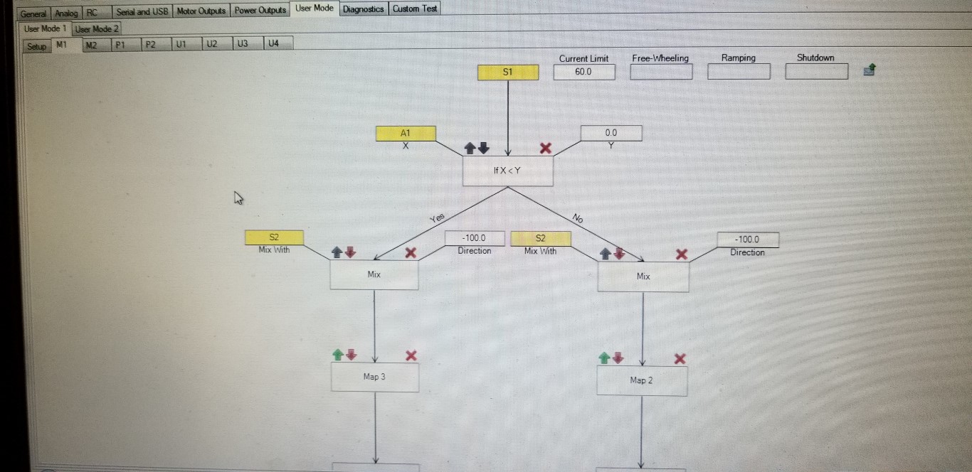

    I have a 24v r/c lawn mower working with the sabertooth, I have a r/c 4 channel in the sticks(ch1 to 4) and 2 buttons that is ch5 and ch6, I programmed 2 maps with the " if " option in M1 and M2 that A1 (ch5) if higher than 0 it will use a map, if not higher will use another map.

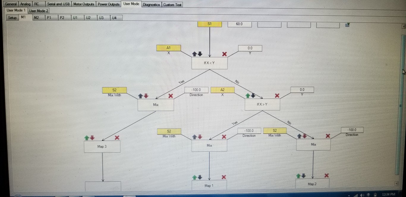

    I want to add a 3rd map but I can't find the way to do it, using the same form as above, under the" if " I created another " if ", this one is A2 (ch6) if higher than 0 will use another map or if not will use the map from the first " if "
    All buttons below 0 (off) work with my first map which gives a 45% of power, but when I turn on any switch it will not operate, 0% of power.
    My previous config was map1 45% of power, map 2 100% of power, now I want map 1 40% of power, map 2 65% of power and map 3 90% of power.
    I found that 100% of the power was faster than a jet and for a mower is not good, I want my son to use it so that's why the slower speeds.
    The U1 to U4 tabs seems to do nothing, everything I put there it doesn't work.

    Adding the configurations, the one with 2 maps works fine, I want something with 3 maps as the second picture. Thanks.

    Hi @Joelpr123 , I don't think anyone here has ever used the mapping functions that you are referring to. Most use an Arduino or other controller to control the the Sabertooth.
