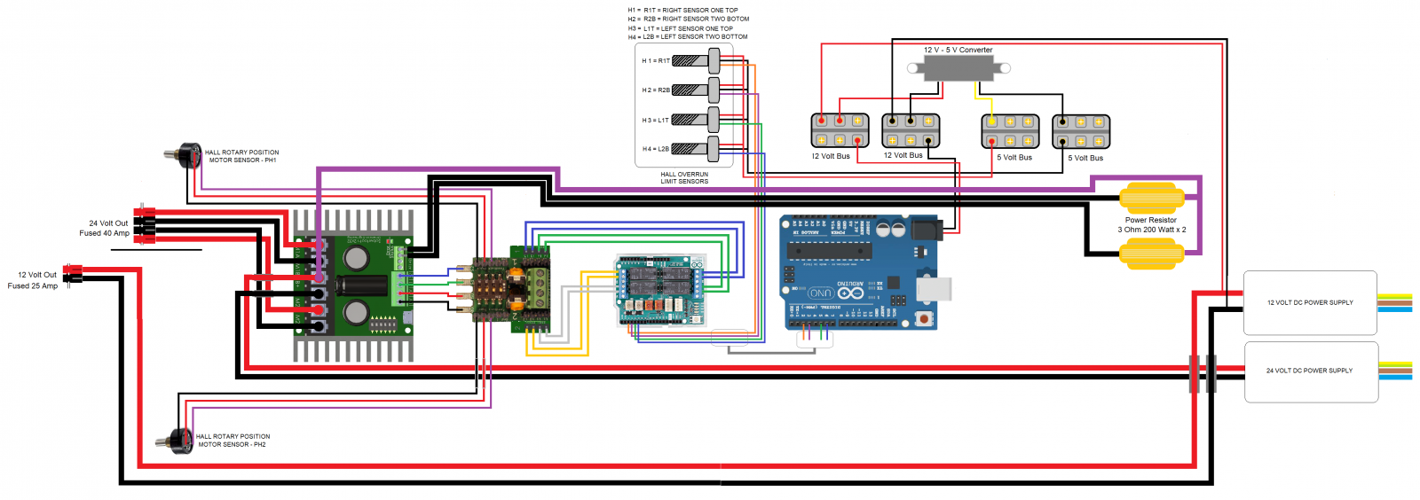

    And I have implemented a limit switch non-contact control at 75 ° on the top stroke, and 75 ° on the bottom stroke, this is controlled with hall switches via a Arduino with a bank of relays set to digital high when activated by the sensors two per motor.

    Here is the circuit diagram / wiring diagram. sIMULATOR CONTROL bOX.png

    The wiring diagram looks fine.

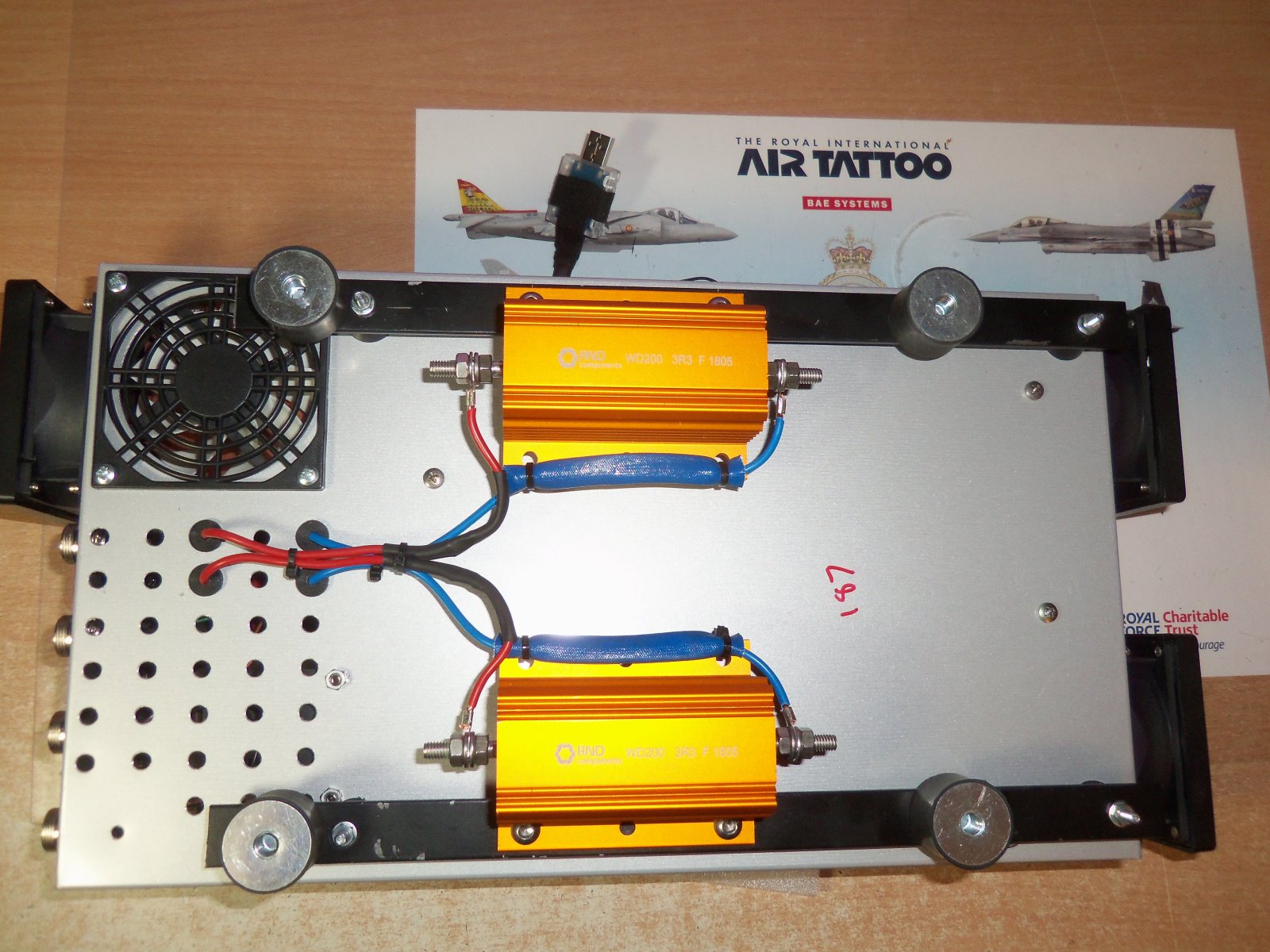

    And I had a second problem that might have caused problems, and this was the Power clamping resistors, I was told that my two 5.Ohm 25 Watt were underrated and that I needed 2 x 3.3 Ohm 200 Watt resistors to dissipate the regenerative current, I have now implemented this on my power supply.

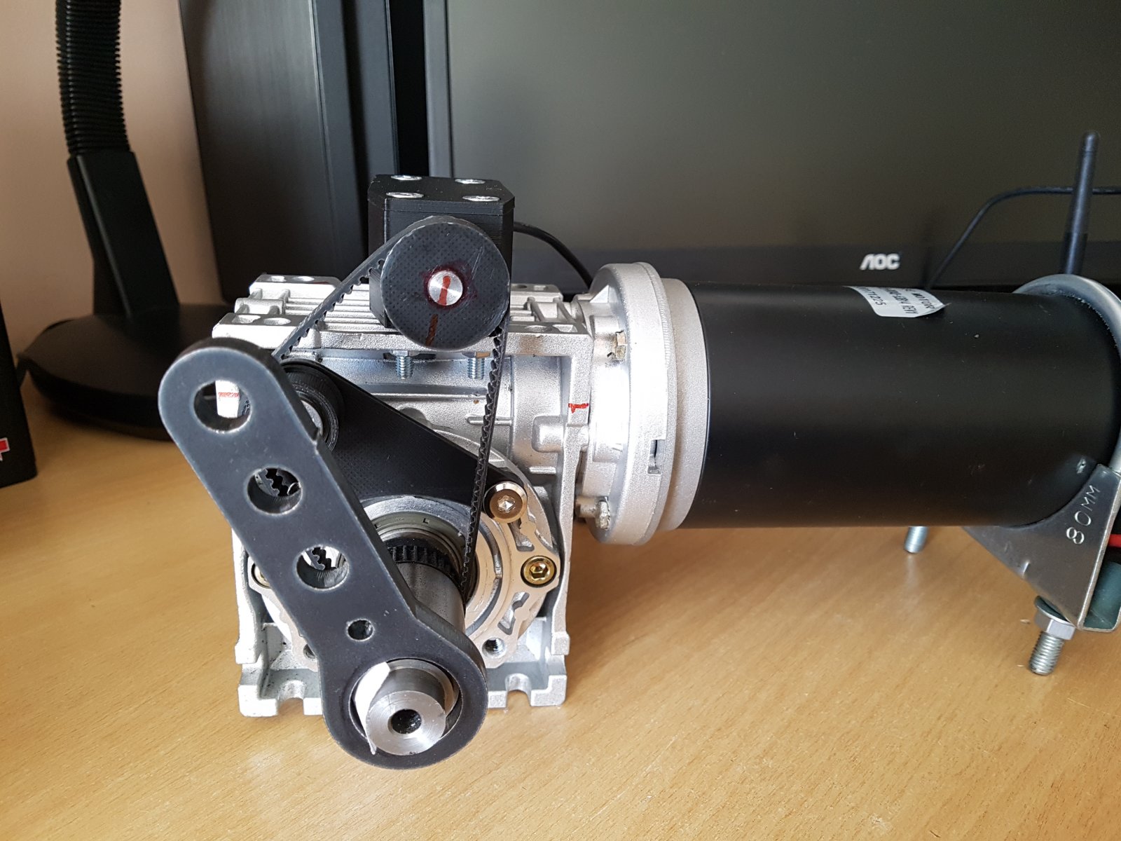

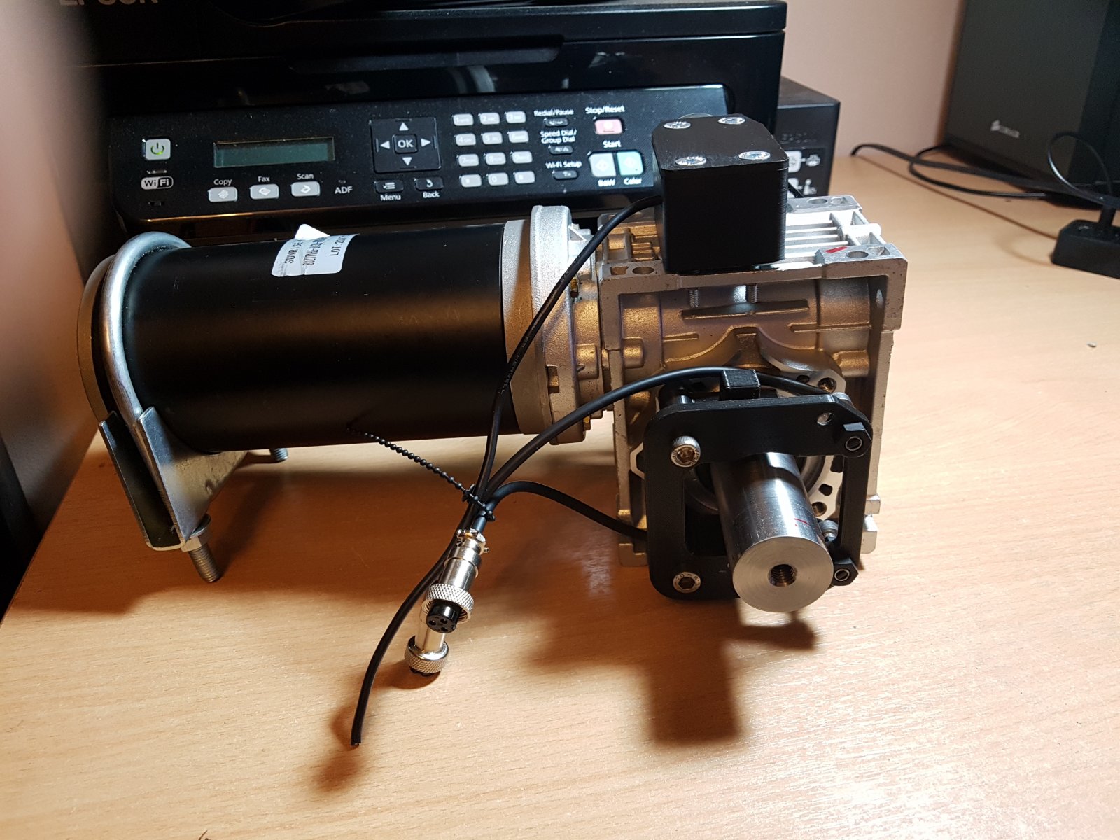

    And I need to redesign my magnet placement on the motor arms as the arms are 8mm in diameter, the magnets are 5mm in diameter and are pressed in to the arms, this causes the magnetic field to be disturbed by the metal surrounding them.

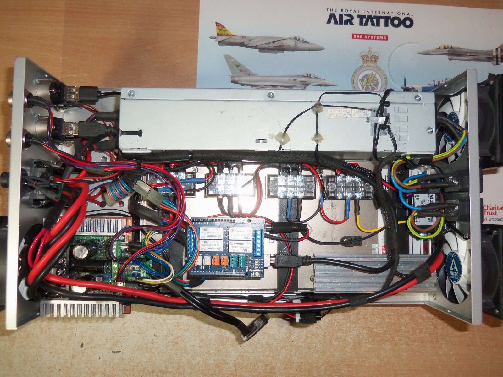

    I have included some pictures for reference.
    And I will down load and save you video reference .

    I think the original magnetic setup did cause problems by giving false position information to the Kangaroo, and I haven’t done a second tune as yet, I need to redesign the magnet trigger as the ones I was using 5x3mm have a very large pull strength of 0.76Kg, so there is a possibility the magnet triggering the hall sensor before the sensor got to its position.
    I will be replacing the magnets with a smaller magnet 3mm x 0.5 with a pull strength of 0.08 kg, I also found that you can trigger the sensor from left to right with different results, depending on the magnet polarity being north or south, it can be head on in one direction, and be one centimetre in the other then it will trigger and it can latch if the sensor goes beyond the magnet.
    So today I will be 3D printing two magnet holders to place the new magnets in and set the polarities on the magnets and do a bench test.
