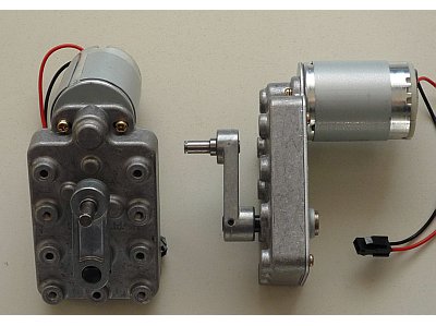

    What kind of rpm is enough for the simulator?
    I found a 30rpm motor in Ebay but it seems a bit slow?

    What kind of simulator? How much movement? What is the weight you are trying to move?
    And I could ask more. There are way to many unknown variables in your question.

    A 2dof wiper motor sim, like the one Tommy has from Finland. I guess about 85-90kg will be enough or I will go on a diet!
    What i've seen a wiper motor sim only moves 1/4 rev or a maximum of a half rev?

    No, they are too slow... Find one that is around 50 - 60 rpm and doesn't look like that!! The motor on the photo is free wheeling that means that the motor driver will be always under load... instead on the classic wiper motors the motor driver is under load only when it has to move the simulator around!!

    Ah, ok! I will have a look in my garage then! Thanks!
