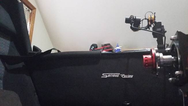

  12. SeatTime
    28,370Coins
    +2,844 / 38 / -0
    My camera is at head height, off to one side and around 30 centimeters from the Oculus Headset array, works well.

  17. sam poole
    sam poole Active Member
    Nov 14, 2017
    137
    midlands
    34Coins
    +45 / 0 / -0
    3DOF, DC motor, Arduino, Motion platform, 4DOF, 6DOF
    the problem I think could have been down to my arms getting in the way so i put it just below head height the opposite side of the gear stick about 60cm from headset
