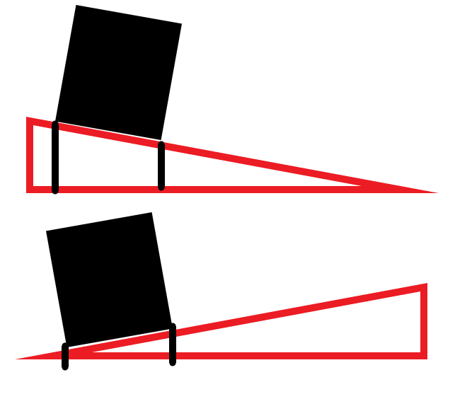

    I've have an idea to fix something that probably isn't even a problem. :think
    The roll axis, for a flight sim or an F1 car you sit straddling the roll axis. Positioning the roll pivot under the middle of your motion sim seat makes sense.
    But what about a GT or Rally car? In a left hand drive car the roll axis is to the right of your seat, under the shift and handbrake.
    Can the software move the axis to the side or do I need to build wide rig to put the pivot to my right?
    Some very rough calculations
    Assuming a 2m wide wheelbase on the car, left seat edge 20cm from left wheels and right seat edge 20cm from center of car.
    Tilt car 10º right and the left side of the seat rises 35cm right side by 21cm,
    Tilt car 10º left and the left side only rises by 2cm and the right by 7cm
    Seems like your body would notice that large of a difference.
    I've only ever ridden in an F1 style simulator before.
    Does my thinking here make any sense? Am I seeing an issue that doesn't exist?

    Set sway to lean away from a corner and roll opposite.
    Perceptually, particularly in something as fast as a GT car, the perceived roll movement, say running up a curb will be from the side it occurs.
    Keep in mind that the purpose of a motion simulator is to exploit physiological and physiological processing weaknesses, to provide adequate cues to have the brain accept something as real when you know it is not, rather than trying to recreate all real world forces, which is not practical for a motion rig, particularly a DIY rig.

    That all makes sense.
    Just over thinking it :grin probably won't make a big enough difference to notice.
    Don't have room to start building my rig until after I move, so just brainstorming.
    I'll dig into the plugin manual a bit deeper and see if there is a way to maybe scale the roll input to move the pivot in software.

    I want to try something a bit different, I'm thinking I'll start with a 2DOF with the pivot point behind and to the right of the seat where the center of a road car is.
    Then add a 3rd for yaw/traction loss later.
