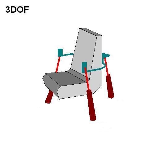

    Ok, i read the thread Pneumatics/hydraulics in comparance to other systems and it's really interesting.
    Sure is that with a pneumatic system i can lift more weight with a decent speed too. This make the pneumatic solution really cool.
    I notice that the Proportional Valves is the only solution if i need a fast response and different movement speeds of the pneumatic cylinder rod.
    I am looking for R'n'R motion system because this is a ready to use pneumatic system. Sure the digital valves are the big limitation but sure that to have one R'n'R it's a positive thing because it's ready to use and ready to work with X-Sim.
    Have one R'n'R = have a machine ready to use and ready to be studied in firt person and not just theory about pneumatic system (yes i know the theory is really important but if you add a machine ready to use i think that is the best solution to make some experiments)
    I find this proportional valve, can you tell me if it's a good theoretica choose for a pneumatic system?:
    http://www.omega.com/ppt/pptsc.asp?ref=PV100

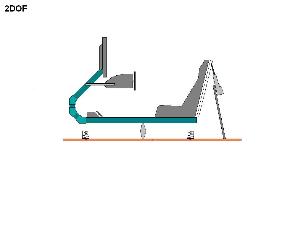

    How much mass are you trying to move?

    Hi, the weight of my platform (2DOF or 3DOF) projects will be so and so 100 / 120kg (human 80kg included).
    I have 2 version about my project, one 2DOF and another 3DOF. You can see my cylinders (or actuators) position in the posted pics for both 2DOF and 3DOF.
    I think pneumatic solution it's a good choose because my first goal is aggressive platform (many tilt angle, many speed)

    I think everyone is trying to tell you that you won't be happy with a pneumatic solution.
    IMHO, you have three viable actuation options for your 3DOF:
    -Expensive electric actuators (Bosch, etc..)
    -DC Motors
    -AC Motors
    There are many threads in this forum that will help you to accomplish the DC or AC gear motor options.
    There is no off the shelf actuation solution for a simulator like your 3DOF design. It simply requires too much actuator power.
    In short, you can either re-design your sim to get the same movements but require less actuator power (which is very possible) , or look into AC or DC motor controllers in these forums.

    Thank you bvillersjr, I think the best solution is the DC/AC choice.
    Yes i can re-design my platform to get the same movement with less actuator power, I saw something about that but probably it's just time to learn to use the DC/AC motors.
