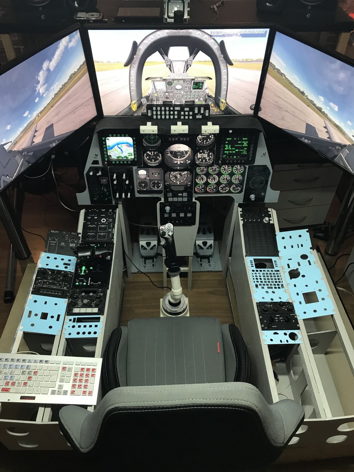

    This is my A-10c pit that I want to get „airborne“ with the motion platform ;) F701A309-0AD8-4E53-AA7C-B6DFE046C06C.jpeg

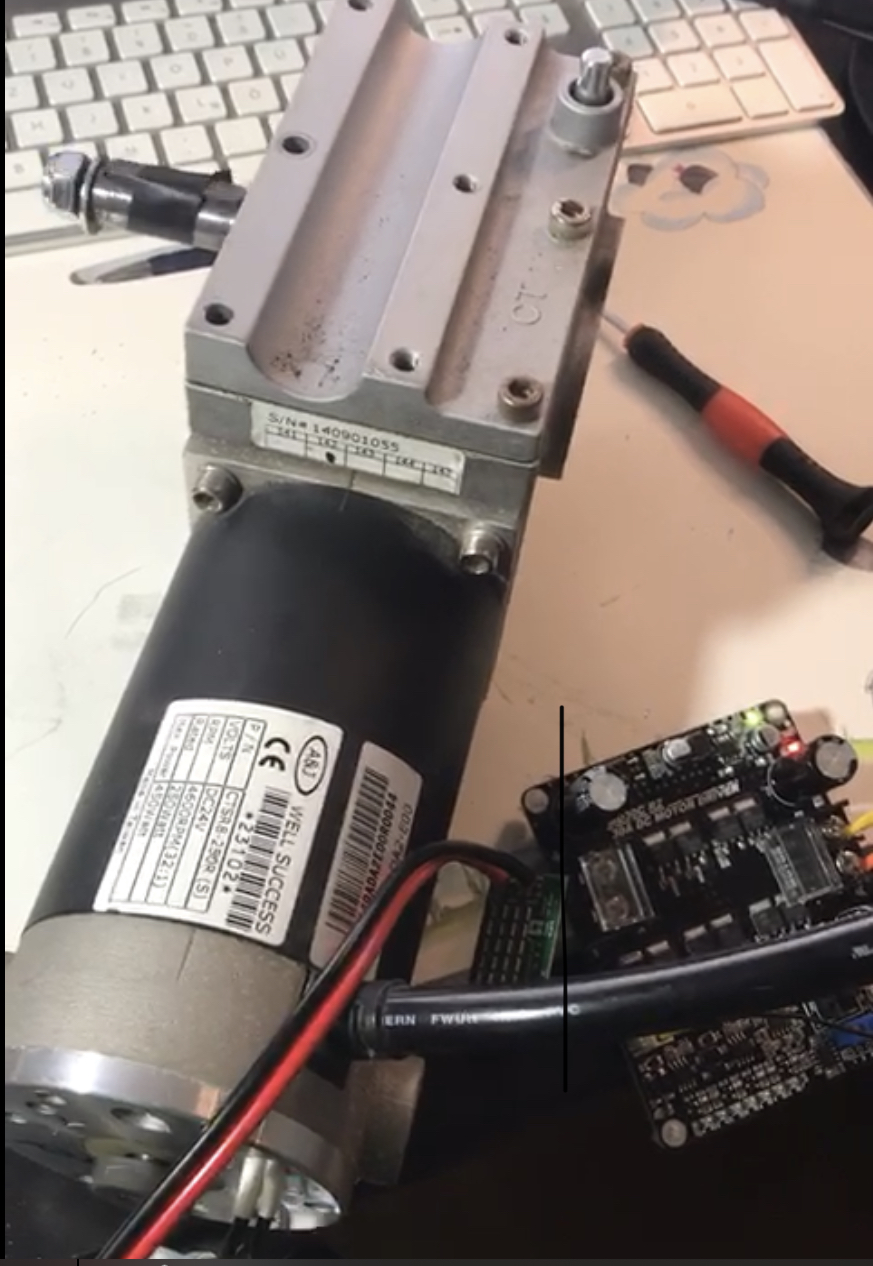

    The two wheelchair motors did also arrive. They are rated 24vdc 250w with 32:1 reduction. I am planning to run them with 12vdc at the beginning B7847791-8641-4D5D-925C-A8B79C631011.jpeg

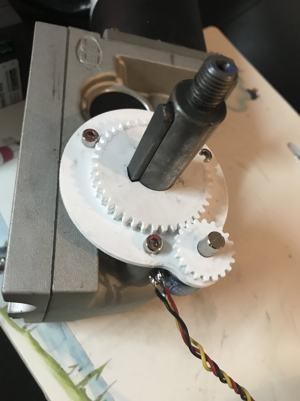

    thanks ! I hope to have enough time this weekend to show you more progress on this project. Last evening I did the first Pot mount. Now I need to figure out how to scale the pot because I only have some 100ohm pots on hand

    if you're using arduino, indeed the ATMEL requirement is 10kOhm

    I don’t have much time at the moment but want to get the second pot gear/support installed this evening...I love my Lasercutter, best investment I ever done :)
