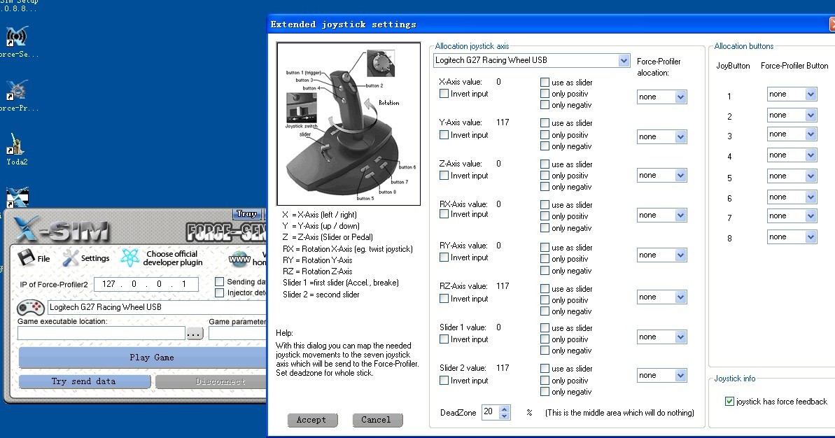

    Today, I have a lot of problems with X SIM2
    with windows XP:
    I have profiler crash, and force sender crash
    1: If force profiler is not open, I can not start GRID
    2: with profiler and force sender (realese 2.1) ; sender opens 10s and closes .
    i need to open in administrator.
    3: with a lot of difficulty, when alls soft in open, When I press start the PC crash!
    the start button stays red and everything is frozen.
    i need to reset the PC
    thanks for help

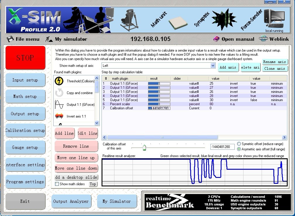

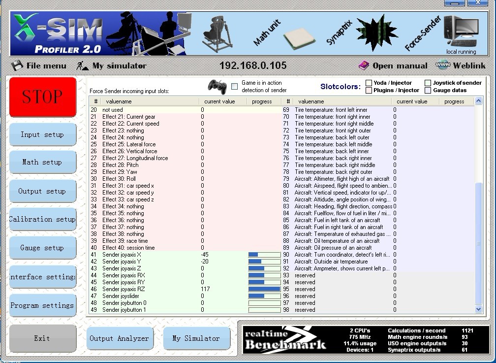

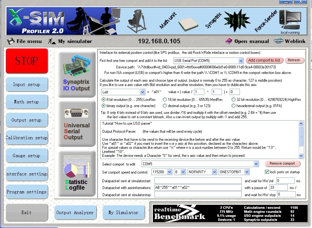

    I did experiment with the speed.
    how to work the speed?
    is the effect that sends the information?
    must submit a special effect for the speed?
    I have my exit Velleman gives me a change of speed, but I do not know how to set, adjust the output.
    can you explain how it works the speed?
    I note that the speed does not use the entire range
    thank you
    my config is the sams than this example:
    3. Usage of a analogue airflow valve with a 5/3 valve as direction switch
    A combination of a analogue valve with a direction valve will solve the pulse mode problem out of 2.) above. You will control the airflow and therefore the movement speed with a analogue valve which is able to half open its switcher. You have to generate a PID synaptrix or you can make your own speeds without the need of PID control. You will need a supported analogue output interface like the vellemen K8055d. Also most of the analogue valves does not support 0 to 5 volts at their inputs, so you might use a analogue amplifier circuit.
    the problem is that I do not know how to do X in the software sim.

  13. egoexpress
    egoexpress Active Member
    Dec 13, 2006
    3,839
    Germany - Frankfurt/M
    421Coins
    +7 / 1 / -0
    Re: Riton' 2DOF project with AC gearhead motors
    have a look at Thanos thread/explanation about PID control in microcontrollers:
    implementing-pid-control-in-microcontroller-t1011.html?hilit=pid
    PID Synaptrix is a software version of PID control.
    Generally, the Velleman should output an analog voltage dependant to the derivation of current postion and target position.
    The greater the distance, the higher the output voltage.
    Regards
