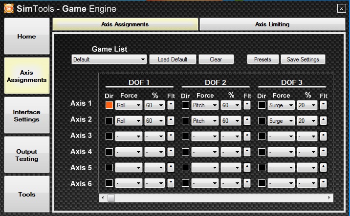

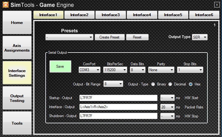

    Hello Sim builders,
    I managed to manually turning my L & R pots to move L & R motors, Arduino code works fine thanks to RacingMat.
    Problem start here, I attached my pots to the motors, uploaded preset cfg for axises and interface cfg. while get to output testing my motors, I managed to move L motor by sliding the slider with mouse. Its actually gives my max , center & min movement too. Even Roll, Pitch & surge are working for left motor while output testing.
    NOT my Right motor. no movement at all.??? Just to double check my pots is still works, so I turn off the output testing, turn my Right pots and sure enough Right Motor moves.
    I thought I threw this issue out there to see if anyone had this or seen this problem before? Perhaps getting some help or advise from you experts out there.

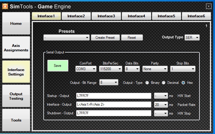

    here are my setting:
  2. yobuddy
    5,392
    50,489Coins
    +5,155 / 18 / -0
    You have a space in <Axis 2> - should be <Axis2>
    Let me know if it worked?
    edit: looks like you have a space in <Axis 1> also, please remove the spaces.
    Let me know how it goes buddy!

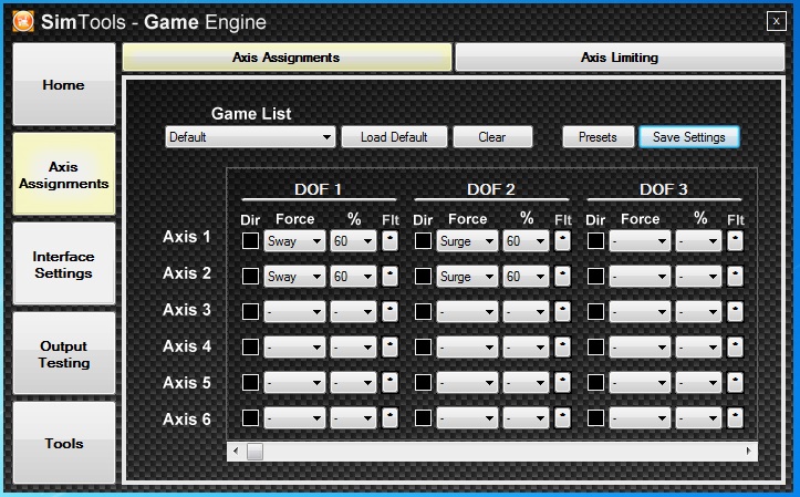

    Sorry, I posted the wrong pictures earlier! I did upload your presets!

    Came home from work and quickly confirm that these are my settings using RacingMat presets. Tried output testing it again ...same result! Motor R not responding! Only manually turning pot is working!

    Hi Mat,
    new discovery, I changed my interface setting (see pic). I got the R motor to move and now the left motor stayed still.
    its totally opposite of the original problem.
